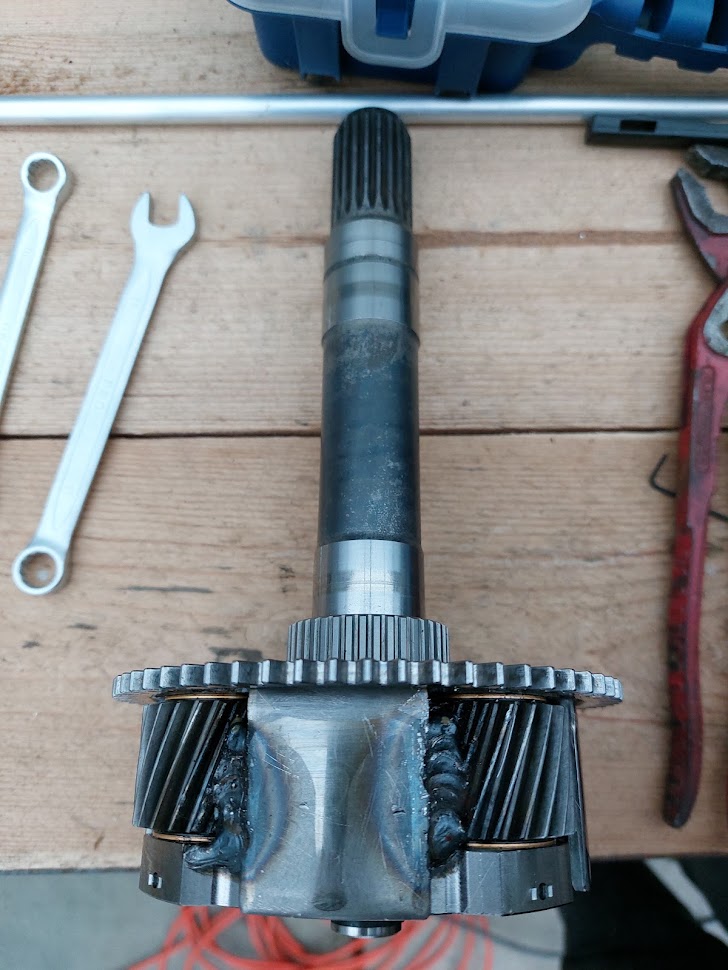

If you read my previous posts, that is actually my idea to weld planetary carrier so MG1 will be locked with mechanical oil pump wich is designed to work constantly, unlike electric pump. And if clutches and solenoids of range selector will suffer from it, basically to replace clutch on one of ranges(high probably) with solid toothed ring, that will permanently lock up range selector.

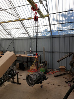

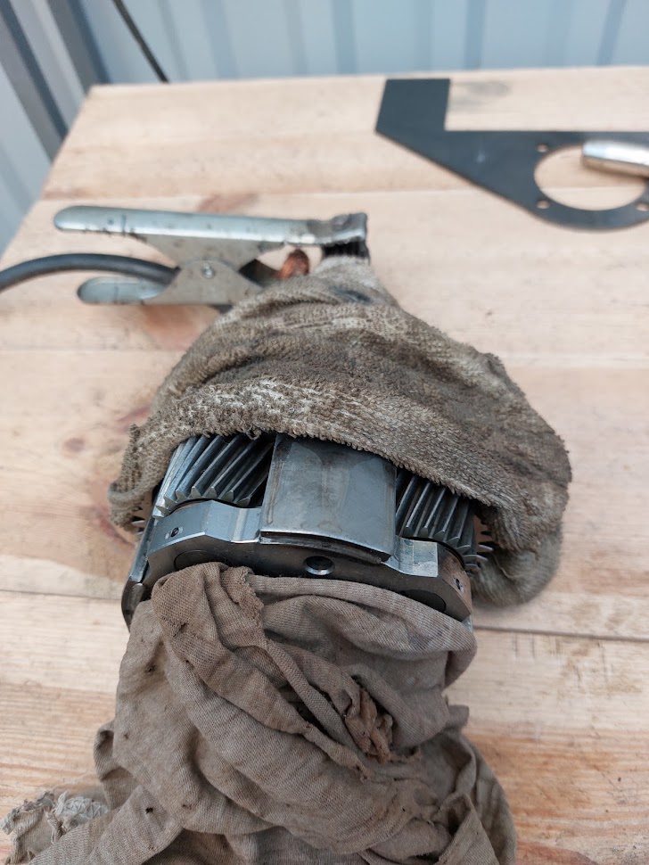

Today I disassembled my gearbox and welded carrier. When I turned oil pump both ways by hand it rotates freely. Only when it rotates backwards it makes woop-woop sound :lol: I believe in that rare and short periods of driving in reverce, pump and bearings will not suffer, and with solid ring I don't need all that pressure to be present for movement.

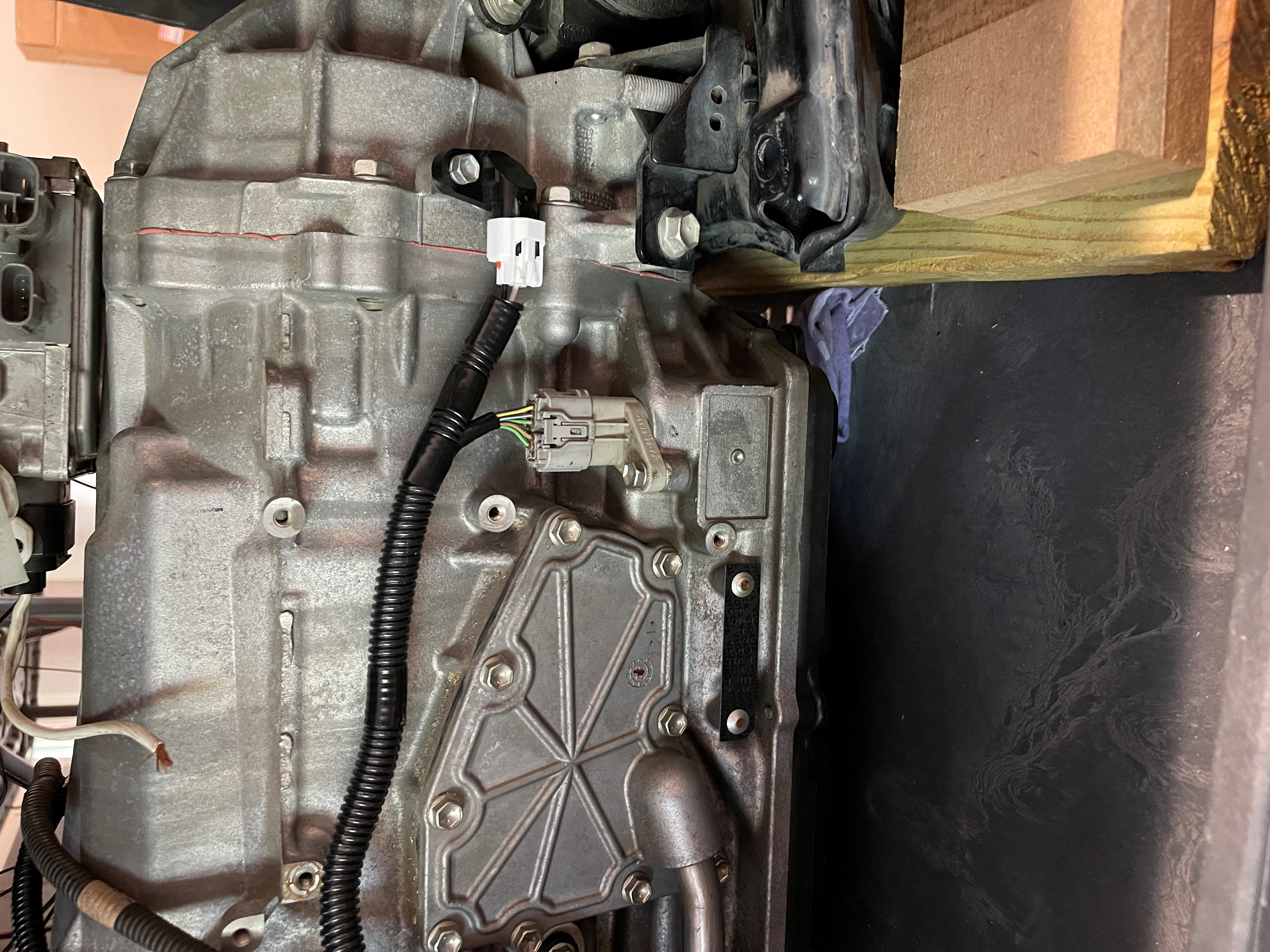

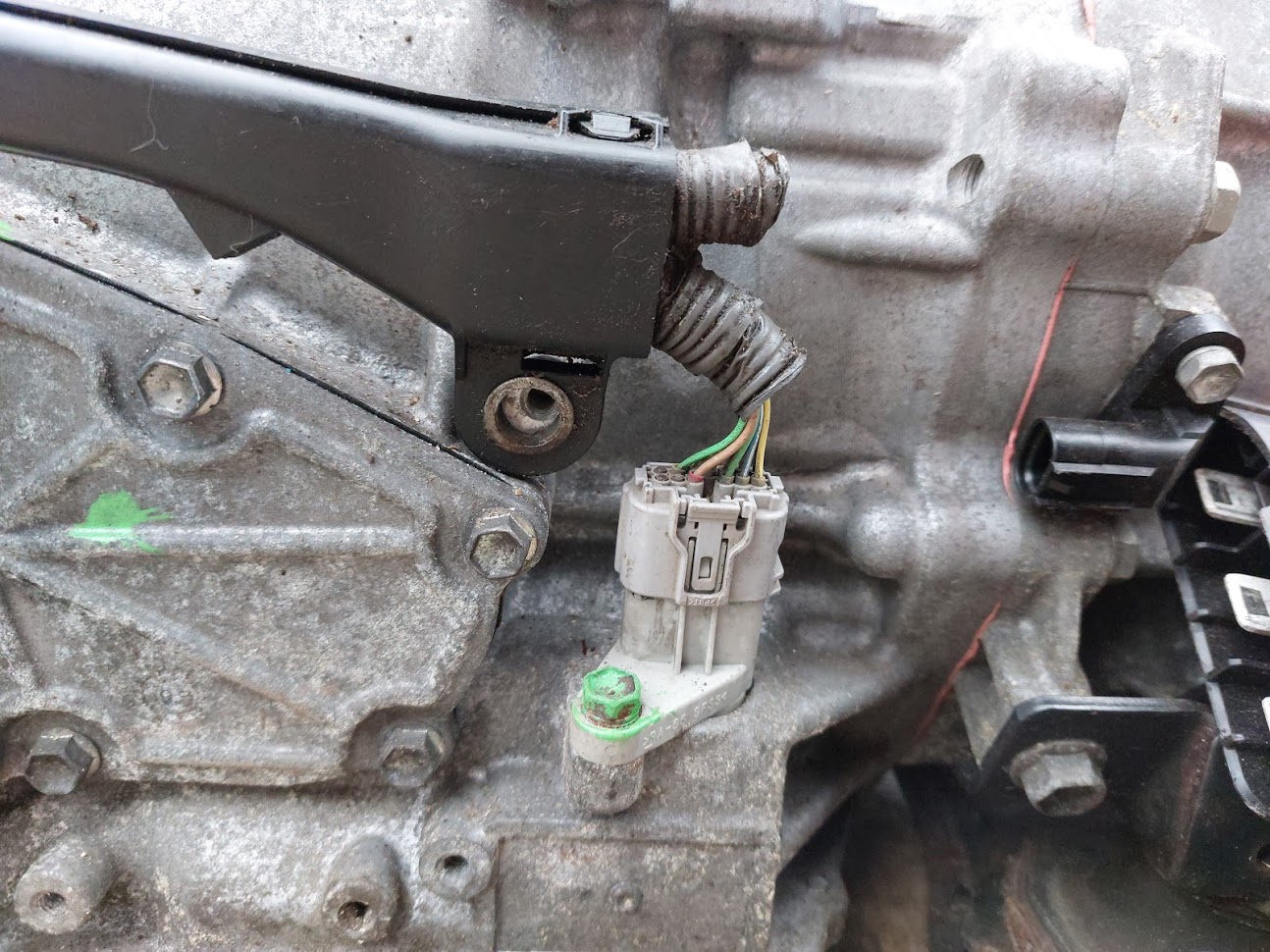

The VSS is the rear most connector on the left side of the transmission, see pic. It's the black sensor with the bright white connector in this photo:
Here's a link to the two wire connector:
https://www.ebay.com/itm/173489472416?e ... %3A2334524

PatrcioEV-ATX wrote: Sun Sep 26, 2021 5:44 pm The VSS is the rear most connector on the left side of the transmission, see pic. It's the black sensor with the bright white connector in this photo:
Yes, I've noticed it today. Unfortunately my harness missing that particular connector for some reason. I guess I'll find something to replace it. Thank you for the link.
Or I'll use original E36 signal from the differential.

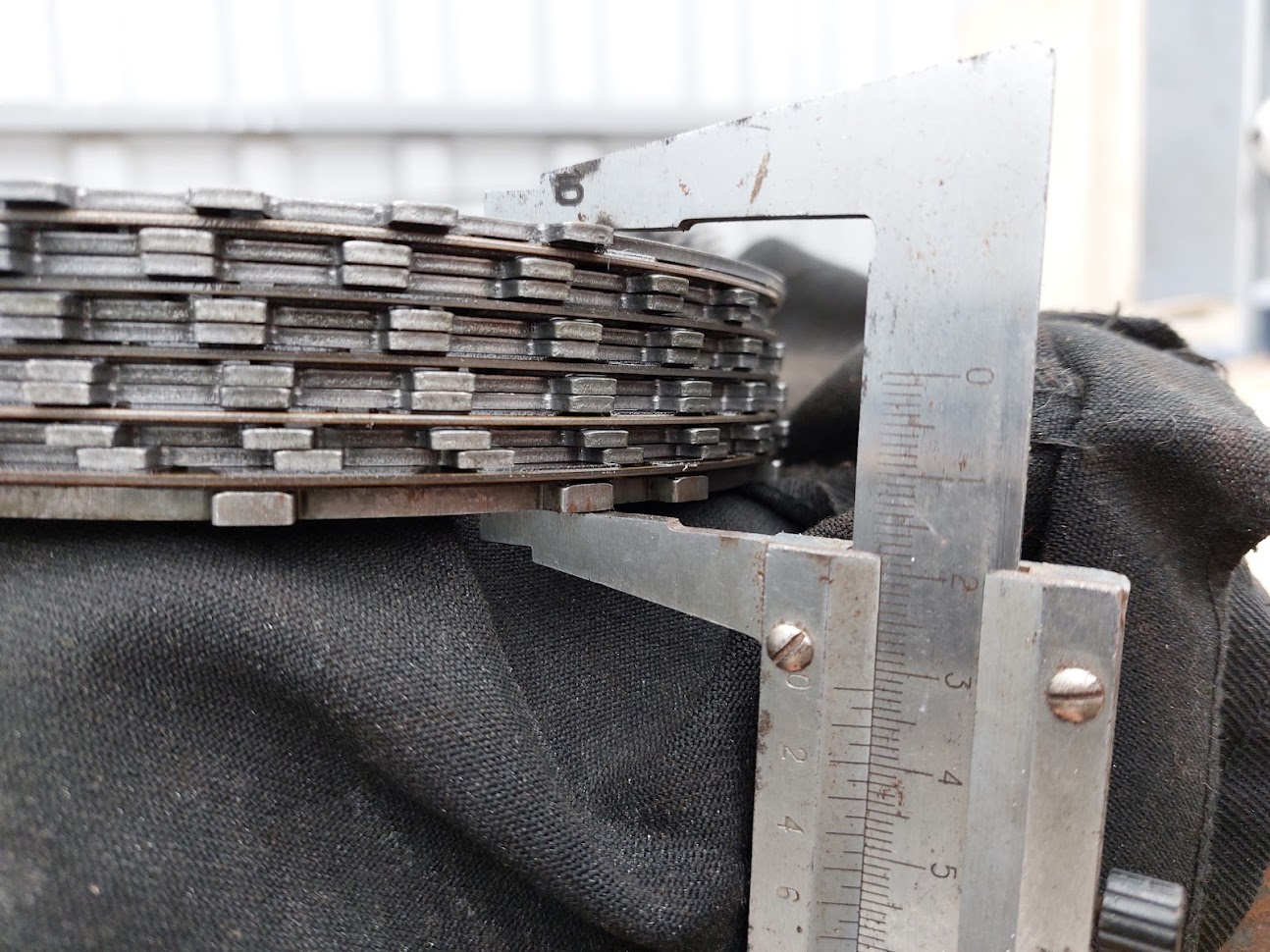

I disassmbled that two-step planetary thing with hard to pronounce name, and took measurements of clutch discs of high range. I will not place a dxf drawing here yet. First I need to make sure that measurements are taken correctly.
Clutch pack thickness is 32mm, so I'll make three 10mm steel rings, to replace the pack.

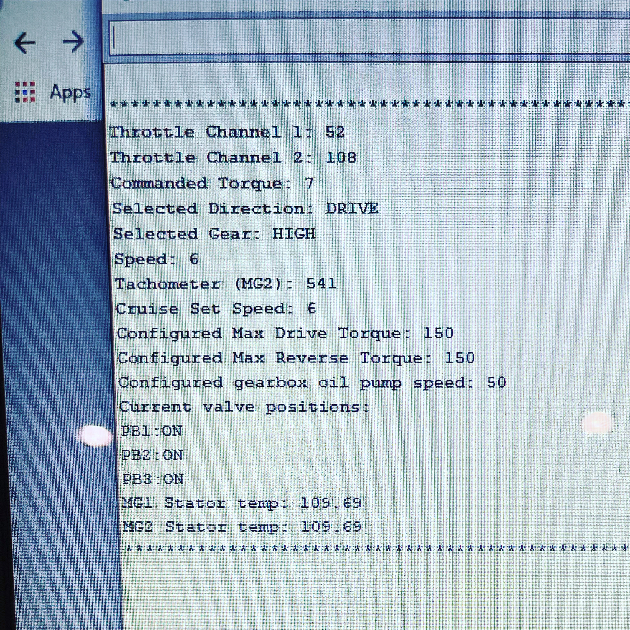

So, very rudimentary cruise control is working.
Video:
https://www.instagram.com/tv/CUdixgLACK ... =copy_link
2012 Nissan Leaf (sold)
2016 Mercedes B250e (sold)
2023 Volvo C40

Bryson wrote: Thu Sep 30, 2021 11:04 pm Awesome! Which pin did you use for input?
Brake_In. It’s very basic right now and is only holding a set ThrotVal when engaged.
Update: I’m able to engage (on long press) and disengage (on short press) cruise control and I’m able to manually accelerate while cruise is engaged and then rest back at cruise. I’m also able to rengage at a higher speed. When engaging, I’m setting a cruise set speed (MPH), a set value for ThrotVal (torque), and a set value for the analog read of Throt1Pin.
I’m struggling to get good results with adjusting torque based on speed, which is what I would need in the real world. Assuming I can get that sorted, I’ll move the trigger to Throt2Pin and use Brake_In for brake pedal input so I can write code to disengage cruise on braking. I know Zombieverter has more in/outputs, but it would be great if this VCU had one or two more of each.

I programmed a rudimentary cruise control which just compares current speed to target speed, determines a suitable pedal position, and sets that position if the actual pedal position is lower. No idea if it works, also would need proportional control.

xp677 wrote: Sat Oct 02, 2021 7:48 pm I programmed a rudimentary cruise control which just compares current speed to target speed, determines a suitable pedal position, and sets that position if the actual pedal position is lower. No idea if it works, also would need proportional control.
Ha! Cruise would be a bit scary to test in the real world. I’m still on the bench waiting for the body shop to finish my car!
