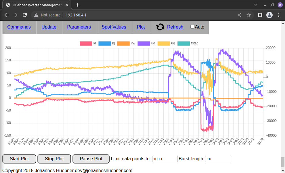

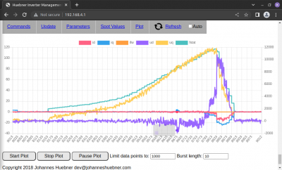

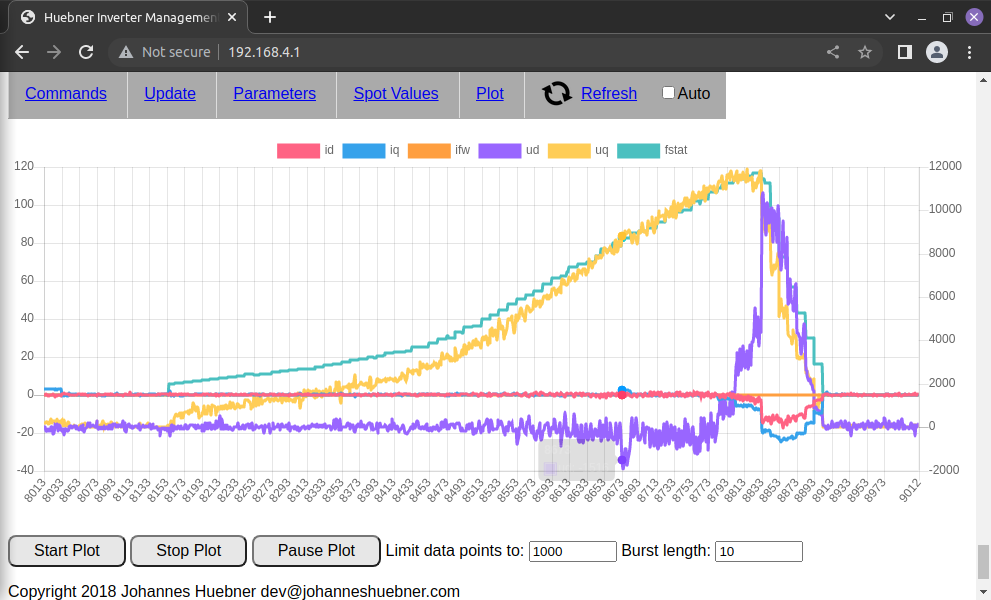

Did a new coast up and tried to do a better step but now relizing I don't know what to do to make it better.
I get odd Ld and Lq from that plot, like 3,3mH and 0,4mH or 10,9mH and 0,3mH.

There is not really any kind of suitable transient on Uq on the second plot. Not sure what to suggest to do differently though, maybe smaller throttle changes at more constant speed?. Correlating against the model should give better results which is why I'd like to try it. A csv version of something like the second plot could work well.
The first plot looks like it should give a good result for flux linkage though.

Pete9008 wrote: Tue Jan 10, 2023 9:52 am The first plot looks like it should give a good result for flux linkage though.
Indeed, I get 101 resp 103mW at 60 resp 100Hz so might decrease my selected parameter setting of 108 slightly to 102. Not bad.
