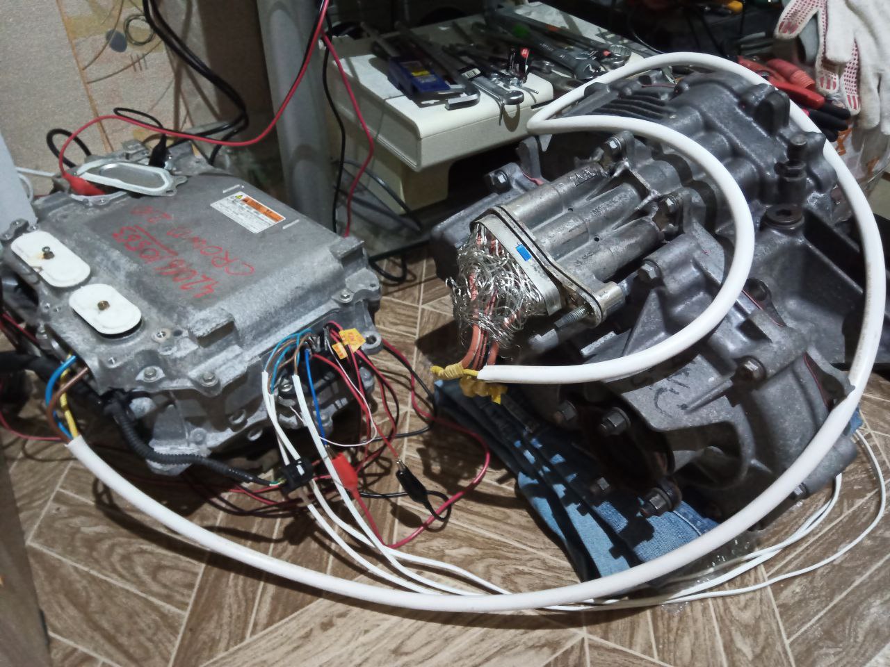

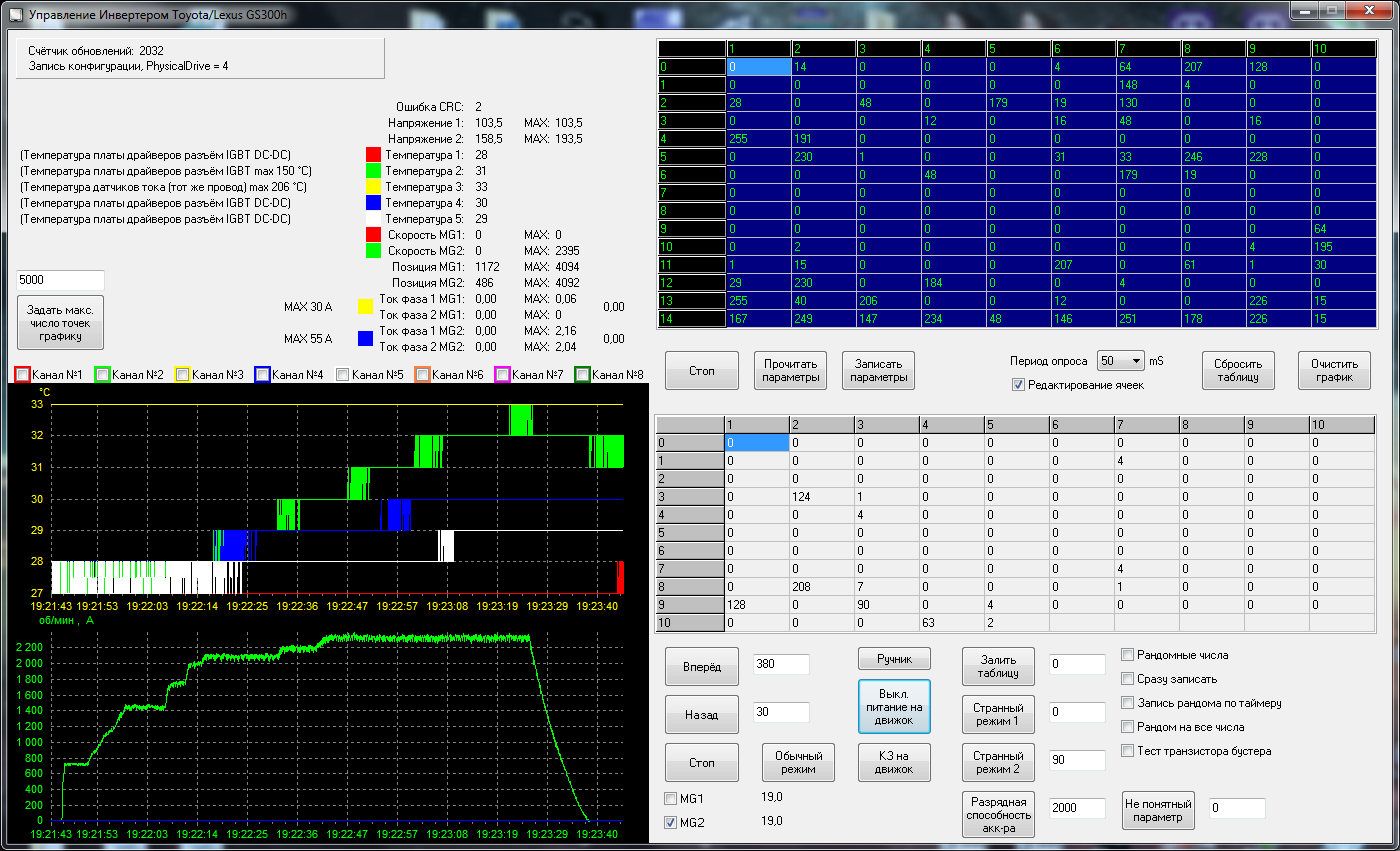

Here is the result of my experiments and observations, if anyone is interested
When power is applied to the inverter, I immediately write to it a data packet of 105 bytes in size like this:
16 byte = 4 - complete shutdown of power to transistors MG1, free run-out of the rotor.
42 byte = 4 - complete shutdown of power to transistors MG2, free run-out of the rotor.
16 byte = 8 - short circuit to the rotor windings MG1 (all three lower IGBT transistors are open).
44 byte = 1 - short circuit to the rotor windings MG2 (all three lower IGBT transistors are open).
76 byte = 4 - the upper IGBT transistor in the Boost IPM block is closed.
76 byte = 1 - the upper IGBT transistor in the Boost IPM block is open.
If 86 byte = 0, and 76 byte = 4 and change the value in byte 76 from 4 to 1, then for a split second the lower IGBT in the Boost IPM block will open, which, when powered by a 12V 3A laboratory power supply, leads to a voltage surge of up to 100V. If 86 byte = 1, then the lower IGBT transistor does not open and there is no voltage surge from the inductor. The upper IGBT transistor simply opens.
92 low byte 93 high byte affects the speed limit (I don’t know how to explain, but I’ll try). If I set 92+93 bytes = 90, then this is the best option for my gearbox; if 92+93 bytes > 100, then the motor rotor accelerates and, when reaching the maximum speed, stops abruptly, which results in a sharp jump in voltage and reverse current. Dangerous for the inverter. If 92+93 bytes < 90, then the maximum speed is reduced; if you reduce the value of this bytes down to 0, then the speed is 0.
94 byte, 3 bit = 1 - my engine works a little better, if 3 bit = 0, then a little worse, other bits have no effect. It also affects the voltage surge when the value of byte 76 changes from 4 to 1. If 3 bit = 1, then the voltage surge is smaller.
81 low byte 82 high byte - 2000 is written for my reducer.
90 byte, 7 bit = 1 - other bits have no effect, allows working with an inverter.
16 byte = 32 - looks like MG1 rotor retention (handbrake), but I'm not sure (I have the gearbox lying on the floor).
42 byte = 32 - looks like MG2 rotor retention. The hold depends on the value of 92+93 bytes.
All other bytes are 0. Except for the torque control bytes MG1, MG2 and the checksum.

A few more observations:
Engine power - received revolutions
100V 0.55A 55W - 1050 rpm
50V 2.55A 130W - 1050 rpm
This is precisely why I am so eager to launch the boost DC-DC (Boost Converter) built into the inverter.
And this is my debugging program
(Delphi7).

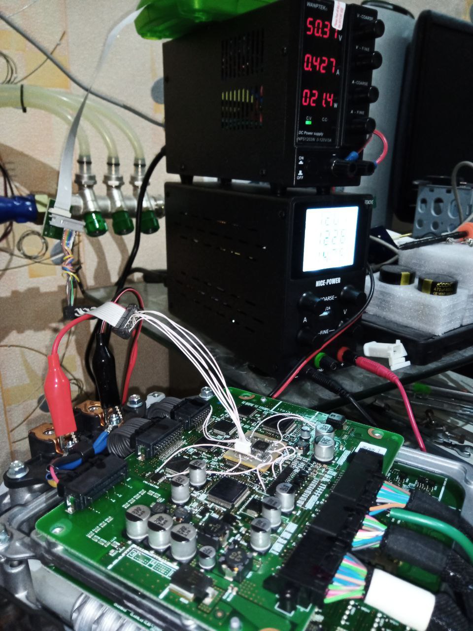

I glued the litl board, soldered the wires, put together a test code (PWM 20 kHz, 50% duty cycle, dead time 1.75 μs) and eventually Boost worked
. I think this weekend I’ll update the code to a working version.

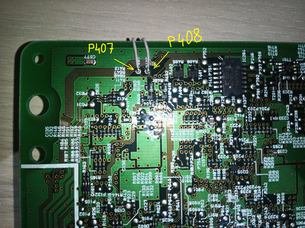

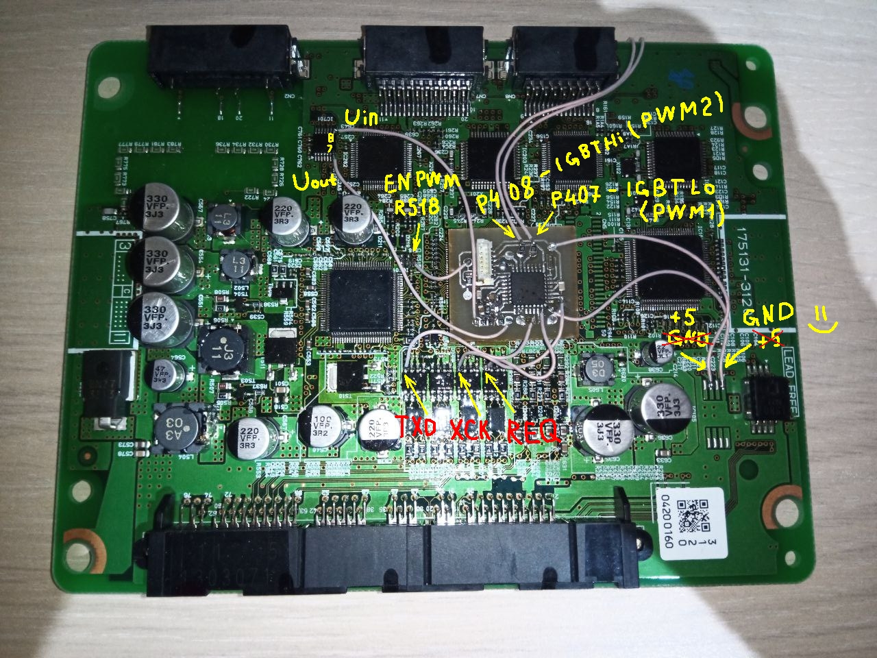

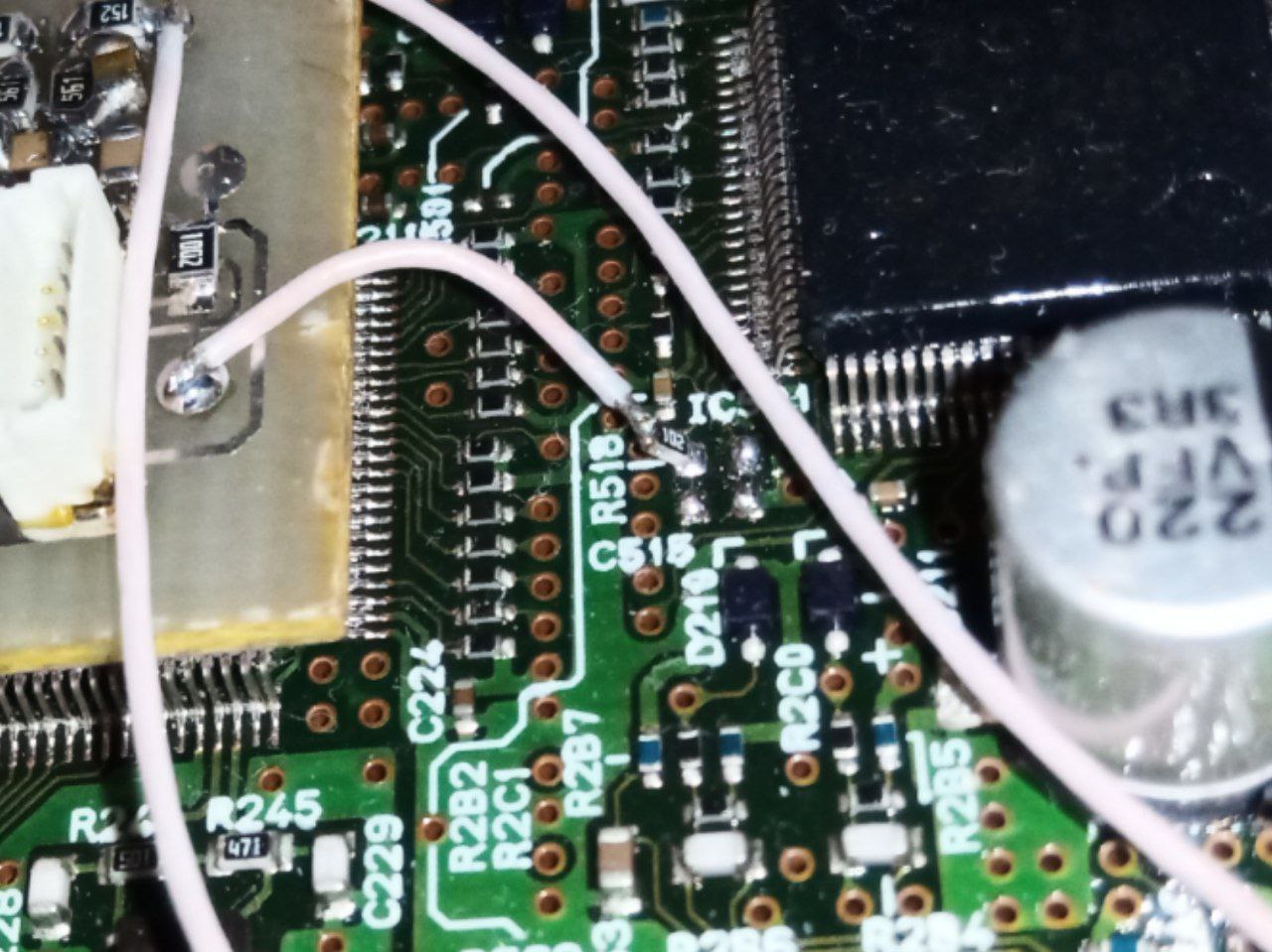

I completed the code for my inverter booster control board from Toyota Crown.
Implementation on the ATMEGA168PA-AU microcontroller, 16 MHz quartz resonator, code written in assembler.
This device is capable of stably maintaining output voltage up to 3.9x the input voltage. Operating frequency PWM 20 kHz. Feedback on the output voltage is implemented by turning on and off PWM with a decision frequency of ~10 kHz, as well as control of the PWM duty cycle on the input voltage in the range from 7.5 to 75%. Control is implemented through the native inverter interface. To do this, I used the unnecessary data field (6 bytes wide) of the management package (which is 105 bytes in size). Byte counting from zero. The 50th byte is responsible for enabling PWM. If it is equal to 1, then PWM is working. If it is 0, then it does not work and the upper IGBT transistor is closed, which prevents the back EMF from getting back into the battery and this can lead to an increase in the output voltage above the critical one and to failure of the inverter! To prevent this from happening, you need to write 3 into the 50th byte, then the upper IGBT transistor will open and the inverter will operate in normal mode without a booster, when the input voltage is equal to the output voltage and the back EMF is seamlessly absorbed by the battery. But if you open this transistor when the input voltage is high and the output voltage is zero, then the inverter may fail! The opposite is also true, if the output capacitor is charged to a very high voltage, and the input is several times less than the output and you open the upper IGBT, then this can also lead to failure of the inverter! The output voltage is set using the 51st (lo) and 52nd (hi) bytes. The conversion factor is approximately 1.4. That is, you need to multiply the desired voltage by 1.4 and write it into this register. The number is a positive integer from 0 to 1023 (that is, the maximum voltage is ~730 volts). Next comes the 53rd byte, the recovery voltage. I got 26 volts at voltages up to 470 volts; I have not tested at higher voltages at the moment. At higher voltages this value may be greater. It is calculated using the same formula as the output voltage. The maximum value is 255 (that is, 182 volts). Bytes 54th (lo) and 55th (hi) are the sum of the previous 4 bytes; it is used to control data integrity. The archive contains the firmware, source code, board layout, where all the contacts are labeled (file "PWM Boostera NEW.lay"), and the board from the photo is the file "PWM Boostera OLD.lay". Also in the archive are photographs of the inverter board with my comments on what to connect and where.
Доделал код для своей платы управления бустером инвертора от Toyota Crown.
Реализация на микроконтроллере ATMEGA168PA-AU, кварцевый резонатор 16МГц, код написан на ассемблере.
Это устройство способно стабильно держать выходное напряжение вплоть до 3,9x от входного. Рабочая частота ШИМ 20кГц. Реализована обратная связь по выходному напряжению методом включения и выключения ШИМ с частотой принятия решения ~10кГц, а так же контроль скважности ШИМ по входному напряжению в пределах от 7,5 до 75%. Управление реализовано через родной интерфейс инвертора. Для этого я воспользовался не нужным полем данных (шириной 6 байт) пакета управления (размер которого 105 байт). Отсчёт байт от нулевого. 50й байт отвечает за включение ШИМ. Если он равен 1, то ШИМ работает. Если он равен 0, то не работает и верхний IGBT транзистор закрыт, что не дает обратному ЭДС попасть обратно в аккумулятор и это может привести к превышению выходного напряжения выше критического и к выходу из строя инвертора! Что бы этого не произошло, в 50й байт нужно записать 3, тогда верхний IGBT транзистор откроется и инвертор будет работать в штатном режиме без бустера, когда напряжение входное равно выходному и обратная ЭДС беспрепятственно поглощается аккумулятором. Но если открыть этот транзистор, когда входящее напряжение высокое, а выходное равно нулую, то инвертор может выйти из строя! Так же справедливо обратное, если выходной конденсатор зарядился до очень большого напряжение, а входное в разы меньше выходного и вы откроете верхний IGBT, то это так же может привести к выходу из строя инвертора! Выходное напряжение задается с помощью 51го (lo) и 52го (hi) байтов. Коэффициент пересчета примерно 1,4. То есть нужно желаемое напряжение умножить на 1,4 и записать в этот регистр. Число целое, положительное от 0 до 1023 (то есть максимальное напряжение ~730 вольт). Далее идет 53й байт напряжение рекуперации. У меня получилось 26 вольт при напряжениях до 470 вольт, при более высоких напряжениях на данный момент не тестировал. При более высоких напряжениях это значение может быть больше. Пересчитывается по той же формуле, что и выходное напряжение. Максимальное значение 255 (то есть 182 вольта). Байты 54й (lo) и 55й (hi) это сумма предыдущих 4 байта, по ней контролируется целостность данных. В архиве прошивка, исходный код, разводка платы, где подписаны все контакты (файл "PWM Boostera NEW.lay"), а плата с фотографии это файт "PWM Boostera OLD.lay". Так же в архиве лежат фотографии платы инвертора с моими комментариями, что и куда подключать.

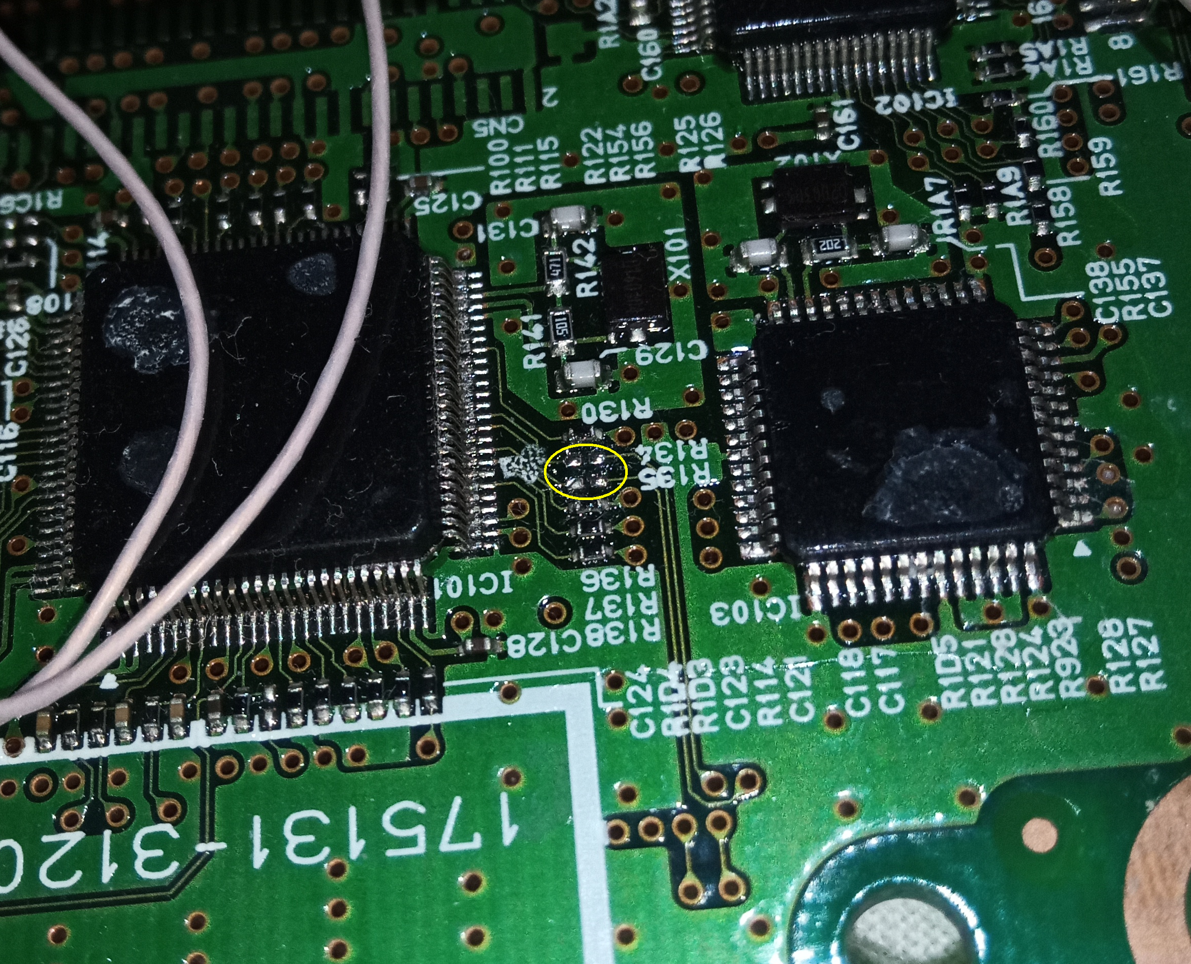

I forgot to mention about removing two resistors R134 and R135 from the inverter board. A week ago, an oscilloscope came to me and foolishly hooked its probe to the inverter board and burned the inverter and my PC
. I just repaired everything. Batteries should arrive by summer.

Please show your whole setup. Like what is providing your power for the inverter?
Also details on the wiring.

are the 2 connectors not different ?Marvin wrote: ↑Sun Oct 13, 2024 1:55 pm Hi together,
I tried spinning up my L210 with the G9200-30132 Inverter. The Inverter came from UK so likely RHD and the Transmission from Europe LHD. Does someone know if the same case applies like for the L110 that the phases are swapped? As written in the Wiki?
All I got in terms of live was one some light stuttering for a few seconds, which I was not able to replicate. My max applied voltage was 87V.
Do I just switch phases not MG1 & MG2 connectors, right?
Thanks in advance, Marvin

Hi Andy,
Yes correct. And that is how I have it connected.
I was referring to this section in the wiki. https://openinverter.org/wiki/Lexus_GS450h_Drivetrain
„ If you combine a LHD transmission with a RHD inverter (or vice versa) you might end up with a motor that is juddering, not spinning. IN this case you need to swap any two phase cables of both MG1 and MG2.“
I will need to ask someone to get some photos as i am not close to the workshop right now. But let’s imagine i wired everything up as intended. At least that is what i tried to do.
In software i am in run mode & drive selected. Inverter Status is On. Throttle is calibrated with pot min & Max
I applied 87V DC via somw battery modules which are connected via the SBox which to my delight was easy to integrate and an audible contactor closing is happing when start is pressed.
Ground is conneced on the inveter. Motor ground might need ro be improved. (Is that a common issue)
Lastly the little black cable and plug seen in the front right of your photo andy. Is that to be connected or is ghat for the buck controller? I cannot find any infos on it. Nor see it connected in any videos.
Thanks for the swift help.
