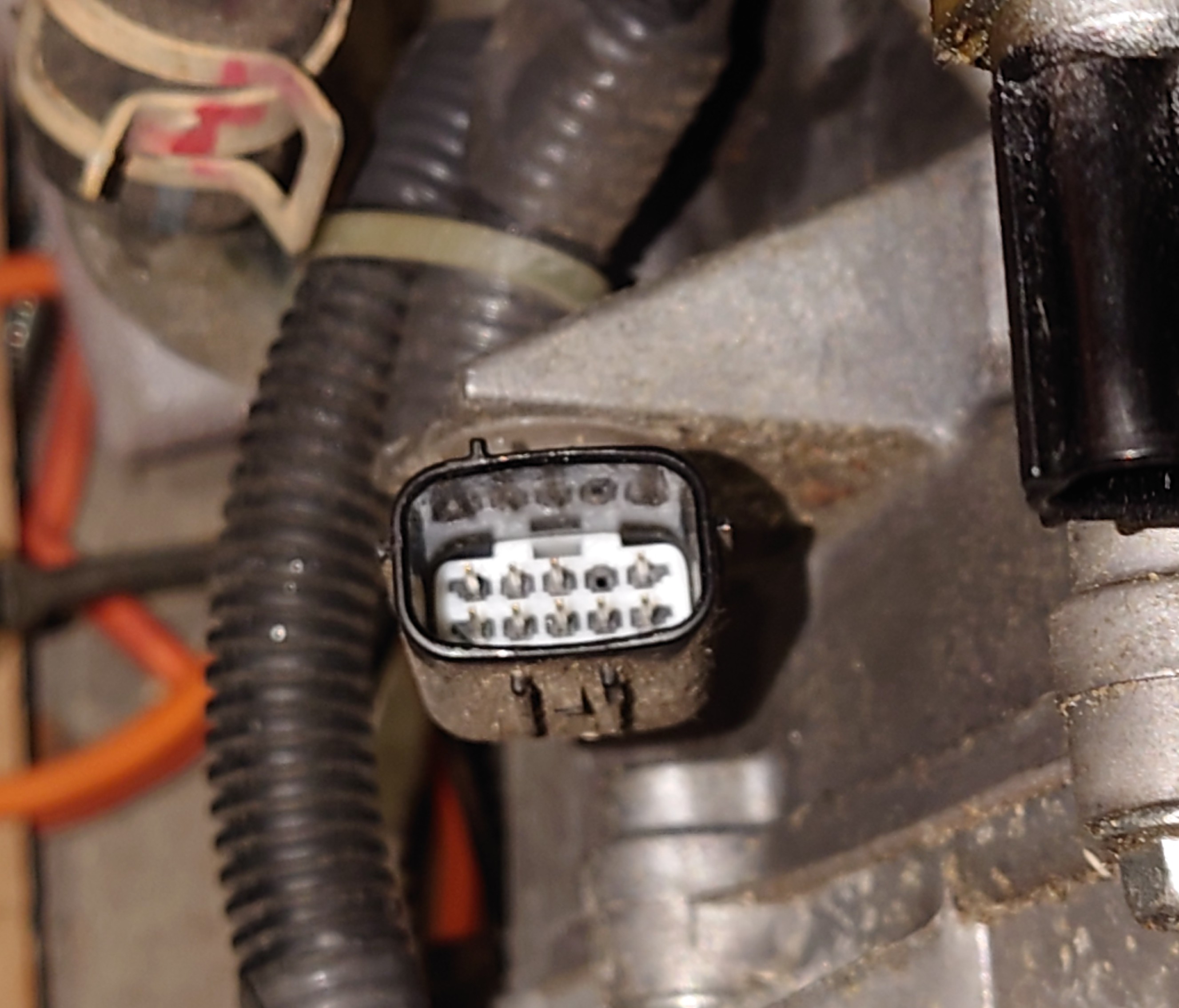

Damien, could you be so kind and tell us the pinout for the front inverter's plug (power supply and CAN bus) The colors of the wires will be enough. I still have the 10-pin connector here. I'm almost sure this is Toyota 90980-12380.

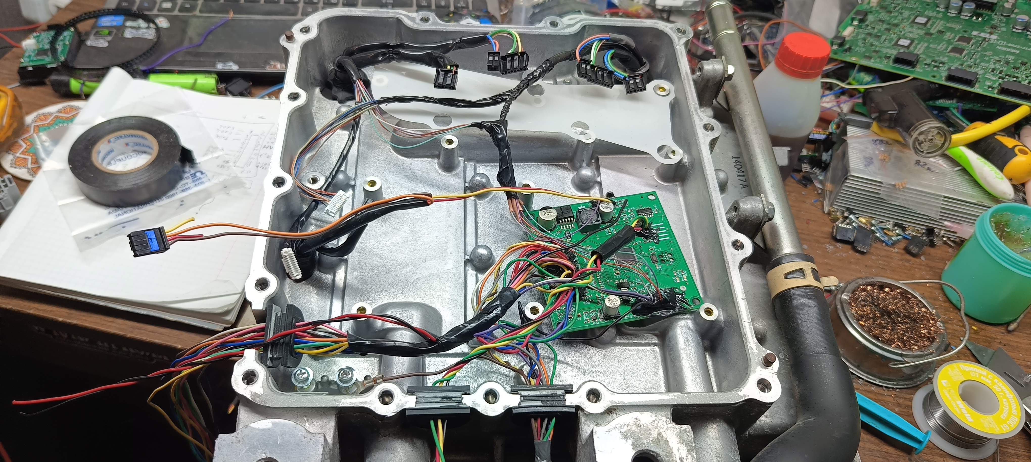

an interesting feature, today I combined the outputs of two power modules in the front outlander inverter into one, but I left the current sensors for only one module! thus, I deceived the system, the brain of O.I. V3 thinks that, for example, only 100 amperes at phase 1, but in fact exactly the same number of amperes is added from the second power module.
ideally, now this controller consists of a dual power module with a nominal value of 650 volts and 1200 amps, it seems to me that you can get a lot of power.
a little later, I will come up with all the necessary switching more culturally and a new cover for the inverter, install it on the car for testing and create a separate topic on this occasion.
Now I want to draw attention to one oddity - when the motor is connected to one half of the inverter (one power module), the motor has 2300 rpm and the syncofs 47700, if the motor is connected to the second module, it will be the same.
but when I connect two in parallel, the syncofs require 50500 and even the maximum speed is 2550 rpm!!!
in all these cases, the attenuation current is 0
one brain controls two power modules in parallel by taking current information from only one current sensor.
by the way, no spacers are required, if you solder the wires directly into the board, then everything fits perfectly under the native board of the inverter.
