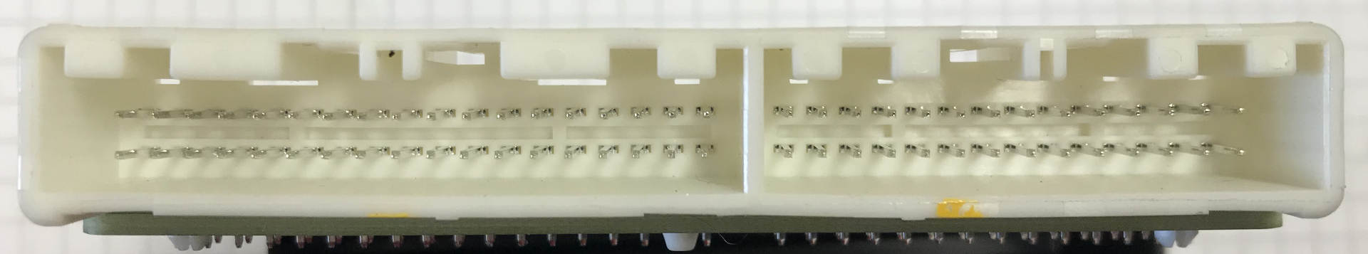

Did some reverse tracing and measurement today.
Looking at the connector as shown in below picture.
The pinout as I could trace it.
Very similar to the Kia Niro PHEV modules that is described in the start of this thread.
Also, when viewing from the bottom side, the chip closest to the connector is the lower voltage chip. Everything seem to be mounted so the boards should be possible to use up to 12S on each chip, 24S in total per pcb.
Each chip can handle 2 temp sensors per piece but usually only one temp sensor is connector and the used postion in the connector varies.
There is a kind of loop going on with pin column 3 and 4. I never figured out how to use this for the PHEV modules but looks very similar for the e-Niro as well.
Regarding cell connections, where it says "tom" in my notes, it's swedish for blank/empty. The most left blank pin (under left 10+) should be 11+ and the right 10+ is the 12+ or highest cell pin used (if only 9S is used it would need to connect to 9+). Hence 10+ in this case as only 10S is used.
Have done a setup, only needs code tweaking, to test communication with the chips. Will report back when tested.

Wow! That's quick! Top job, txs for sharing.
EDIT: When i can i check the connections with the real 10S and 9S packs (20S and 19S). At the moment a bit of between house moving etc.

I've checked on a 20S module from the e-Niro pack. The 19S module has one less cable.
I'm able to communicate with the slave module and read out the cell voltages, die temperature as well as external temperature sensor, all while using the same hardware as mentioned in the start of this thread so I call this a big win!
@EV_Builder: Thank you for pointing out that the Kona slaves use this chip. The board I looked at first was hard to read the chip marking on and I did not find that marking and I then assumed it was a Kia/Hyundai specific chip.
