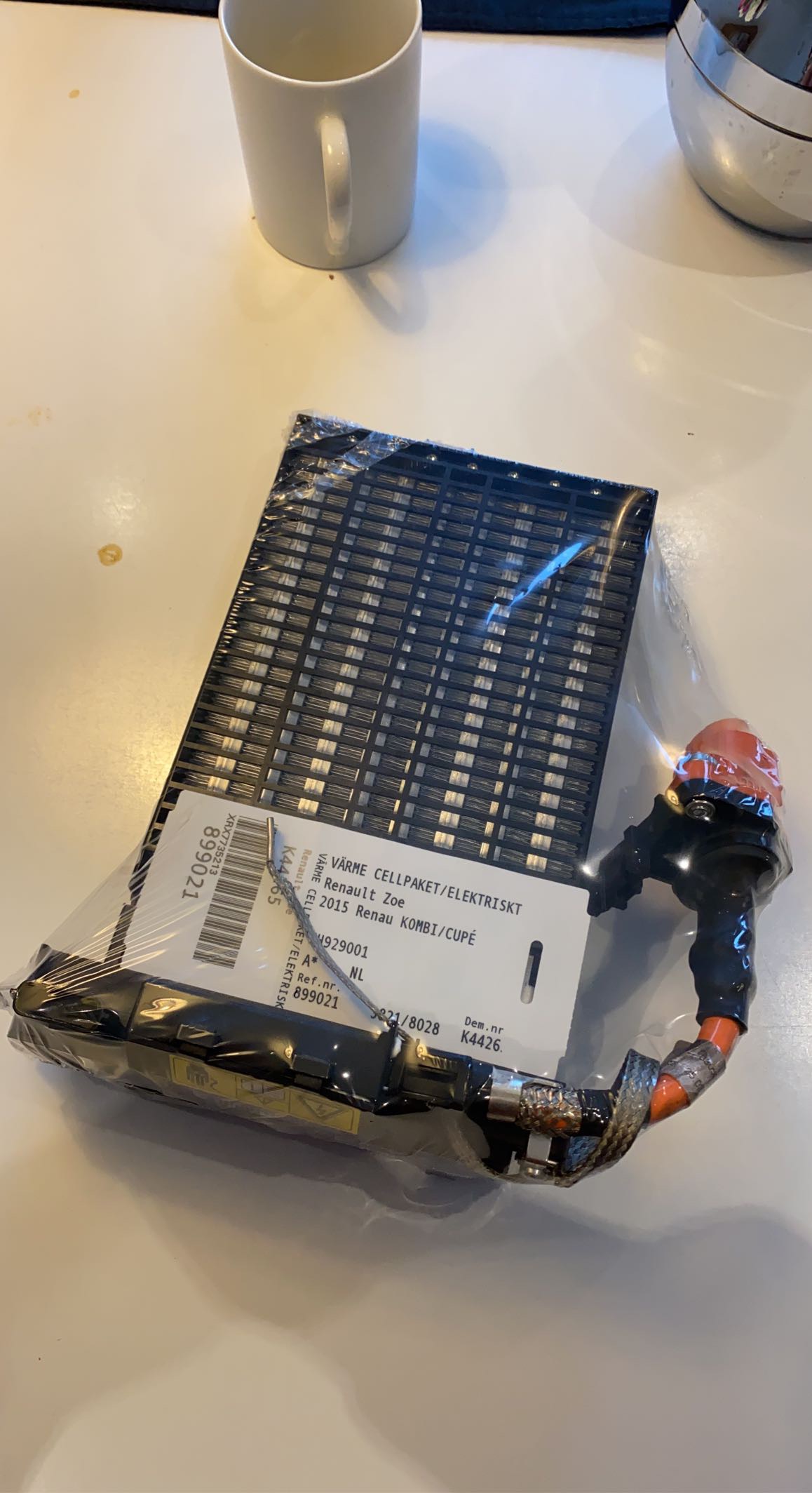

Heating. So my idea for cabin heating is to replace the original cabin radiator with a Renault ZOE ptc. These can be purchased for 100-150eu.
Located a "low speed can transceiver" "up to 125k" (TH8053) So if someone has readings of a <125k can bus on the Zoe I would really like to take a look on it=)

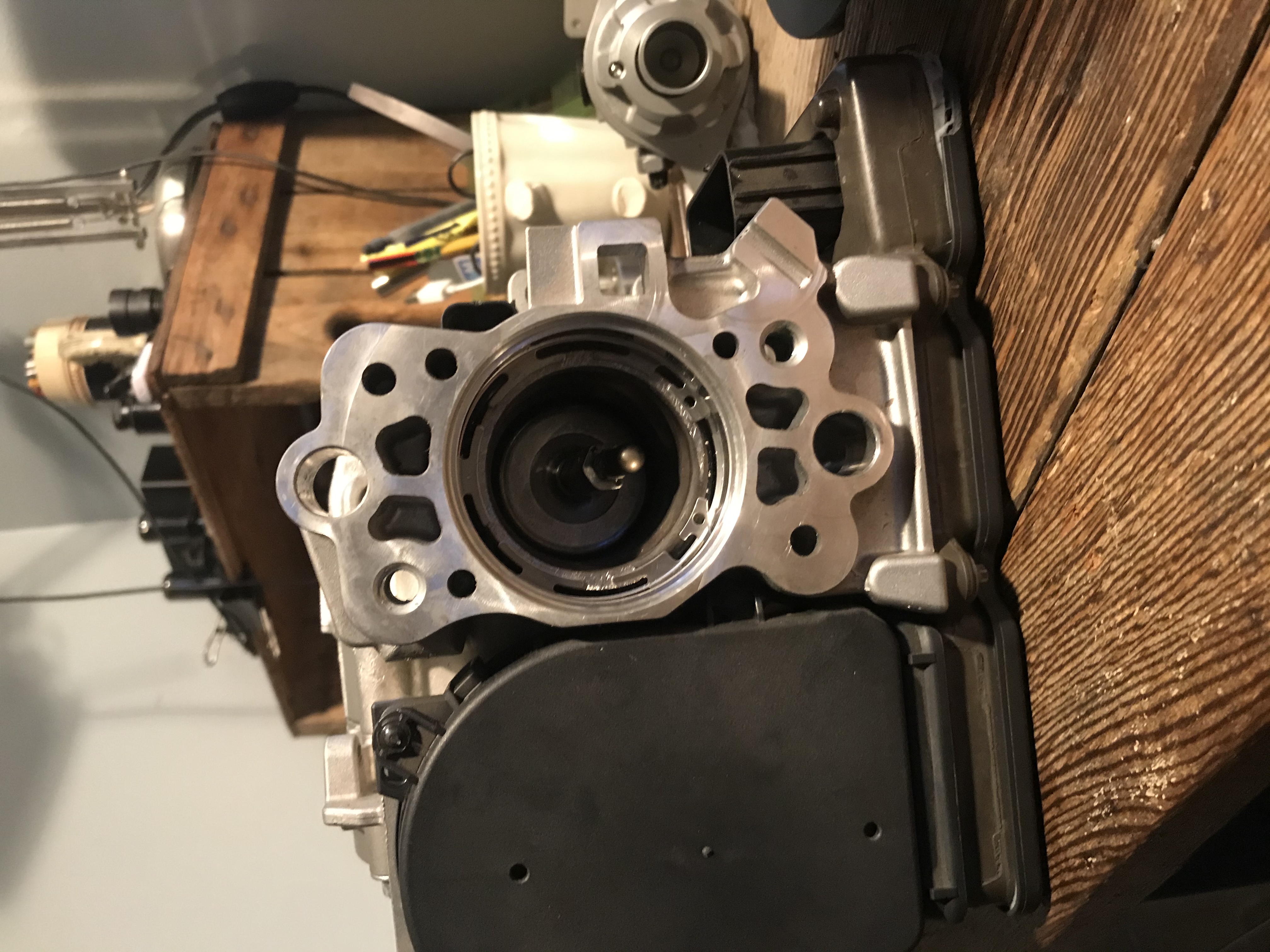

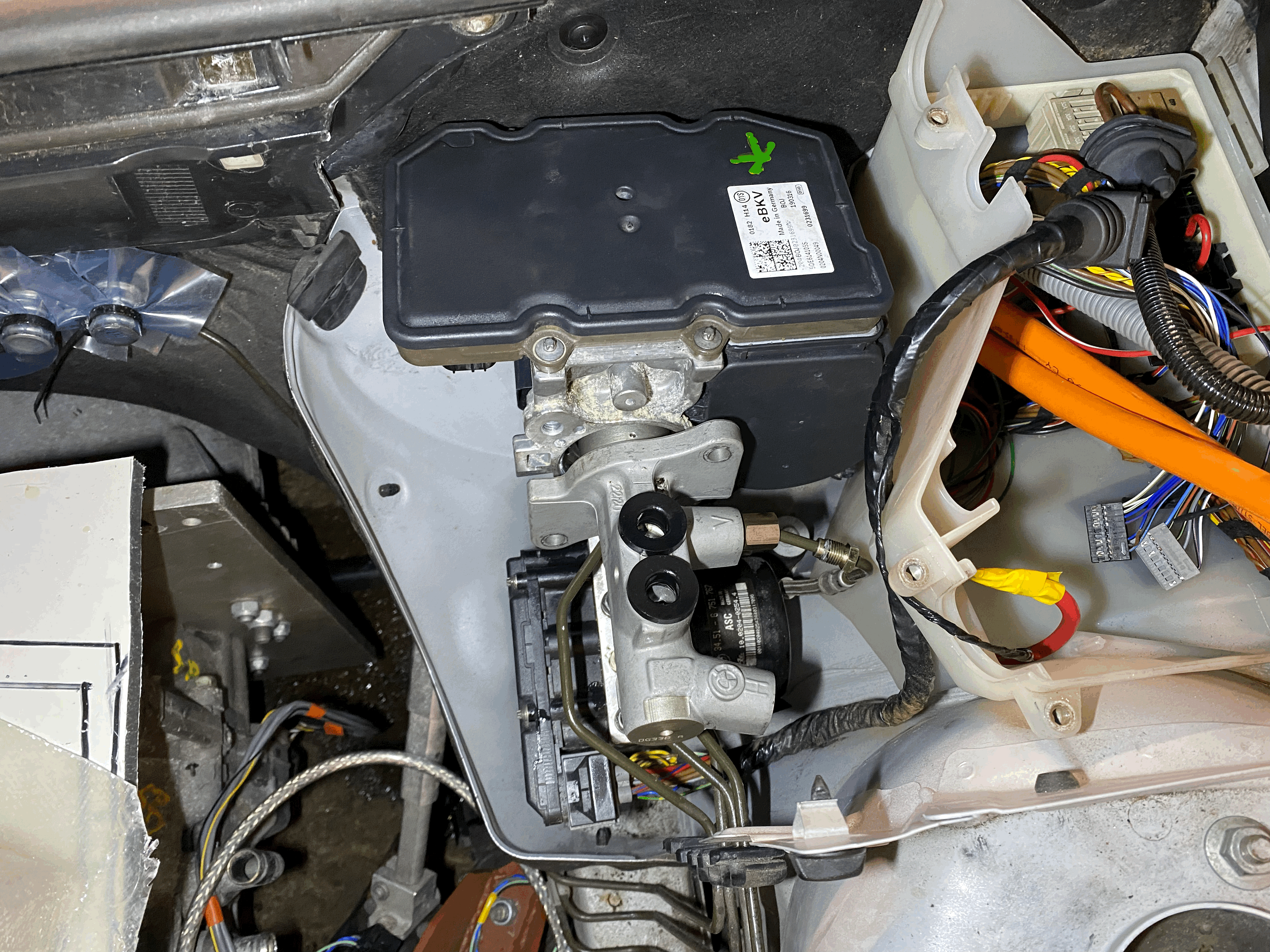

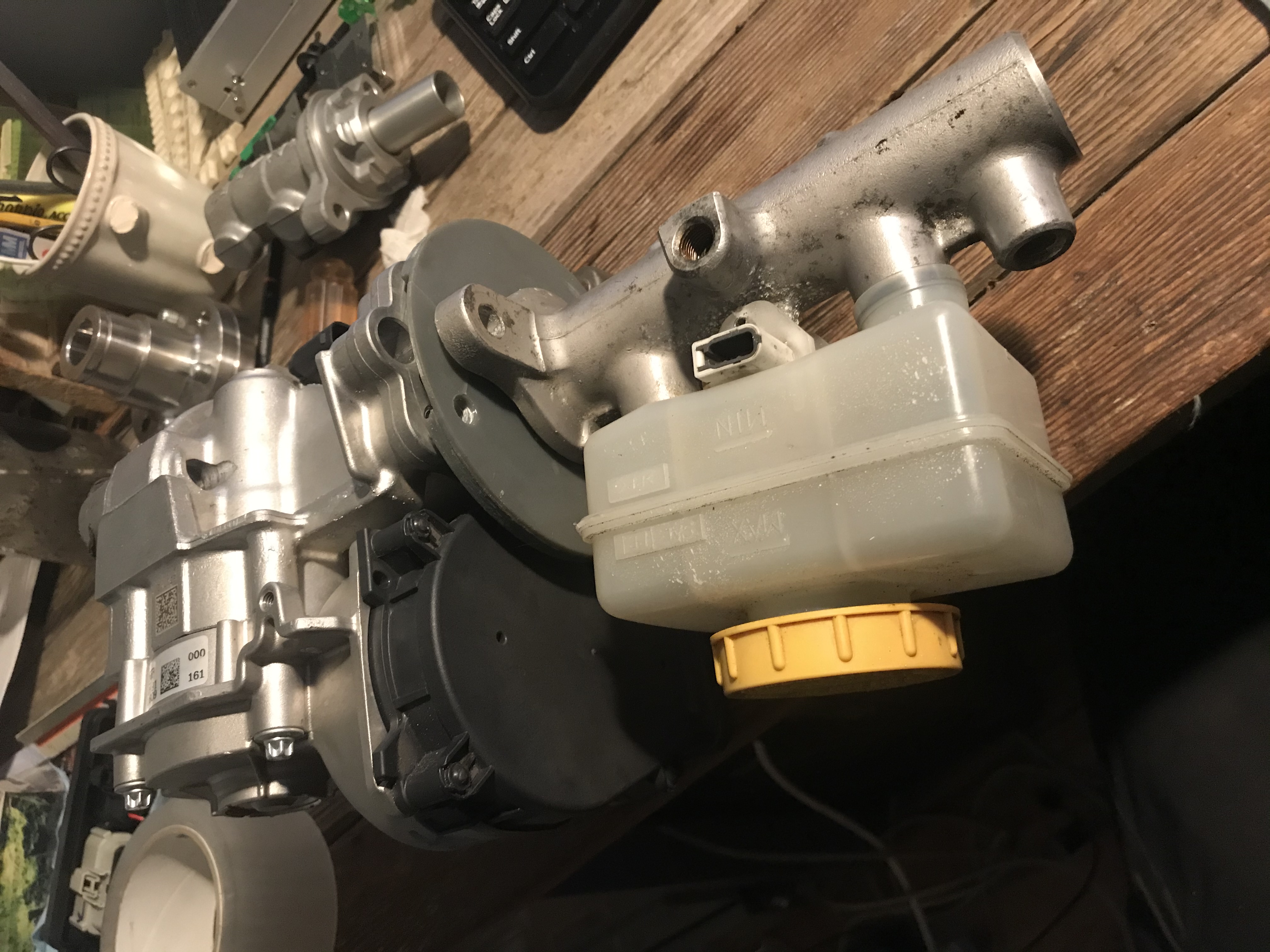

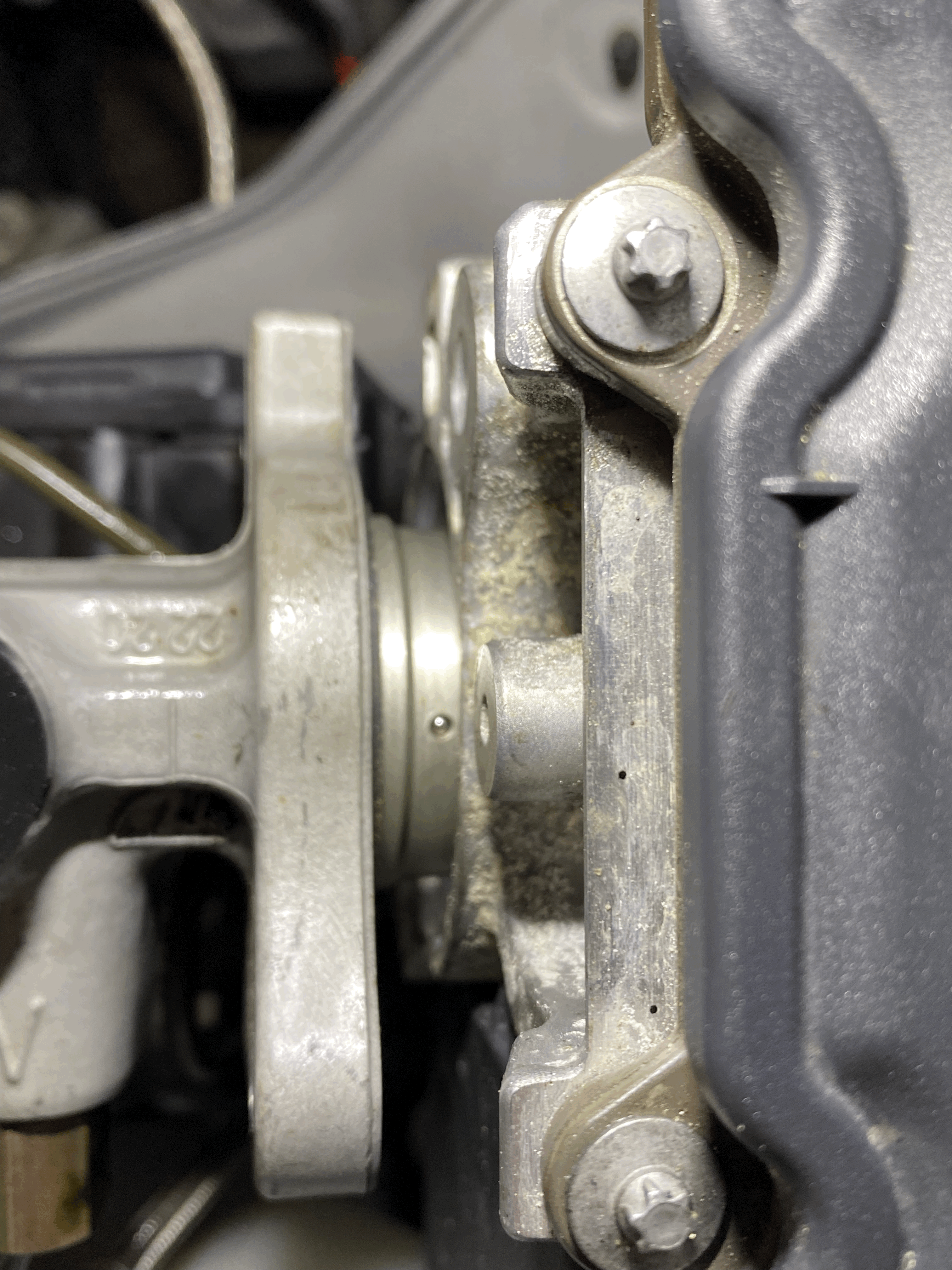

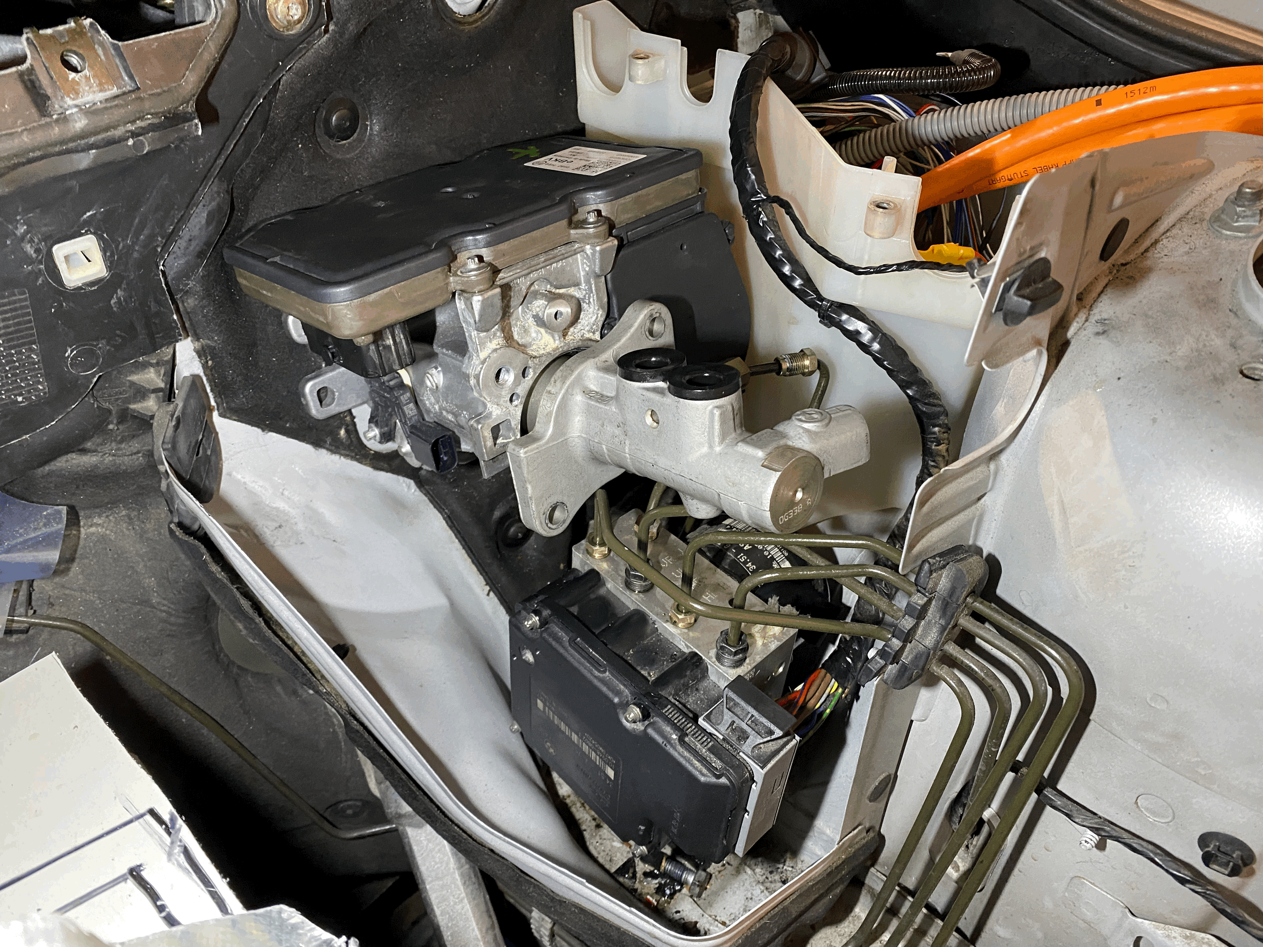

Rolled the dice and purchased a passat gte brake servo. Essentially a Tesla Gen 1 booster. And it actually seems to fit on the e46 when flipped 90° to the right wohoo
The E46 master cylinder also kind of fits on the ibooster body. Even has the same bolt pattern as the passat one so I will try to make an adapter plate compensating altered orientation thus keeping it upright. Should be pretty easy. Using the e46 master cylinder no pipe work is required saving allot of money and time.
Let me know if anyone is interested in these adapter plates. If I decide to make them in a cnc it would be affordable to spit out a couple more.
I thought about doing the same for my brat. I got a volt ibooster... so it’s huge imperial threads.. compared to the small metric ones on the Subaru. Thread on dmc talk which did exactly this, made an adapter. http://dmctalk.org/showthread.php?1621 ... post263397

Bratitude - Intresting, Imperial threads on the ibooster body?. Nice thread exactly how I'm doing it=). looks like I have to do some research on the stroke length and cylinder diameter.
Domt177 - I don't have a Tesla ibooster that I can compare with but it looks the same from pictures. Except from the end plate but that would matter in your case. Cant see how bosch would have different castings for different brands. How are you solving steering for open pilot? Also, I'm following your e46 build. Awesome. Have you managed to fit the Tesla motor in the subframe?

seems so. I went ahead and drew up a adapter for a Subaru master cylinder. first quick test print things look alright.
my volt ibooster has 2 different offset mount points for the master cylinder. but only one of the is taped. they look concentric and to be about 28degrees off level.
