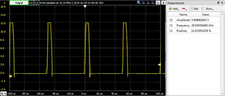

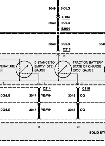

Anyone know hot to get a analog SOC gauge to work?
I'm connecting it to OUT8 (conn4 pin15) and to pin 4 on the SOC gauge.
When the SOC meter is unconnected, it show 50% (middle)
This is how it looks on paper:
The top of gauge is feed 12V (pin 11) and the bottom (pin 4) was connected to the old BMS.
I think the old output where open collector (LOW)
When connected to Simp BMS the PWM signal is getting lower (in volt) when pulse width increase.
Does this mean it is to weak to drive it?

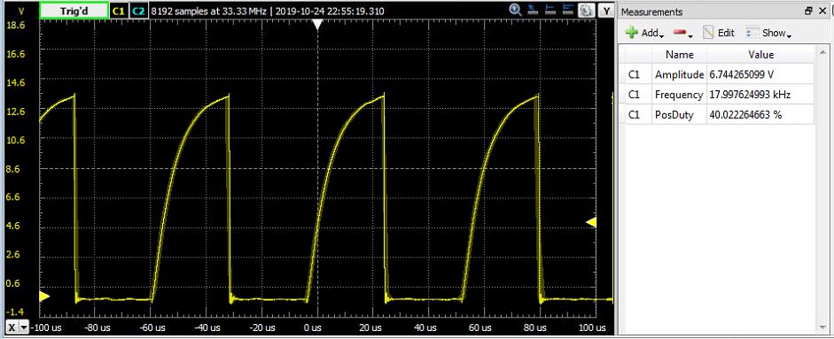

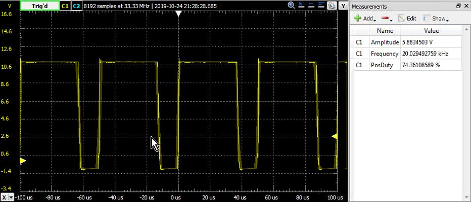

I put in the original BMS, and did some scope saves with 0% OSC and 100% SOC:
This is how it looks with simp BMS:
The SOC gauge will not go over 50% even with high duty...
Have I killed the output, or is this how it should look?
Posts: 2962
Has thanked: 330 times
Been thanked: 847 times
Re: Simp BMS
This does not look right, can you check it with just a simple 10K to 12V instead of the gauge?
I can run some tests myself, but I would need some information on what the load is of the gauge.

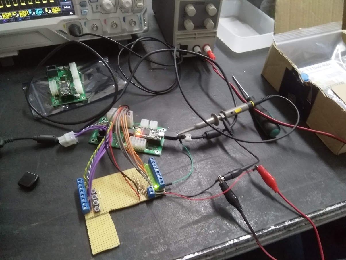

The last scope save is with 10K pullup, and no gauge connected.
Will do some test on the bench and check the PWM from microcontroller.

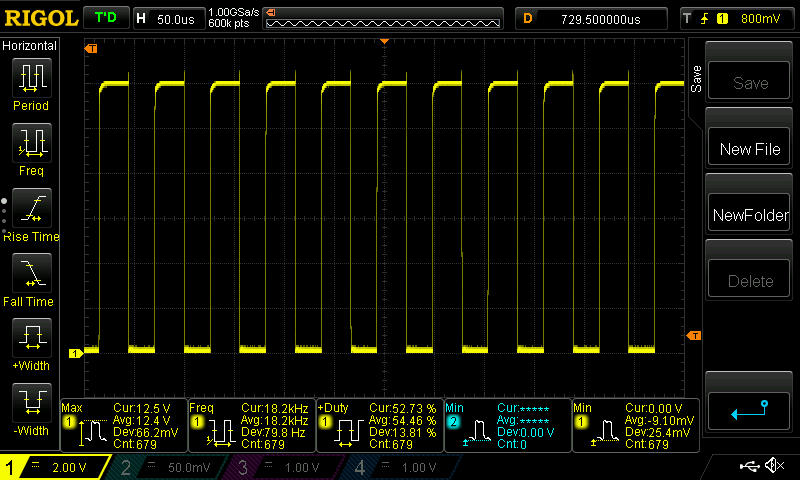

This is what a Gauge output looks like powering an LED with 550 ohm resistor.
So I would say something is wrong with your board, possibly damaged a mosfet.

Posts: 2962
Re: Simp BMS
I would say please check the control signal first with the mosfet removed.
Mosfet Part number: IRF9956TRPBF
