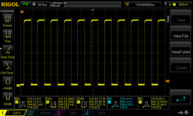

Anyone know hot to get a analog SOC gauge to work?
I'm connecting it to OUT8 (conn4 pin15) and to pin 4 on the SOC gauge.
When the SOC meter is unconnected, it show 50% (middle)
This is how it looks on paper:
The top of gauge is feed 12V (pin 11) and the bottom (pin 4) was connected to the old BMS.
I think the old output where open collector (LOW)
When connected to Simp BMS the PWM signal is getting lower (in volt) when pulse width increase.
Does this mean it is to weak to drive it?
Re: Simp BMS
Posted: Thu Oct 24, 2019 3:19 pm
by tom91
No the Simp BMS gauge output is also a grounding signal, so higher PWM duty is a lower resulting voltage.
If you try lets say a low duty and a really high does the gauge move?
Re: Simp BMS
Posted: Thu Oct 24, 2019 4:12 pm
by joromy
Yes it moves from under 0 to 50%, when I run the SOC gauge test.
If I connect it to 12V it goes over 100%, and under 0 if I connect to GND.
Re: Simp BMS
Posted: Thu Oct 24, 2019 4:43 pm
by tom91
Can you measure the resistances on that pin to ground and 12V.
Also can you use a power supply and vary the voltage to see if the gauges follows it?
Re: Simp BMS
Posted: Thu Oct 24, 2019 9:29 pm
by joromy
I put in the original BMS, and did some scope saves with 0% OSC and 100% SOC:
This is how it looks with simp BMS:
The SOC gauge will not go over 50% even with high duty...
Have I killed the output, or is this how it should look?
Re: Simp BMS
Posted: Thu Oct 24, 2019 9:33 pm
by tom91
This does not look right, can you check it with just a simple 10K to 12V instead of the gauge?
I can run some tests myself, but I would need some information on what the load is of the gauge.
Re: Simp BMS
Posted: Thu Oct 24, 2019 9:38 pm
by joromy
The last scope save is with 10K pullup, and no gauge connected.
Will do some test on the bench and check the PWM from microcontroller.

Re: Simp BMS
Posted: Fri Oct 25, 2019 9:02 am
by tom91
This is what a Gauge output looks like powering an LED with 550 ohm resistor.
So I would say something is wrong with your board, possibly damaged a mosfet.

Re: Simp BMS
Posted: Mon Nov 11, 2019 11:49 pm
by joromy
tom91 wrote: Fri Oct 25, 2019 9:02 am
Ref: PWM out to analog SOC gauge.
Will try to change the mosfet, what is part number?
Re: Simp BMS
Posted: Tue Nov 12, 2019 10:06 am
by tom91
I would say please check the control signal first with the mosfet removed.
Mosfet Part number: IRF9956TRPBF
