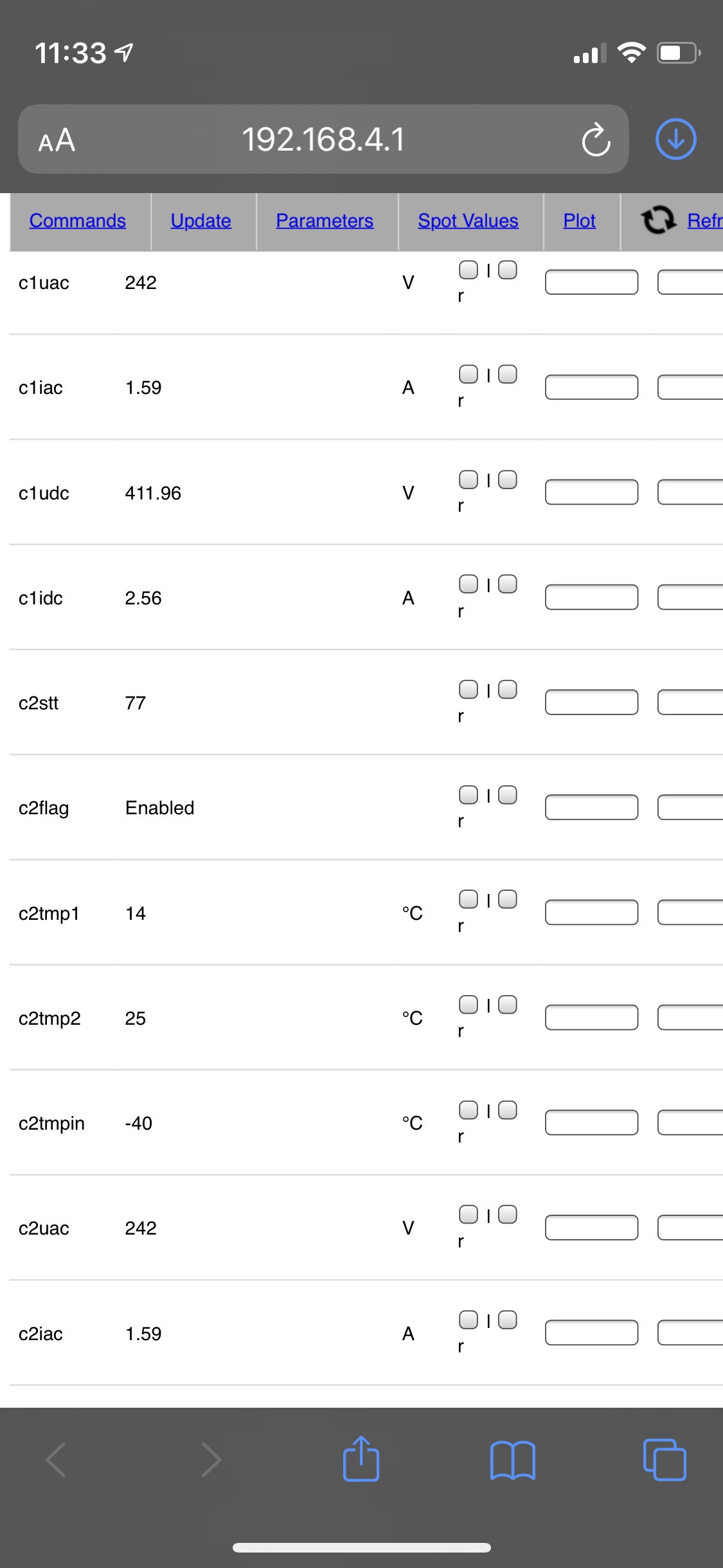

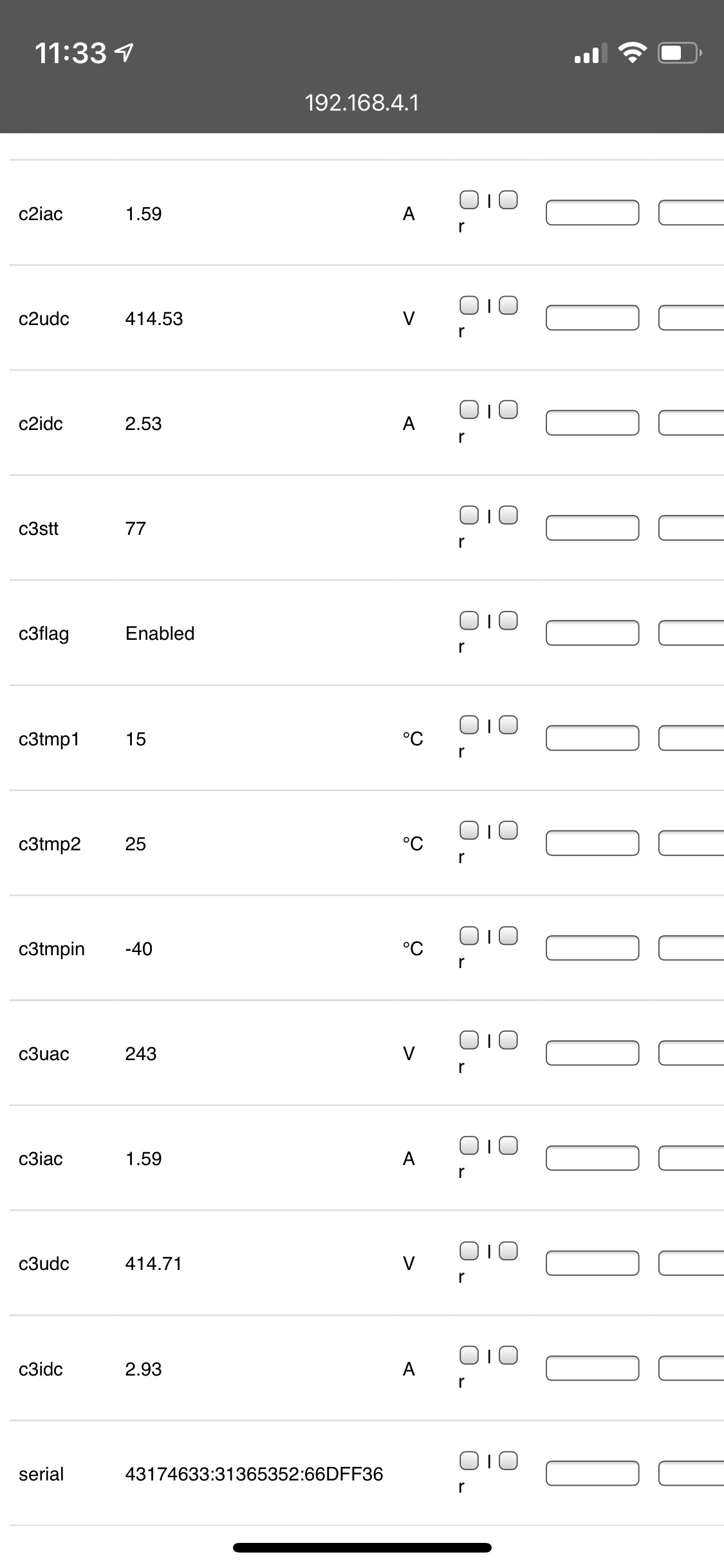

Thanks, I was able to replace the C3 cap with a 10uF that we had in the office. I believe these are 0805 as the 0603 barely fit on the footprint and was smaller than what I removed, for what it's worth.

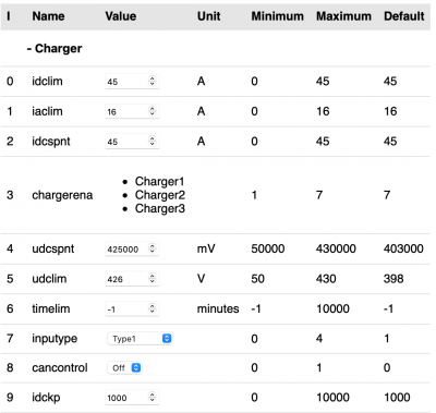

I was able to flash the software, but I'm no longer able to communicate with the USB serial link after flashing - has this been deprecated in the new firmware?
My ESP8266 WiFi has never worked properly and I believe that makes this firmware not useable for me until I can resolve that. WiFi at 192.168.4.1 has always shown '900' for all 'gauges' for me. I did have a hell of a time flashing the software to the ESP8266 on my mac, so perhaps I made a mistake there.
edit: I realized I had another ESP8266 sitting around - I programmed that one and we're off to the races. I'm able to edit parameters via the Management Console :D Very slick. The charger works great, and the 5 minute timer works exactly as advertised :) Thank you!
Here's me charging on a US single phase 240V circuit (I cycled the charger button to initiate the second charge start in the first image):

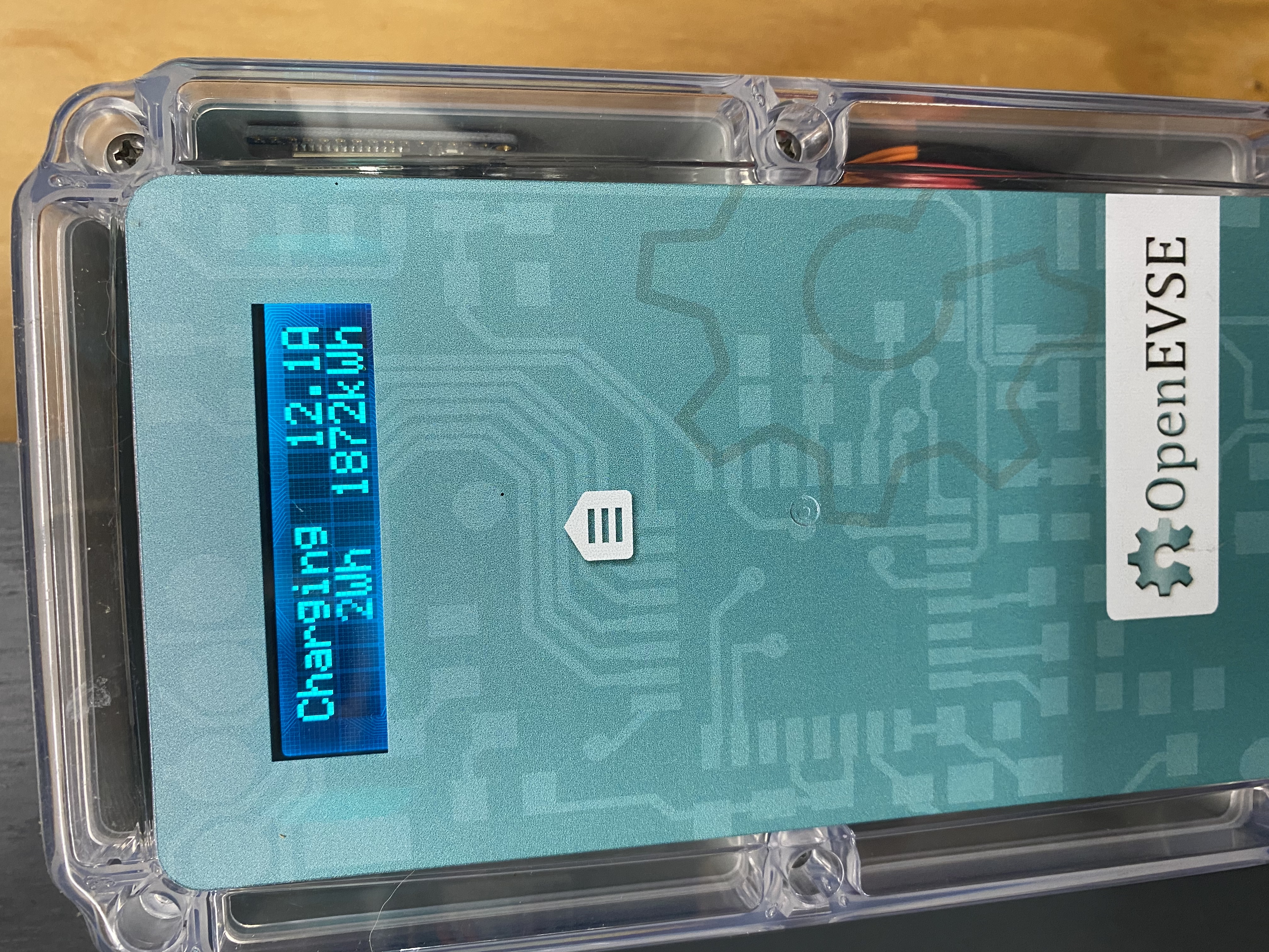

jon volk
Posts: 574
Location: Connecticut
Re: Tesla Charger alternative firmware
Post by jon volk »

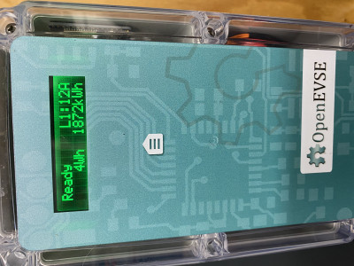

Im about to pull the car in the garage to get the cover off the charger. I can give it a go without changing the cap to save time and then pull the board if Im getting bad inputs on the ADC. It appears the openevse will accept the 120v input as well so it should be a quick reconfigure at the breaker box.

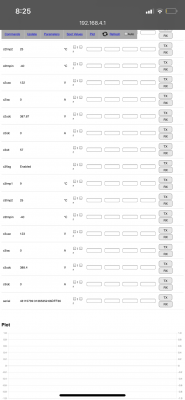

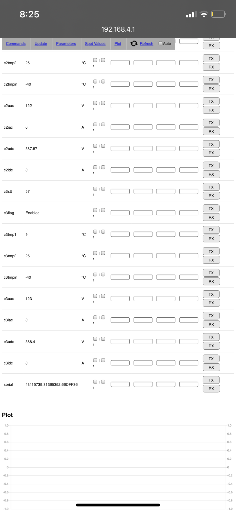

No luck today. Updated the wifi module and have the interface showing. Updated the bootloader and charger file but no parameters coming through on the interface. Need to dig in further tomorrow.
EDIT: I’m a dumbass and didn’t tag the reset button. Will configure and test power after the kids are fed,
jon volk
Posts: 574
Post by jon volk »

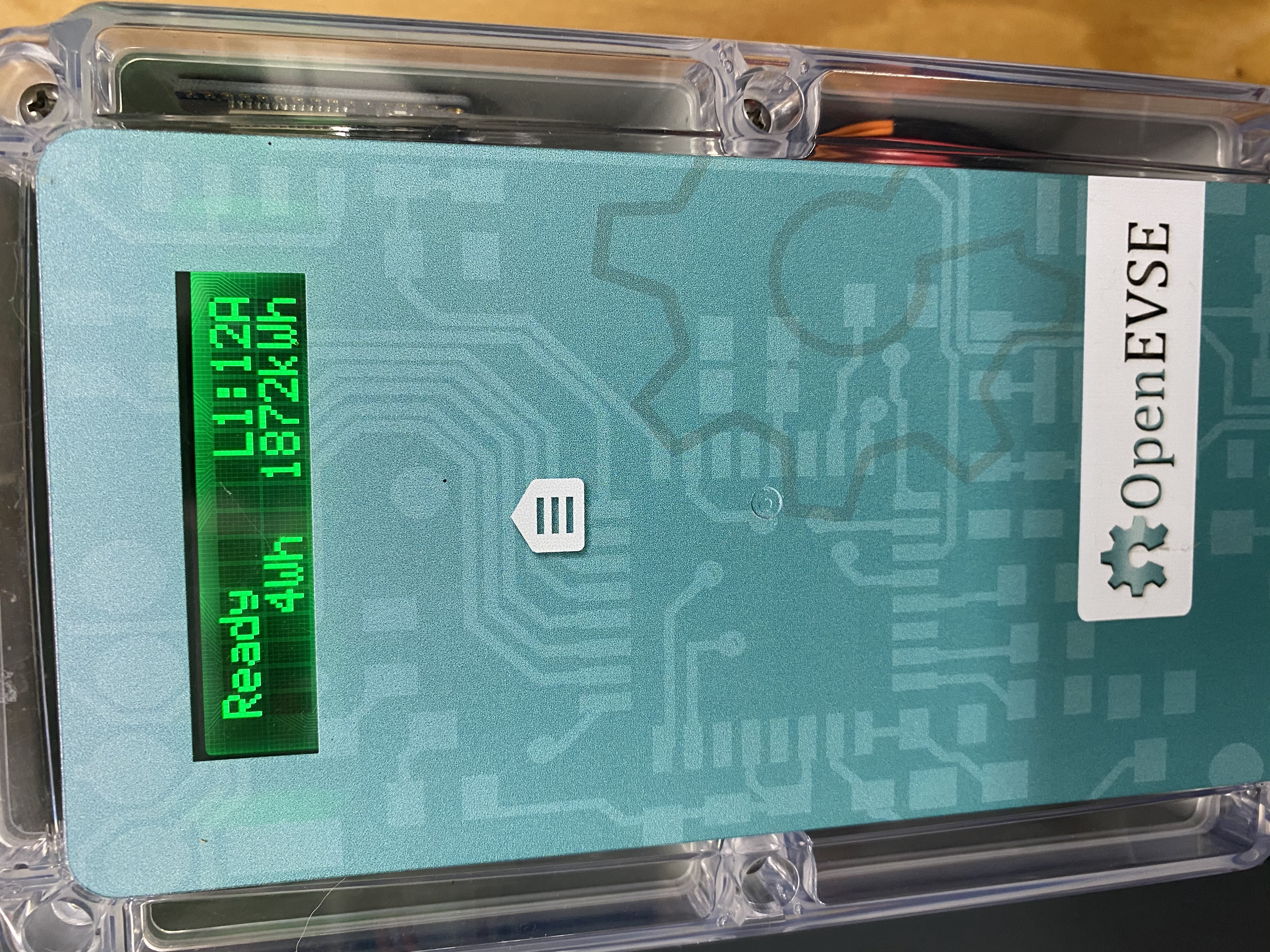

120v EVSE charging works. Correctly IDd evse set 12a limit.
Been thanked: 1918 times

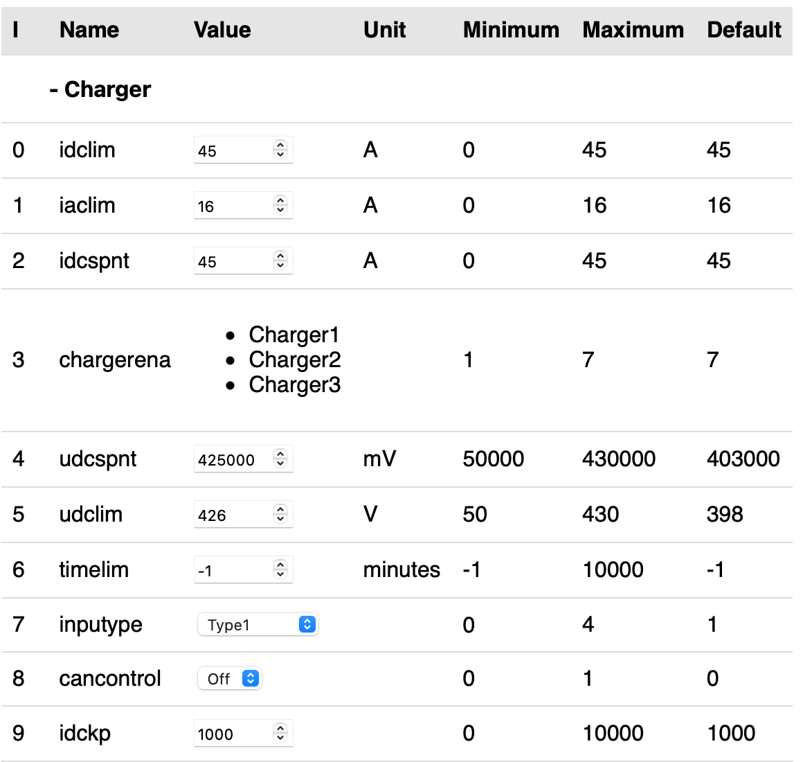

One bug found :) iaclim was limited to 16A, which limits total current on a single phase outlet to... well 16A. Even if it could provide 32A or more.
Fixed.
stm32_charger.zip
(30.74 KiB) Downloaded 361 times

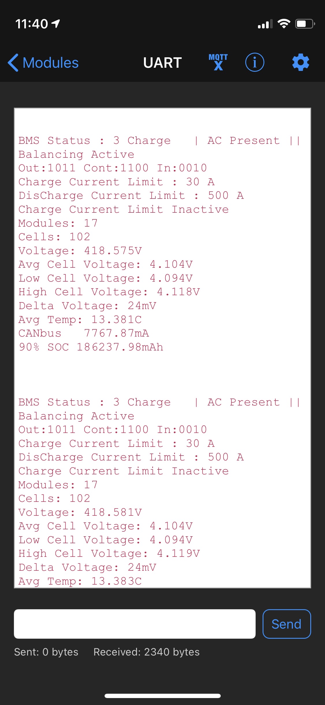

jon volk
Posts: 574
Post by jon volk »
Excellent. Now I have to go do some burnouts to drag the pack voltage below charge threshold again. Tough life.

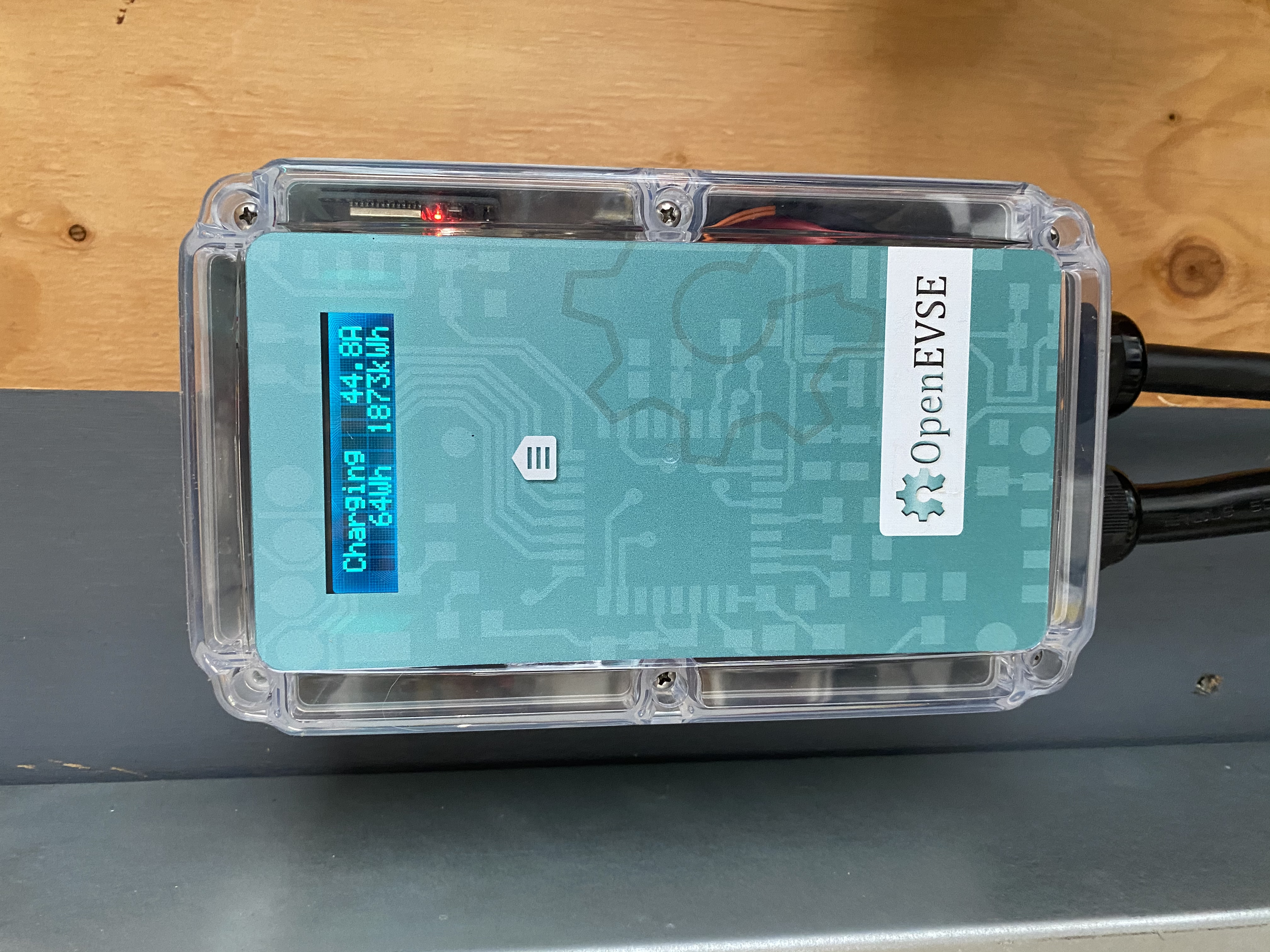

Full power charging works as expected as does the CAN transmit messages as evidenced by my water pump and dcdc turning on with the charger enabled value of 5.
Good stuff.

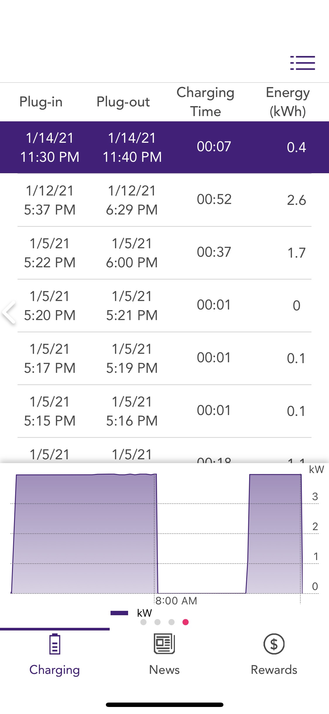

Bryson
Posts: 179
Location: California
Post by Bryson »
Mine is still charging at a steady 4kW = 16A on my 40A EVSE after the firmware upgrade. I am at 92% SOC so it may be coincidental that the taper current is the same and that’s what I’m seeing. I’ll have to drive a bunch to discharge it and try again.
