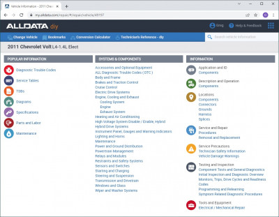

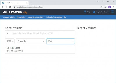

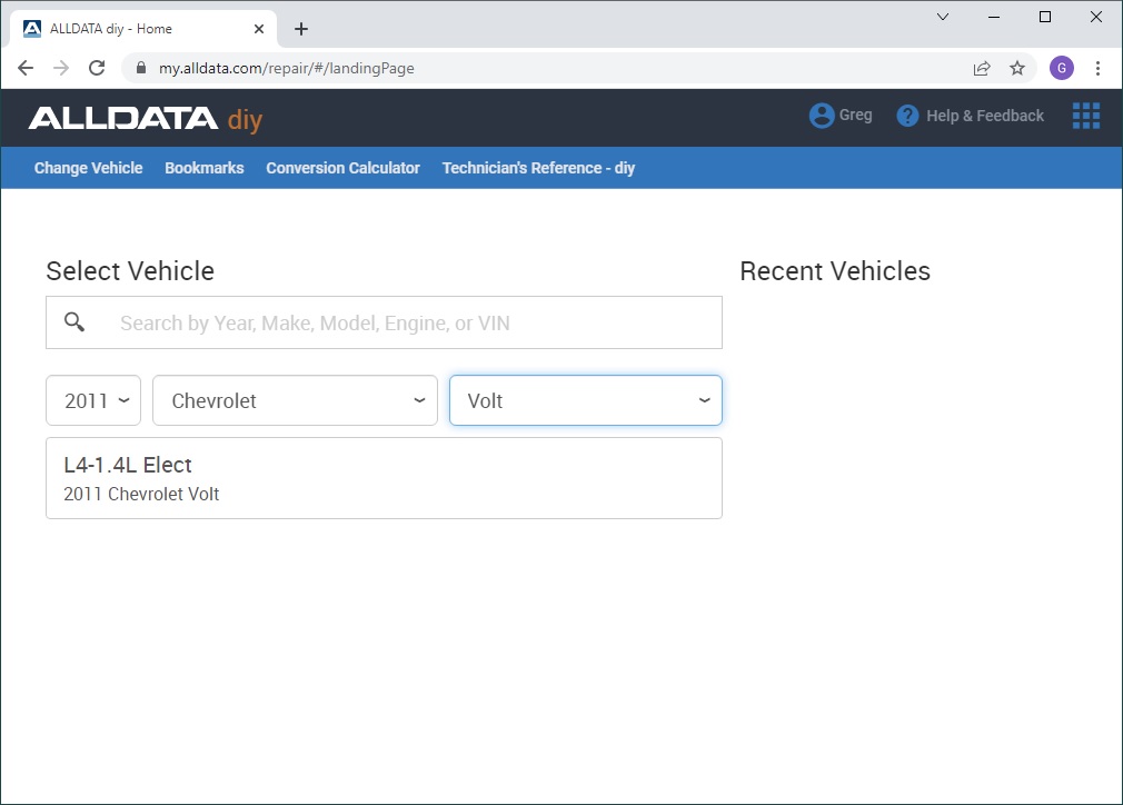

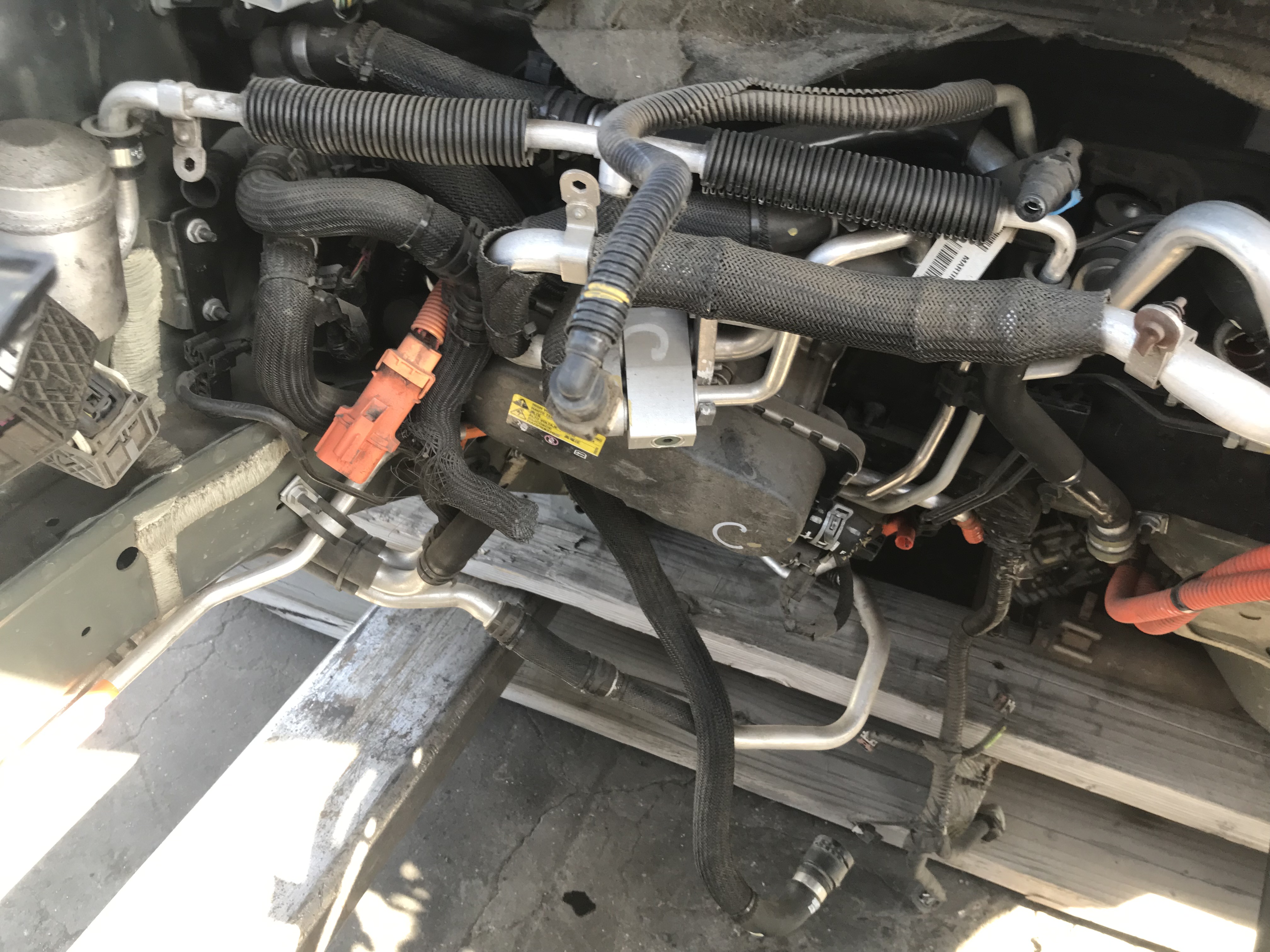

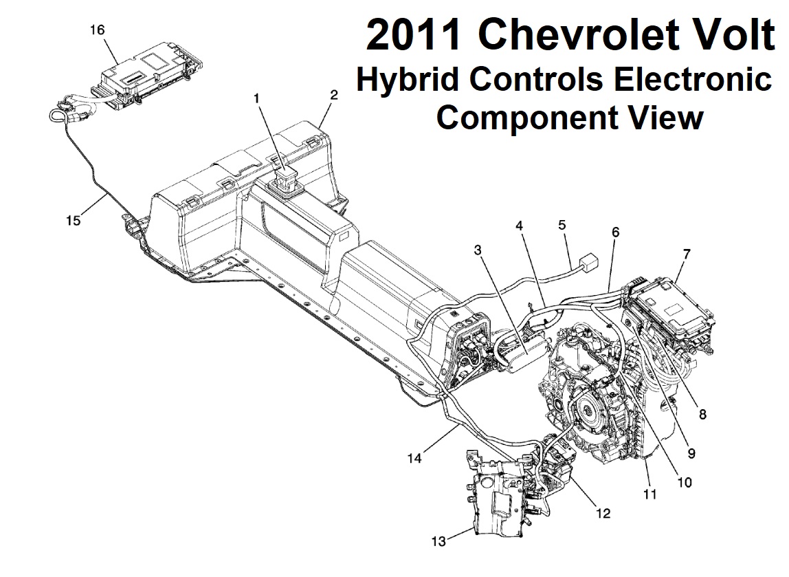

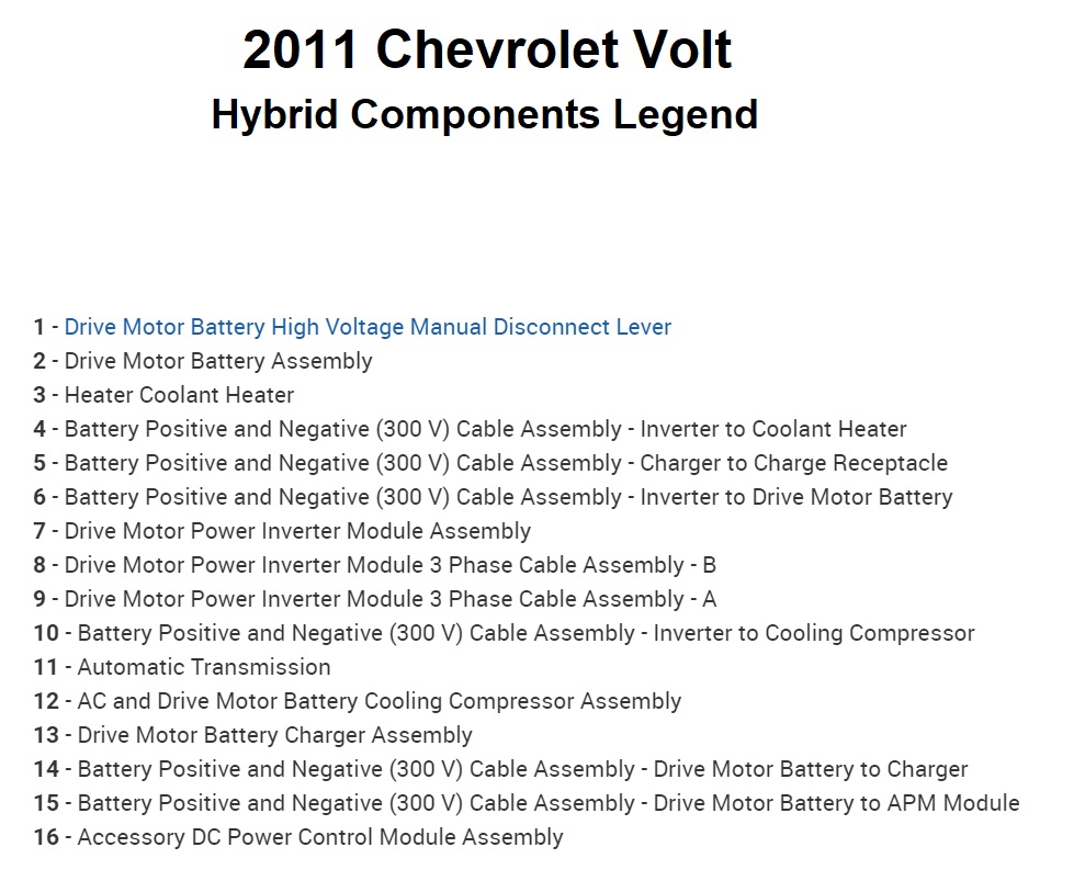

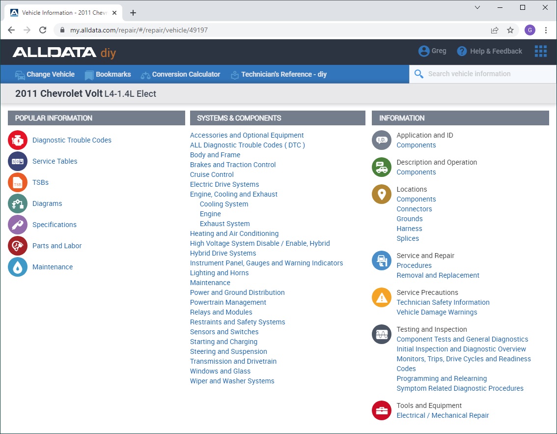

I am late to the party as per usual but would like to contribute what I can to this thread instead of rolling my own
absent an actual Chevy Volt in my possession I resorted to an old resource AllData.com an online user/service manual portal, and purchases a 1 month subscription for the first gen Volt for $20 bucks
I had questions:
1. where is the onboard charger even located?
2. what does the charge port connect to, does it plug in directly to the charger?

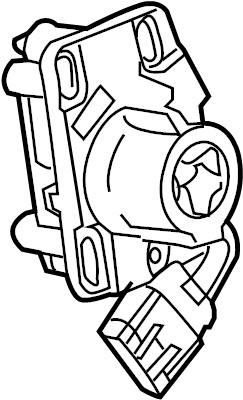

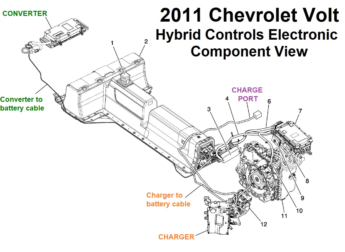

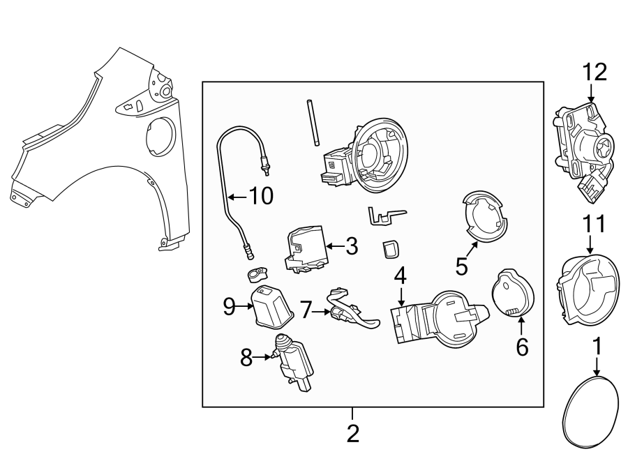

and here are the labeled key components
Gregski
Posts: 3158
Has thanked: 630 times
Been thanked: 1607 times
Re: Chevy Volt Gen1 Charger
Post by Gregski »

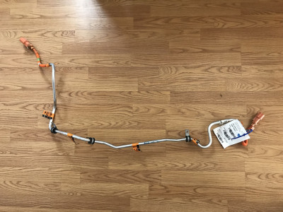

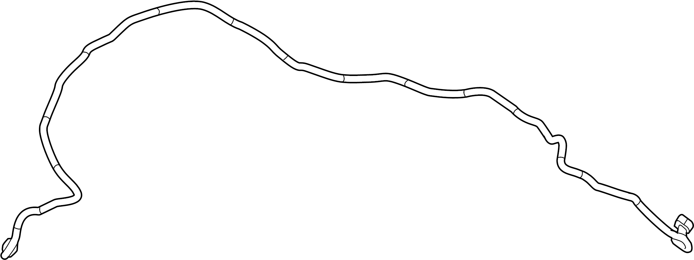

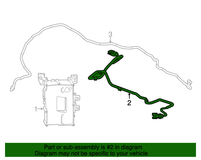

alright I believe I have identified the actual part number for the Charger to Battery gen 1 cable part #22889574
Supersession(s): 22744388; 22827024
and as seen in the wild

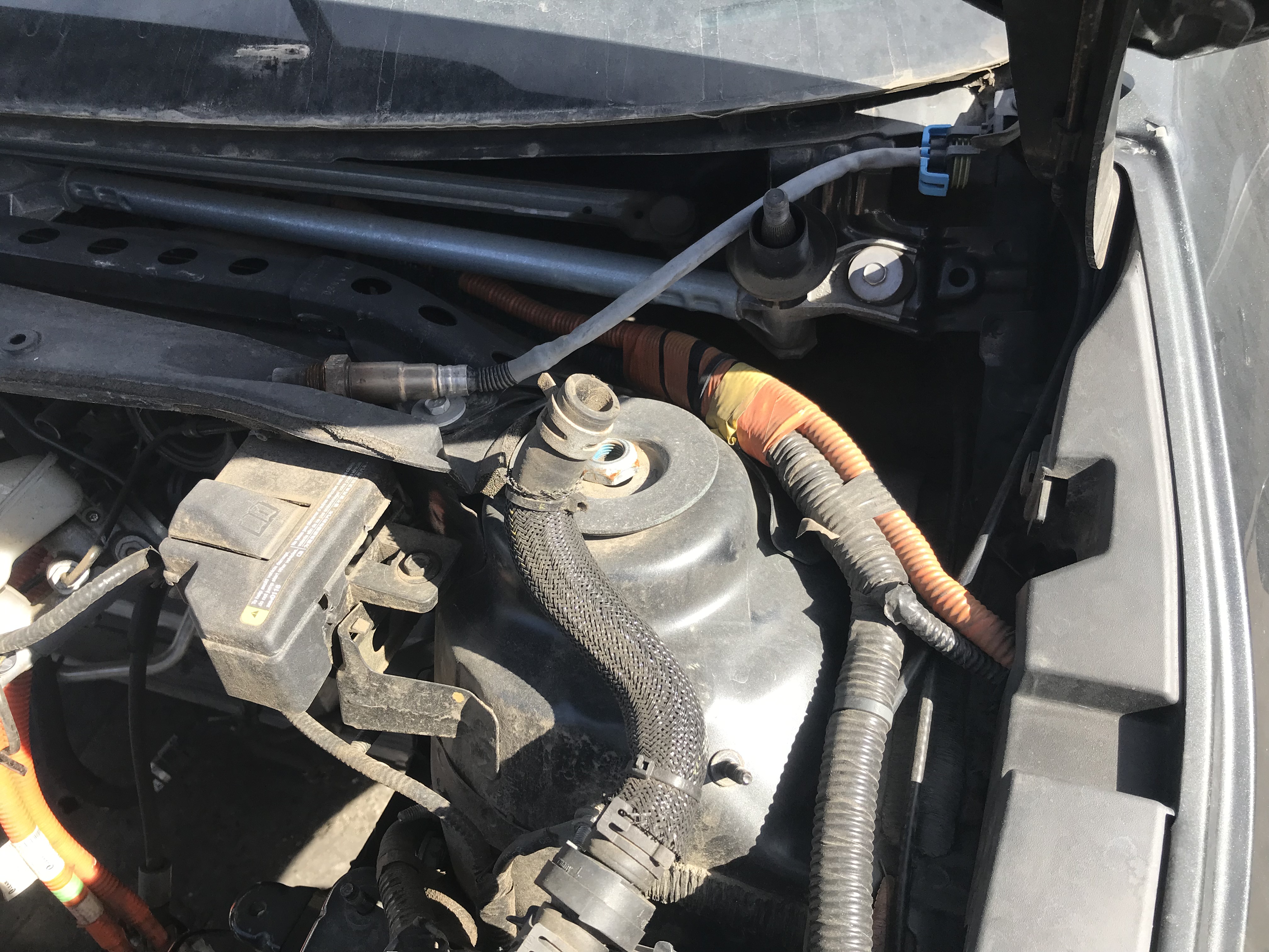

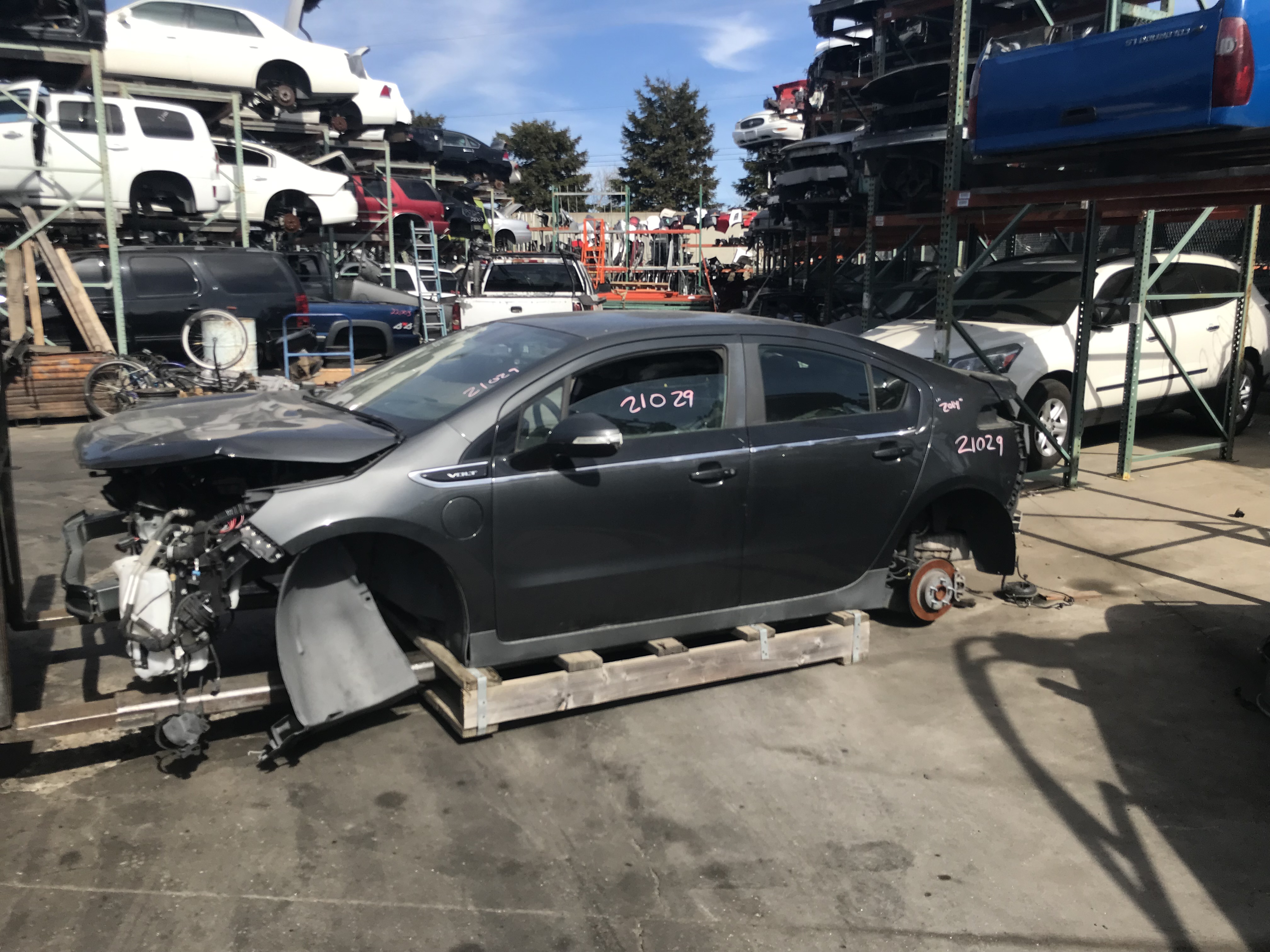

so I swung by a local all Chevy parts wrecker today in my town and they said they had one first gen Chevy Volt a 2014 model and they would let me go and look at it with them and tell them what parts I needed that were still on it, they were also kind enough to allow me to take some pics so now I can share with confidence the location of said components
Gregski

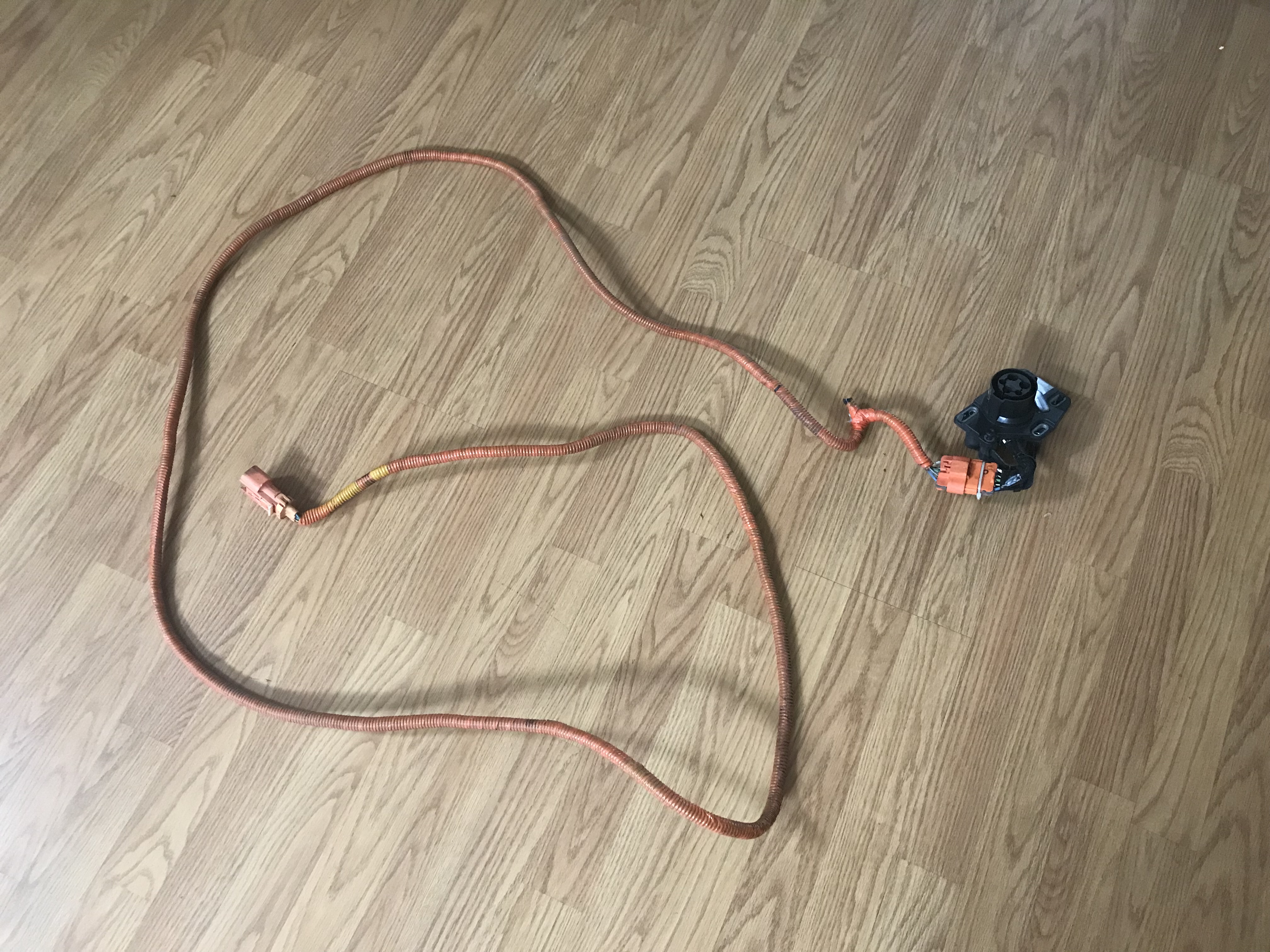

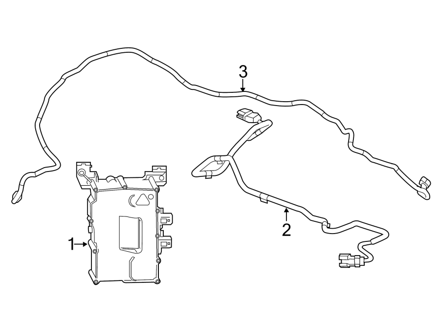

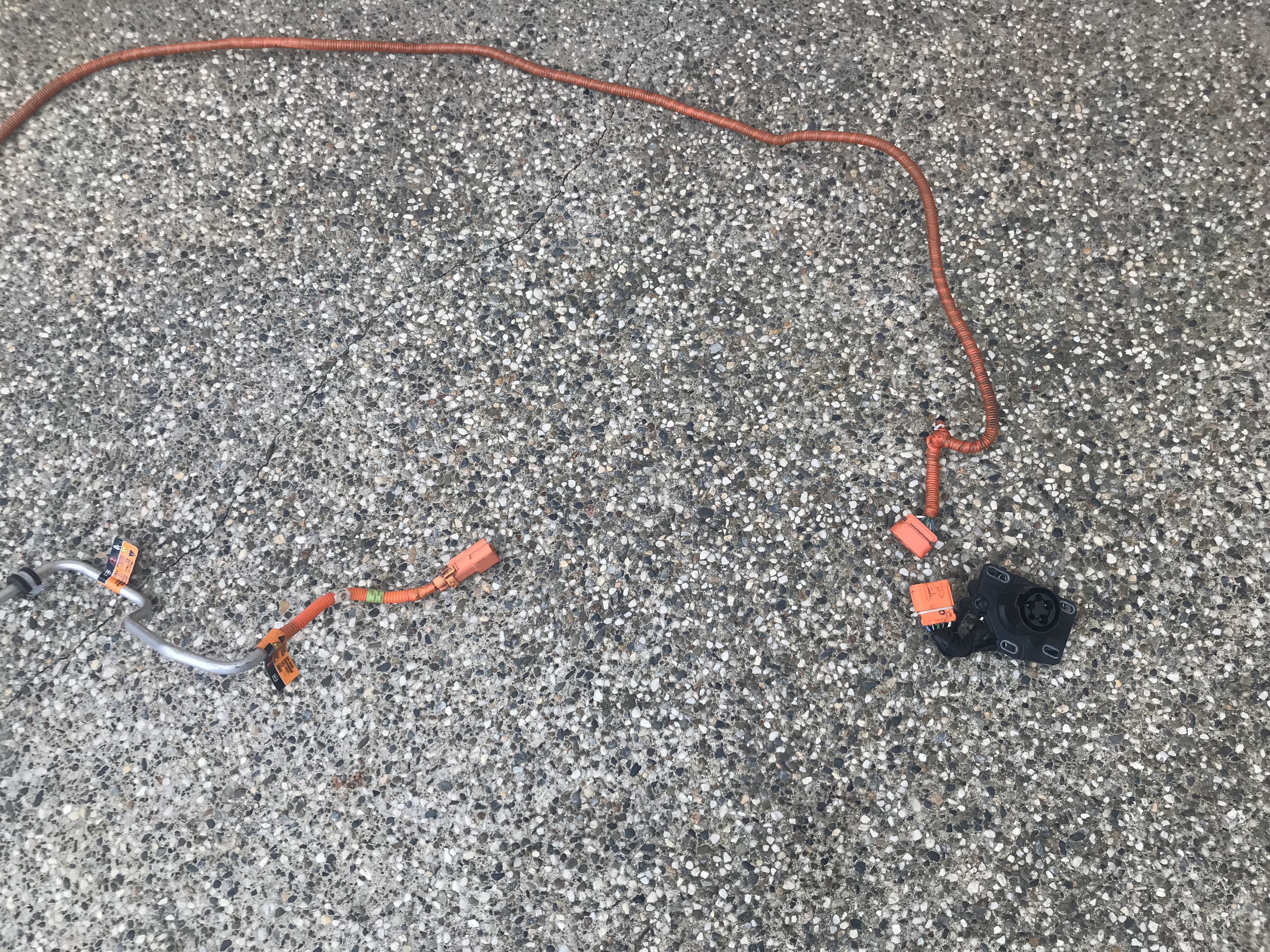

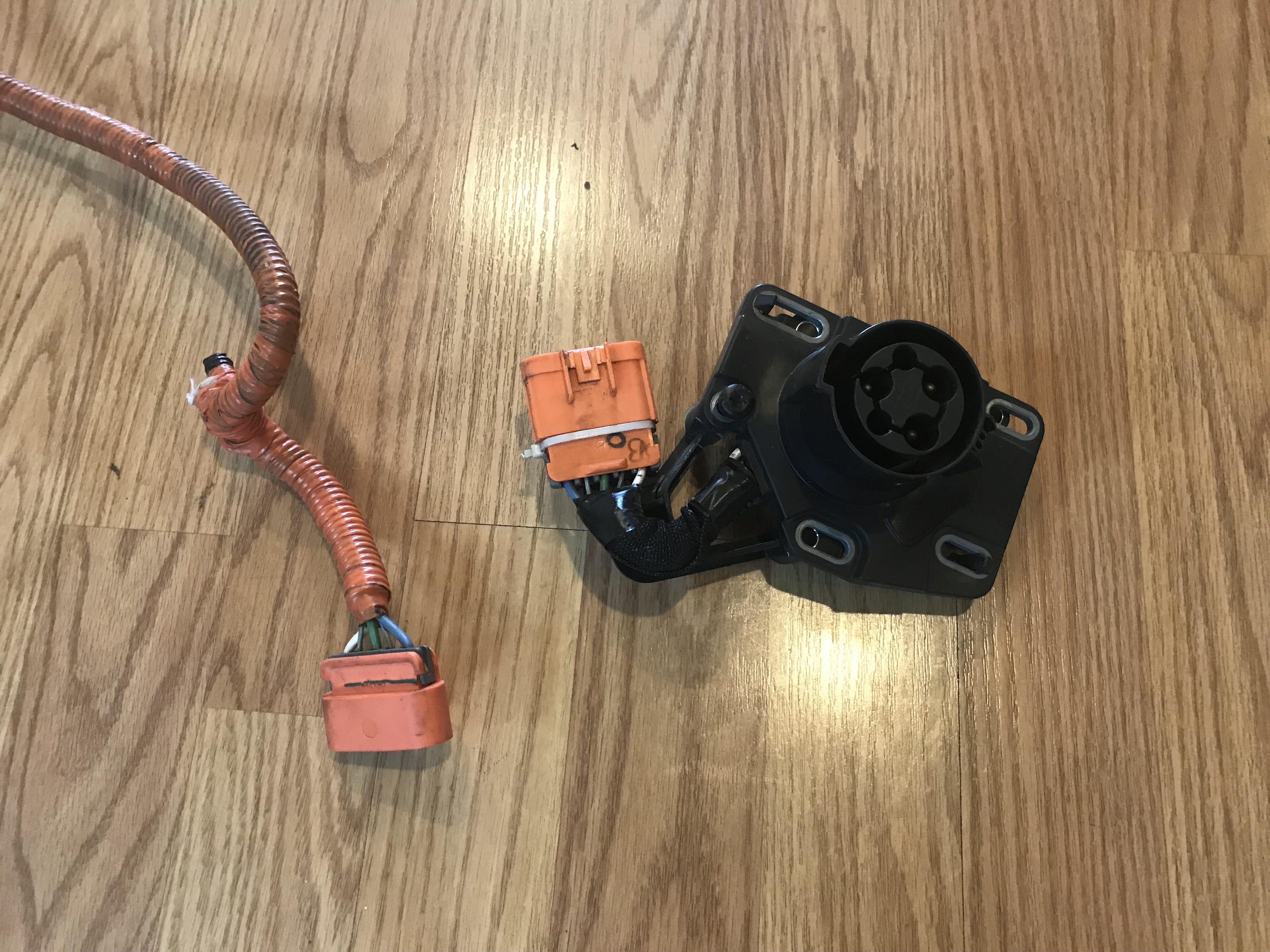

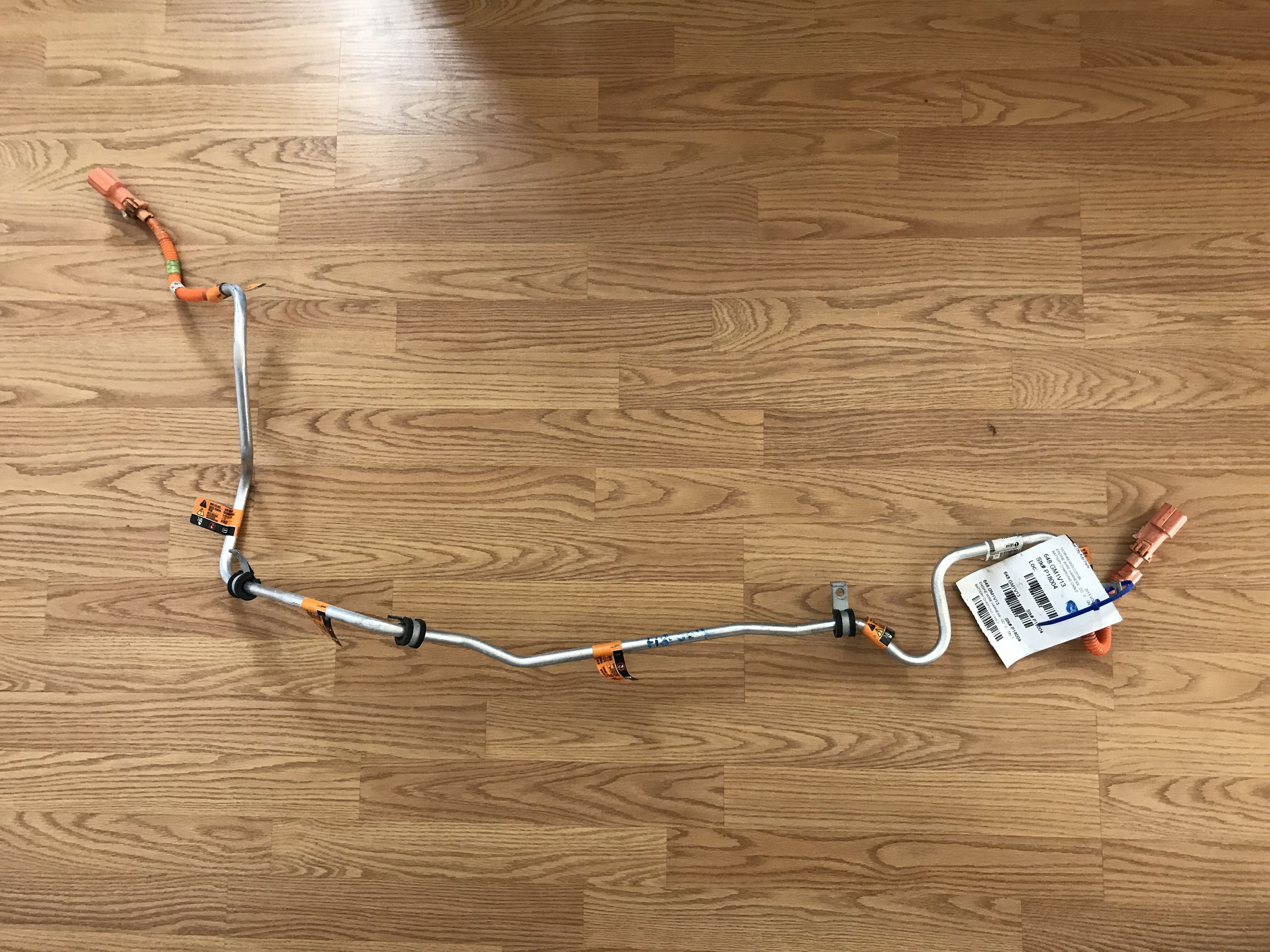

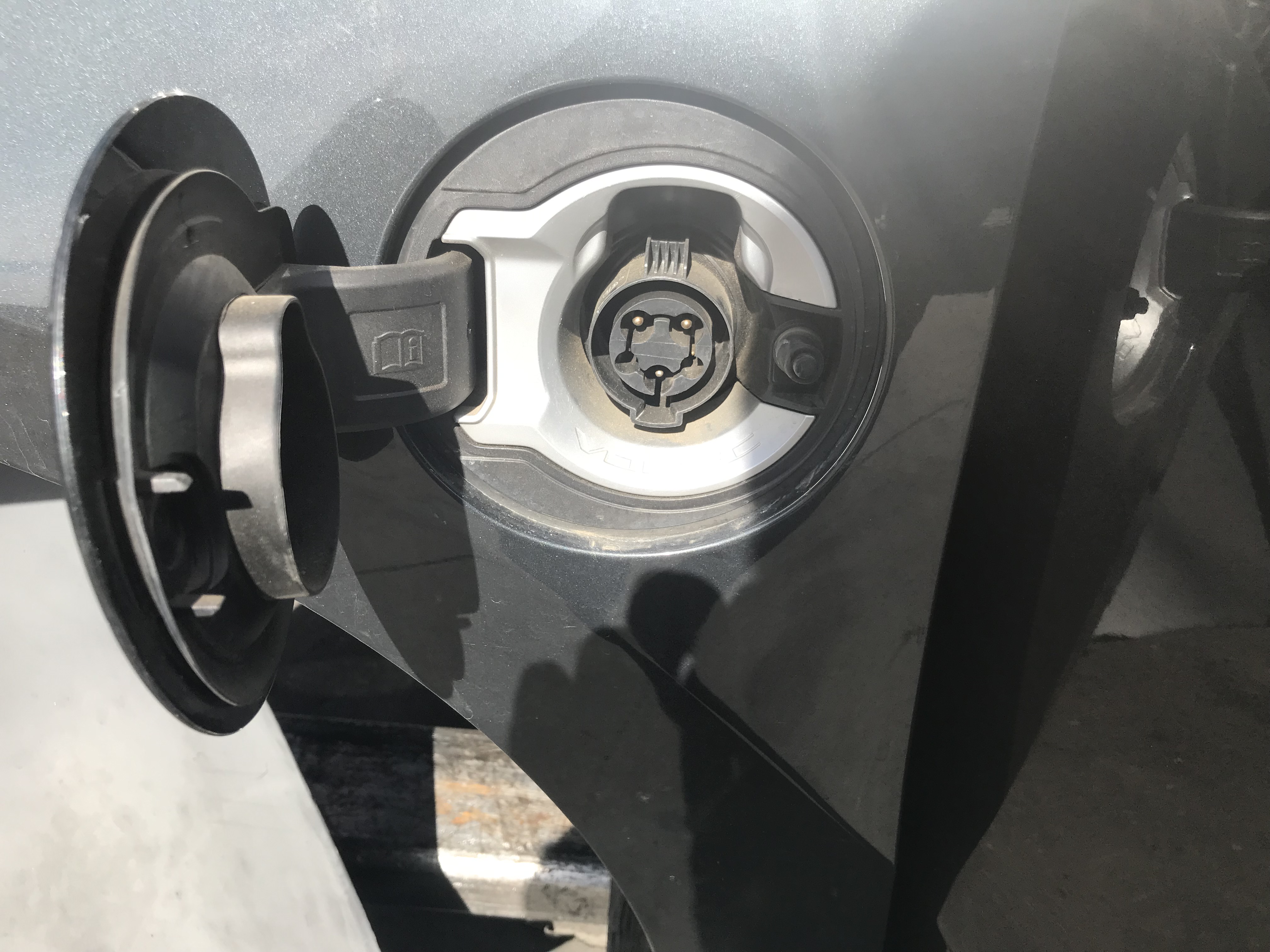

so I bought the charge port and its orange tail, please be advised, unlike all the other orange "two nostril" cables, this one has three nostrils!
Drive Motor Battery Pack Charging Port Assembly (2011-2013)
Part Number: 23281030
Supersession(s): 22759324; 22822889; 22975305; 23453436
long orange cable from charge port to charger part # 20972413 (no other superseded numbers)
#3 in the pic below:

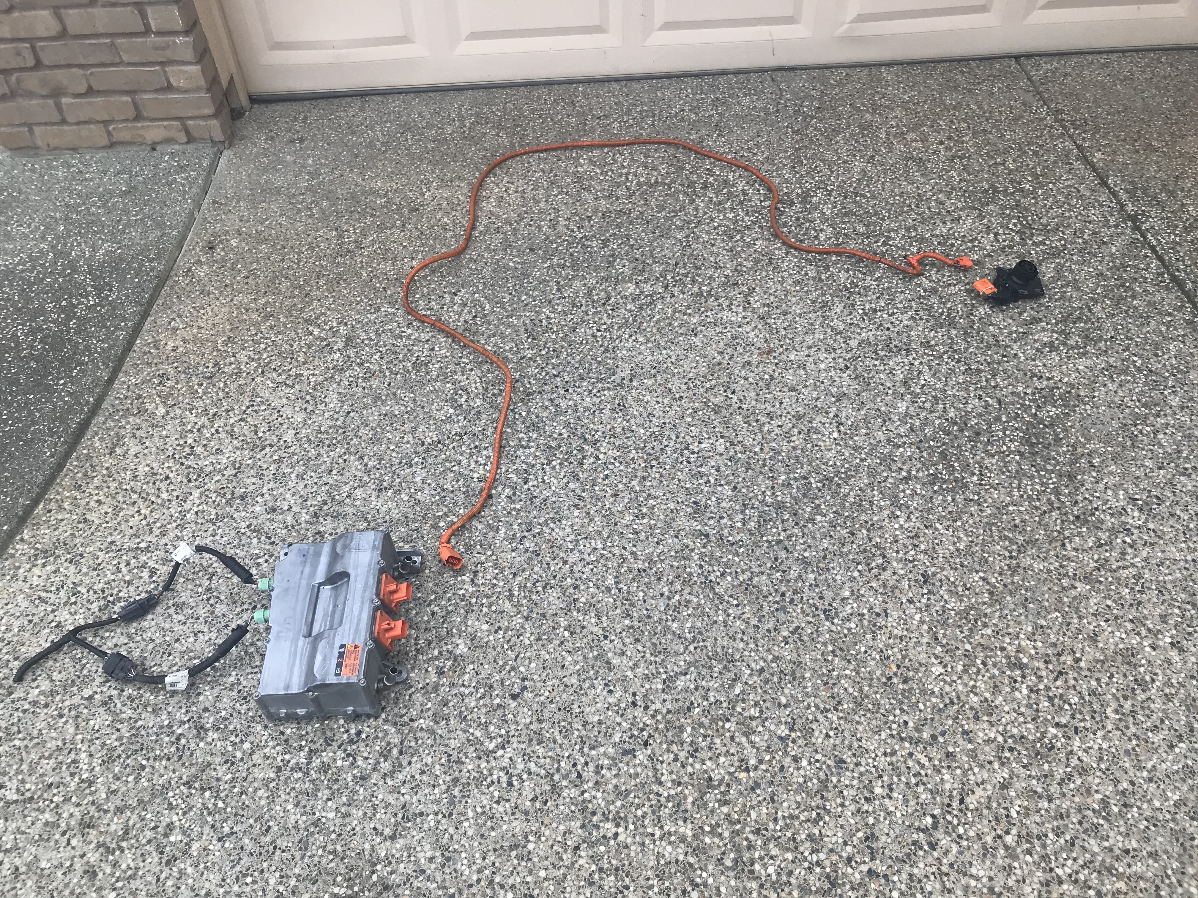

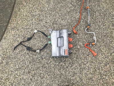

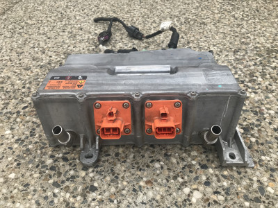

Post by Gregski »

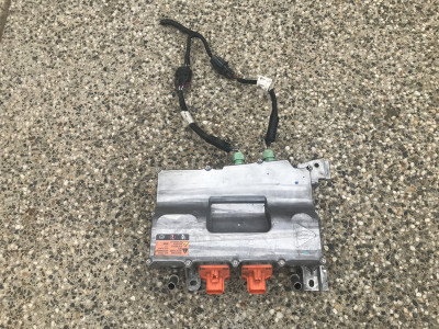

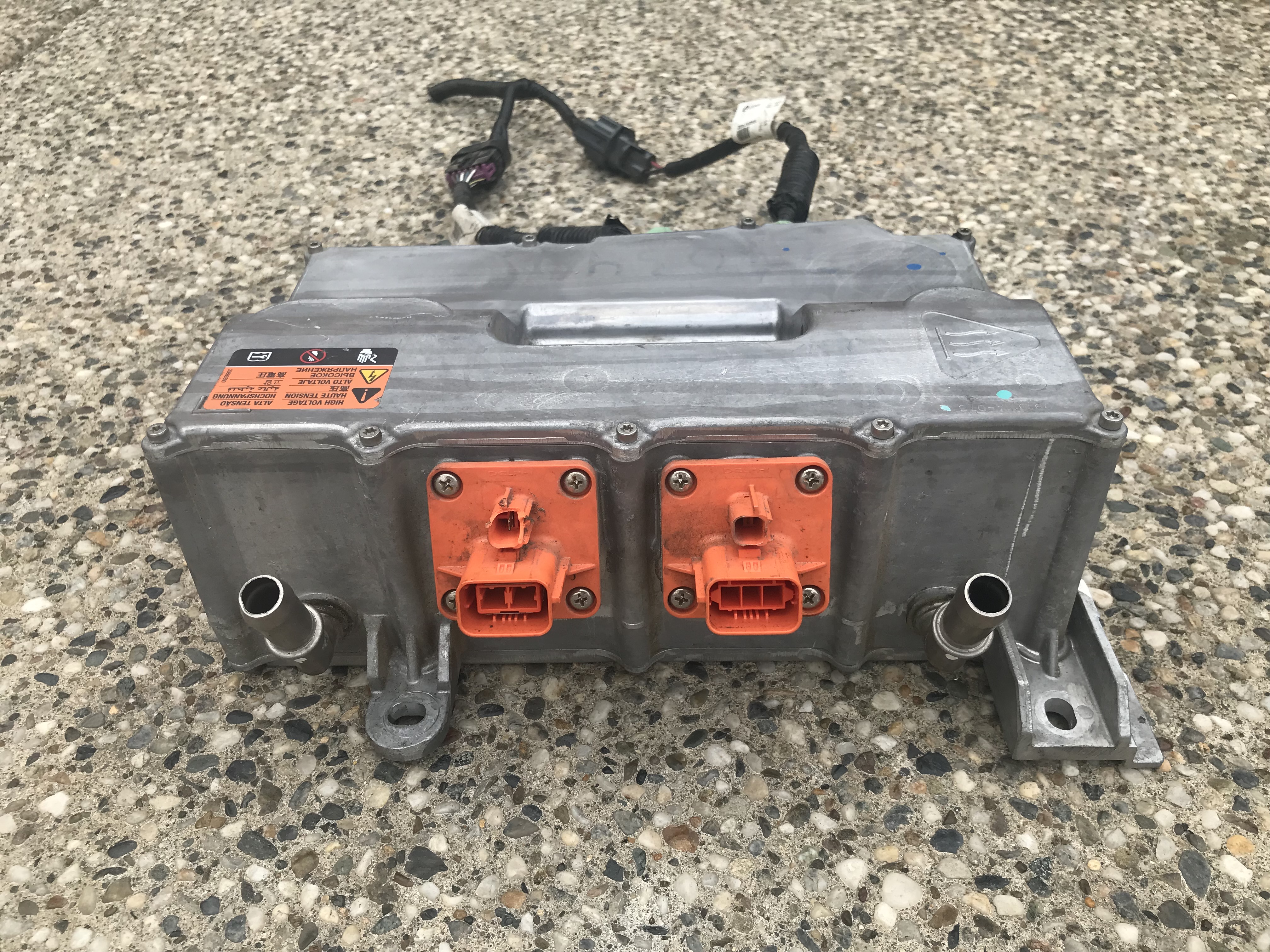

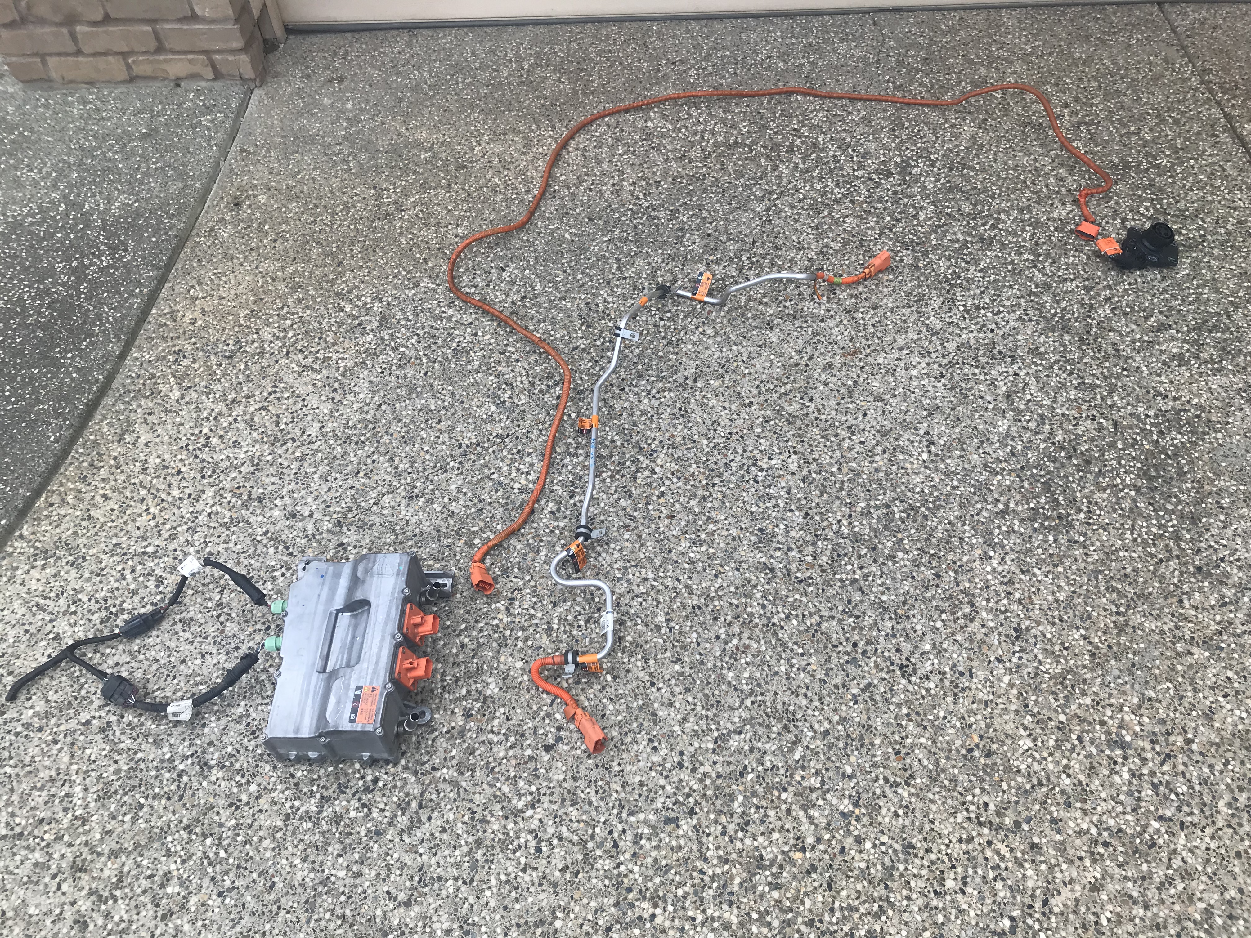

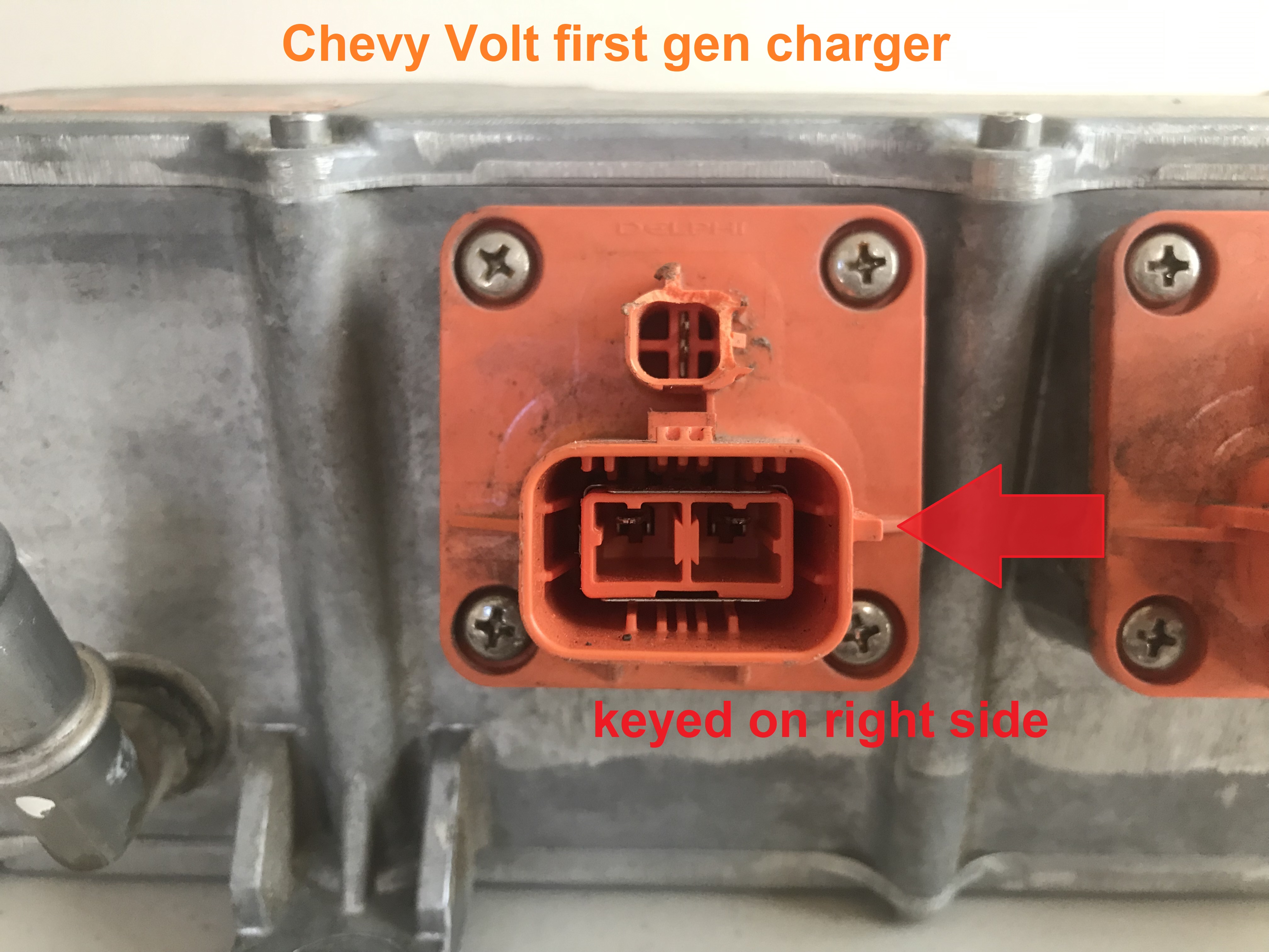

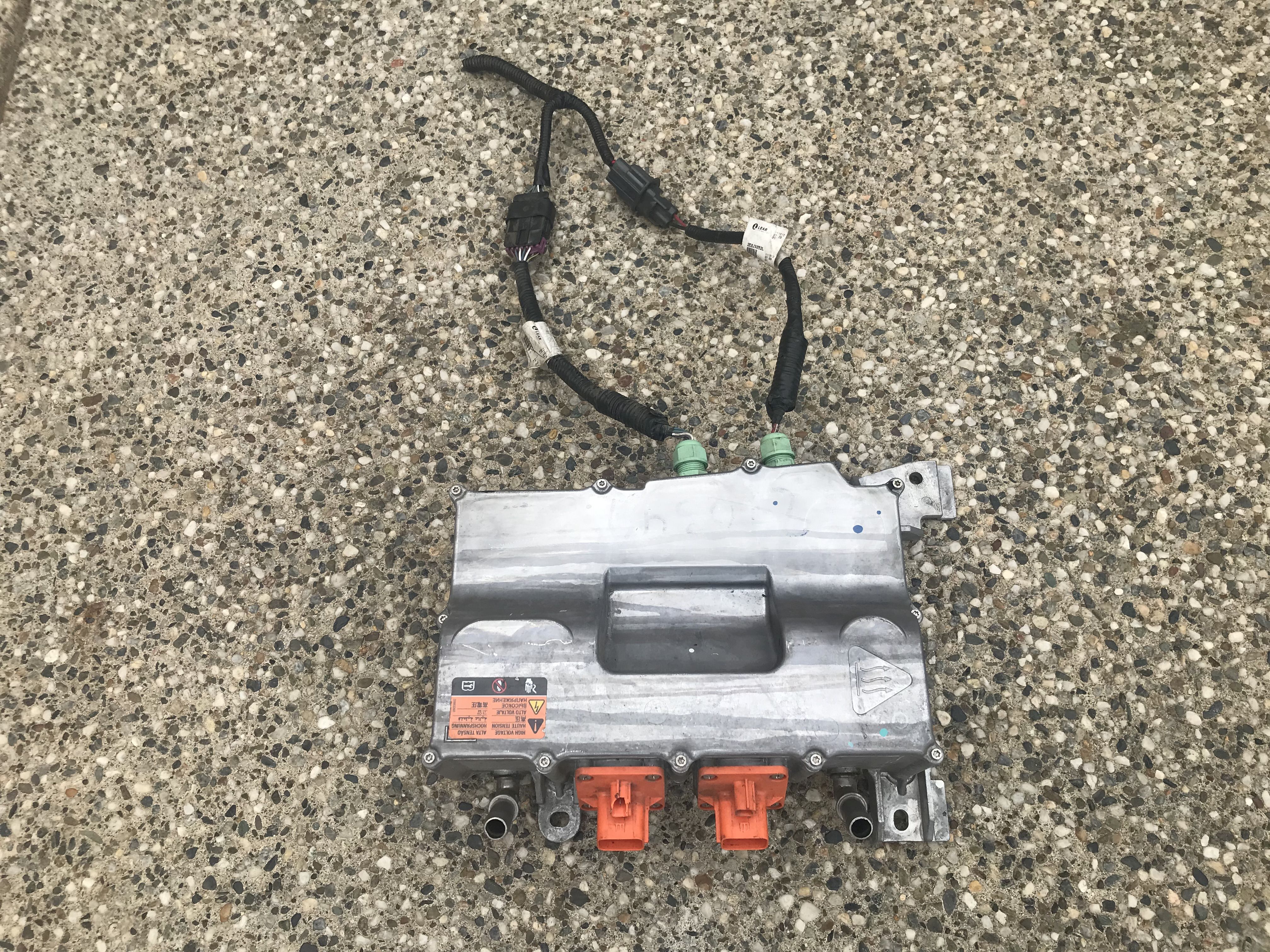

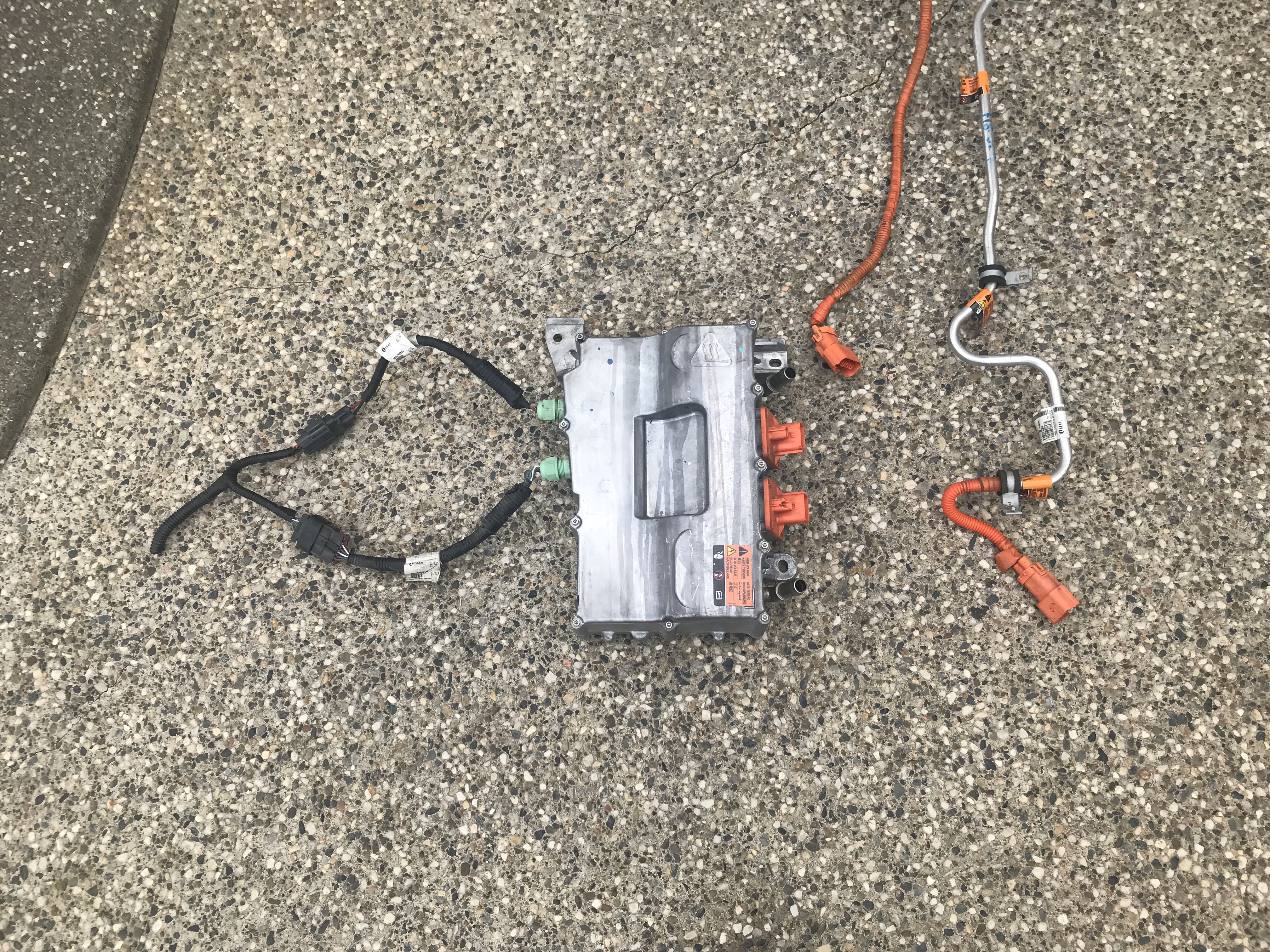

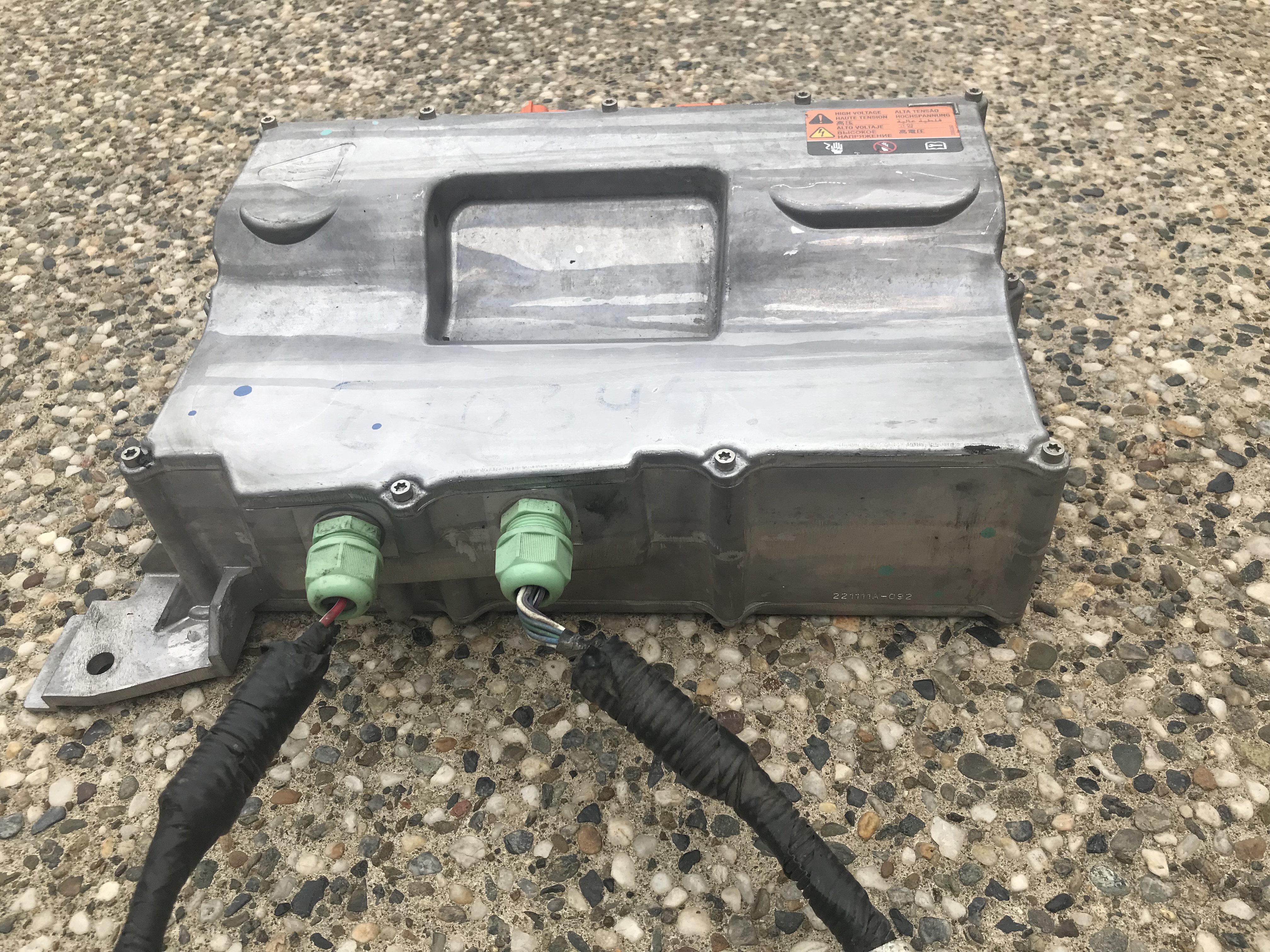

so I am happy to report I just scored a Chevy Volt gen 1 (2011-2015) onboard battery charger for $280 at a local wrecker, so no shipping costs
and I must say the father and son Armenian duo at the wrecker (in Rancho Cordova, California) that sold it to me, are the nicest salt of the earth folks I ever ranned into - Thank You So Much

Post by Gregski »
and here is the driveway wiring diagram
Gregski

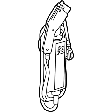

oh the fun rages on, so I want to get the OEM charger cable for the first gen Chevy Volt onboard charger and so I went looking for the part number and found this: (note the 600 different part numbers!!!)
Part Number: 24276685 (fits 2011-2012)
Supersession(s): 22781210; 22809287; 22865050; 22914085; 22943277; 23106561; 23248798; 23441757; 23446639
Part Number: 23487635 (fits 2013-2015)
Supersession(s): 22942876; 23136007; 23145307; 23203508; 24286957; 24291478

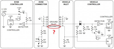

Post by Gregski »

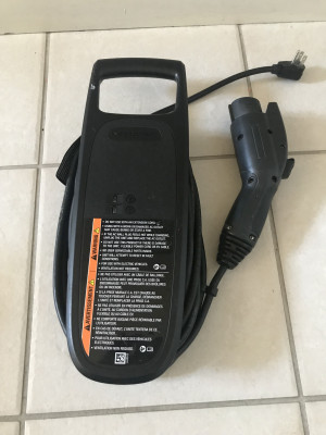

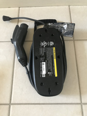

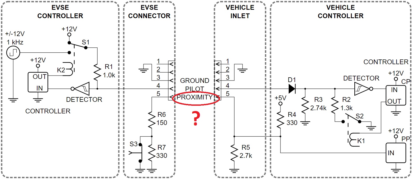

so once again I went out and took one for the team and bought this plugulator for it, I know nothing about this particular J1772 gitty up. I assume it's just a dime a dozen Level 1 charger that here in the Independent States it plugs into our 110/120 volt 15 amp wall outlets and makes you wait, or does the General pull some stunts with it? you let us know
actually bought on eBay but they shipped it in a used AMAZON box (just wanted to point that out)

Gregski wrote: Sun May 08, 2022 6:55 am so once again I went out and took one for the team and bought this plugulator for it, I know nothing about this particular J1772 gitty up.
There is nothing wrong with your J1772 charging handle/socket. It is a small EVSE. You just lack the integration.
Since you dont yet have DUE wired to your charging soclet you cant use my program for charging.
What you can do is wire up a relay with coil connected to 12V and PP pin on the charging port. Also make sure you connect PE pin to socket GND. So now every time you plug in the handle you pull in the relay. I use that PP signal to jolt my DUE into charging as well.
Now you put a diode on the CP pin of the socket and 2K7 resistor towards GND. Then wire 1K3 resistor in parallel to 2K7 to go through relay towards GND. This way you will signal charging to your EVSE every time you connect the handle.
It is all here in this schematic:
https://en.wikipedia.org/wiki/SAE_J1772 ... ircuit.svg

Oh wow, thanks for that, so let's break it down, prepare for death by a 1,000 questions:
When you say: "Also make sure you connect PE pin to socket GND." doesn't that happen automagically simply by inserting the shower head thingie into the socket, doesn't that connect the Protected Earth male pin into the corresponding socket's female port (bottom middle on most)
and I'm sorry that's just what them J1772s look like to me

arber333 wrote: Sun May 08, 2022 11:27 amIt is all here in this schematic:
am I crazy or is the schematic mislabeled, and what is being called Proximity (pin 5) should actually be called Control?
Posts: 3795
Been thanked: 411 times
Gregski wrote: Sun May 08, 2022 1:15 pm Oh wow, thanks for that, so let's break it down, prepare for death by a 1,000 questions:
Am i detecting a salt of irony...?
What i meant was to connect PE pin on your charging socket with your car chassis. Since it is not yet EV that is kind of a must. Doing that will connect aux battery GND/chassis/PE pin together. If you look closely to the J1772 schematic you will notice there is a small 150R (330R) resistor from PP to GND/PE on the EVSE side. PP on the car side is pulled up by a weak (10K) signal so that uC is aware there is nothing connected.
When plug is inserted PP signal is shown GND and it pulls that uC pin to GND signalling connection. Also EVSE will also pull CP pin 1K3 resistor which will command charger power. That is how it works in EVs and how we desire for our conversions...
But if you just need to charge you only need to convince EVSE to open AC power. Which is why you use PP pin as a GND and provide 12V to relay coil when plug is inserted. Provide diode and resistors to the other side of relay...
Or you can just connect diode and 880R from CP to PE.
https://mazdamx3ev.wordpress.com/2018/0 ... nica-evse/
