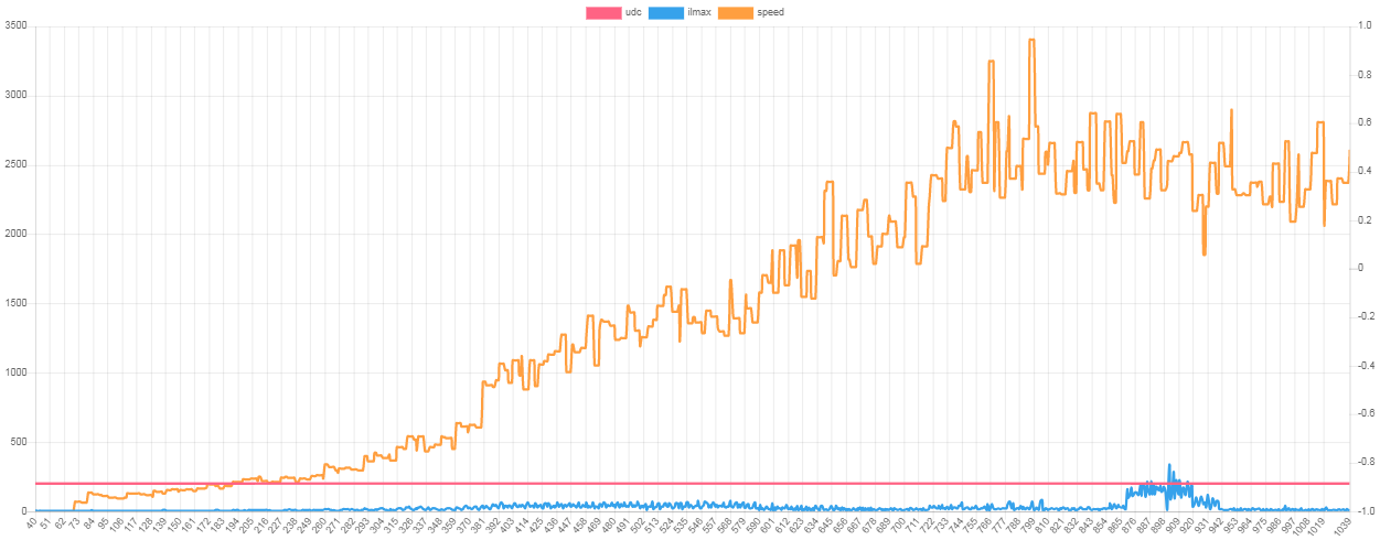

Whenever i try to run motor it ramps up to 4500rpm and there starts to wobble like it became unstable and finally trips OC. Or so it seems. I am not sure if it is OClimit. Interface indicates like it would jump to 5000rpm but mmediately fall to 4000RPM. Too fast to be other than indication error. See pic attached.
Is is possible those RPM drops are caused by voltage drop?
You think 17kHz wil be better for resolver? Why?

I can't explain the wobble just yet. But is most certainly has something to do with syncofs.
1. Ok, so EMI does not seem to be the problem here.
2. Iftlrise and fall dampem the response of the over current limiting. The higher the value, the slower the reponse. ifltfall dampens how quickly the amplitude is decreased once it overshoots iacmax*80%, ifltrise dampens the recovery.
3. Ok weird. The plan is that the AC current stays constant over the whole rev range at a given throttle percentage.
So 17.6kHz would yield a doubled update rate of the resolver. Thats why I think it's worth a try.

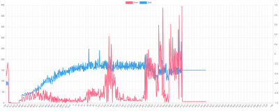

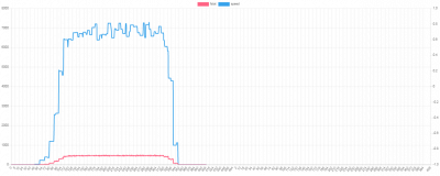

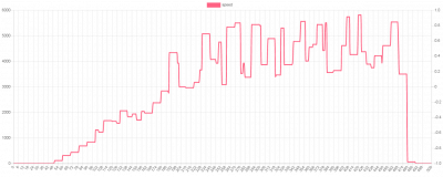

Facts:
1. We have to replace phase cables because car wants to move backwards

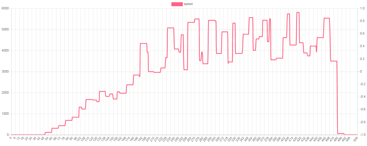

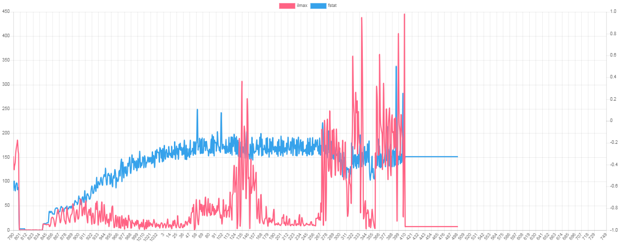

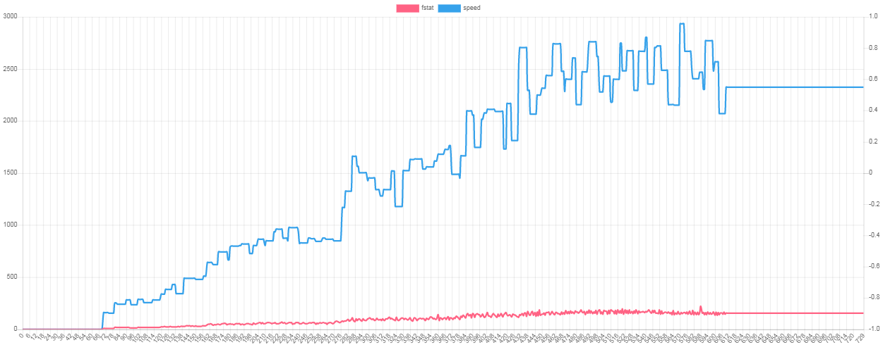

2. When torque is applied motor will turn up to some 2600RPM and not more. I tried to force the weakening and i got some 450A phase amps and OClimit, even though i had it set to 600A! Well just before it went out of scope i could hear motor straining and function wasnt sine anymore.

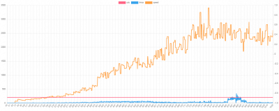

3. I took some shots of RPM plot and Hz. It seems motor consumes some 16A at 200Vdc max for 2500rpm. But at that rpm amps can be at 450A!!! What logic is that? I expected it would stabilise and raise voltage with RPM. I even expected for the speed to go towards 4000RPM at 200Vdc.
If you observe the first plot there is RPM and Hz. You can see when something tripped at 2300rpm.
Second plot observs max current and rpm. I had some success in getting more rpm from weakening. You can see when OClimit tripped and consumption went up.
hird plot is about Hz and max amps. Again observe where amps go up to 450A and inverter starts to whistle. Then OClimit.

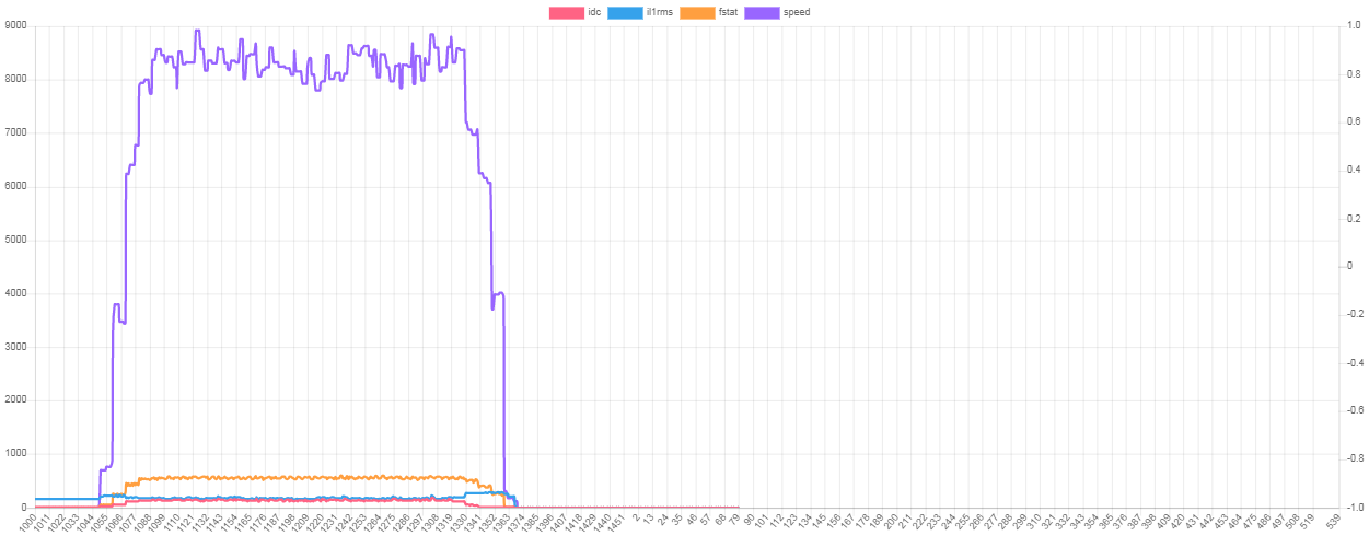

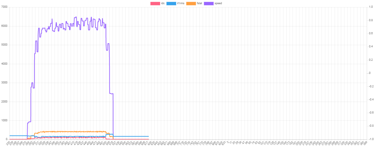

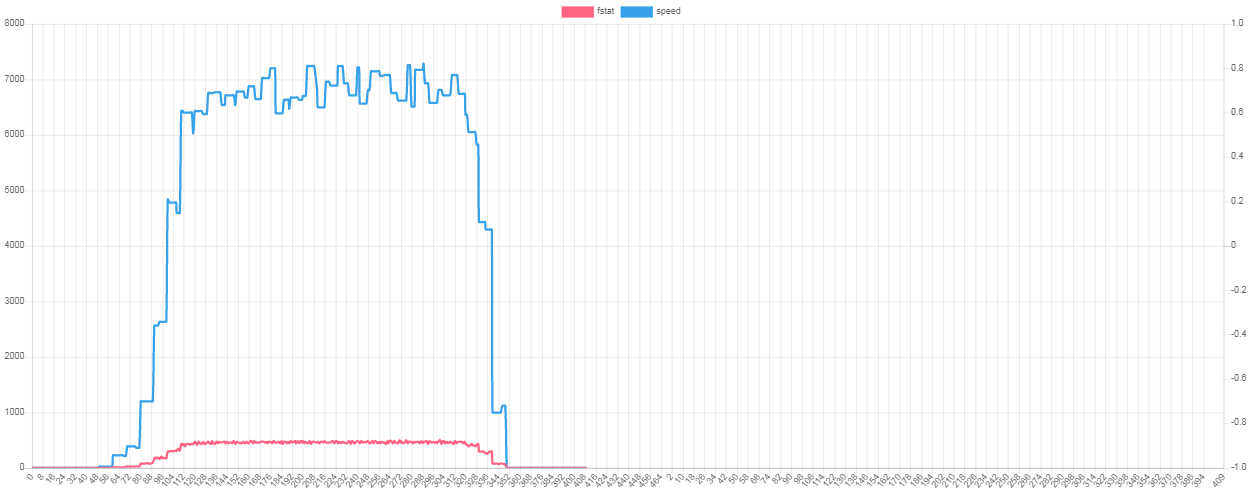

Todays test went on incredibly good.
We changed phase wires and got a bang from the motor and then i also swaped the cos resolver wires.

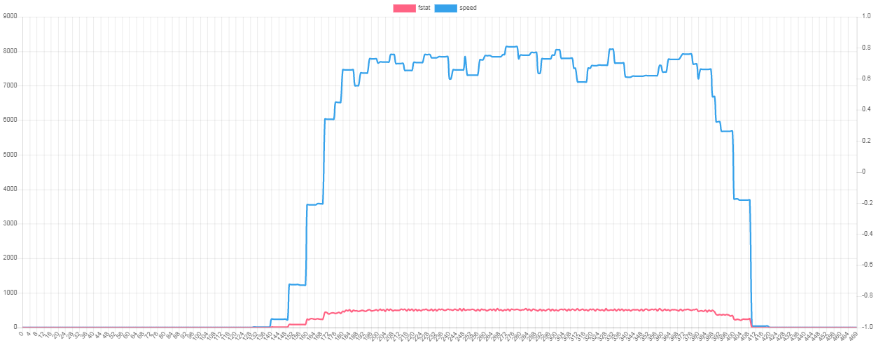

We managed to spun the motor, but only after i set up boost of 12000 and went to offset 32000. I then tried multiple offset settings and it seemed that motor could spin faster the more we were closing to 38000. Finally i tried 40000, but motor would rumble when turning and used too much amps.
At 38000 however motor would spin to 7000rpm at 200Vdc! Even better at 39000 motor would go towards 8000rpm, but with pron ounced roughness.
See my settings in json file.
params (8).json
(1.25 KiB) Downloaded 429 times

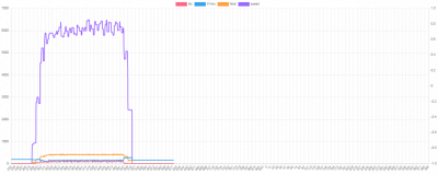

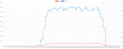

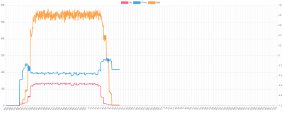

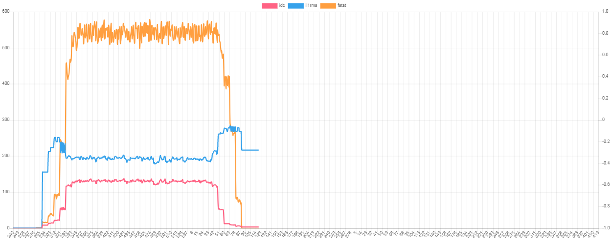

Then i took shots of RPM and freq at different settings. Also i took some shots of current paramters
With 40000 offset it seemed some smoke came from the hood! We stopped and investigated. Nothing seemed broken so we went for a drive test.
We tried to start the car and drive it from the shop... the car went backwards!!!! We were turning transmission 8000rpm in reverse. Obviously bearing lubrication system wasnt made for fast rearwards turning. I am still surprised how the smoke lifted from under the hood...
How is it possible to turn backwards since we changed phase cables since last time car was going backwards? We turned motor at first with 27000 and it was very jumpy there. But it turned itself forwards with a car surging a bit then OClimit tripped. This was in the afternoon, before the nice frames.
We tried to change cables again, but this time it wouldnt start DCcontactor! We checked and found desat was tripping.
I hope we didnt damage IGBTs. I have OClimit at 600A and tonight it tripped many times....

Hi Arber, that looks very promising! syncofs can also reverse direction, I think thats what happened.
Are you running coolant in your inverter? Modern car inverters have only very little thermal mass.

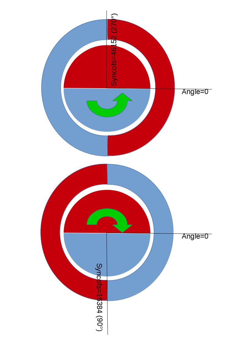

OK then. Can you privide insight how to rotate the other way? We almost burned oil inside transmission in reverse.
Just now i tried again on my inverter with 360Vdc and offset 38000. I noticed i got correct rotation, but only about 1000rpm. Then i went to 28000 and motor went wild! I got 8Krpm, but it should give more proportionaly to voltage increase. Leaf gearbox is very quiet one. You almost dont hear the gears.
I did change boost setting from 8000 to 12000 to 25000 in the end. Each time i got to more RPM, but i also tripped OClimit when i reduced throttle. I did set 100A for regen limit though. How does the boost work here. I thought boost is only present when starting?

arber333 wrote: Sun Mar 10, 2019 8:00 pm OK then. Can you privide insight how to rotate the other way? We almost burned oil inside transmission in reverse.
Of course:
So "red" always wants to be exactly opposite of "blue". Therefor if you start out with a field offset of 270° or -90° the rotor will rotate anti-clockwise. If you start with 90° it will rotate clockwise. The inverter just follows the movement, it does not try to force a certain direction of rotation.
You can see how "red" overlapping "red" will weaken the magnetic field. But lets not discuss that here.
More importantly the challenge in finding a good syncofs if two variables:
  1. if rotor and stator align perfectly, what is the value of syncofs? Ideally it would be zero.
  2. Next, there is a fixed phase delay between rotor voltage and rotor current, how much is that? Ideally 90°
So we need to add up 3 offsets: resolver/stator alignment offset, desired magnetic offset, voltage/current offset.
Of course the drawing is a 2-pole rotor, Nissan Leaf has 8 "sectors".
Does that make it clearer?

Hm... so lets assume then my sweet spot is 38000 and the motor is turning in the unwanted direction. To get it turning in the RIGHT way i need to apply force at 180°. So from 65000 what does mean 180°? 90° from 65000 should be 1/4? That is some 16000?
So if i now make this arithmetic 38000+(2*16000) = 70000 so in a circle that means some 5000 from 0? Would that mean motor would just turn the other way? Is it really that easy?

Yes that is how it should be. That said, in code I shift the field by 180° for reverse but it never quite runs in the same manner as in forward. But at least 5000 is in the right ball park.
I use 55000 as default but that is found using an idle motor at 60V. So your value is probably better.
EDIT: as opposed to my drawing above, IPM motors (magnets buried in the rotor rather than being glued to its surface) reach their best torque per amp at 45° field offset. https://www.controleng.com/articles/und ... et-motors/
So in that case the angle difference between forward and backward would only be 90°, right?

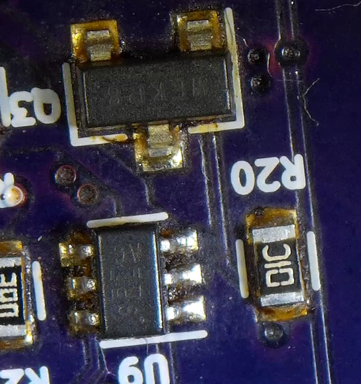

I have inverter on my worktable now and it seems like Fault trigger transistor on Volt driver board is burned. It is a small SMD thing even smaller than SOT23 parts. I think it is SSMini3 package. I will try to replace both of them and then see what happens.
How would you expect they are polarized? Signal is grounded all the time inverter is in operation except when fault happens, then signal floats. Would that be NPN transistor properties?
Also Johannes would it be possible to have a button on web interface with next revision? That would save the graph frame and store it as a pic. I tried to capture frames with my phone and couldnt. I could capture interesting drive/regen data...
doobedoobedo

Can you get a magnifier on the package and see what's etched on there? Same size as SC-70/SOT363? Google might help with package and markings.
SC70 (below) sot23 (above) resistors are 0603

Hm... i found one burned Ampera driver board and changed transistors from fault position. Seems they are working. I get good fault response when i connect 60Vdc to inverter.
However when i connected mainboard there was still desat error. I inspected the main board and it seems that desat pin is allways pulled to GND. I saw on my interface board that i cnnected both desat and UVLO pins together. But now UVLO pin is pulling them both to GND. Johannes how is UVLO connected? Why would it draw it to GND?
EDIT: It seems my Olimex board developed UVLO pin towards GND. When i replaced it with another 2nd power stage works with 50Vdc battery. I still have to try it with 380Vdc.
1st power stage is relentlessly tripping desat no matter what i do. It seems it is damaged. I even tested without power stage connected and desat didnt trip then obviously.
