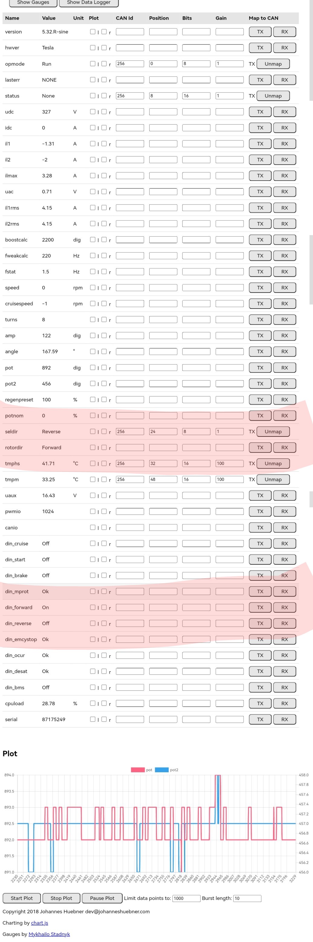

Another small note. Setting the dirmode to "SwitchReversed" also inverts the seldir.
Example: if din_forward = on, seldir shows Reversed. The motor spins forward correctly.
I was trying to use the seldir as the signal for the dashboard display, but need to invert it, I guess. rotordit only updates after actually spinning the motor, so cannot use that.
