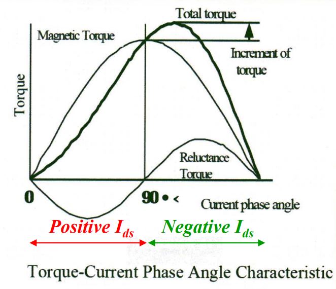

Re: Testing FOC for synchronous motor
When you say fixed value do you mean x amps or do you mean x=-y%Iq?
To achive MTPA on an IPM motor Id = -x%Iq . In the case of say a gen2 toyota prius x turns out to be -30 % of Iq. x needs to be determined experimenally and is different for IPM motors of different designs primarily because in FOC speak the inductance on the d axis is determined by the physical structure of the rotor. So from that perspective Id must be dynamic for best performance. And we should only employ FW once we have approached the maximum rpm with the available line voltage.
With normal FOC control, Iq's sign is direction of torque production.
Consider the 4-quadrant operation:
Motor direction = forward; Positive Iq = motoring torque.
Motor direction = forward; Negative Iq = regeneration torque.
Motor direction = reverse; Negative Iq = motoring torque.
Motor direction = reverse; Positive Iq = regeneration torque.
An IPM will always want negative Id:

Ok, thats very interesting. So motoring in forward works out to regen in backward and vice versa. id always negative, understood.
Any idea why regen became more pronounced with rising speed? Some phase lag perhaps?
Thats a good sign. I have a limited experience of 3 devices that have been running for quite a while and never failed. As opposed to noname Chinese ones you get on ebay. They failed after 3 months because the main inductor lost its coating
If the regen increased, you should see the Iq change accordingly...
On regen, the leg voltages are phase delayed compared to motoring. So, if you have lagging leg voltages as RPMs rise, then that will reducing motoring effort (when motoring is desired), and increase regen effort (when regen is desired).

Now I'm starting to wonder if there is some kind of asymmetry built into the leaf motor. In one direction I can spin up to almost any speed (off the scale of the 8krpm rev counter). Now if I only change the sign of the desired iq it does spin in the other direction as expected but it doesn't spin as fast and has a tendency to trip out. It could be the motor spins in the other direction when in the Leaf.
So, anyone ever experienced a preferred spinning direction with the Leaf motor?
