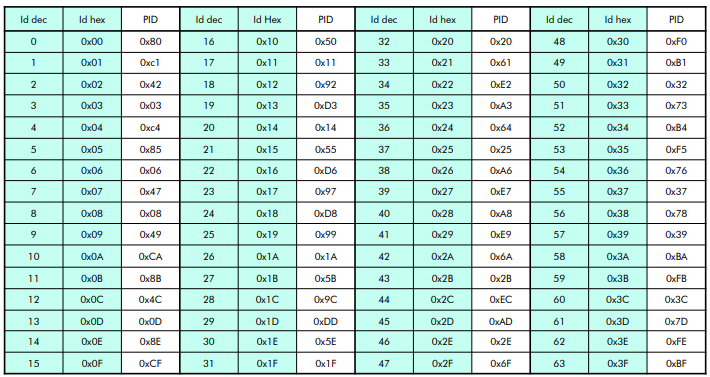

I think the compressor ID may match yours (I think you have included the address parity bits?) The data seems different (unless this is because I don't have HV on it?). The heater matches yours.

in my post the PID[30] and PID[48] are decimal, in hex it would be 0x21 and 0x30Pete9008 wrote: ↑Thu Jul 07, 2022 8:52 amAgree completely, which is why I've just tested them!muehlpower wrote: ↑Thu Jul 07, 2022 7:29 am I agree that most OEM devices don't have this feature, but it's worth a try.

Just to add / clarify for the purist, no offence, the difference between ID and PID are the two parity bits. Both of them make one byte. So there are only 6bits for an ID. That's why we have 63 Addresses maximum.
IMHO we should talk ID not PID.
PID is implementation level.

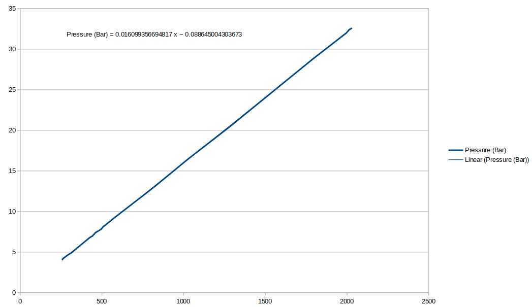

hi its been a while. i had some free time today and was working decoding the pressure reading from the factory sensor. i connected upto the heater control on my work bench and send the can wakeup signal and connected VCDS to read the ac pressure sensor values. i then emulator the lin bus signals to see the VCDS sensor reading.
the pressure sensor partnumber is 5Q0 959 126A
40 F8 2F 22 1bar 0100 0000 1111 1000
01 01 01 01 4bar 0000 0001 0000 0001
05 01 01 01 4.2bar 0000 0101 0000 0001
20 01 01 01 4.6bar 0010 0000 0000 0001
30 01 01 01 4.8 bar 0011 0000 0000 0001
40 01 01 01 5.0bar
aa 01 01 01 6.8bar
bb 01 01 01 7.0bar
cc 01 01 01 7.4 bar
dd 01 01 01 7.6 bar
ee 01 01 01 7.8 bar
ff 01 01 01 8.2bar 1111 1111 0000 0001
ff 02 01 01 12.2 bar 1111 1111 0000 0010
ff 03 01 01 16.4bar 1111 1111 0000 0011
ff 04 01 01 20.4 bar 1111 1111 0000 0100
ff 05 01 01 24.6 1111 1111 0000 0101
ff 06 01 01 28.8 1111 1111 0000 0110
cc 07 01 01 32.0 1111 1111 0000 0111
dd 07 01 01 32.4
ee 07 01 01 32.6
cc 10 01 01 3.2 1100 1100 0001 0000

it looks like the pressure data is the first two bytes and is a 12bit value hope this helps bits 0-8 = 0-4bar bits 9-12 = pressure + 4bar

- Posts: 1801
- Has thanked: 102 times
- Been thanked: 349 times
Re: VW A/C Compressor
Thank you
I bought one of those sensors a while ago and that has been on my to do list ever since!
Edit - Curious what it looked like so plotted it: Pretty good, you must have taken a bit of care taking those measurements!
Pressure is on the y and message value on the x so that the regression equation is more useful.
Pressure(Bar) = 0.088645 * (Byte0 + (256 * Byte1))
Note - there is something odd going on at pressures below 4bar - the output starts going up again. Wondering whether bytes 2 and 3 need to be used in this region too?
Edit2 - BTW if you are looking for one of these sensors on ebay it's worth searching for VW AC pipes rather than the part number. There are a number of pipes for sale, complete with the sensor, mounting boss/valve and often wiring pigtails for less than the second hand sensor alone (a bit of care is required to make sure it's off a car that had the pressure sensor rather than the pressure switch though). I got mine for around £10 this way.
