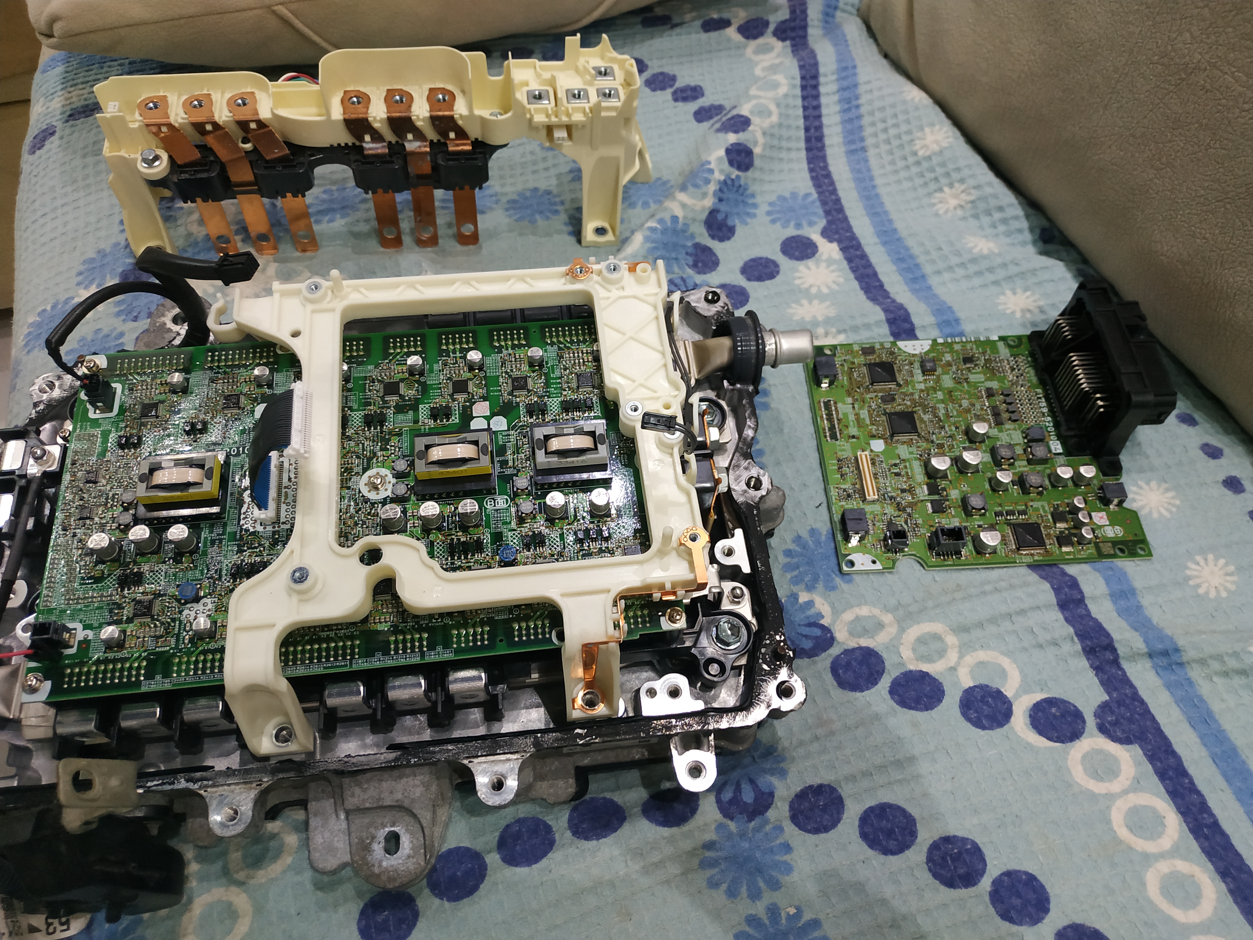

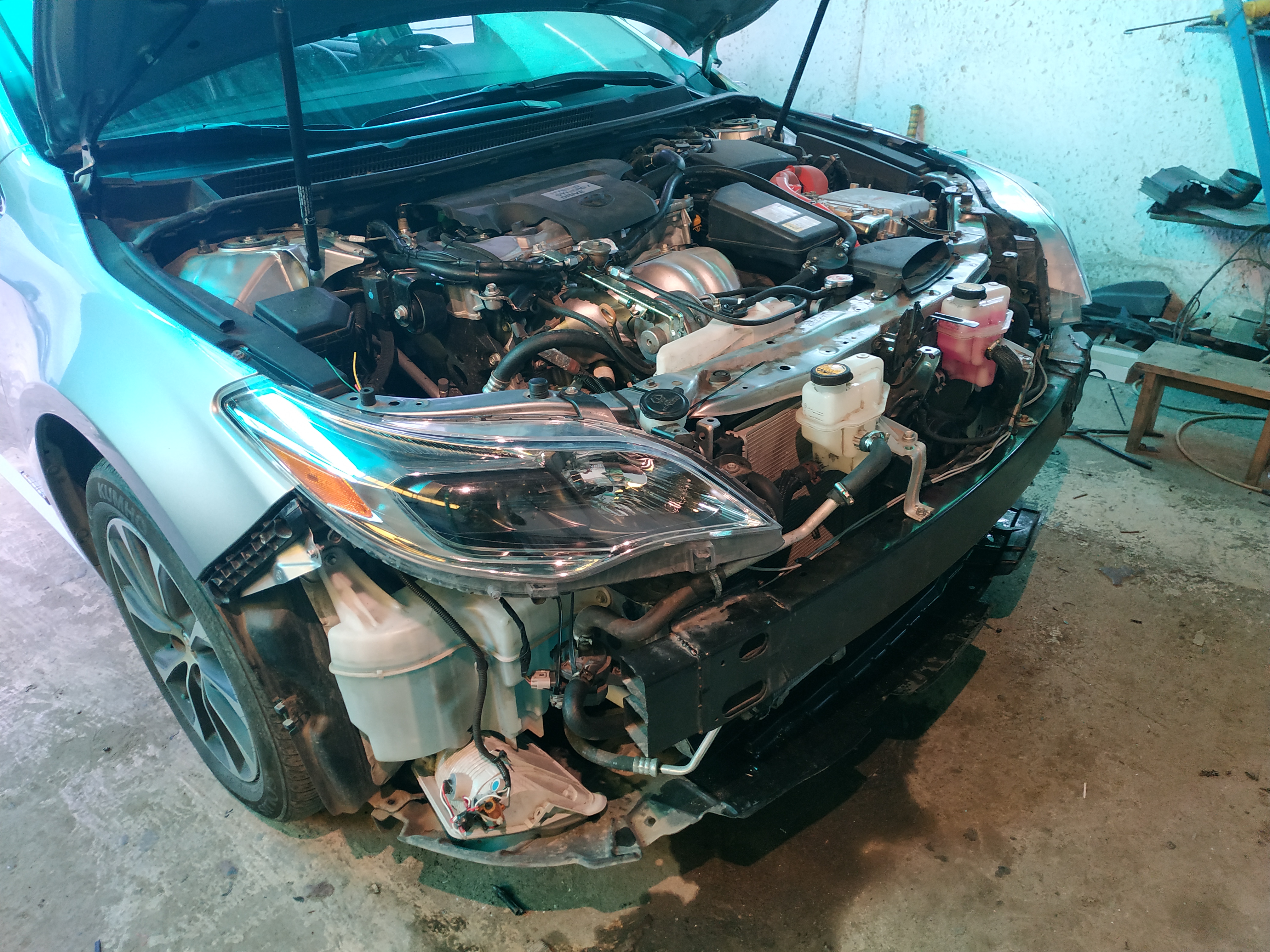

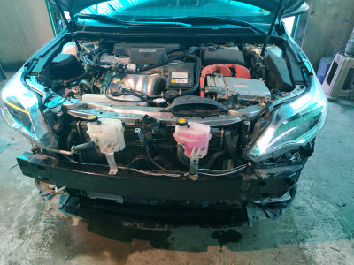

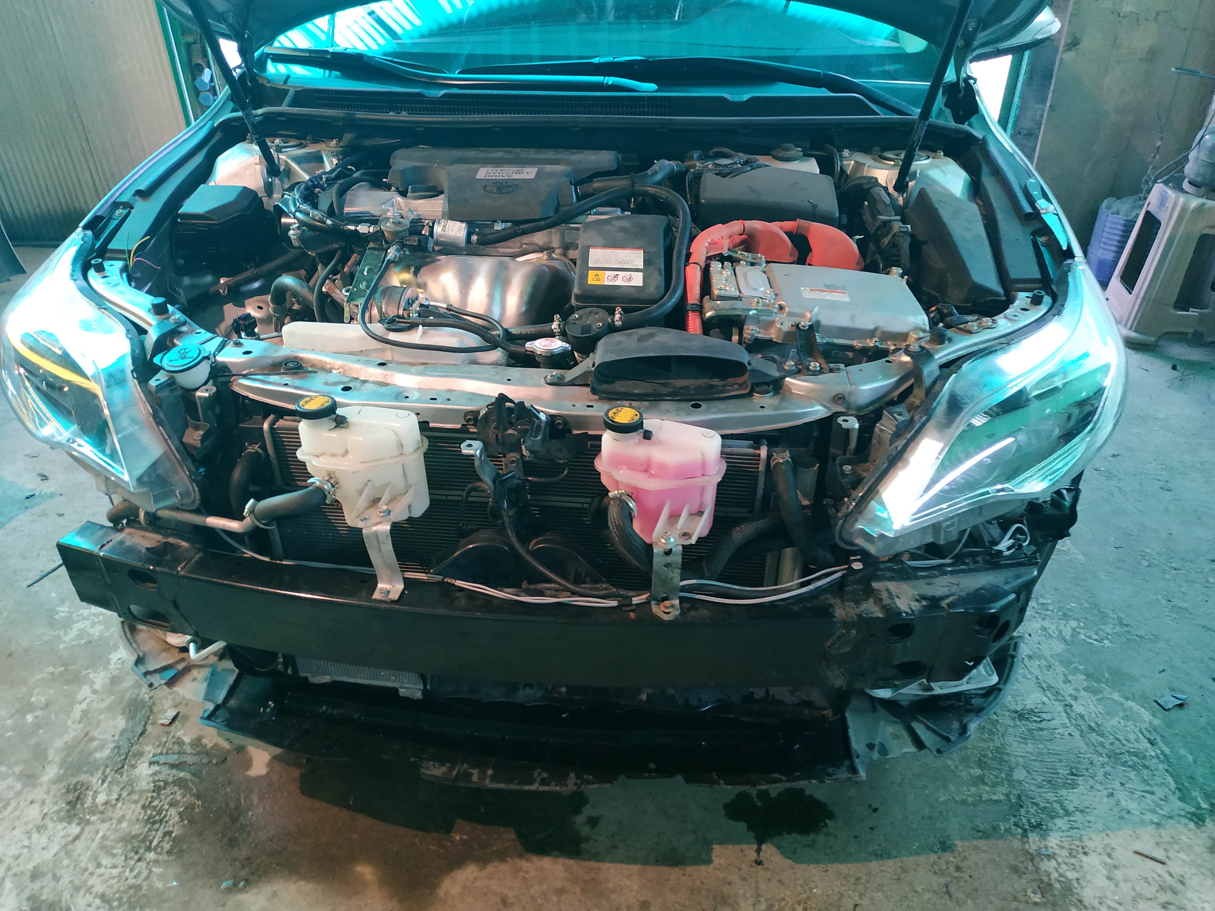

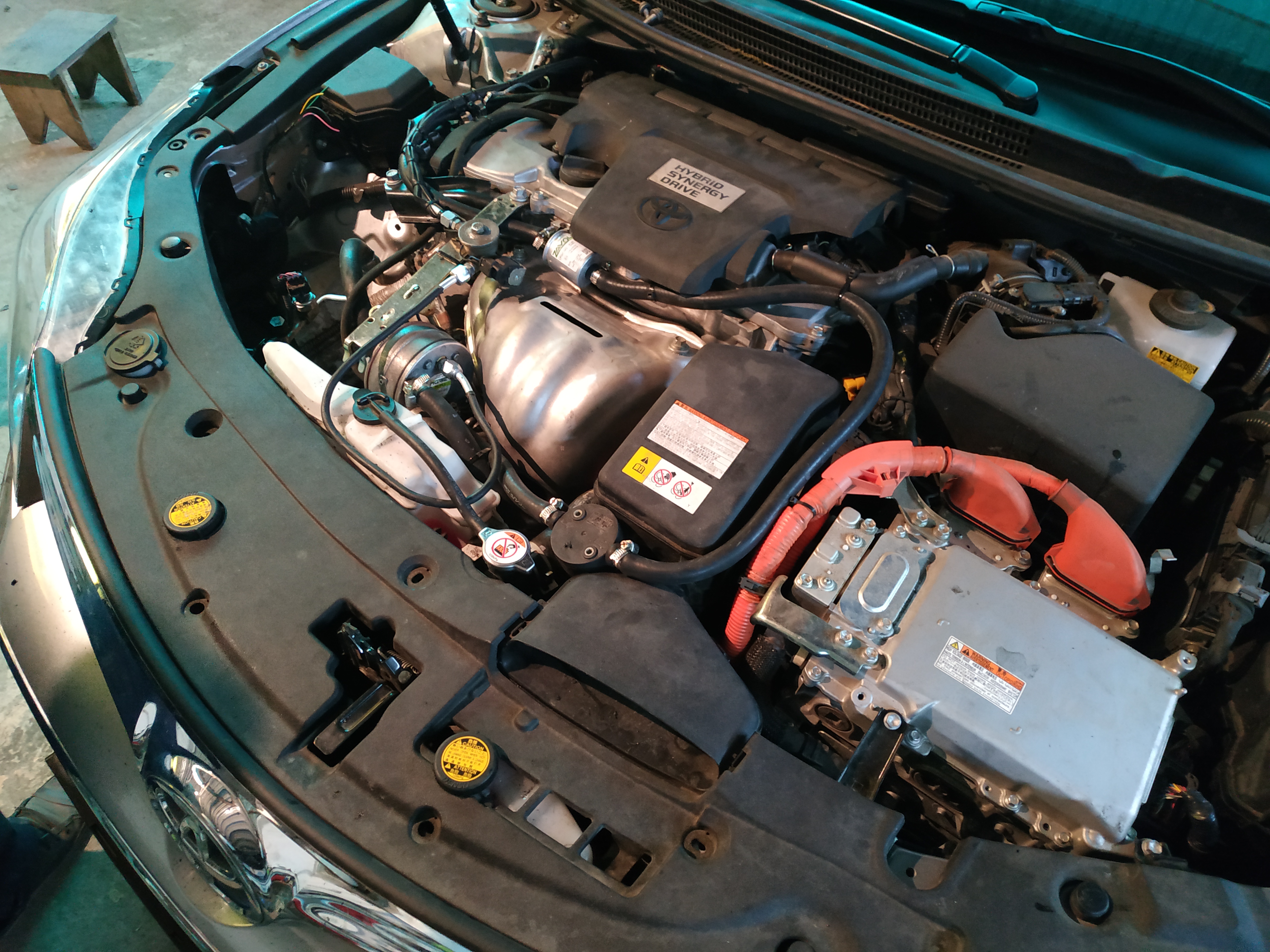

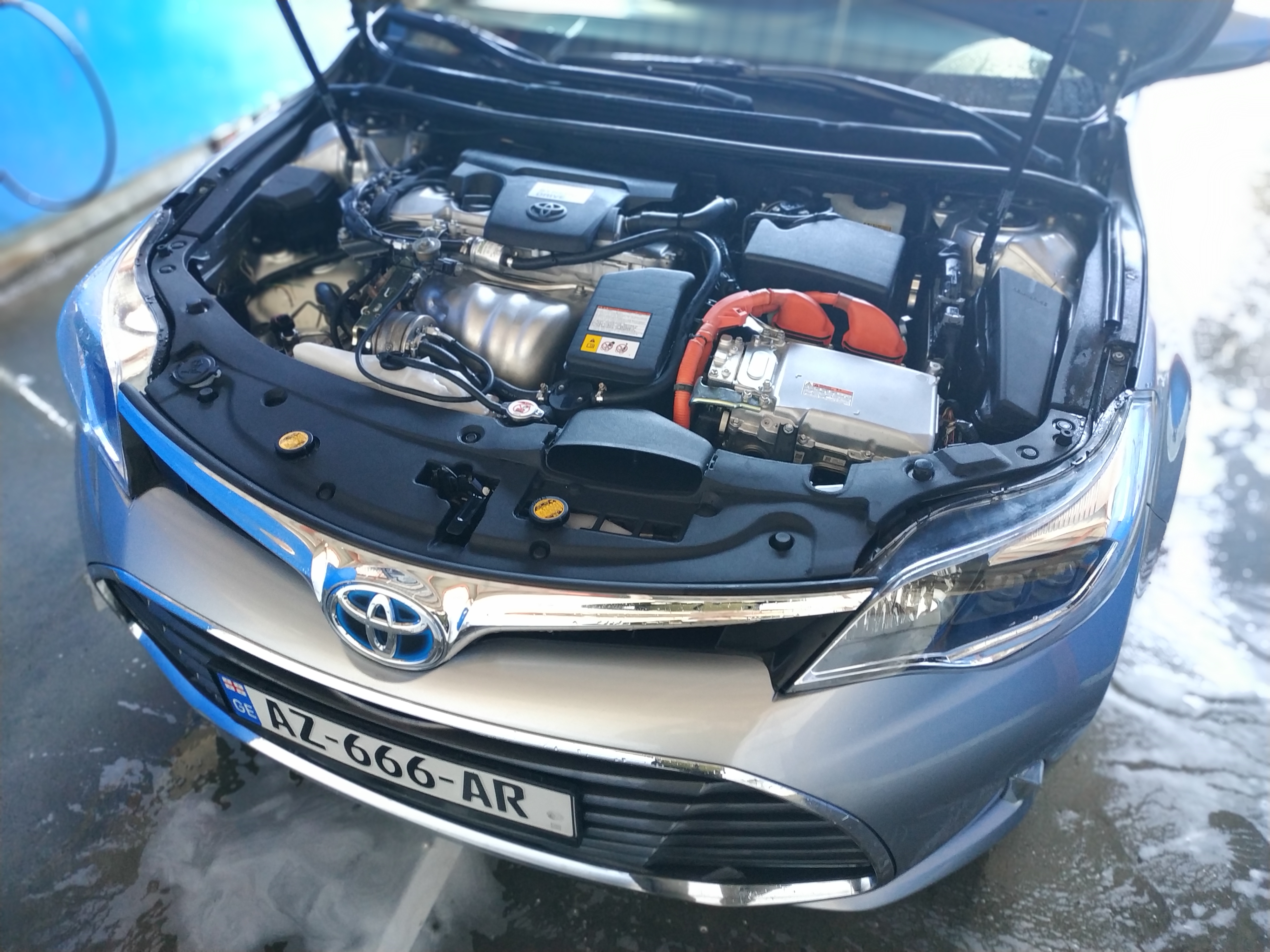

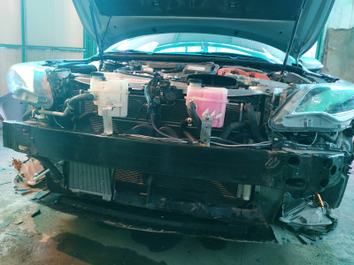

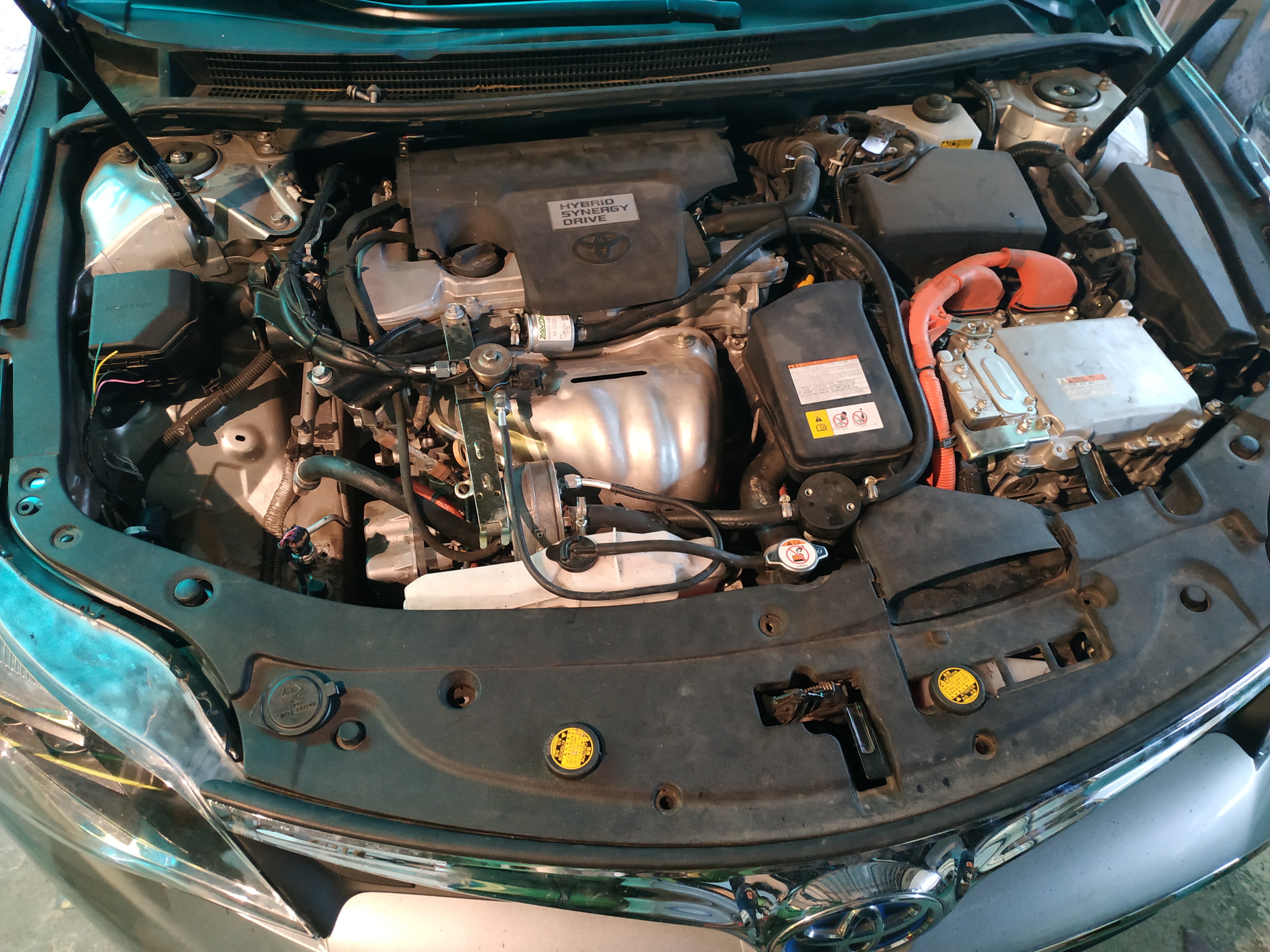

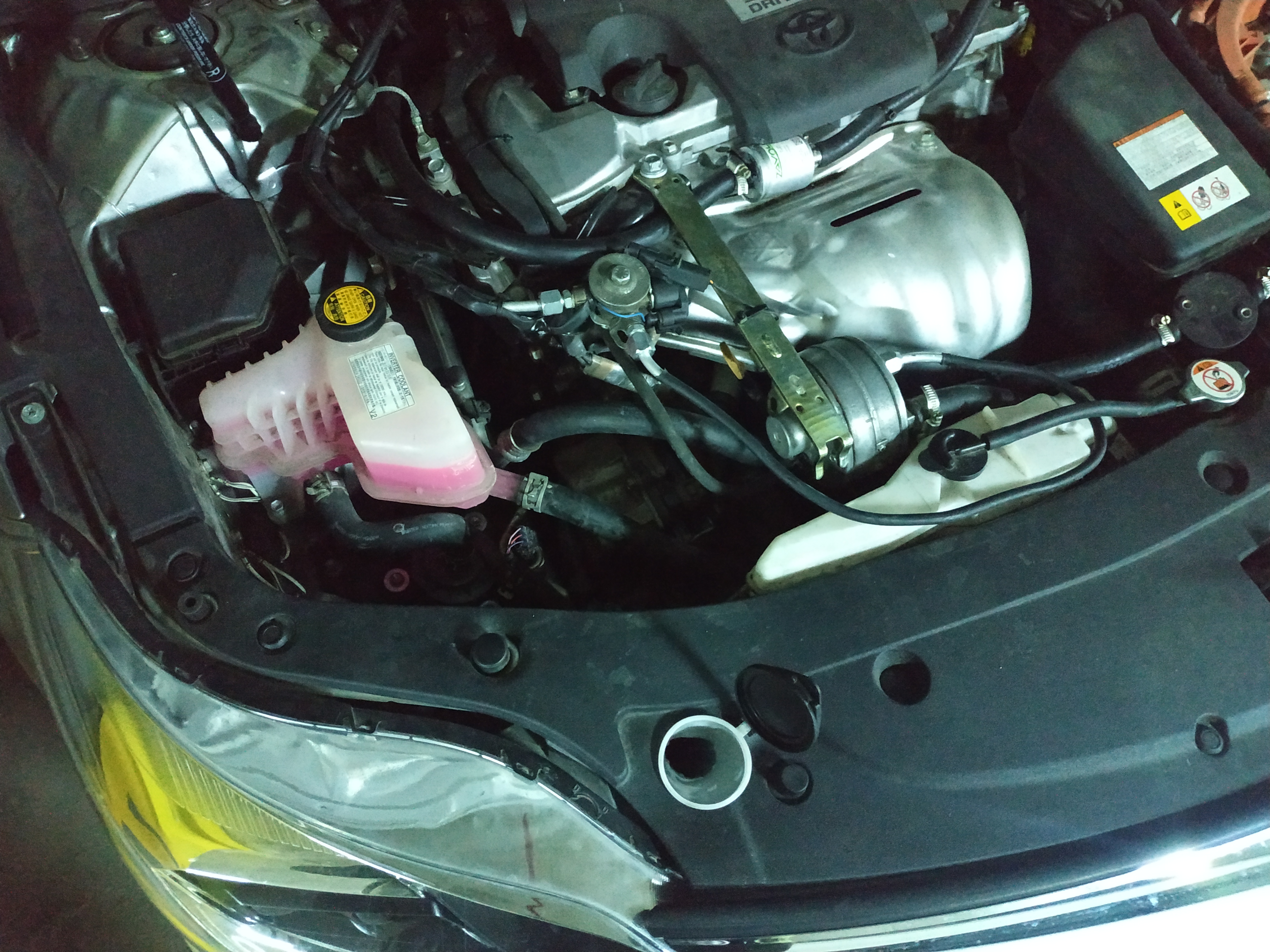

The washer tank was moved, the Propane LPG gas gearbox was moved, it remained to move the tank and the Invertor Pump1 by pushing the place and there I will put the Inverter 2 for the rear axle-the electric reducer of the Lexus RX400h, on a hacked board with current regulation via Wi-Fi and processing of the resolver of the synchronous revving and economical engine.

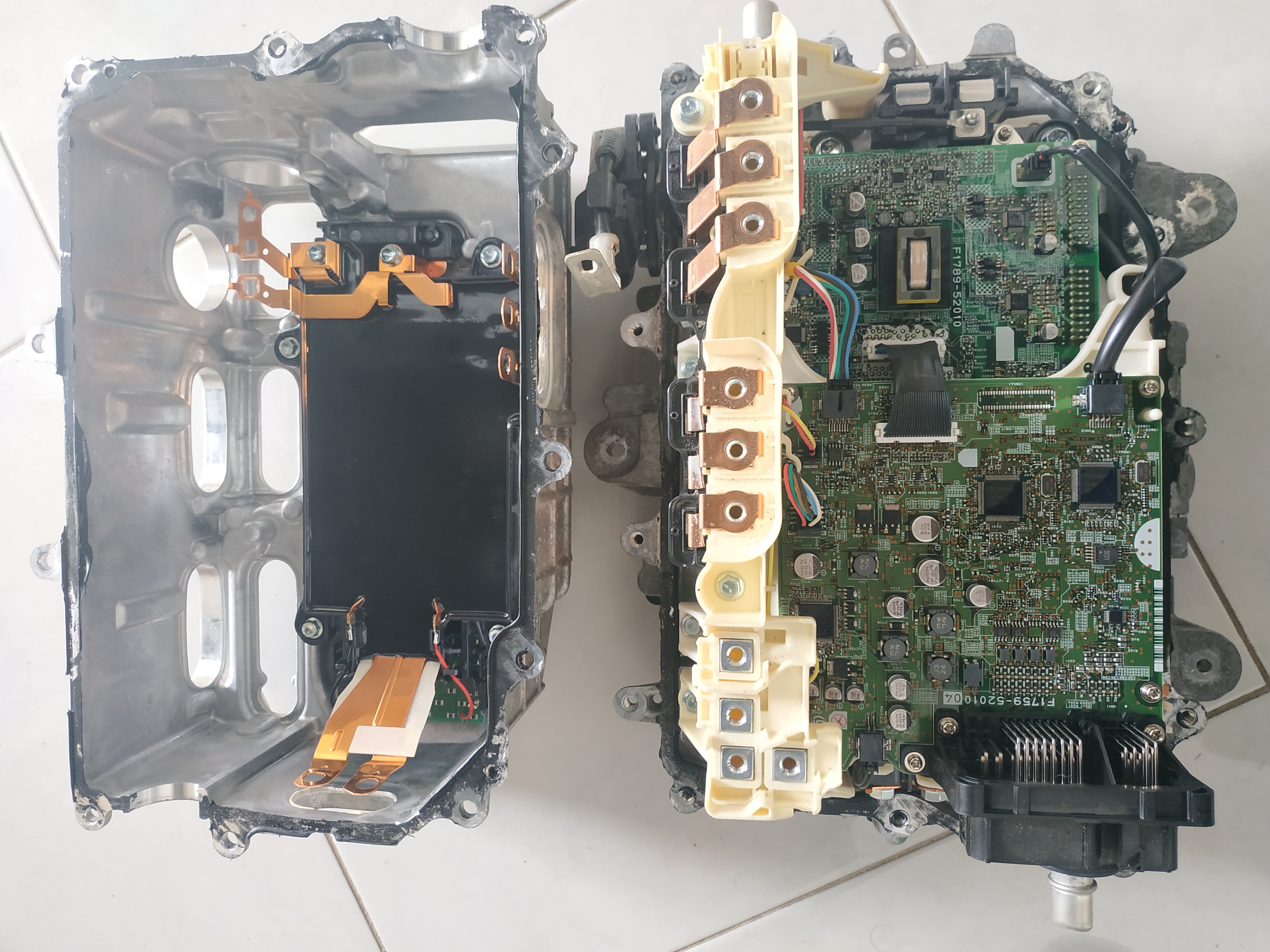

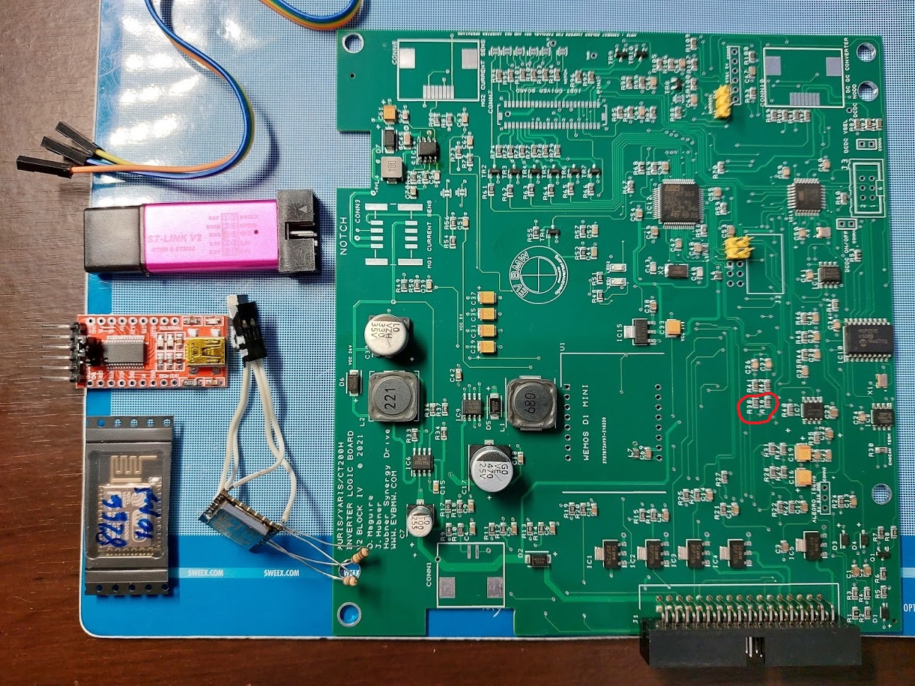

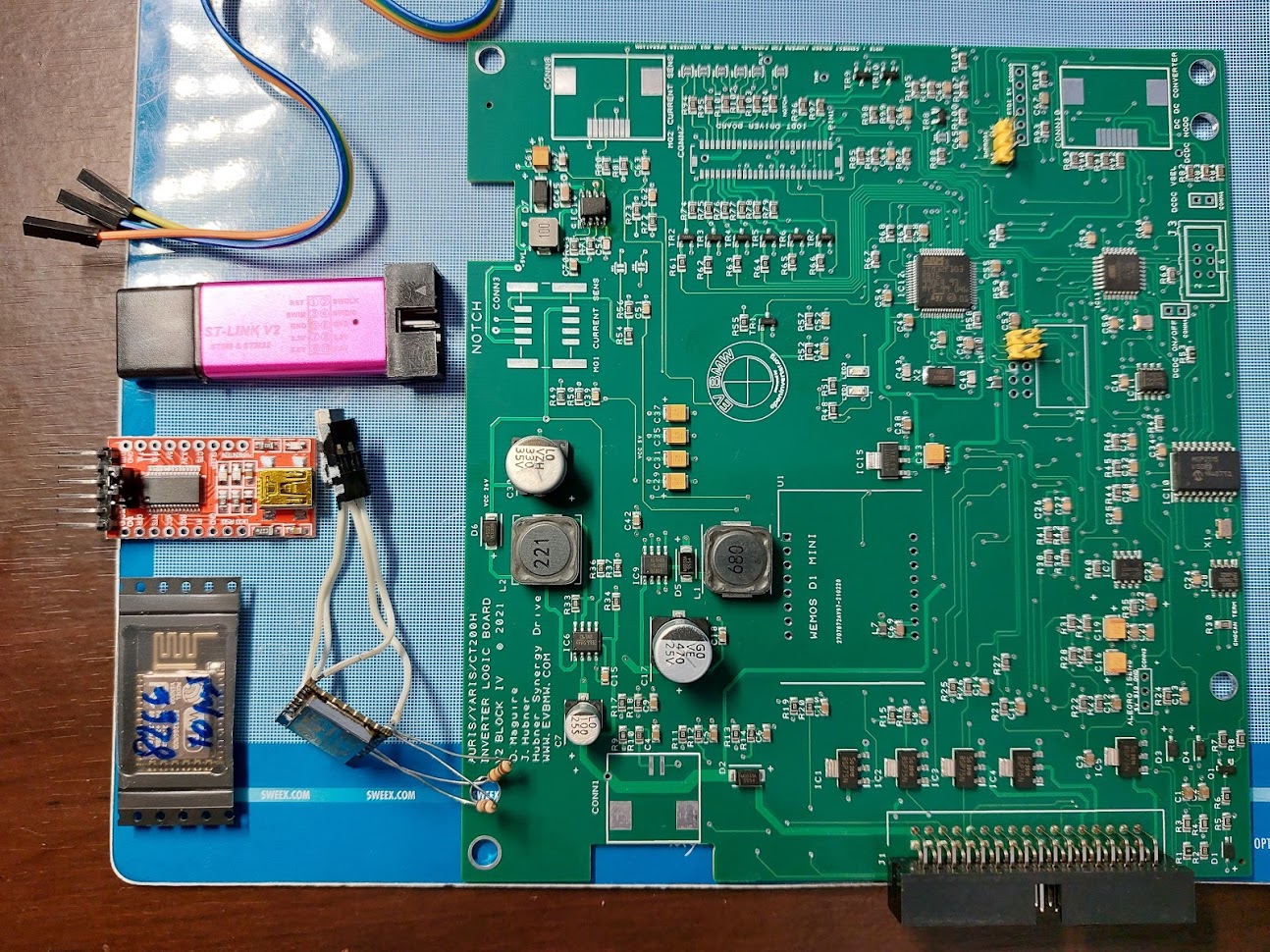

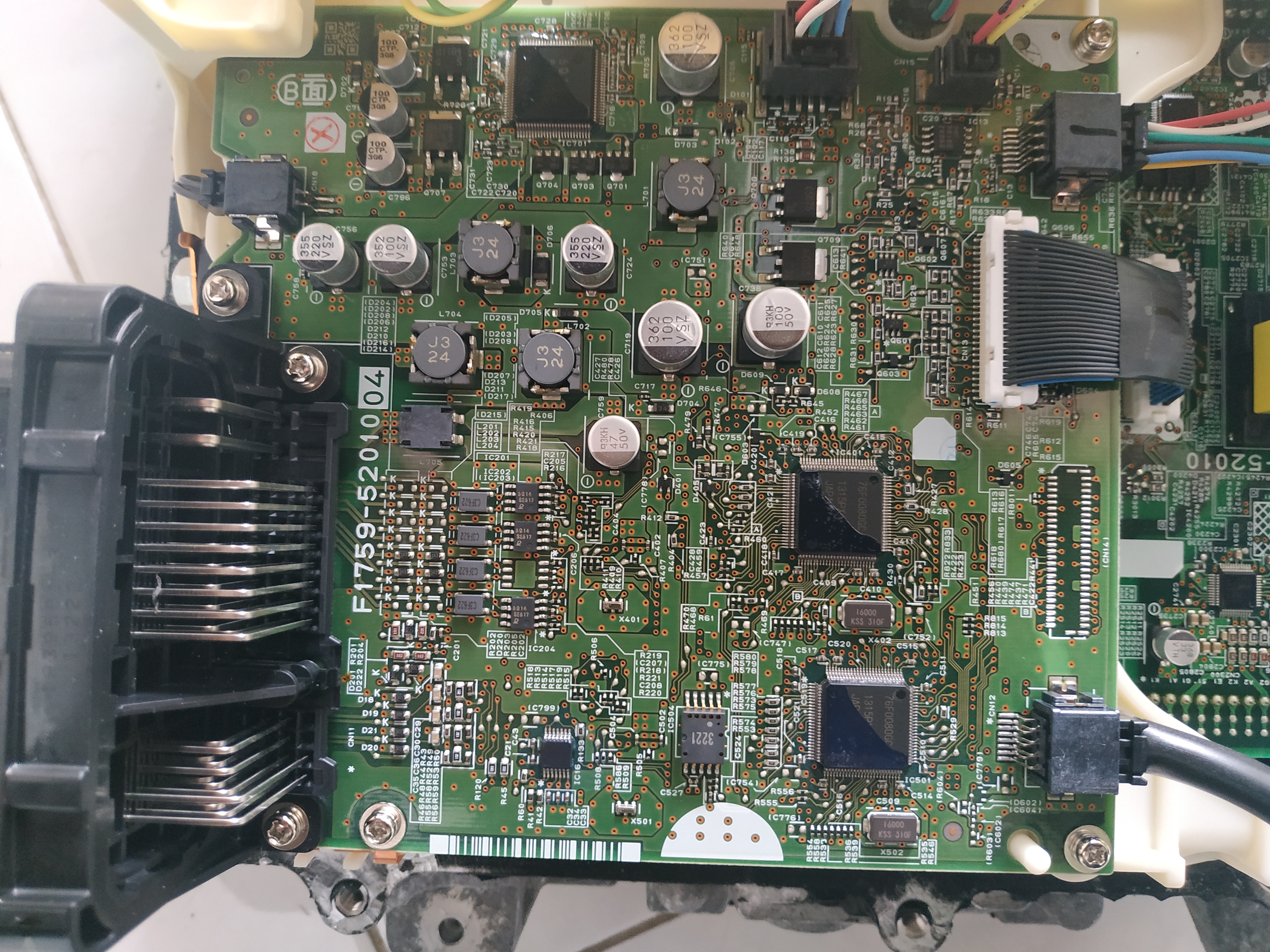

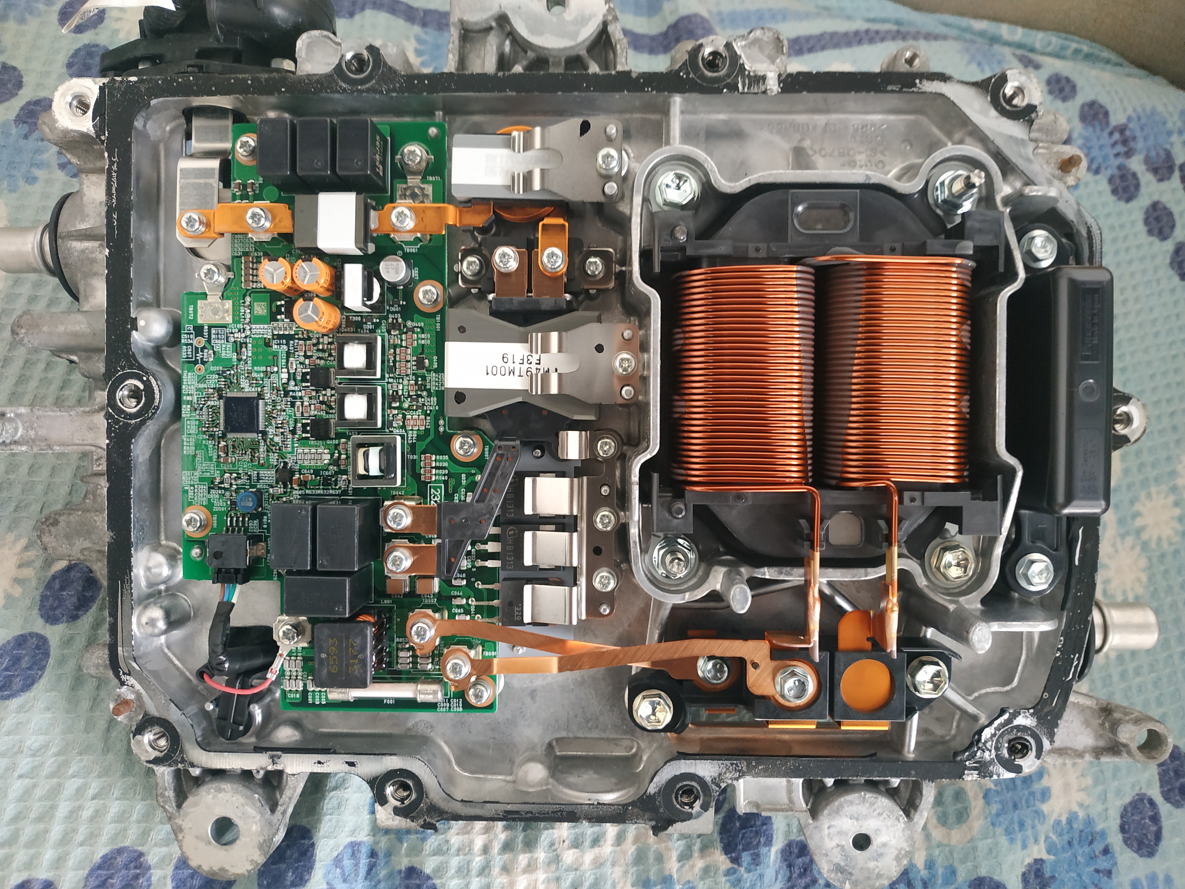

Hello everyone, smart people. It is difficult for me to understand, because I am Azar-speaking (Russian-speaking), I translate through an electronic translator. And I'm not an electronics expert. I'm just used to jumping into a job that interests me. Tell me what resistors I need and where to solder them. I bought a board from Demian, thank you very much. These 2 resistors R38, R39, what needs to be soldered, and in what place they are. Is it possible to close the lower lid on the sealant already? What should I do to make it work as a charger? What and where to connect? I have a Battery from the Toyota Avalon 244.8 volts, and the Inverter from the Toyota Aqua is also on the same ze battery, and the engine is also such a 3-phase power from 380 to 650 in the peak from the Lexus RX400h. Pokadite who at hand has information, please.

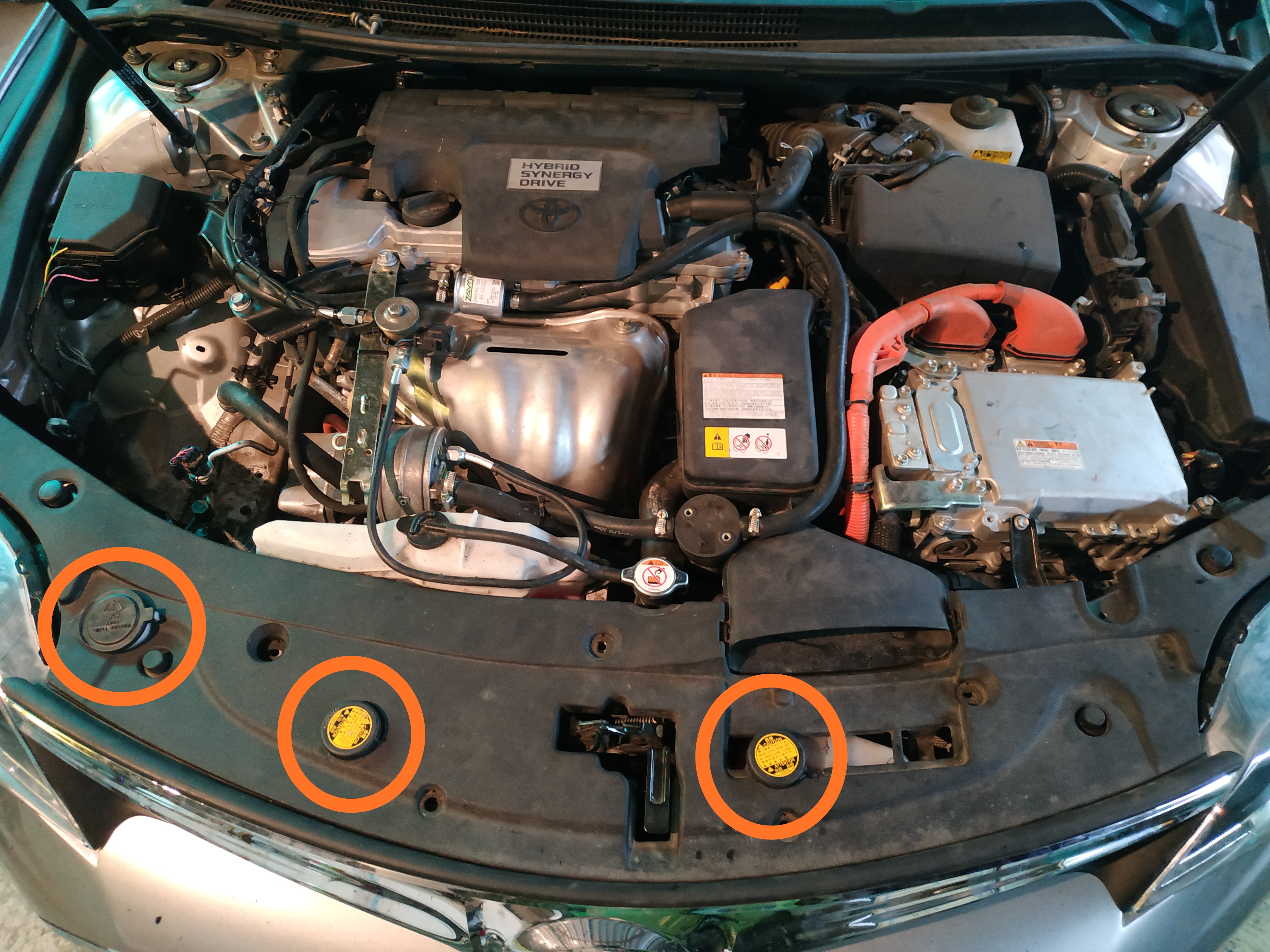

So I made a permutation. Now I have made room for a second inverter on the rear electric axle-gearbox Lexus RX400h.

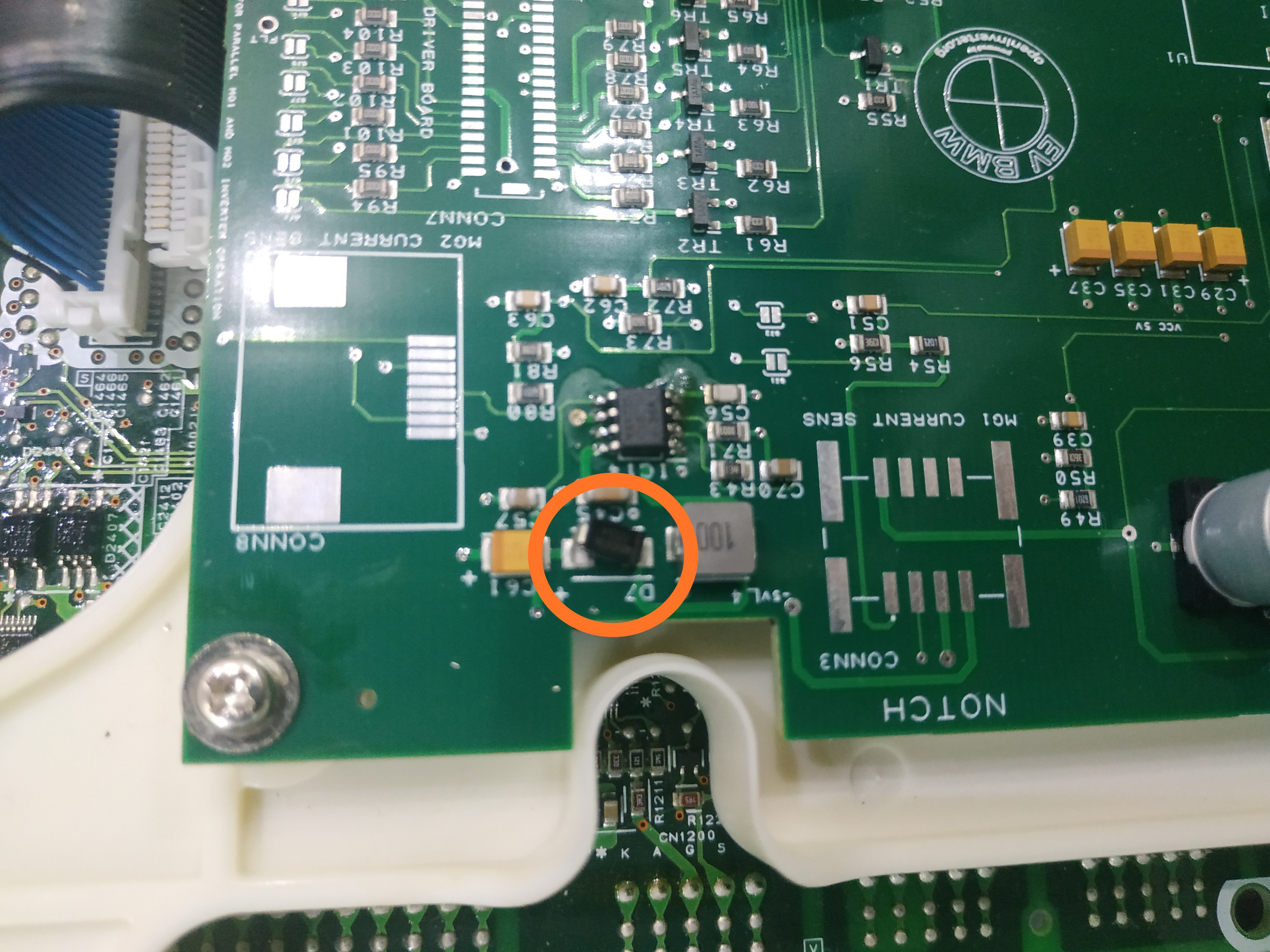

tell me please where are these resistors R38 and R 39? Which board are they on, top or bottom? Whether to remove these resistors. What else can I do? To use Circuit 1 as a charger, what do you need to charge and what do you need to amplify? I have in Aveton Toete the battery voltage is the same as the standard 244.8 volts in the Prius. Advise who understands what to do before installing the inverter, while it is open?
midway
Posts: 100
Location: Ural
Has thanked: 15 times
Been thanked: 16 times
Re: Toyota Avalon Hibrid 4*4
Post by midway »
Remove the resistors on this board. As a charger, it still does not work well.
https://youtu.be/71fKOzV085s write in a personal, I will help with the setting

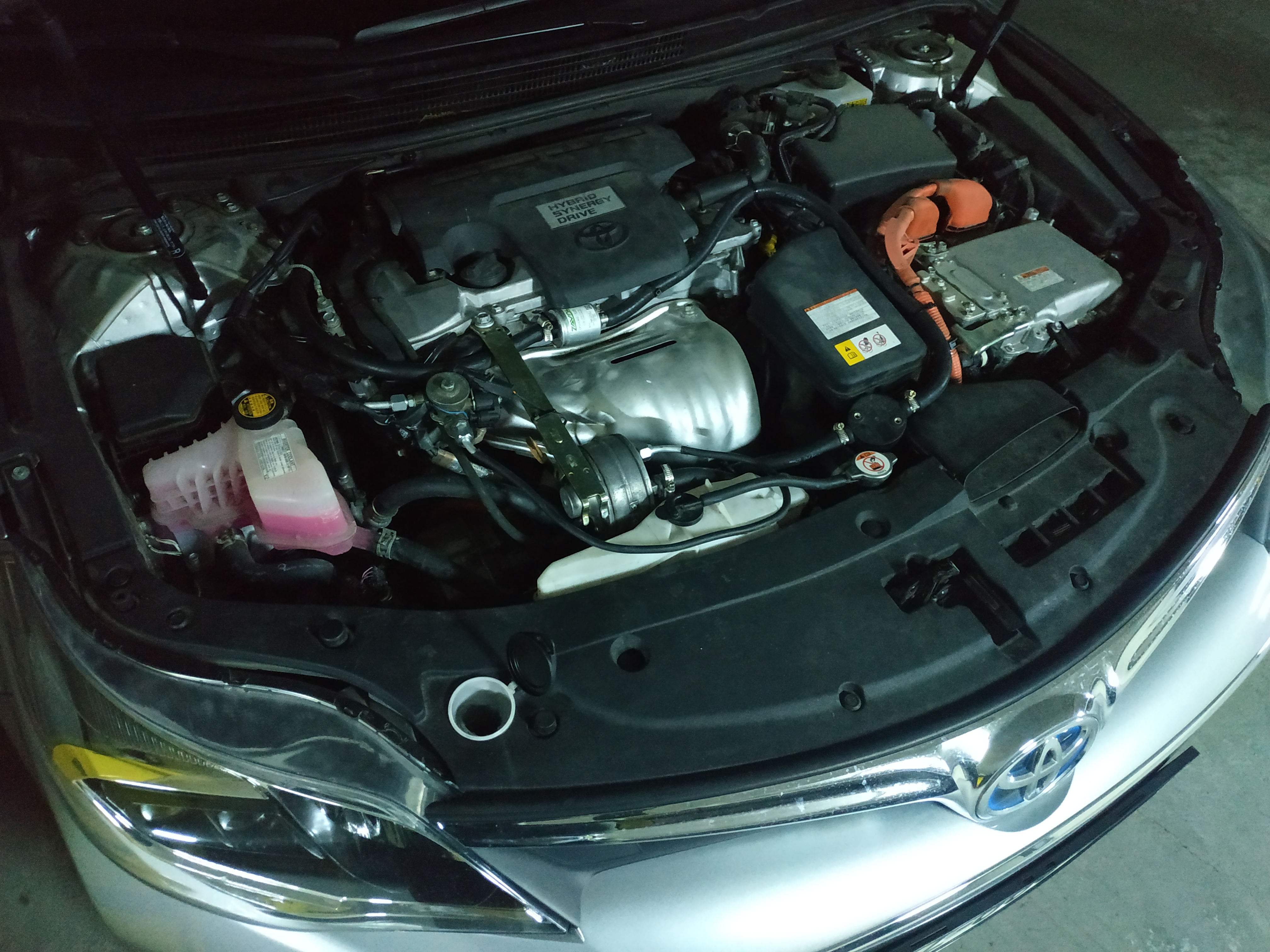

Oh, man. thanks for the tip. I'm waiting for Plvtu by mail Konstantin well done, he told me about Demian. Helped me with a paid purchase. And what kind of charger should I buy then? and which batteries are better? I have a 244.8 volt battery on my Avalon Toyete. I thought to buy not a new battery from Shavrolet Volt, but oam 288 volts, I thought to remove several sections and put them in stock. I have 2 questions. 1) What are the best batteries to buy, maybe what model in China is now a good one is not expensive? 2) What kind of charging for my voltage 244.8 to buy for normal charging and for fast, is there any option in China at an adequate price?

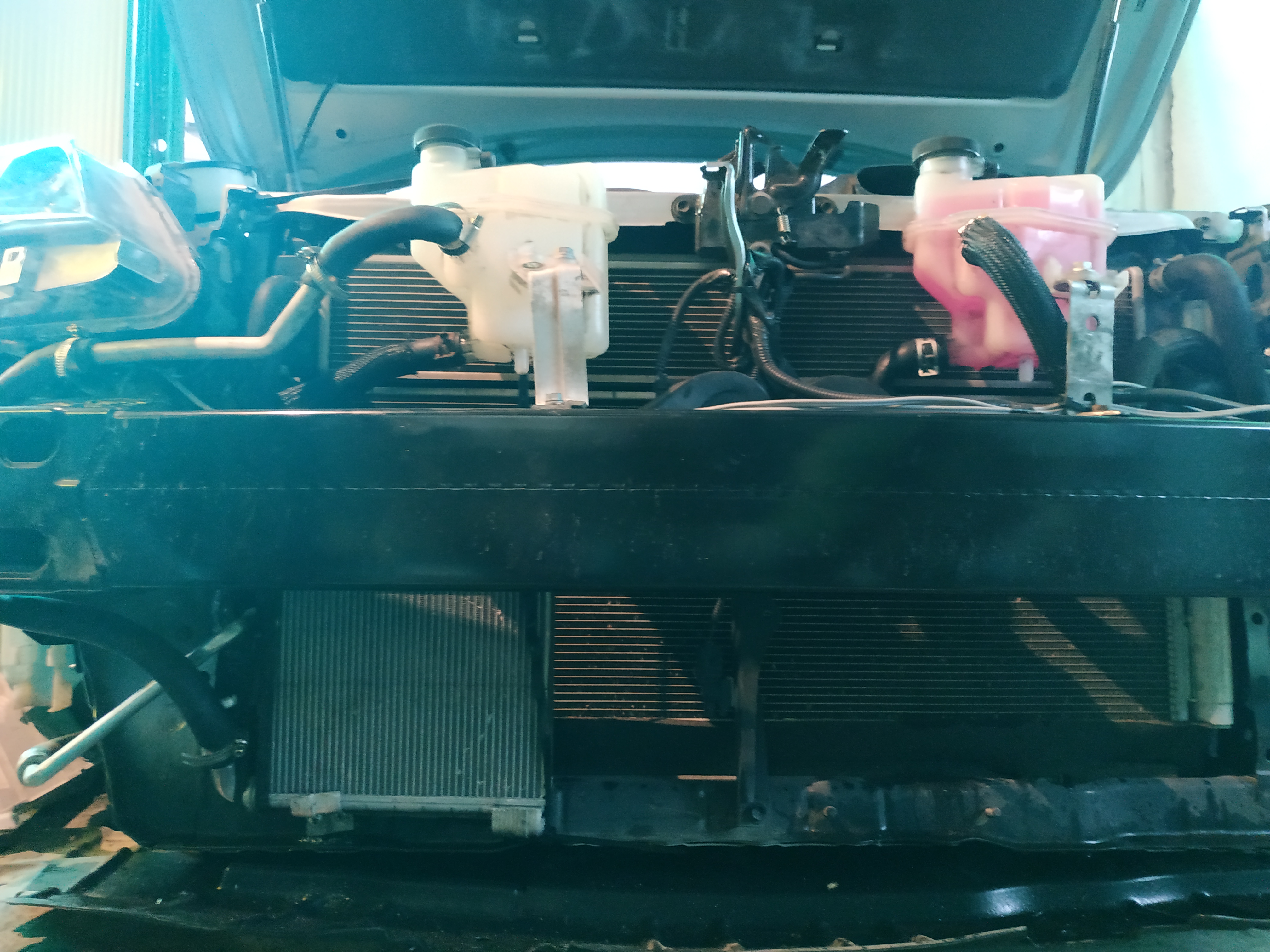

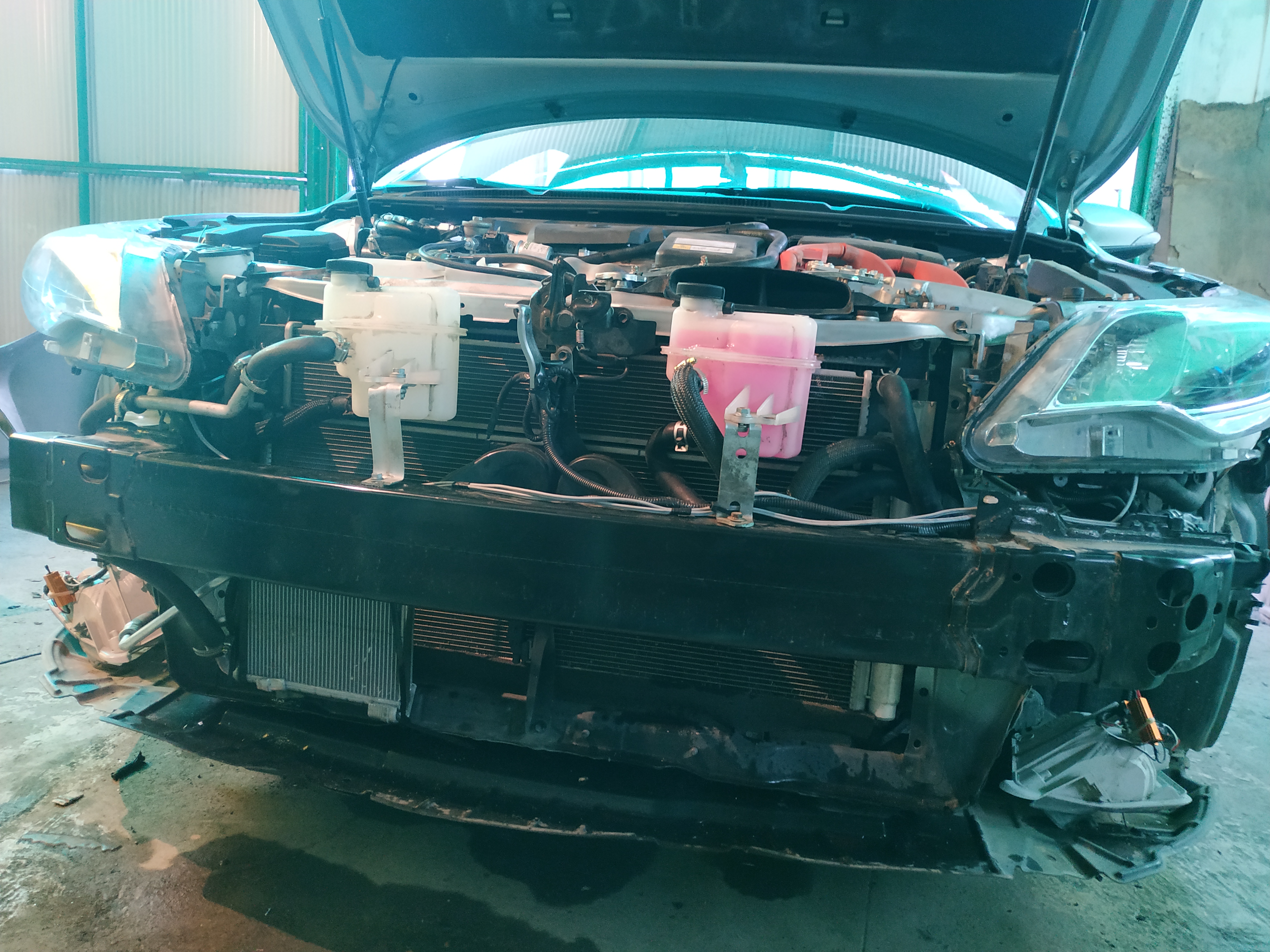

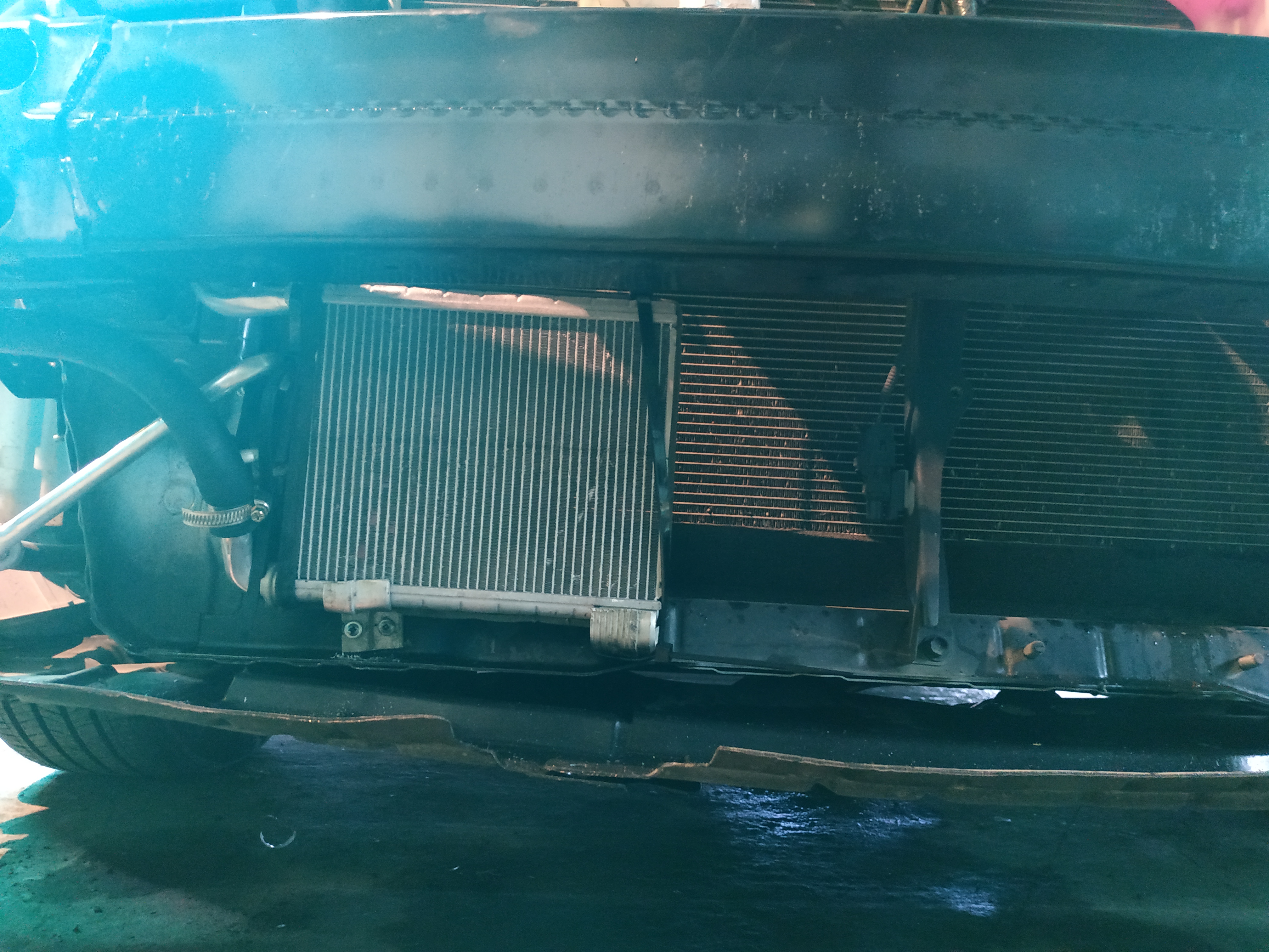

Post by OdArowGUsir »
I cleared a space in front under the hood on the passenger side to install the inverter. I brought the cooling down, it remains to snap the tubes on the inverter, fix it and carefully pour the antifreeze. But as soon as the payment from Demian arrives in the mail, you will have to tinker with the connection. But the "Clean Start" is already approaching.

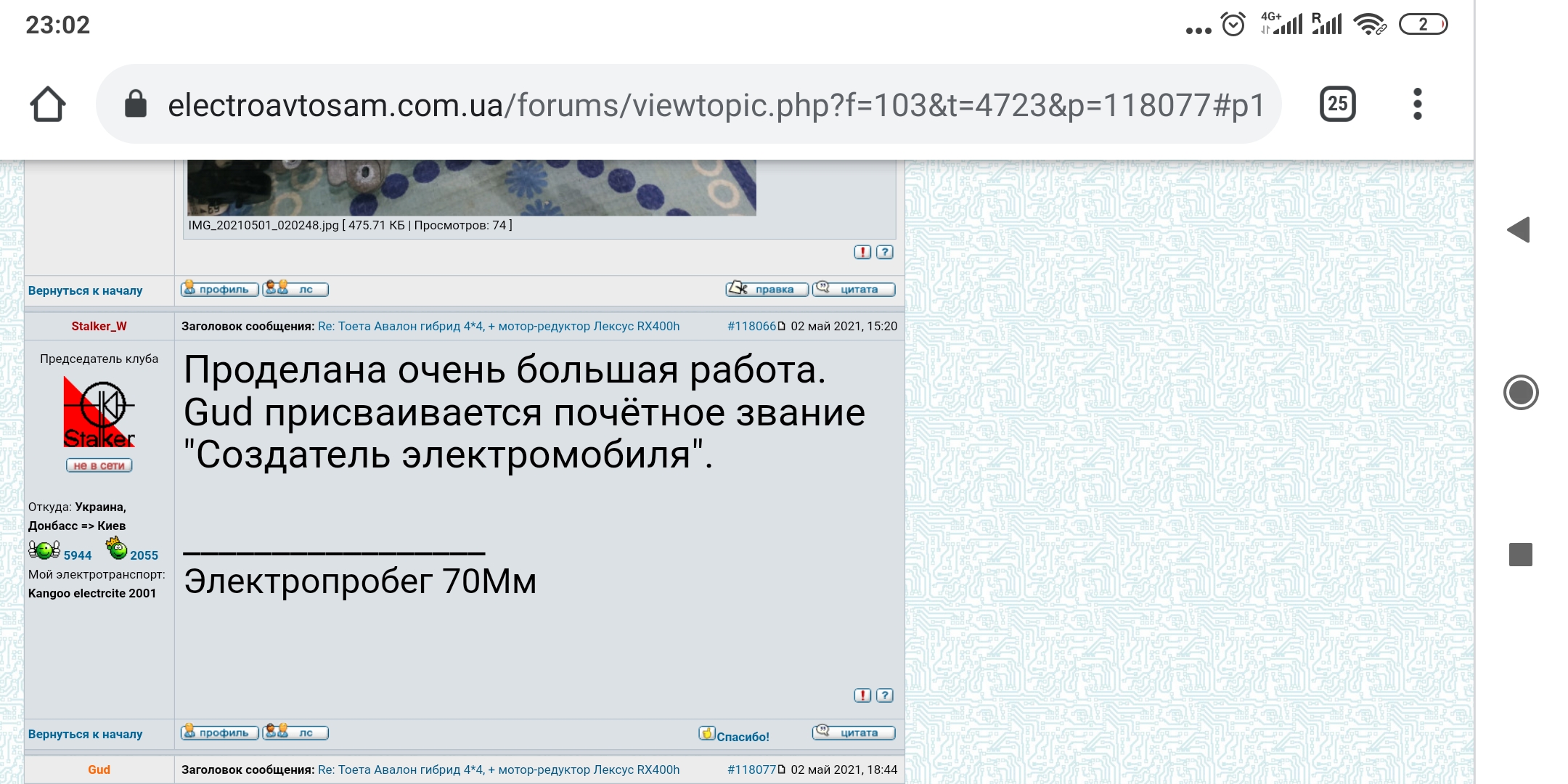

Hooray. I got the status of "Creator of an Electric Car"on one site. Of course, I jumped into this "Pure and Blind Cloud" myself. But I was helped by Demian and Konstantin, thanks to them from me. I think a lot of Azar-speaking (Russian-speaking) people will want to buy boards from Demian. The time for electric traction has come, I think a lot of it needs to be рrepare the boards for sale to Demian.

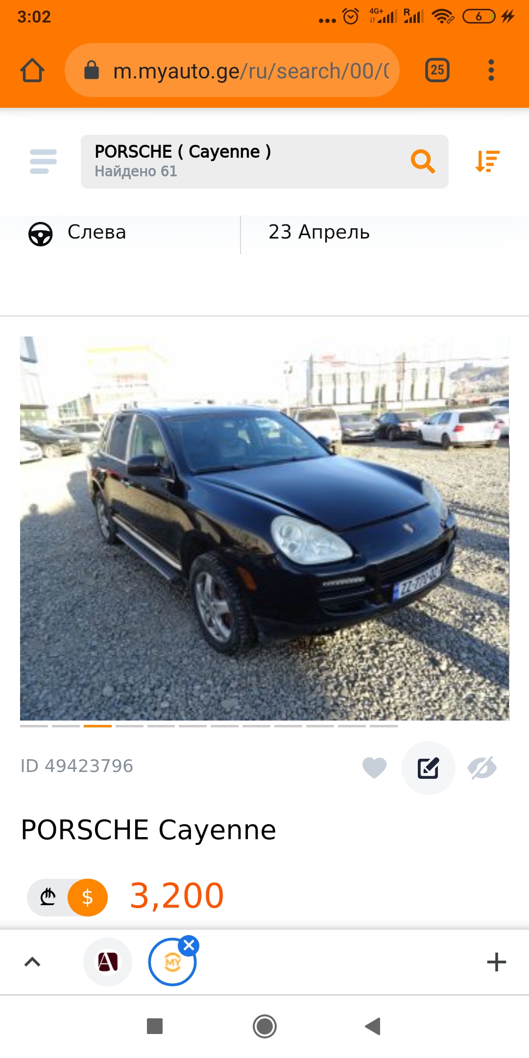

The point of this project is to drive only on electric power from the battery on the second gas pedal 50-100 km, without starting the hybrid engine. And the creation of an inexpensive kit for an electric car. We have a lot of cars in Georgia, Porsche Kaen and Audi A8, with dead engines and automatic transmission. They ask for them for 3000 dollars, and showing the money you can buy for 2000 a good version of the body and interior with small defects. I want to build a kit that can be made and 2 motor and more powerful than the engine is, but to make fully electric cars. This, and cheap to use when charging at the night rate, and the kit itself with an unkillable Lexus electric motor, or two, will cost up to 3000 dollars including a high-voltage battery. And if a single-engine,then 2000 dollars can be met. That is, it is possible for 4000-5000 dollars to collect a Porsche Kaen or Audi A8, Mercedes, without their sores and unkillable electric car, with their comfort, and with cheap driving on electric traction and with liquidity for sale, since there are no customs duties on electric cars. Here, for example, is a good option, with a boiling engine and a dead automatic transmission. To bargain, to repair the interior a little, to put such an electric kit on 2 bridges and to leave the internal combustion engines altogether. With what if you put there 2 electric motors-gearboxes from Nissan Leaf or Toyota Camry and raise the currents in them, the car will shoot up to 5 seconds to 100 km. There is a lot of space for batteries, when you pull out the gasoline engine and remove the gimbals, you can also put a lot of batteries in their shafts. A set of T-shaped battery from Chevrolet Volt for 50-70 km costs $ 1000. You can put them 2. With a Nissan Leaf, the battery costs 2000 dollars for 120 km of such a car it will be enough. This is a city train that turns out to be economical, and comfortable, that there are so few cars and new ones now, and economical to use, no need for any MAINTENANCE, an inexpensive night charge. There is nothing to break in it and a long-lasting electric car will turn out. I train with this car of mine, to understand that everything is possible and tested. I can make it different and with more powerful electric motors. And you do not need to pay such money for a Tesla, it will not be much better, from the Audi A8 I even like the body more and it is aluminum, technological, light, after throwing out all the broken transmission and internal combustion engine, it turns out a reliable and cool electric car in the interior.

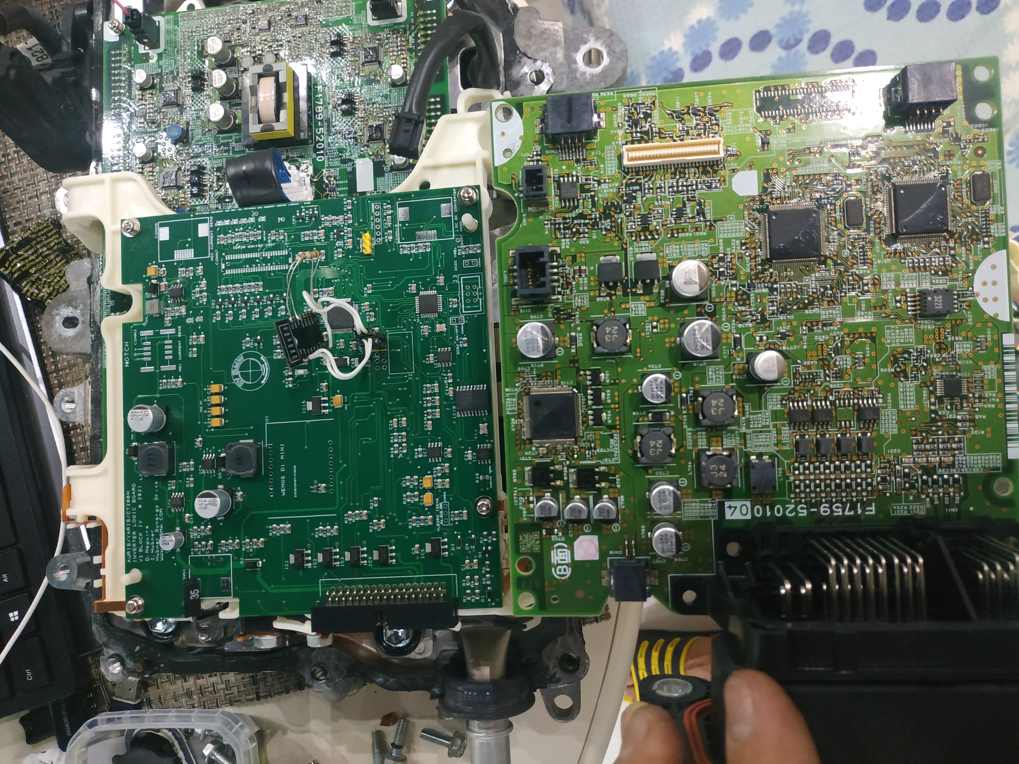

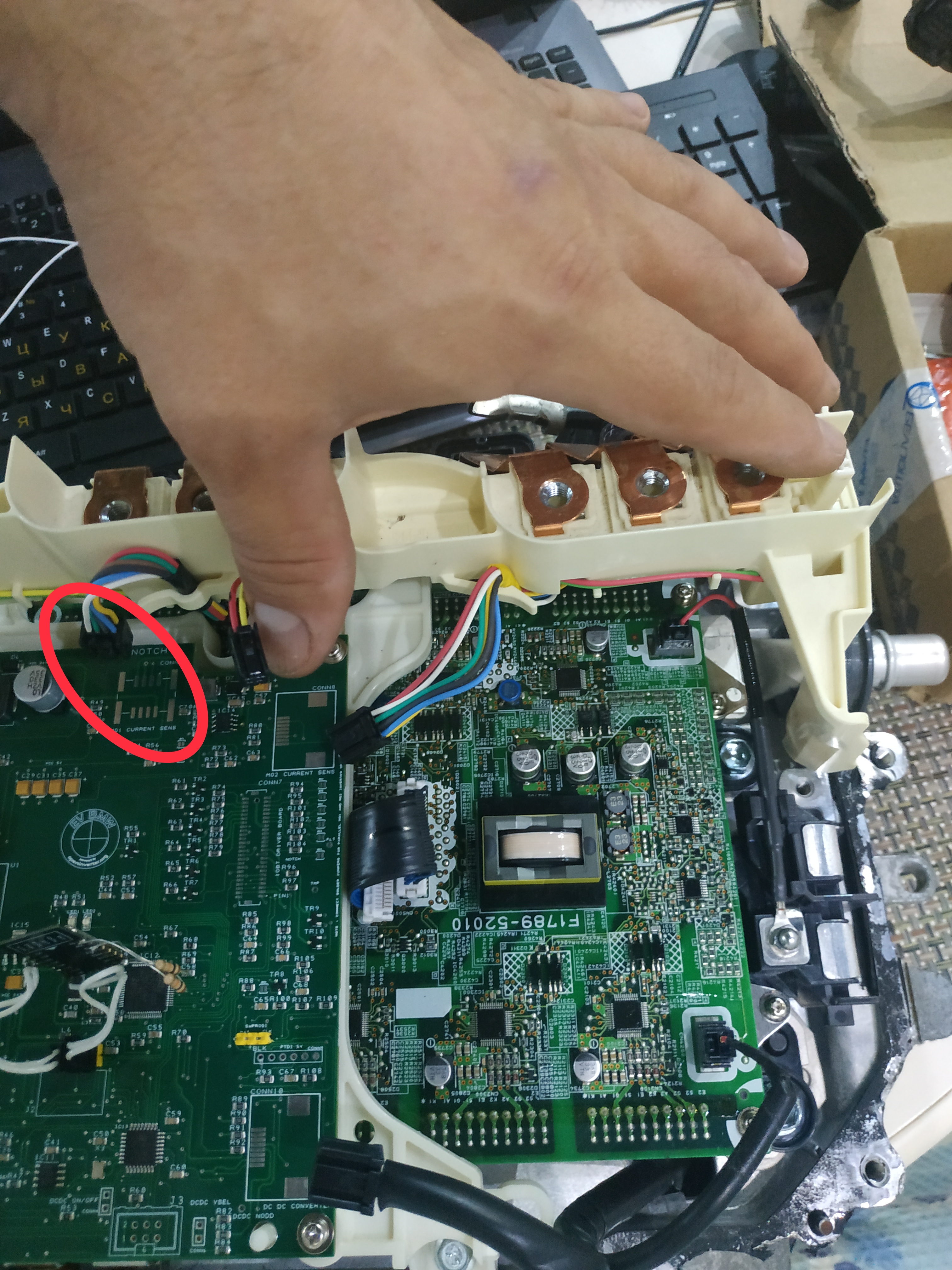

Oh, the payment has finally arrived. So I have a Resolver and I solder the resistors R38 and R39 to the Incoder. But this contact I have in the transfer was cut off, or it is so open and leave, or align and solder?
Isaac96
Posts: 656
Post by Isaac96 »
That looks important, yes, align and solder. Careful!

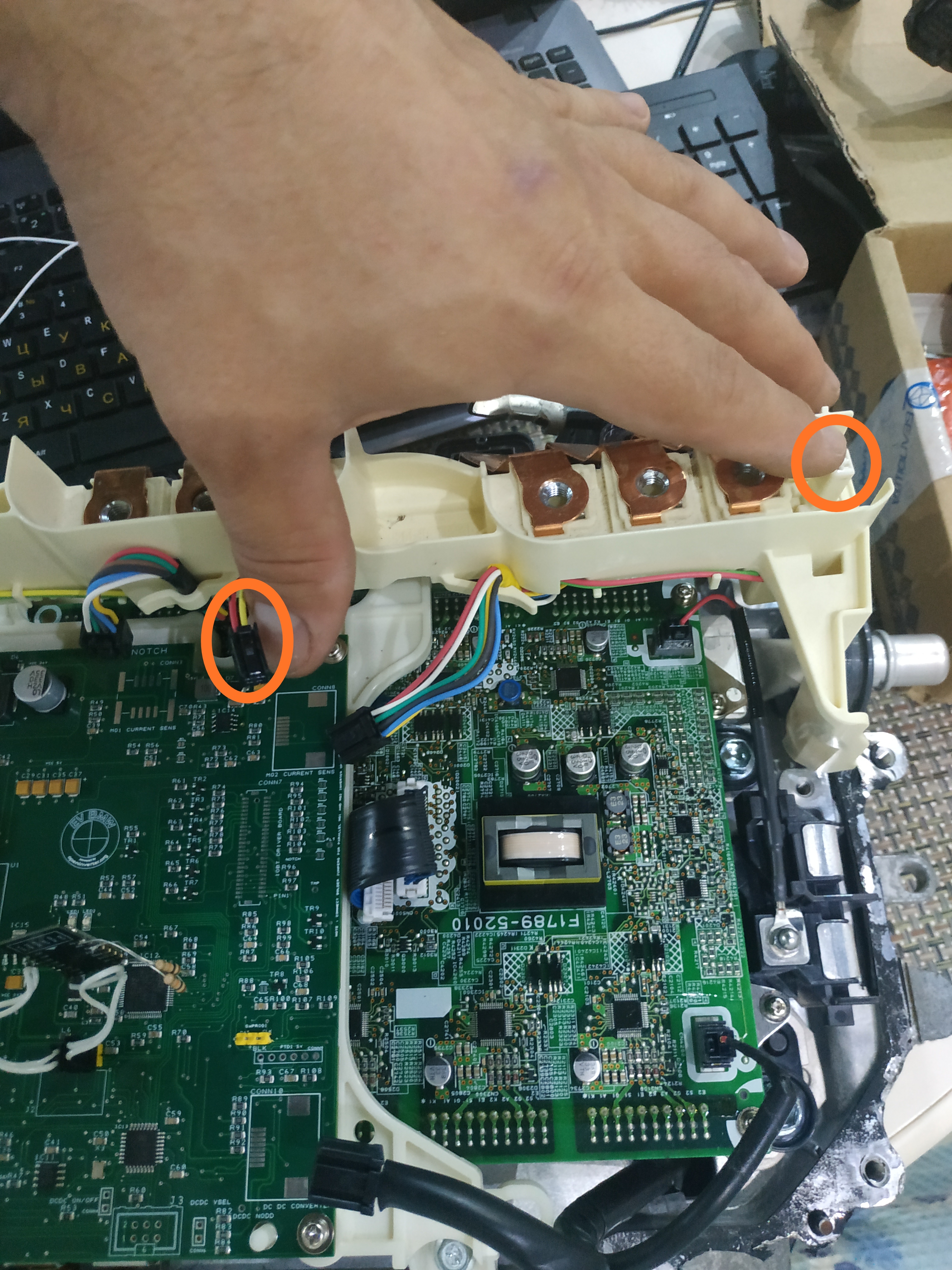

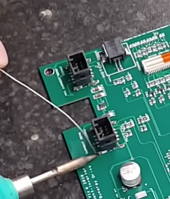

Isaac hi. Thank you very much, I will solder it carefully. But this contact and all the others do not need to turn them over like the Sun at 180°? I saw something there on the contrary it was on some video. I still don't know much about the language, I don't quite understand the videos of Demian and Johan - Ioan. Or on this board, you do not need to turn over the terminals of contactors that are portable from old boards. So everything is the same without a coup? Or just one coup? and here is on this orange klemu seats there is no far perenovit. Demian just sawed it with a knife:) it is not needed?
midway
Posts: 100
Location: Ural
Post by midway »
Screenshot 2020-06-20 at 11.53.27 am.png (255.96 KiB) Viewed 5441 times
The connectors should be like this

надо заказать недостающие детали
missing parts must be ordered
некоторые детали или разъемы можно выпаять из предыдущий платы.
some parts or connectors can be removed from the previous board.
