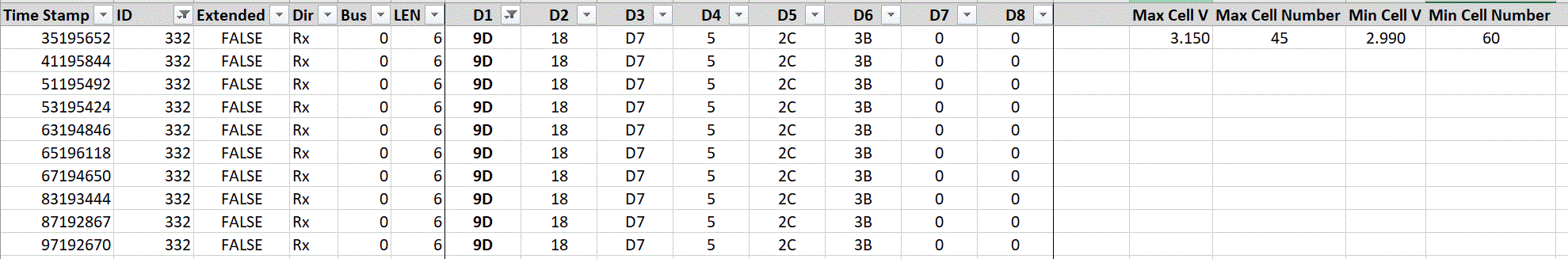

nkiernan wrote: Mon May 24, 2021 1:03 pm Latest capture of the vehicle CAN with the four modules connected up to make full pack and a second CAN capture with 0x500 introduced after approx 10 seconds for comparison. As Collin said, the two extra ID's do show up here too
240521 - TM3 HV Controller - Vehicle CAN - Full Pack Connected 0x500.csv
240521 - TM3 HV Controller - Vehicle CAN - Full Pack Connected.csv
I loaded the 0x500 connected file. It seems like you're dropping a lot of frames for some reason. For instance, 0x332 is sometimes only coming through every 3-5 seconds. It is sent much faster than that. The 0x7D2 message that gets unlocked by sending 0x500 should be occurring every second. That's certainly not happening. It could be because the 0x70A message is spamming the bus. All of these units seem to do that. I think it's looking for the other devices in the car and spams the bus with that message to reach out to them... somehow? You don't see 0x70A being constantly sent in the full car. It gets sent sometimes for a little while but then it stops again. In your captures the 0x70A message is 3/4 of the traffic! 0x132 happens a lot too but not nearly as often.
What are you using for capture? I'm almost positive that I was getting much more consistent results when I captured with a PeakCAN adapter but, alas, I did not save any captures.
Anyway, 0x332 shows this:
Min cell: 2.99v (cell 60)
Max cell: 3.15v (cell 45)
So, that pack is quite discharged. It shows about 7% SOC too.

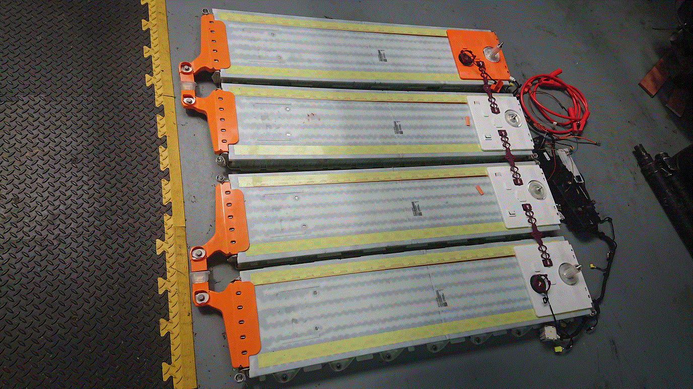

Thanks for looking at the file Collin. I am using a Macchina M2 running M2RET with Savvycan. I'll tidy up the routing and make sure I'm not getting any interference or resistance issues.
Thanks for pulling out that info, I was a bit concerned about the pack as I knew it was well down but relatively new to these batteries and how bad is too bad! So was keen to get some charging sorted and to make sure this BMS and some balancing was working...so this thread has been helpful, and I have a a good bit more to figure out.
I have Damien's PCS controller and getting it set up so should be able to do some charging shortly. Connecting the PCS to the HV controller probably won't do anything for 0x70A traffic, so part of that solution is probably going to need some vehicle CAN mimic at some stage.

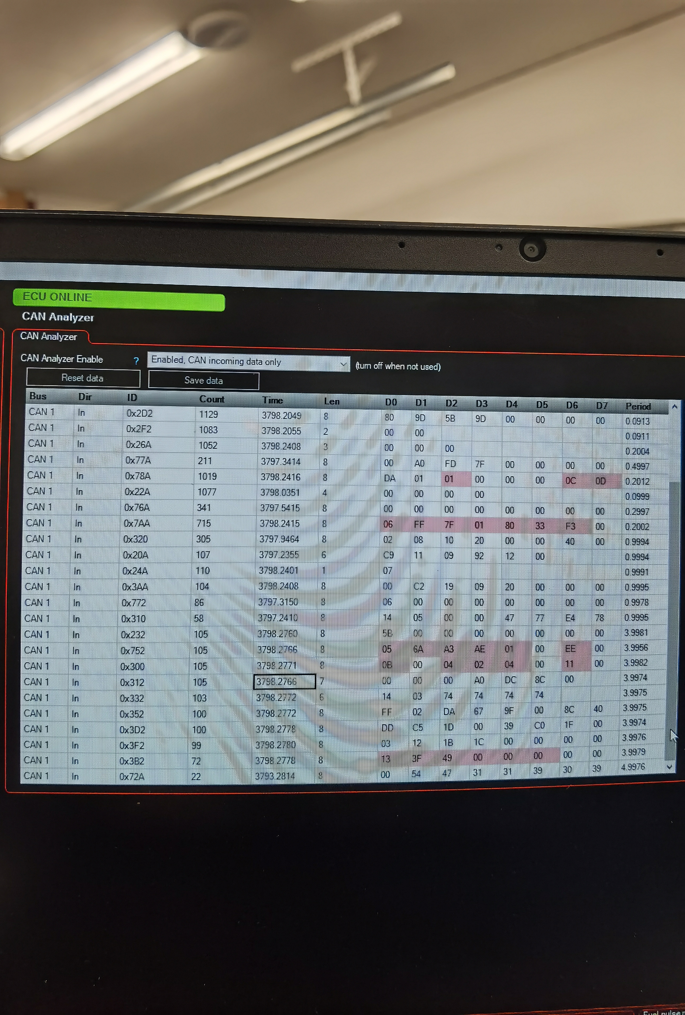

Now it's happening more stuff when I change to pt-can
Very annoying 0x70A, send like 1000 messages/second.
Also tested to connect +30 but nothing remarkable happened to can output
Not really sure how to get the correct info of 0x332, even if your explanation was good.
This is my recent readout from 0x332 approx 1 message/sec
0x332 DD 1F 00 00 14 2F
0X332 14 03 74 74 74 74
I have saved 1 previous canlog, now its time to test if the battey get balanced under 2h, then take a new can log in about 2 hour to see if there been some difference

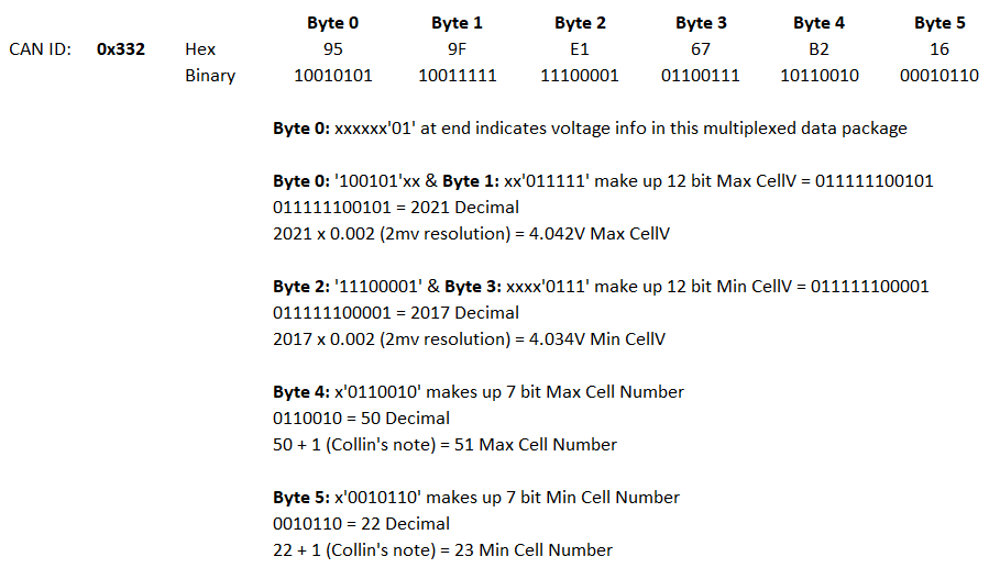

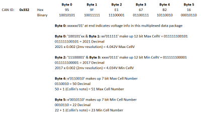

fredd90 wrote: Tue May 25, 2021 2:26 pm Not really sure how to get the correct info of 0x332, even if your explanation was good.
The message is multiplexed which is why you're getting such different data in the frame. It should look to be alternating back and forth between two types.
The bottom 2 bits are the multiplexor.
0 = Thermistor data 1 = voltage data
For voltage data the next 12 bits are max voltage, then starting at the low bit of byte 2 there's a 12 bit number for minimum voltage. Both are in 2mv scale. Then the cell numbers for each are in the next two bytes. Working it out in your case:
The one that starts with DD is the voltage. 0x1FDD shifted down 2 places (to get rid of the multiplexor bits) is 0x07F7. Multiply by 0.002 and you get 4.078V. Of course, what does not make sense is that 0000 * 0.002 is still 0. This means it thinks you have a set of cells at 0V but I doubt that. 0x14 is cell group 21 (0x14 + 1) and 0x2F is cell group 48.
So, it seems to make sense to me except that it claims you have cells at zero volts. Maybe it will say that if it can't communicate to all the cells properly? I'm not sure...

fredd90, had just laid this out before I saw Collin explained above, will share anyway in case it helps:

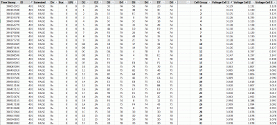

fredd90, what way did you pull out the cell voltages and pack voltage, had you a script or manually? Use 0x401?

Did i manually through 0x401, took about 30 min.

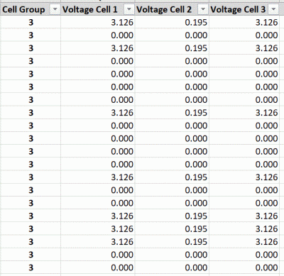

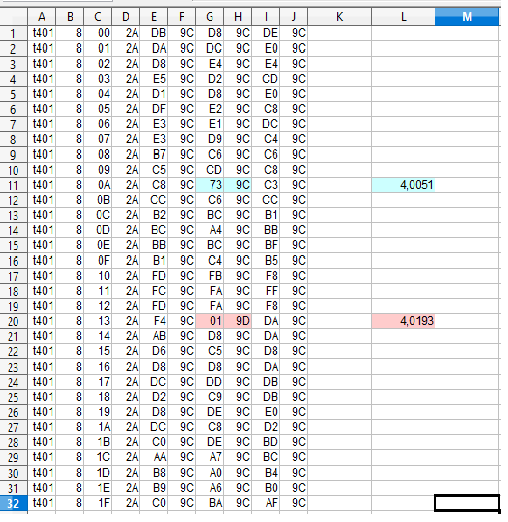

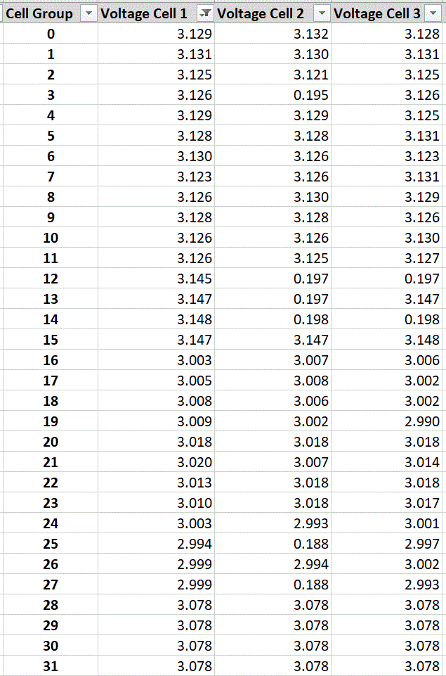

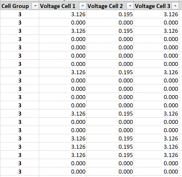

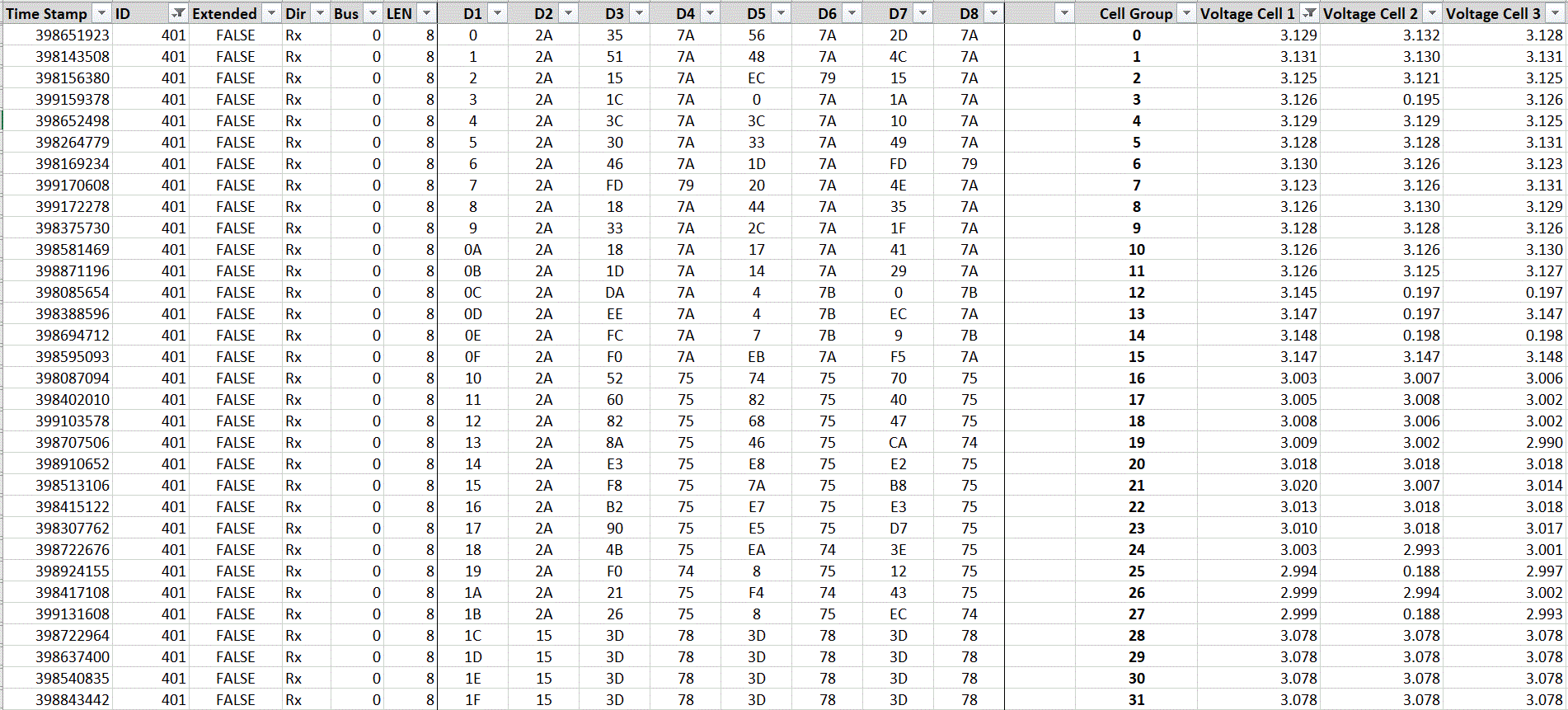

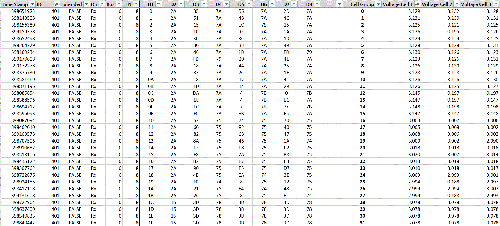

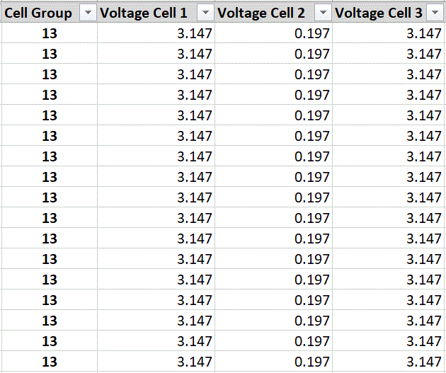

Fredd90, got some interesting results looking at mine to compare with what you have! Assuming I have the conversions right.
Some stray low voltages in there I wasn't happy to see, but when I total these 96 values I get 272.194V. Measuring the actual pack voltage with a fluke meter gives me 294.5V. There are about 8 really low values there, and if they were averaging the same as other cells, that would bring the total up to around the measured value!
Hoping this is just a CAN message issue for some reason! Looking at a couple of the groups in more detail, group 13 stays consistent but group 3 bounces between zeros and these values.
Edit: Just to note, this is for a short range 55kWh pack

Nice work👍. Did you also do it manually?
That is almost like the active balancing shuts off voltage measuring?
Some of Damiens video about just the bms balancing, did he expect the active balancing to be around 250mA if i remember correctly??
If the voltage measuring happens during balancing there would be a huge volt drop due to thin pcb leads.

nkiernan wrote: Wed May 26, 2021 7:54 pm
fredd90 wrote: Wed May 26, 2021 4:27 am
Would be really nice if you nkiernan could do a manual controll of 06, 0F, 18, 1E

Now tested with hvdc wiring in place, 391vcd to hv controller, but still the same readings.
The shunt was also connected, battery "battery always connected pin" got 196vdc
The value of D1 does not change due to missing values. I found these values in CP can not in vehicle can.
I have add my excel file and schematic of hv wiring.
EDIT:, looking trough vehicle can, found 0x2D2 80 9D F5 9B 00 00 00 00 0.0900
1 hour later 0x2D2 80 9D 18 9C 00 00 00 00 0.1000
Maybe max min volt bms? scale 0,0001 bit 4 and 3 9BF5 : 39925 bit 2 and 1 9D80 : 40320
1 hour later, bit 4 and 3 9C18 : 39960 bit 2 and 1 9D80 : 40320
Maybe there is some movement in the lowest cell,
tesla model 3 hv.pdf
(355.03 KiB) Downloaded 445 times
0x401.xlsx
(11.09 KiB) Downloaded 400 times

muehlpower wrote: Thu May 27, 2021 8:18 am
where do the values ​​come from? 0x401 from the CP CAN or can thay also be found on the vehicle CAN. What was the value of D1 in the respective measurements!
For my values, I got them from 0x401 on CP CAN bus with fredd90's help on how to read them. Image below shows the corresponding CAN data:
On the Vehicle CAN bus then, reading 0x332 I get below output for min and max cell voltages and cell numbers (same result Collin was able to read from my csv files earlier in this thread), and this shows a mismatch in results:

I am sure that only the values ​​where D1 = 0x2A are correct. With D1 = 0x15 all values ​​are dummy values. In your case the blocks 0x1C - 0x1F. Unfortunately, the strange values ​​are also marked as correct.

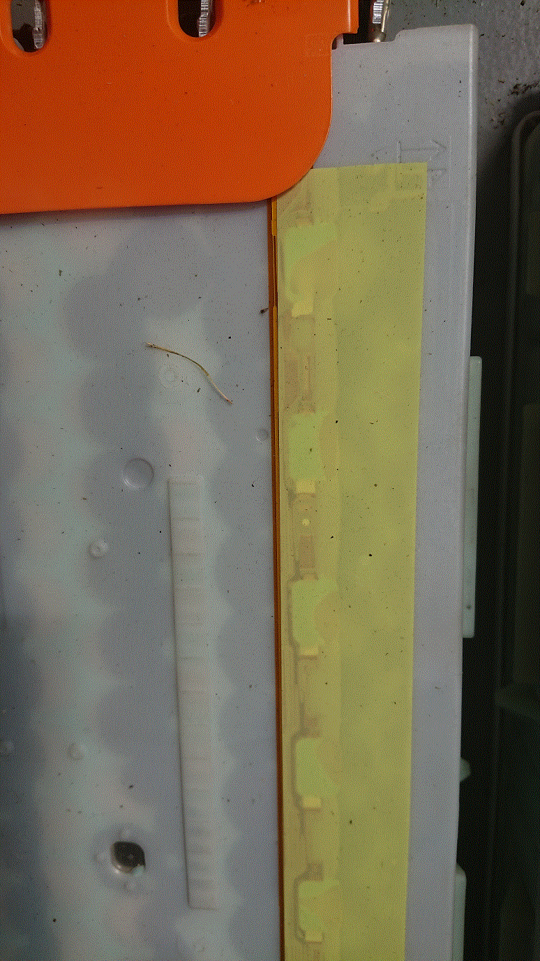

Good to know that the Bms system is redundant, sad to admit that my pack have some problem, the battery cells is probably good because of the high voltage measured by my fluke multimeter. 391,5v.

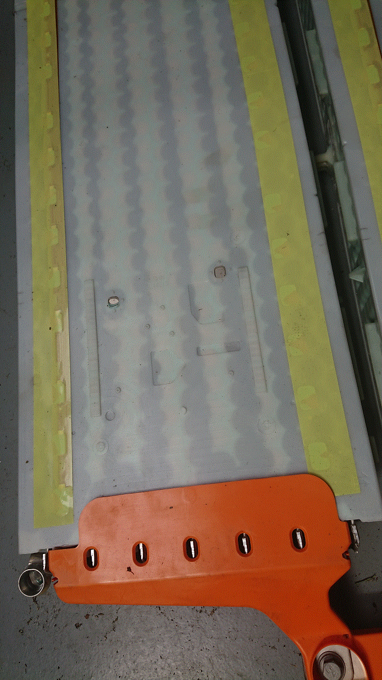

Is there a slight chance of cutting bottom of penthouse and measure? evshop.eu sells model 3 "bms replacement" boards for orion 2 bms, "Just replace original boards and solder" they said.
My battery was from a scrapyard, the donor car looked nearly unharmed, and has around 1600km on the odometer. roof, windshield, hood was damaged.
Could this really messed up bms readings from the end of 4 batterypacks :?
