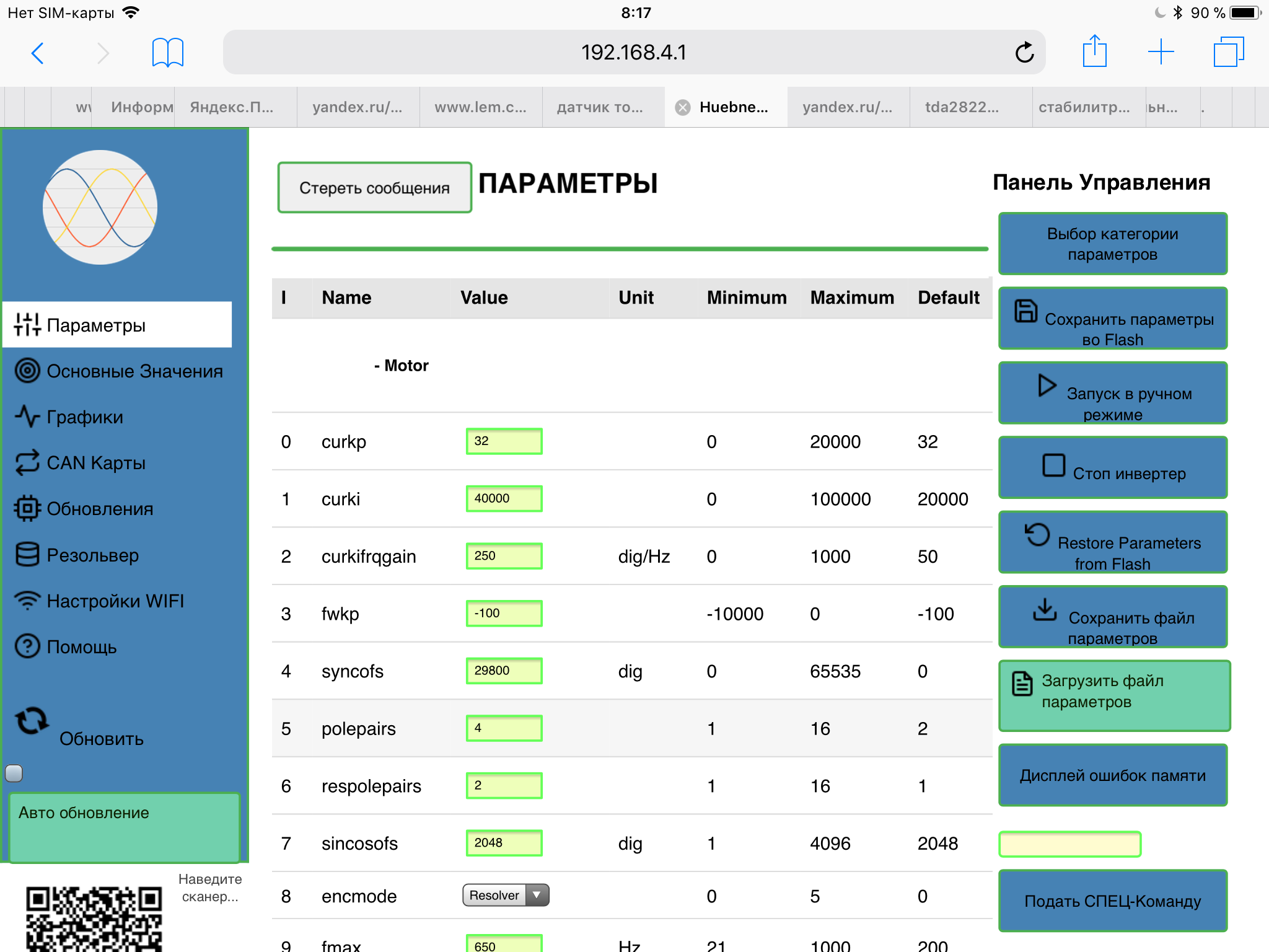

Strange! Lately i went on to program several Wemos D1 mini modules. I tried Original, Dimas code as well as newer code by chrskly. Neither would show parameters. Is there something that interferes with parameters? Olimex ESP8266 mod with really old code works just fine! I tried to swap tx/rx cables to no effect.
Anyone has a .bin file for Wemos D1 mini that works? tnx

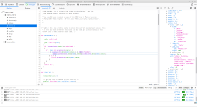

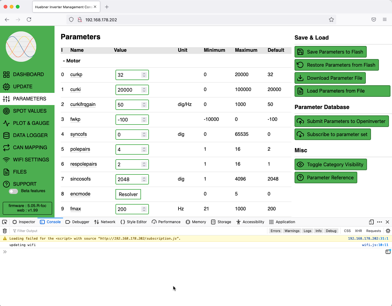

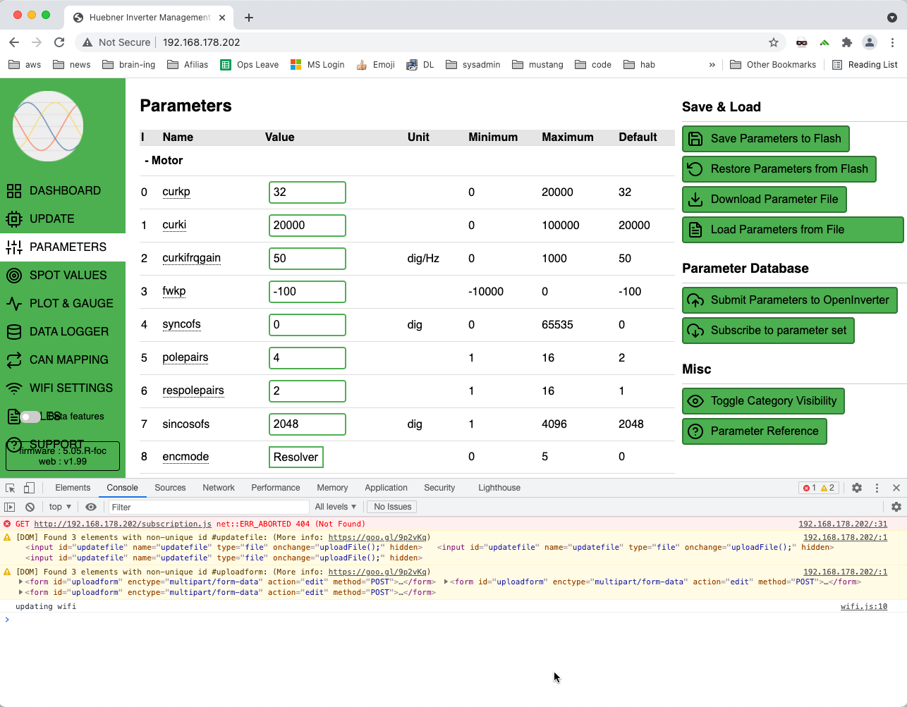

Re: Web interface improvements
If the params aren't showing, then it's likely a javascript error or a file missing from the web interface. Can you post a screengrab of what the developer console on your browser is showing? To do this on chrome, firefox, or edge, right click on anywhere in the web page, and then click on 'inspect'. Then click on the 'console' tab.arber333 wrote: ↑Fri Jul 09, 2021 6:56 am Strange! Lately i went on to program several Wemos D1 mini modules. I tried Original, Dimas code as well as newer code by chrskly. Neither would show parameters. Is there something that interferes with parameters? Olimex ESP8266 mod with really old code works just fine! I tried to swap tx/rx cables to no effect.
Here are grabs from firefox and chrome from my laptop. What method did you use to upgrade the web interface? Arduino > ESP8266 Sketch Data Upload ?
Yes i uploaded ino code and then uploaded spiffs via arduino option.
I will post my screen grab later when i am at my work PC.

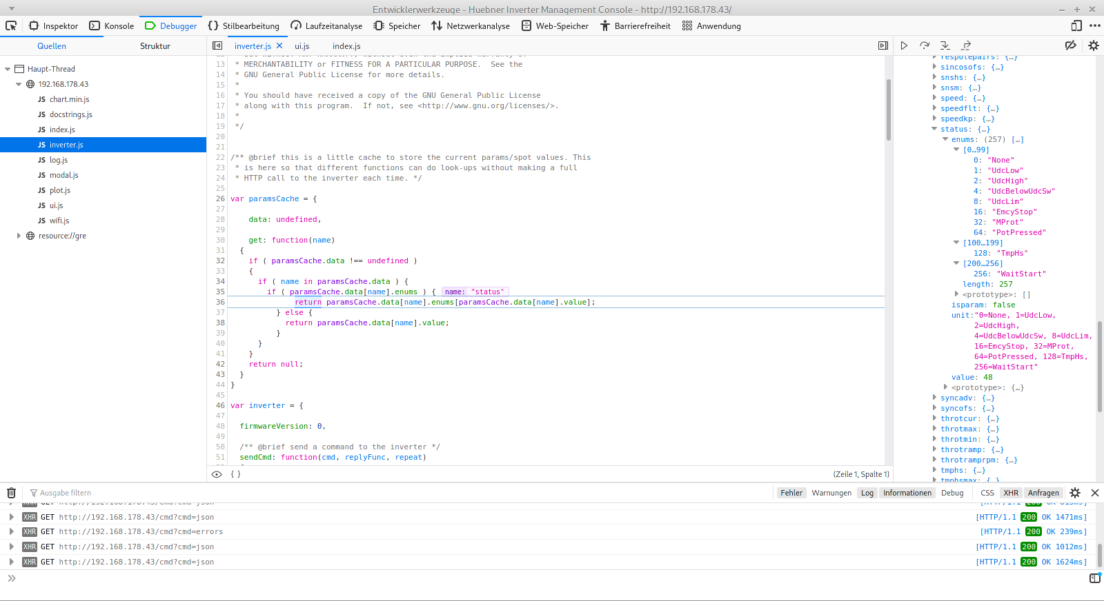

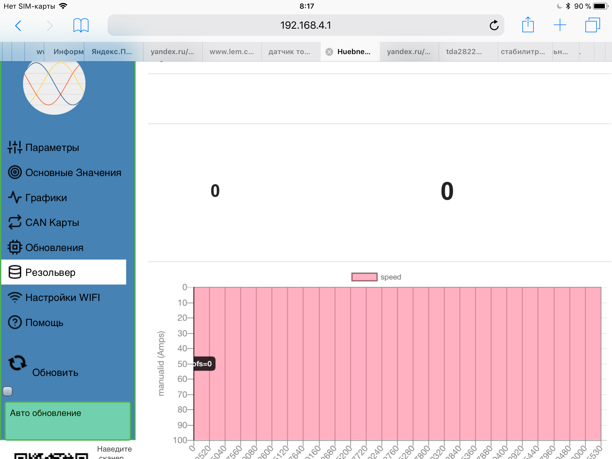

- Been thanked: 1918 times
1. Screenshot attached. It checks for status which in my case is 48 (two flags set). It doesn't handle flag channels so return undefined. Check Spot values implementation on handling (multiple) flags. While debugging I also noticed it calls cmd=json twice.
4. Please no autosaving! I experiment a lot with parameters and CAN mappings and am happy I can just forget them with a restart
Of course you could add optional autosaving as another toggle switch for those who prefer it
