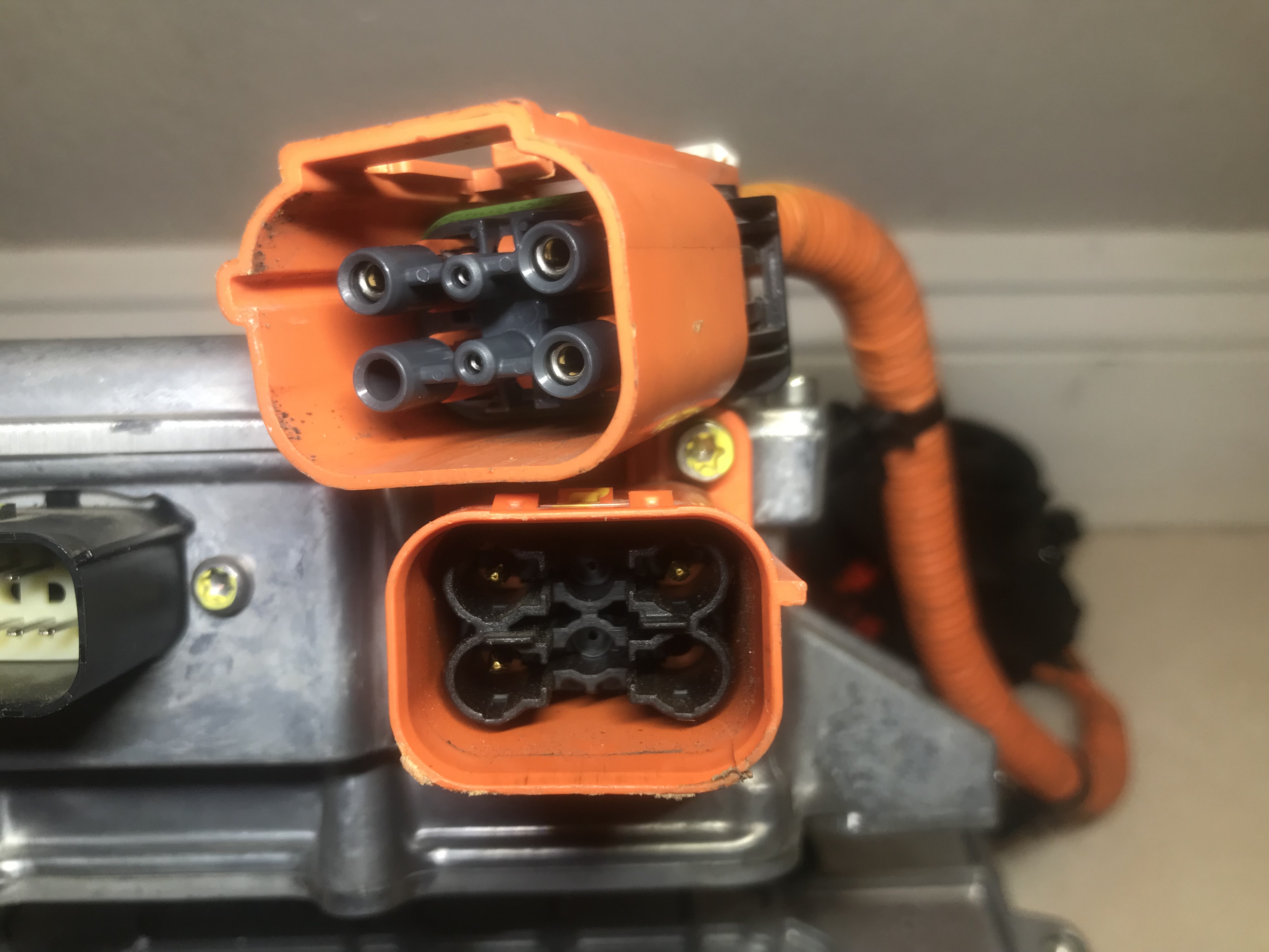

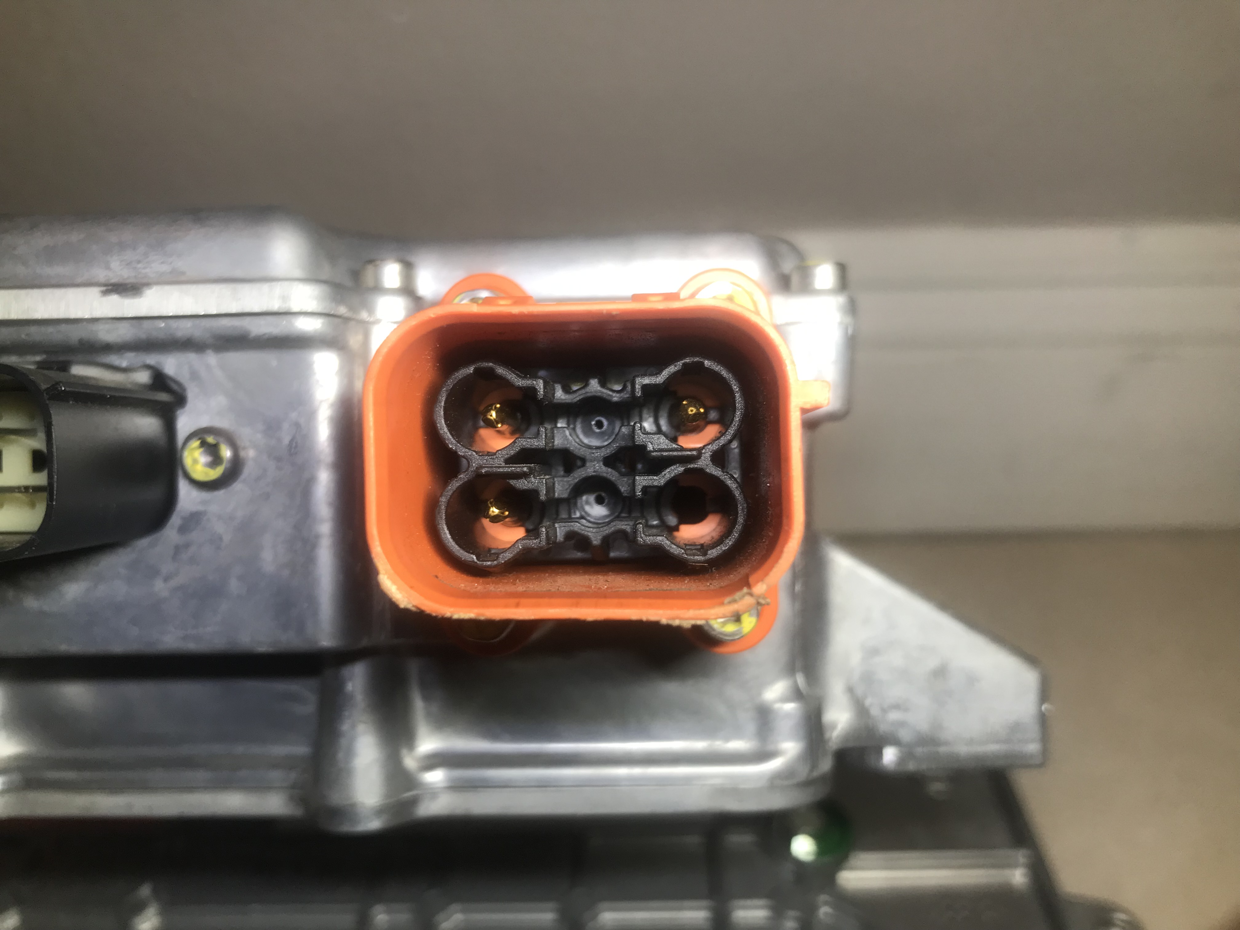

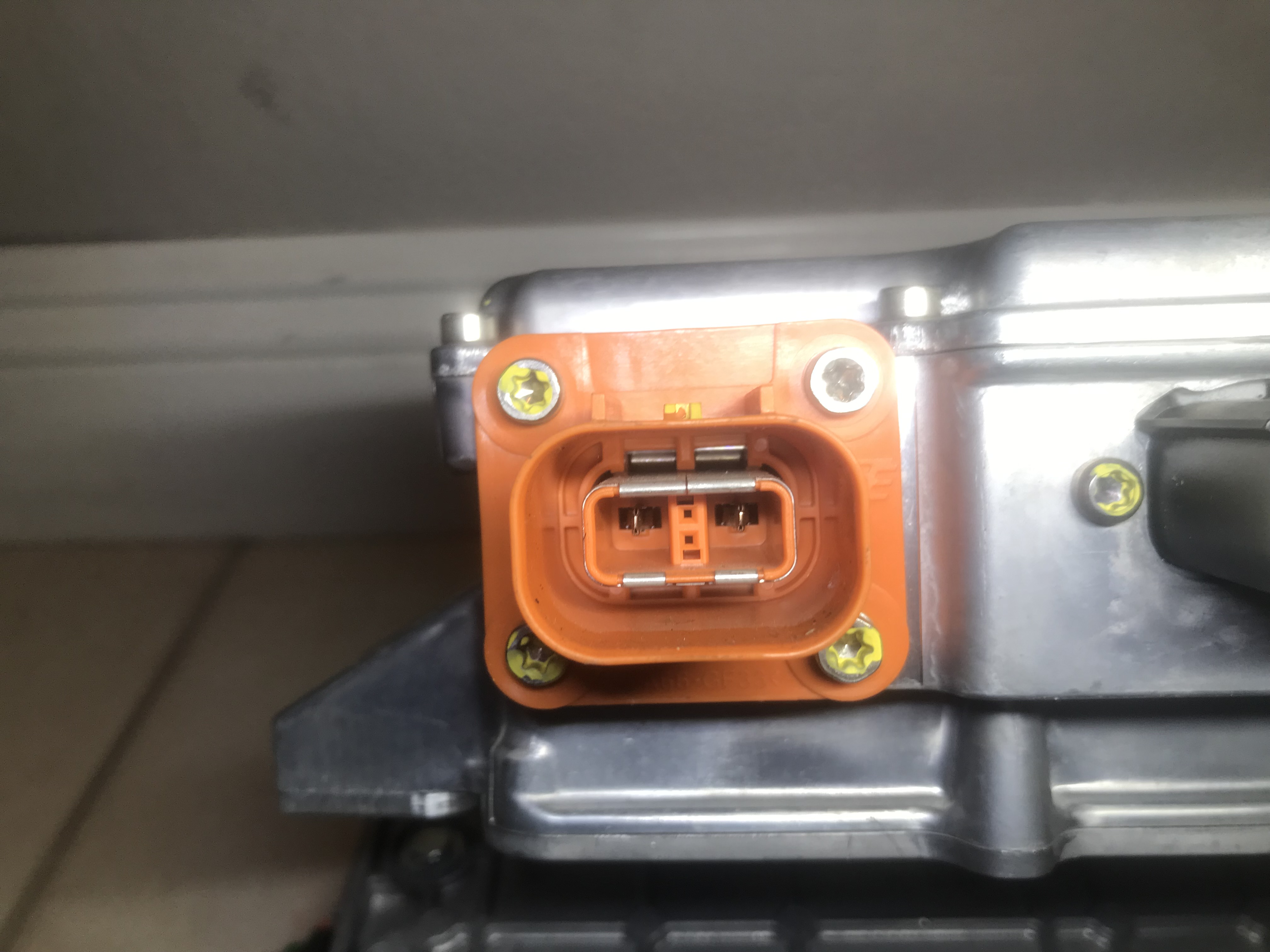

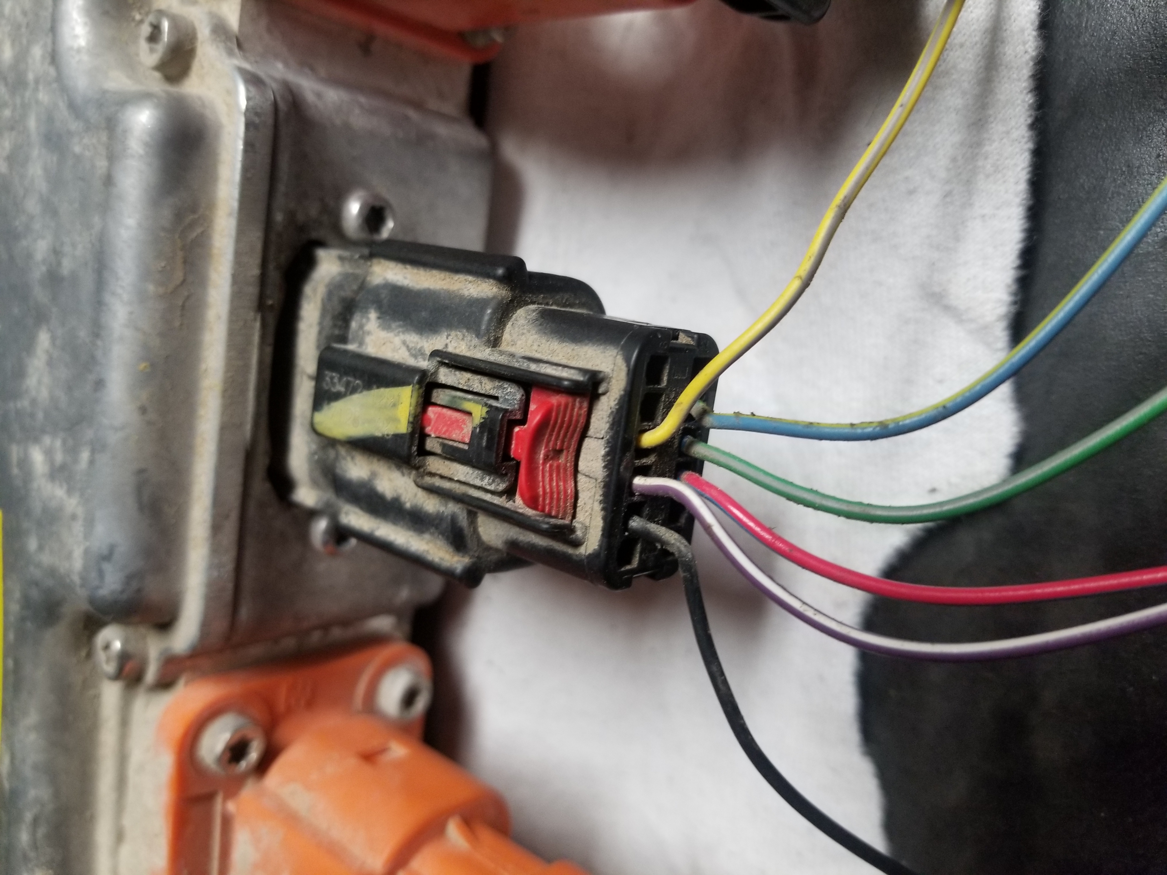

I've looked high and low but I cant find anywhere the pin layout for the GEN 2 battery charger control plug.
Can someone tell me where Pin 1 is? Or better yet a link to a pinout somewhere would be awesome.
I checked amber's blog and he describes the pins but I really could use the pin layout.
- Posts: 3796
- Has thanked: 166 times
- Been thanked: 413 times
Re: Chevy Volt Gen 2 charger 24281923
Ok, i am away from PC now and cant do much. But observe in my blog how i used all black wires with numbers and single green/yellow wire. Well that is P2 GND (black wire in your photo) wire. P1 is not populated and then you can count wires from there. You only really need 4 wires P2, P4, P9 and P11.
I think you can also download molex connector datasheet to see pinout distribution.
I will draw a schematic when i am home...

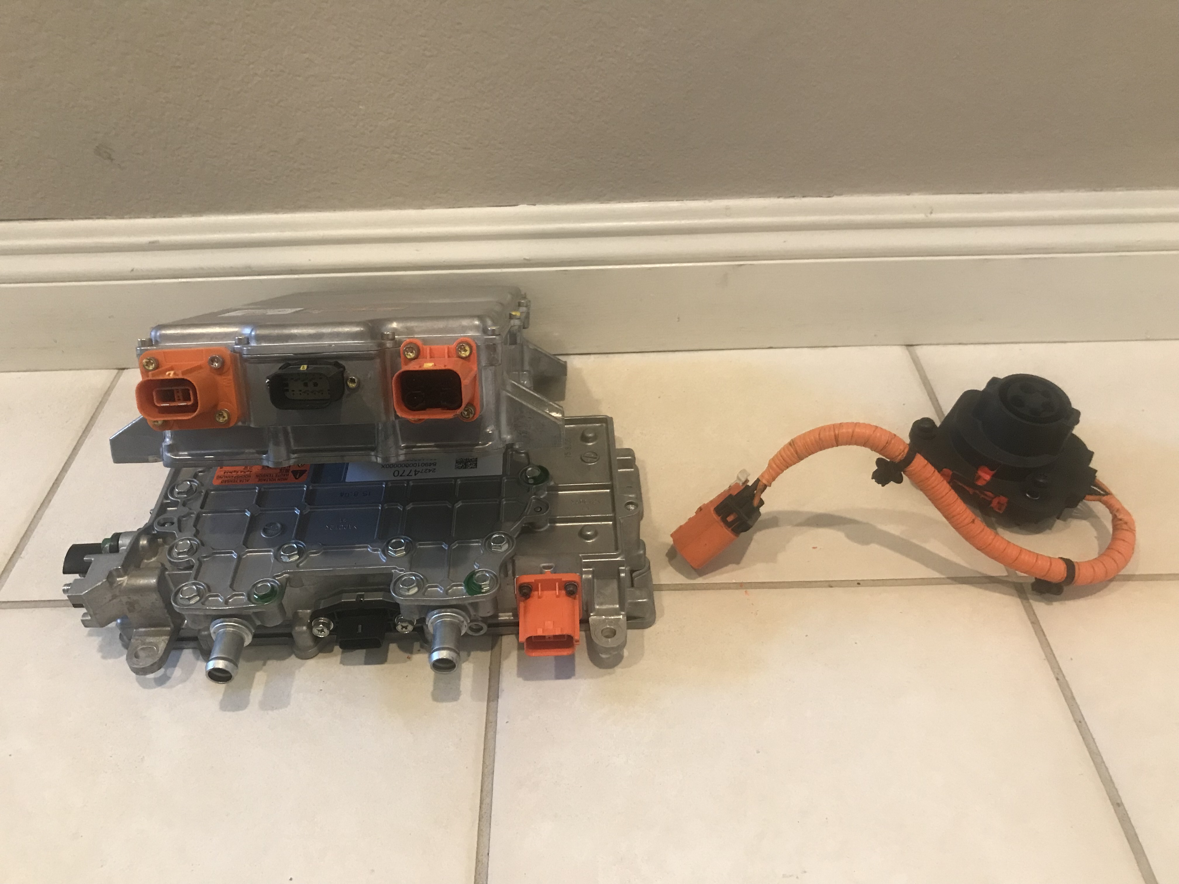

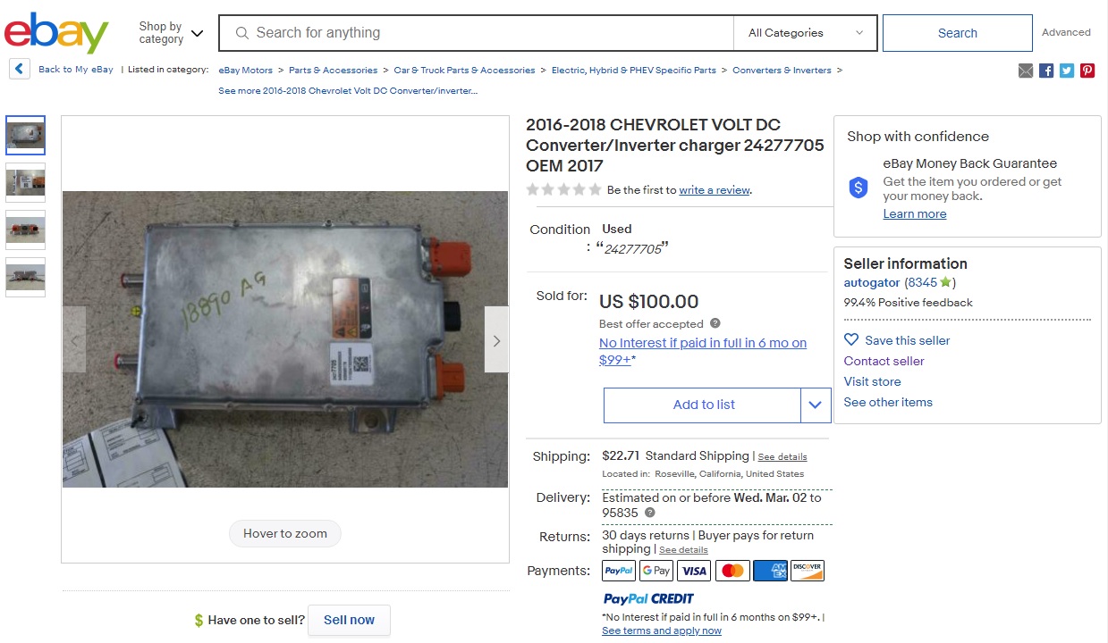

just got my second gen Charger/Converter set on eBay, sharing the charger listing (items were purchased separately) to show folks what they go for as of the current date, brace yourselves for death by a 1,000 questions, ha ha
Part Number: 24281923
Supersession(s): 24277705
Part Number: 24291446
Supersession(s): 24275451; 24286781
https://www.gmpartsmog.com/p/75741768/24291446.html

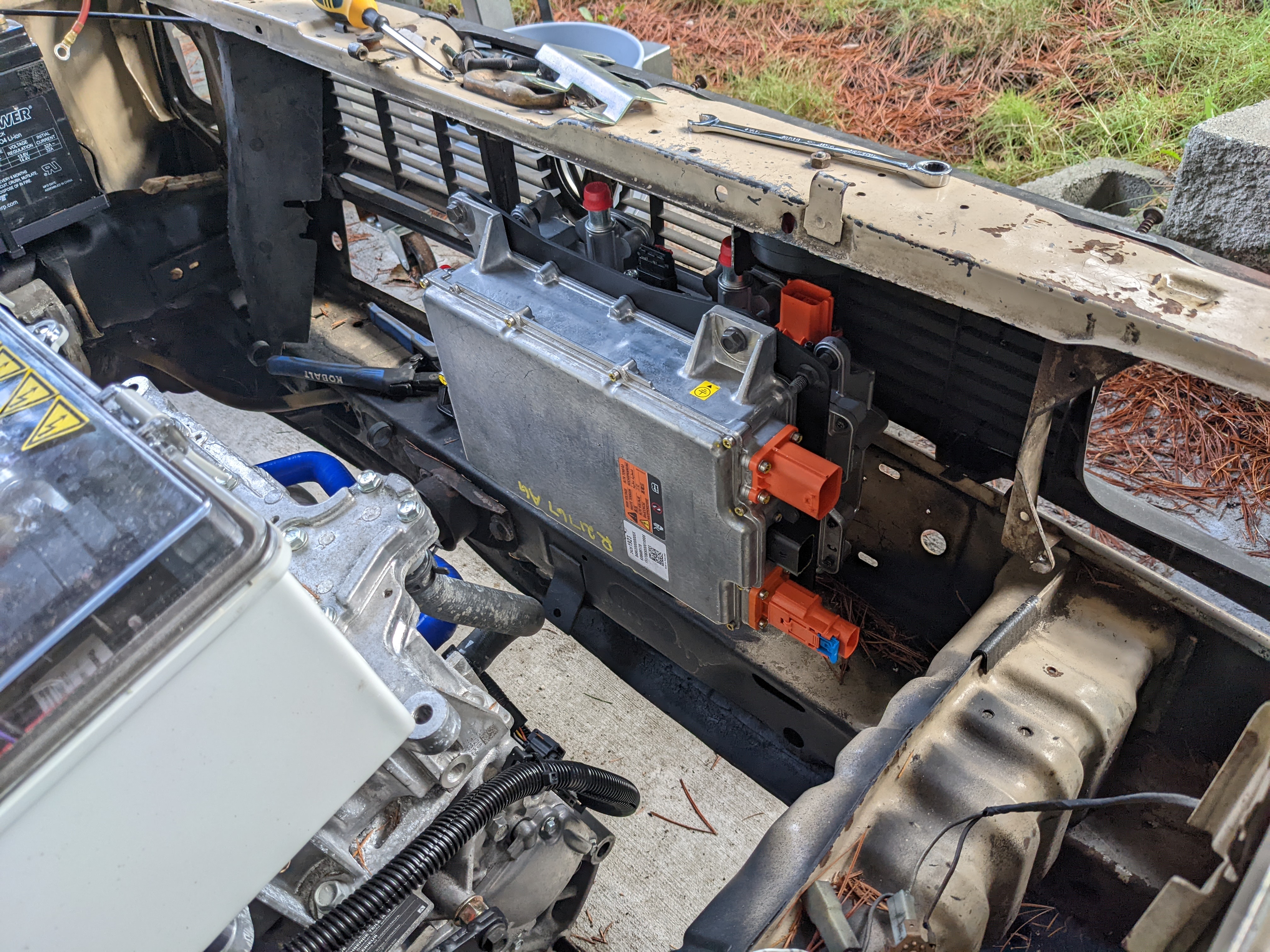

this shows where Chevy Volt Gen 2 (2016-2019) charger aka the On Board Charging Module or OBCM is housed inside the trunk of the vehicle in case you find one in the wild and want to lift it

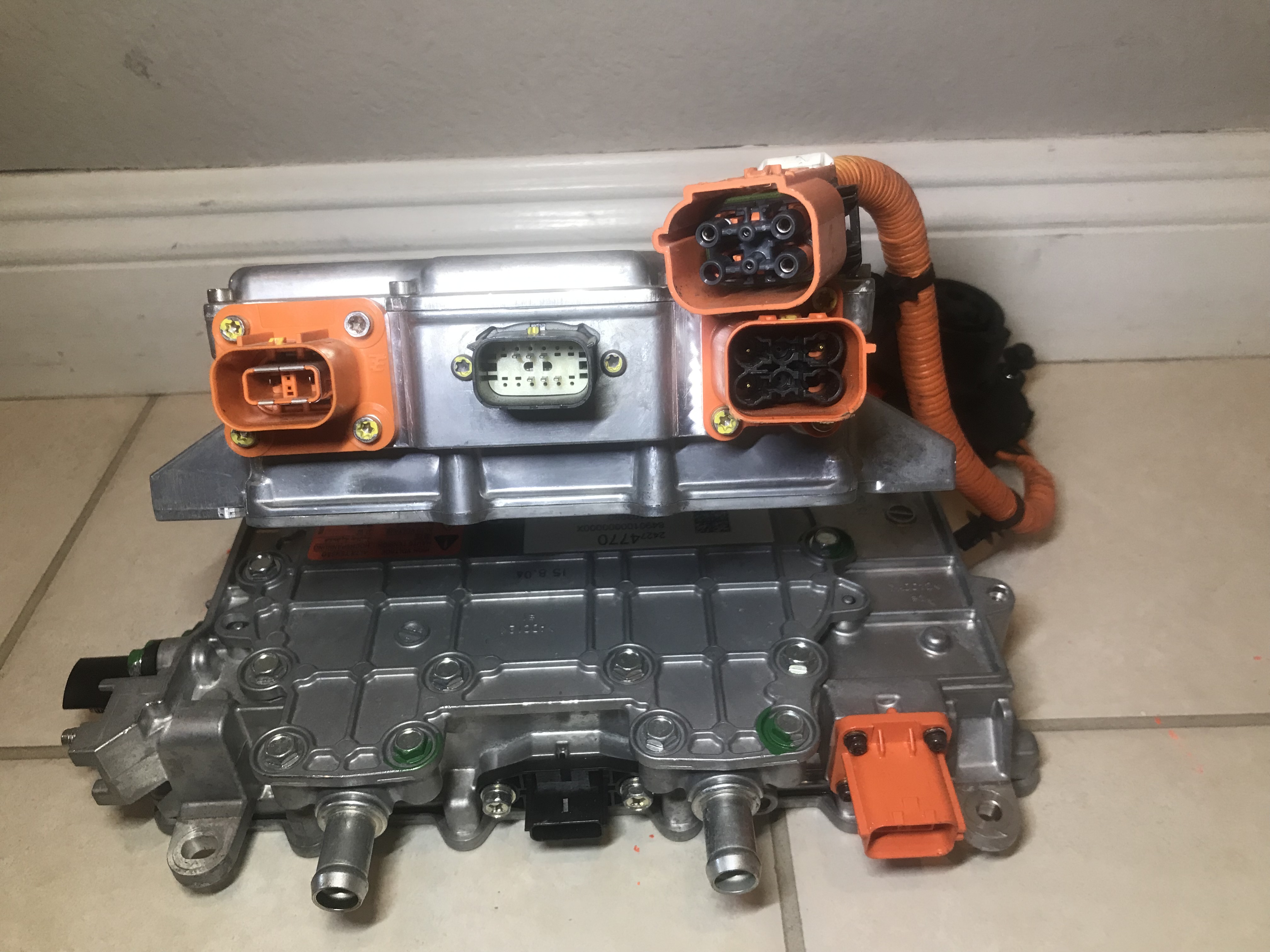

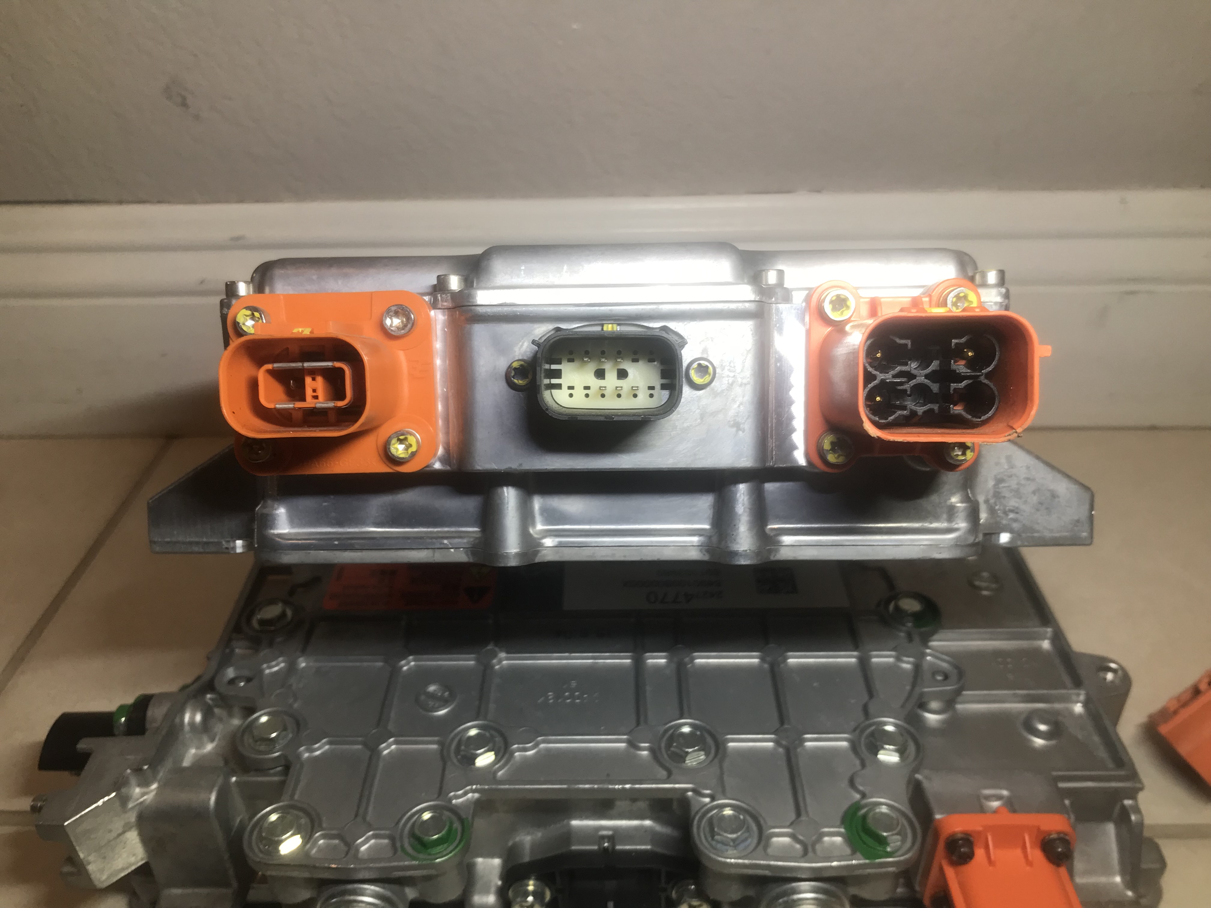

I have also been collecting these on eBay for cheap. Have 3 chargers and 2 DCDC right now. They're just so compact!
I designed a bracket for them to be mounted together. LMK if anyone is interested.

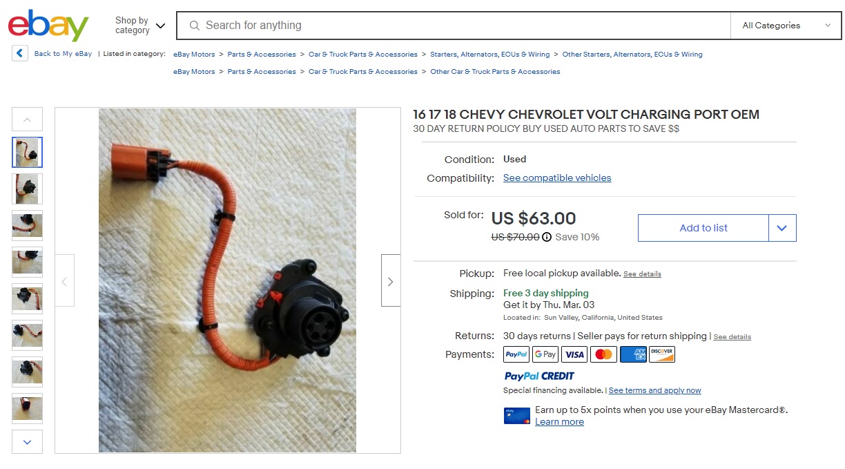

So i came across a new and cheap Chevy Volt charge inlet assembly on ebay and decided to grab it, if only for the charger side connector. Interestingly it also includes the J1772 pilot and proximity connections. I'm now wondering if this charger will handle EVSE connectivity on it's own instead of running something like an AVC2.
Has anyone looked into this? I may be able to test this in the near future when i get my PWM generator wired up.
- Posts: 3796
No. This charger will start under conditionsvwbrady wrote: ↑Thu Apr 07, 2022 3:53 pm So i came across a new and cheap Chevy Volt charge inlet assembly on ebay and decided to grab it, if only for the charger side connector. Interestingly it also includes the J1772 pilot and proximity connections. I'm now wondering if this charger will handle EVSE connectivity on it's own instead of running something like an AVC2.
1. DC is present
2. AC is present
3. 100Hz PWM on pin4
Cp is used on the separate controler (HPCM2?) which in turn sets PWM signal for the charger to follow.

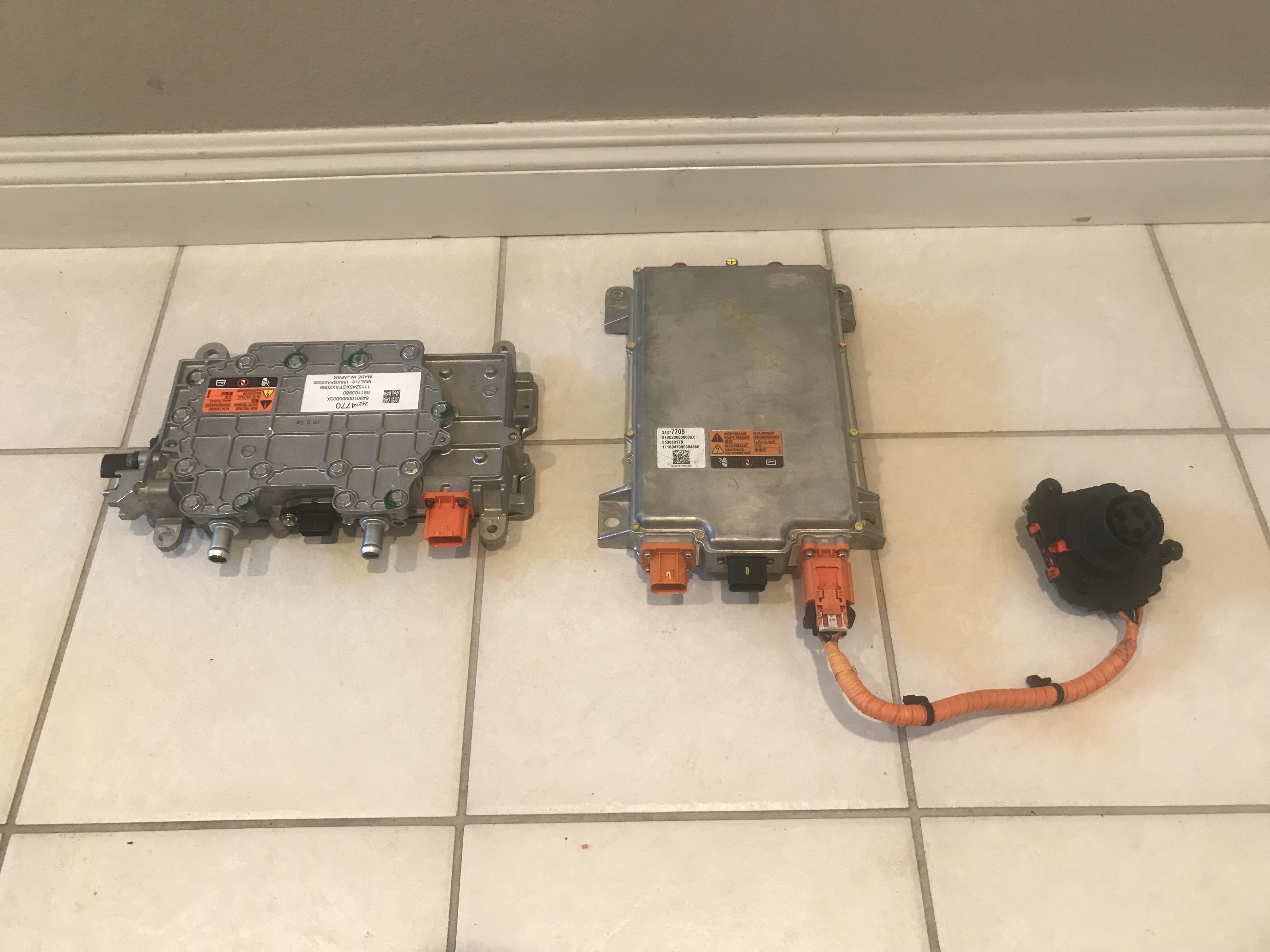

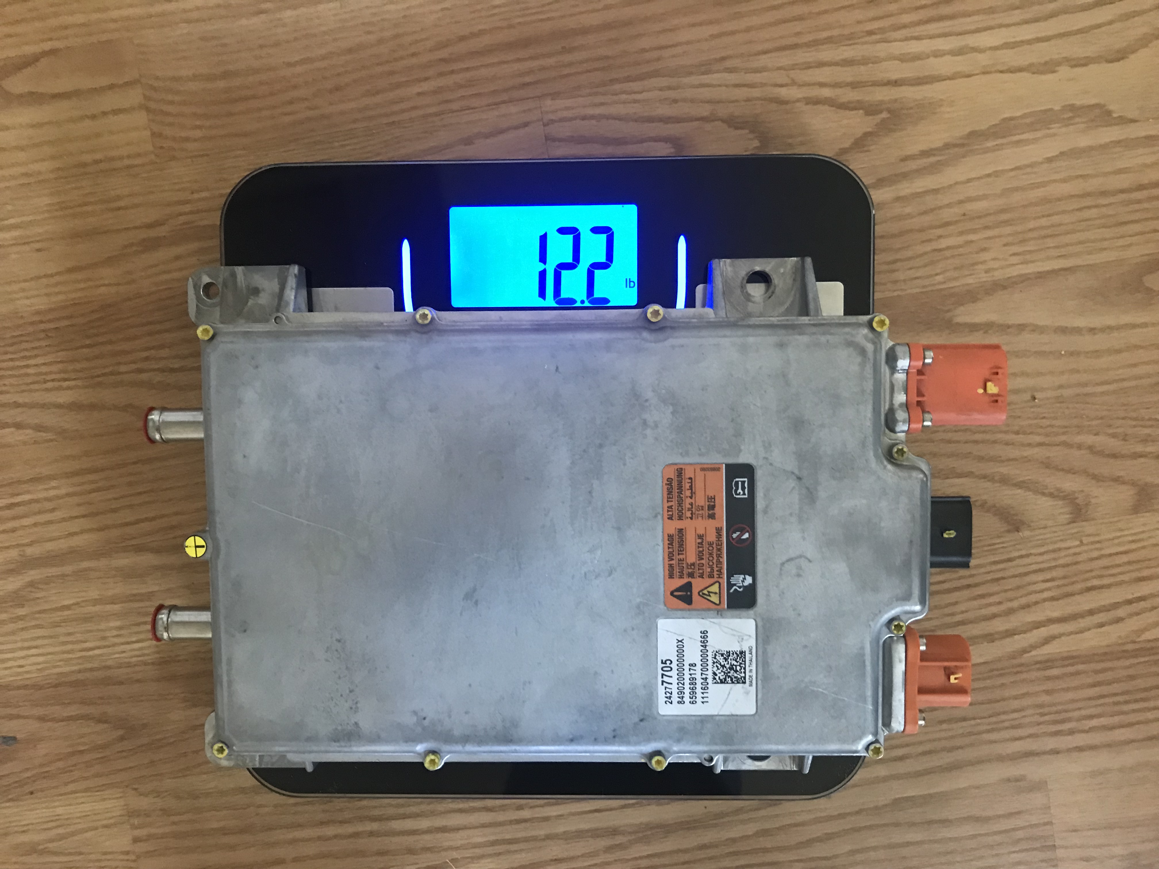

someone actually asked how much this thing weighs, so Greg to the rescue
