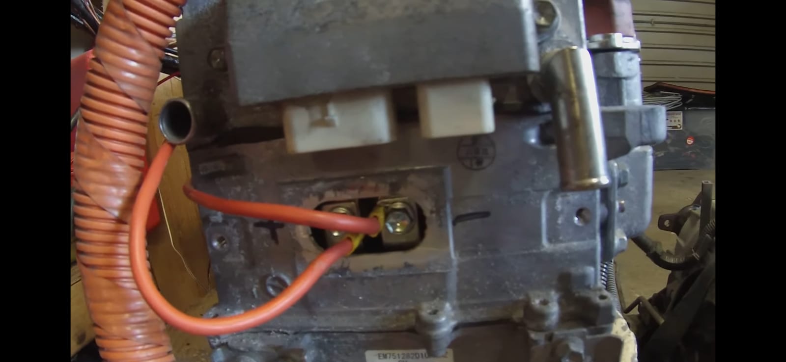

Jack Bauer wrote: Tue Aug 30, 2022 8:51 am If only someone had demonstrated this 3 years ago .... oh wait :
It seems obvious now, looking at the still picture, which terminal is positive.
Have you ever watched a movie 2 or 3 times, and found plot details you didn't notice before? That's the way it is with these videos. It's so much easier to find details that are written down, like in the wiki, rather than having to go through hours of video over and over again to find these details. I puzzled over which terminal was which for a long time. I don't even remember how I found out the correct polarity.
I do appreciate you and all the other people putting in the time and effort to make this possible for me to get my project going. The electronics and programming are way over my head.

Mr. Bauer, I tip my hat to you!
For bypassing the boost capacitor bank we are not using the OEM connector:
POSITIVE (+) HV DC is on the LEFT
NEGATIVE (-) HV DC is on the RIGHT

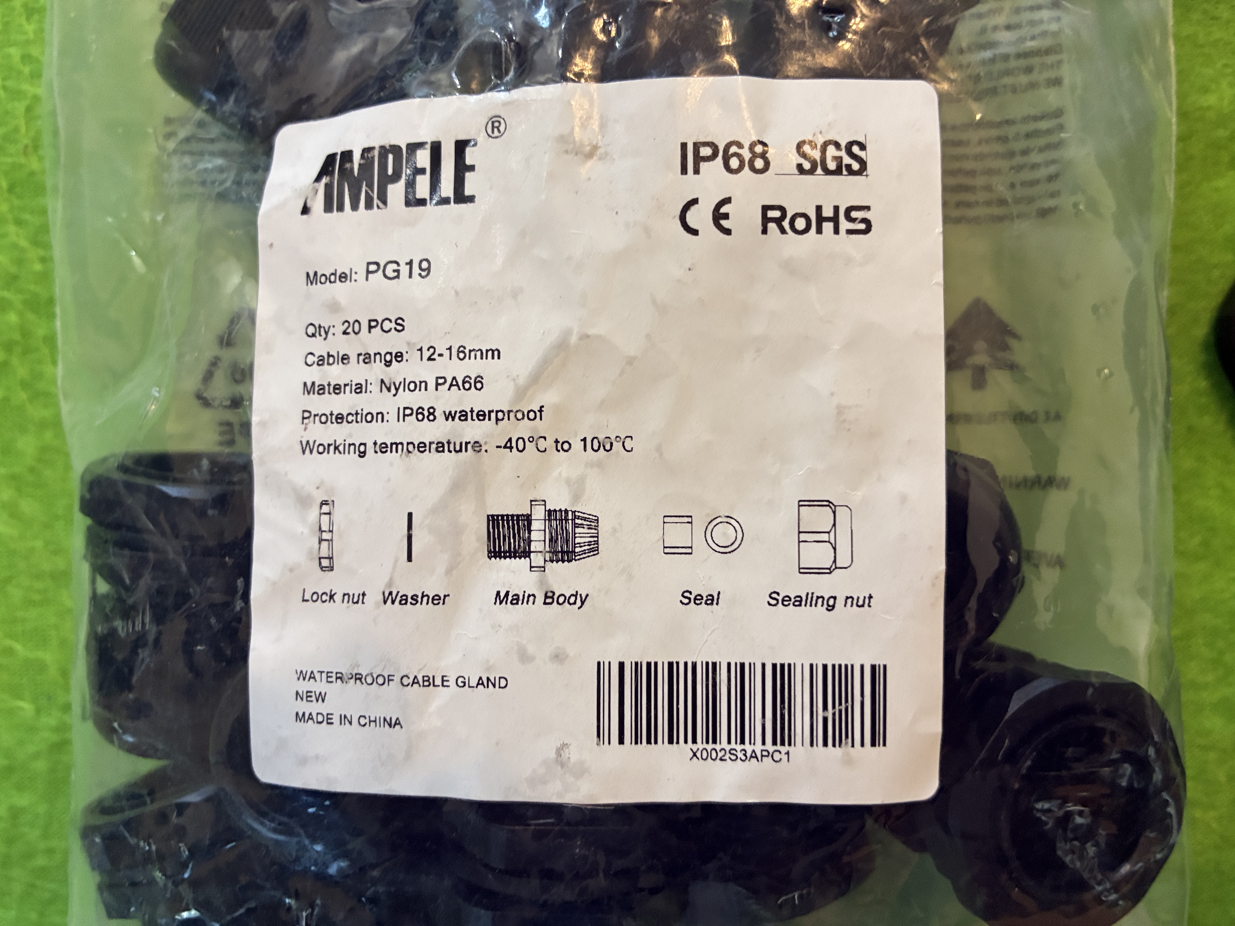

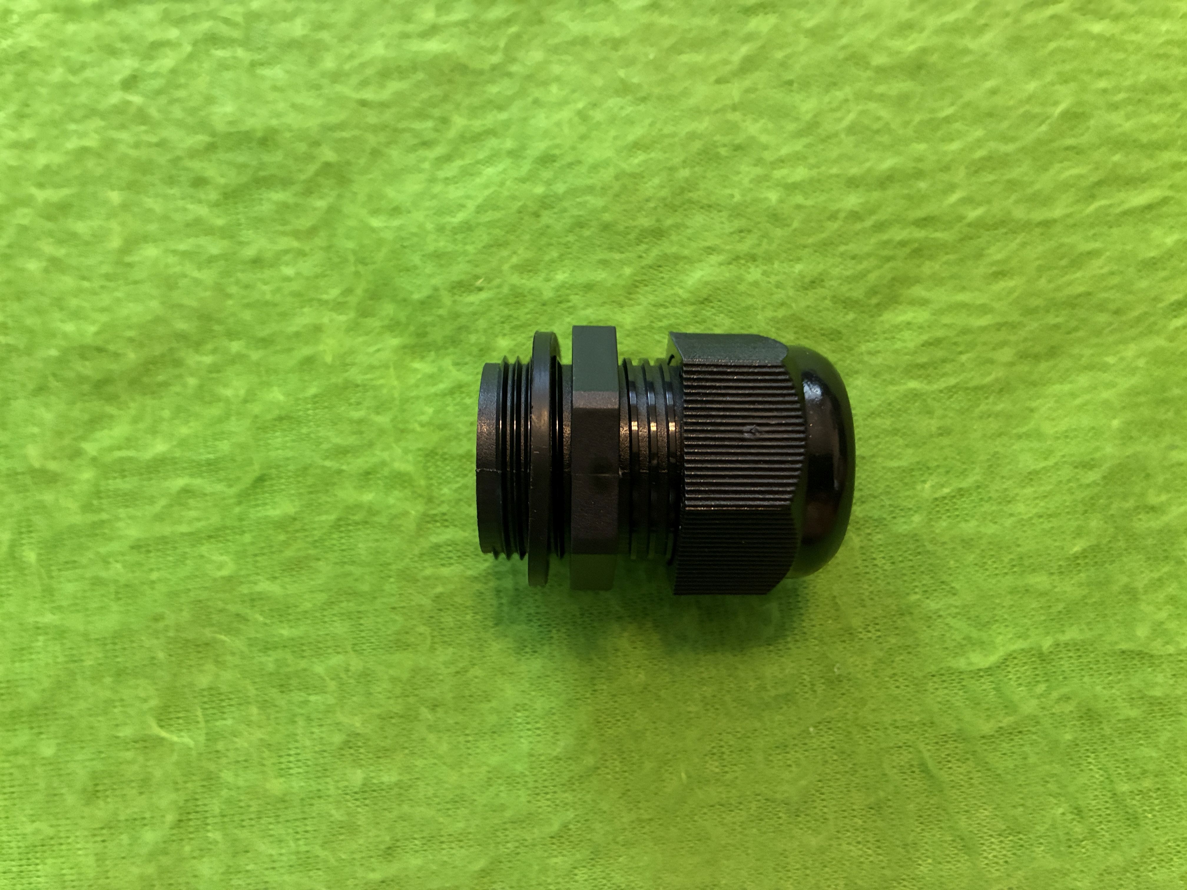

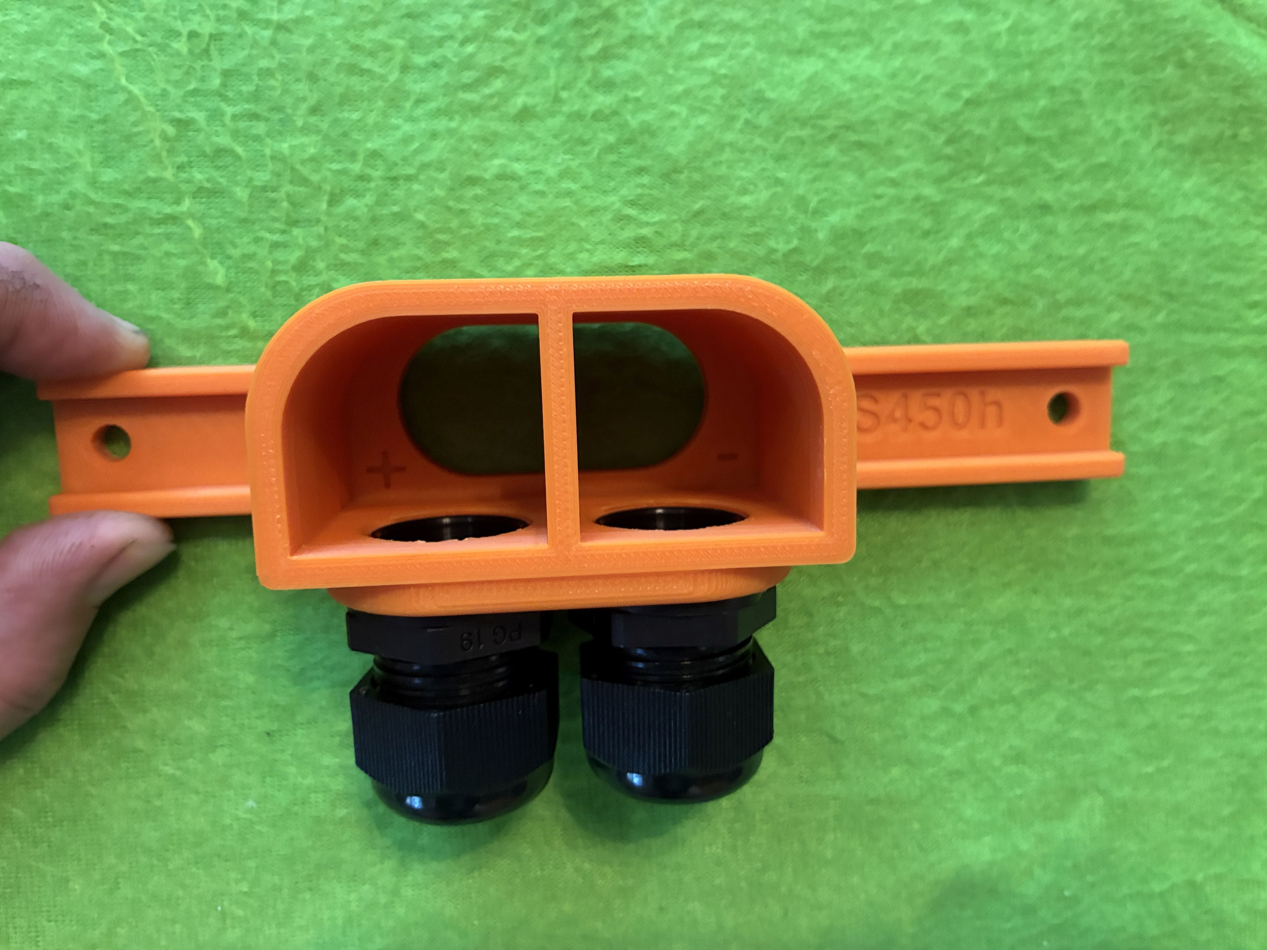

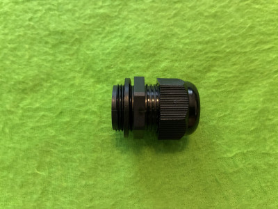

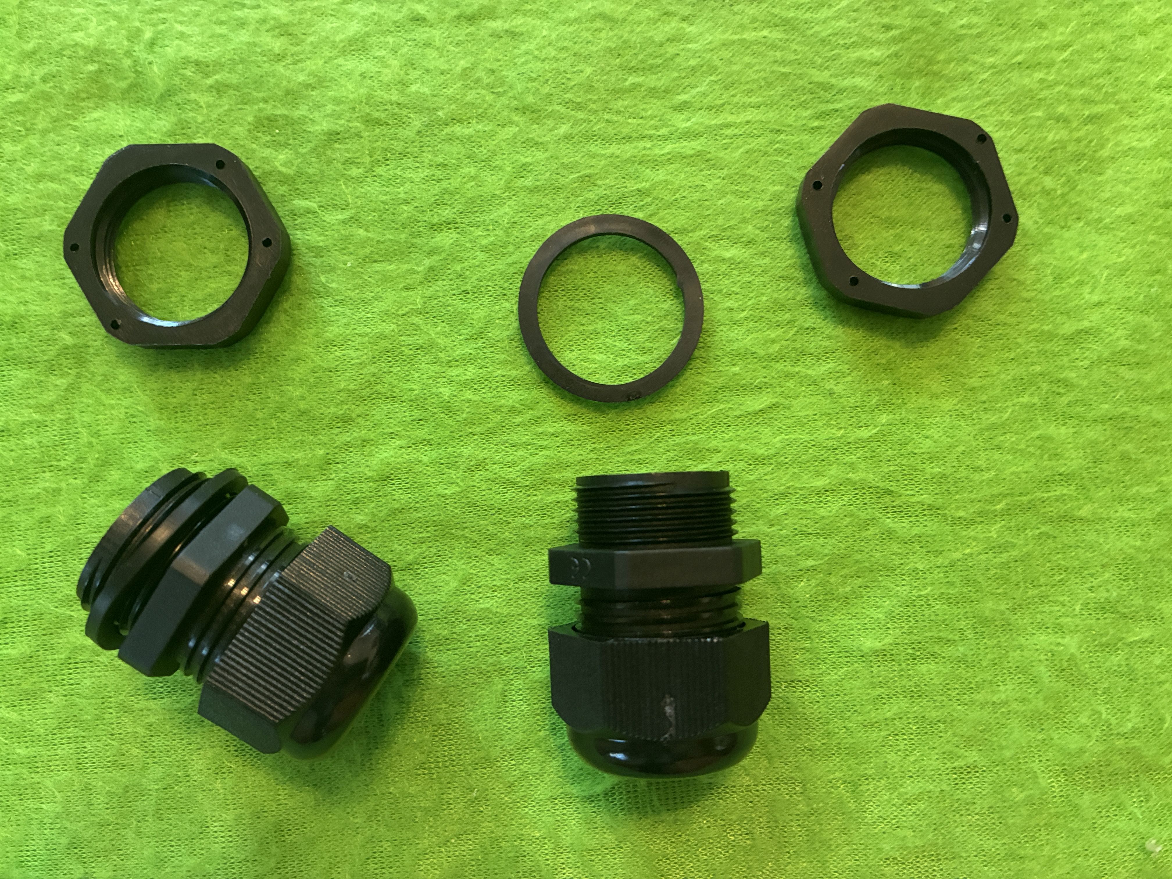

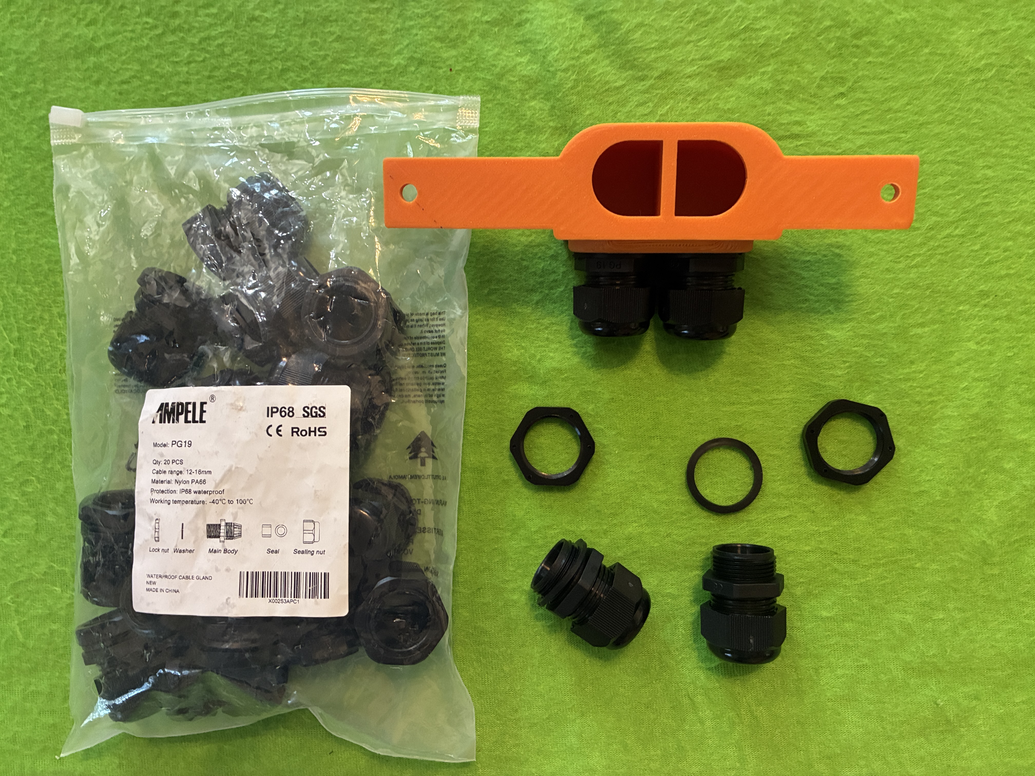

james@N52E01 wrote: Thu Sep 02, 2021 11:20 pm Glad the print came out well Dan. I’ve looked into the gland size issue. Very helpfully, the specs tell you the thread for the hole but not for the gland part on the other side. There are a range of sizes and the ones you have are the bigger ones. I can get some eBay links for the ones you want if that would help but essentially you’re okay with any glands that have the same thread (m25) on both sides. Example below:
thank you so much James, just wanted to share these PG19 cable glands as these are the first ones that I ordered that arrived with gaskets, would offer up a direct Amazon link, but by the time you read this it would most likely be expired
these are just screwed in by hand I think they can sink in a bit deeper with a wrench
