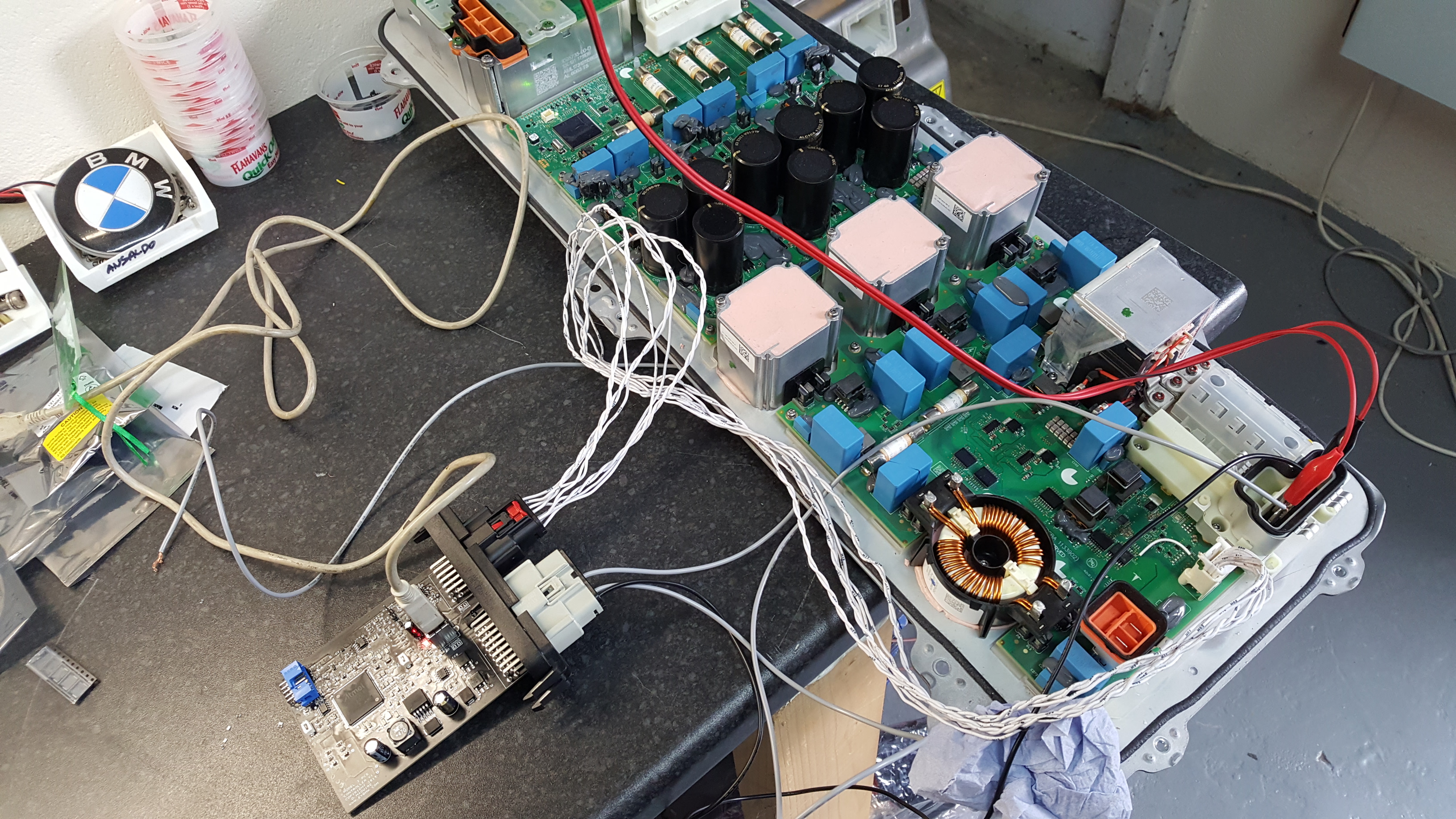

Some very good progress Damien, hats off.
Very janky setup as usual, might want to make a bit more permanent rectification setup.
You tried changing some values in 0x22A to see if you can request less current?

Thanks Tom. Lots more testing to do. Regards ipc can here is a copy of a comment on the above video that seems to shed some light :
Inter Process Communication (IPC) can use the CAN protocol over a half duplex single ended bus, without the usual Transceivers (that are used to convert to a differential bus topology for noise immunity and low EMI), by simply hardware OR'ing the TX lines onto a single data line. Used over short distances with system of a common ground it allows all the usual CAN goodness (built in checksums, automatic bus arbitration and multi-drop architecture) without the additional parts count for the full CAN physical layer. As Automotive spec micro-processors now pretty much all include multiple CAN nodes in hardware, it makes sense to use that rather than alternative IPC options (classic UART, SPI, I2C etc)

Message 0x22a on ipc can at 10ms intervals. Byte 1 , bit 2 is dcdc enable. set it to one and the dcdc wakes up. set it to 0 and it shutsdown. Released a first cut at a pcs controller on github. Just a modification to the existing gen3 charger controller.

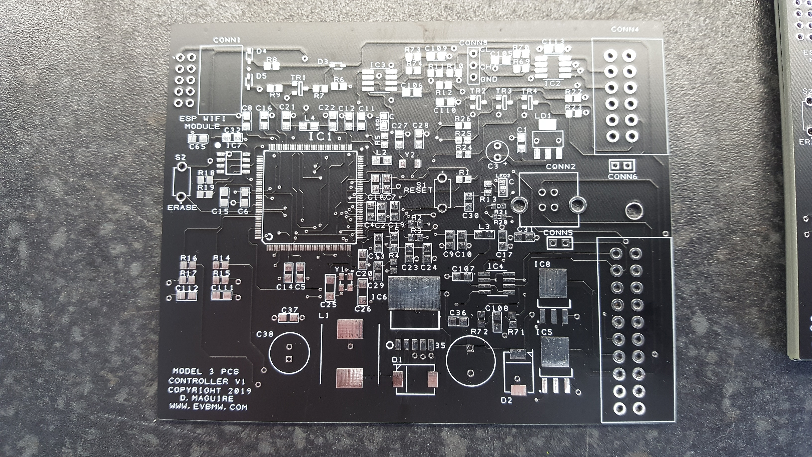

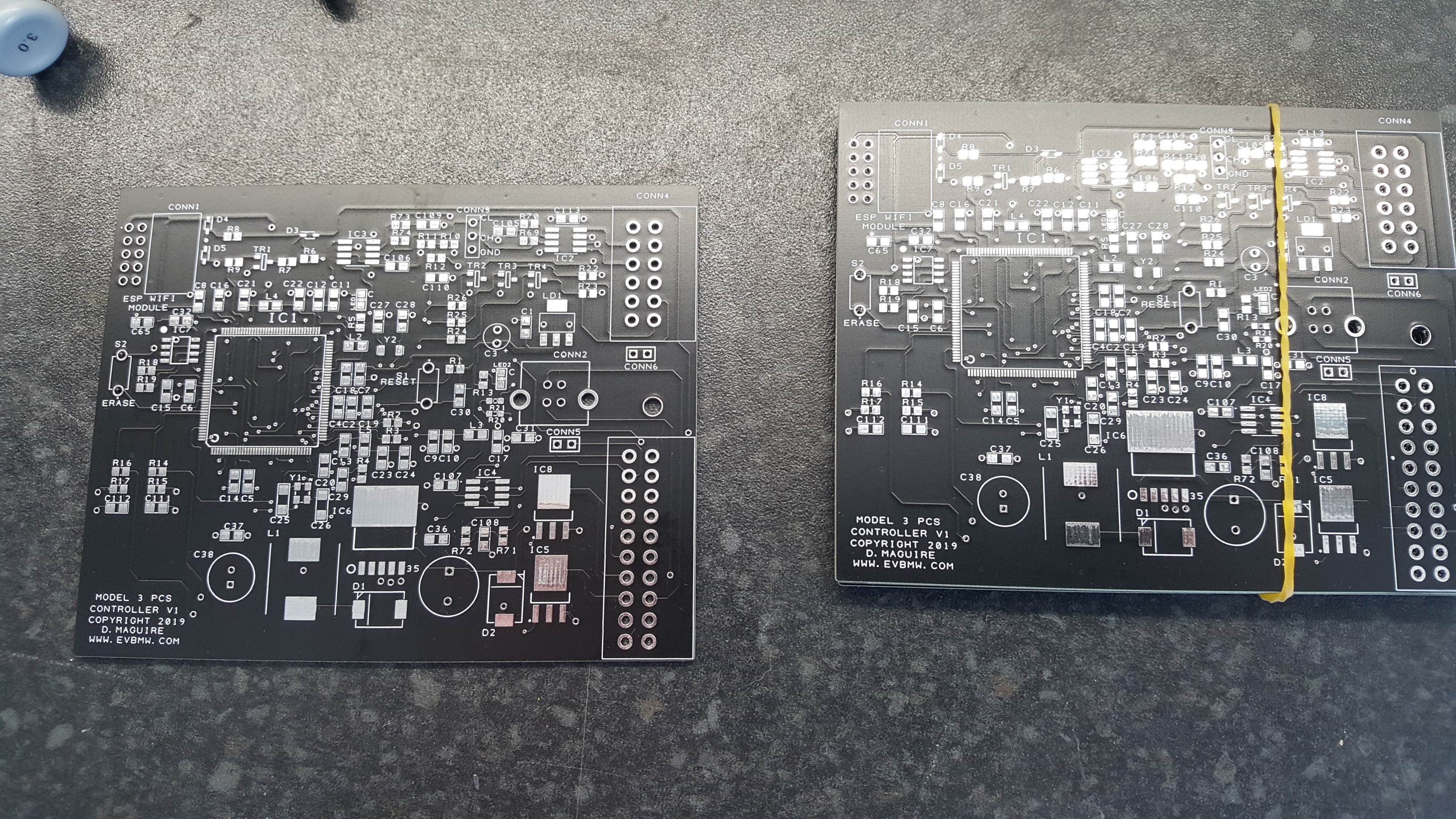

Just ordered some prototype boards from these guys : https://jlcpcb.com/
We'll see what they turn out like. If any one on here has a PCS and wants to play along let me know and I'll ship you a controller for free.

Blank pcbs have arrived for the pcs controller:)

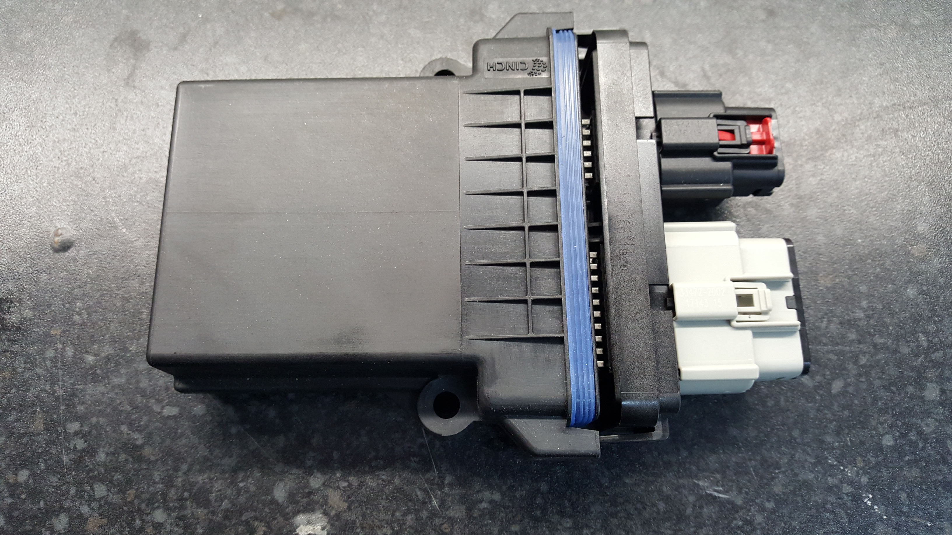

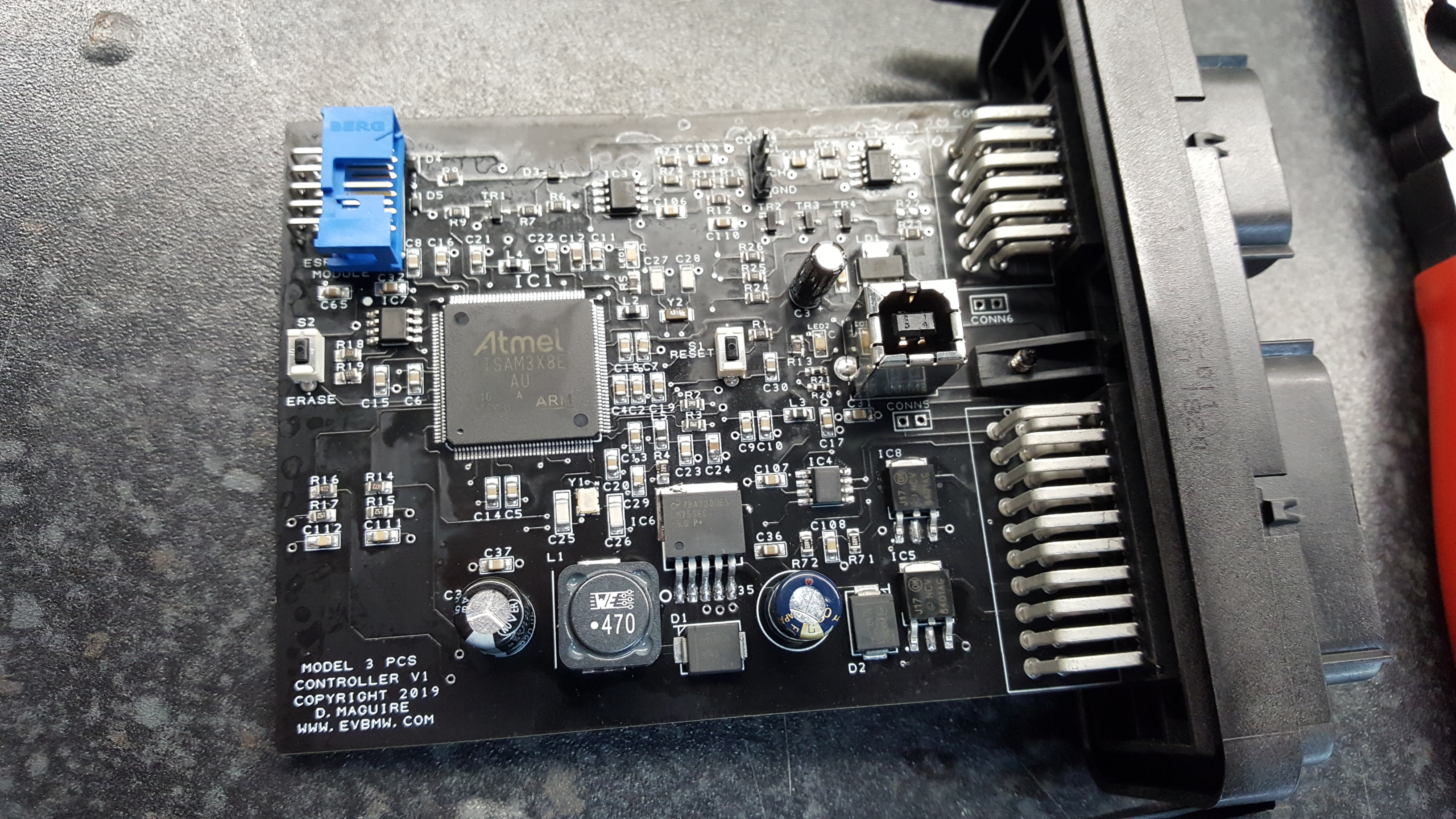

PCS Controller working perfectly:) Also my first oven reflow pcb so double happy. Now for some software....

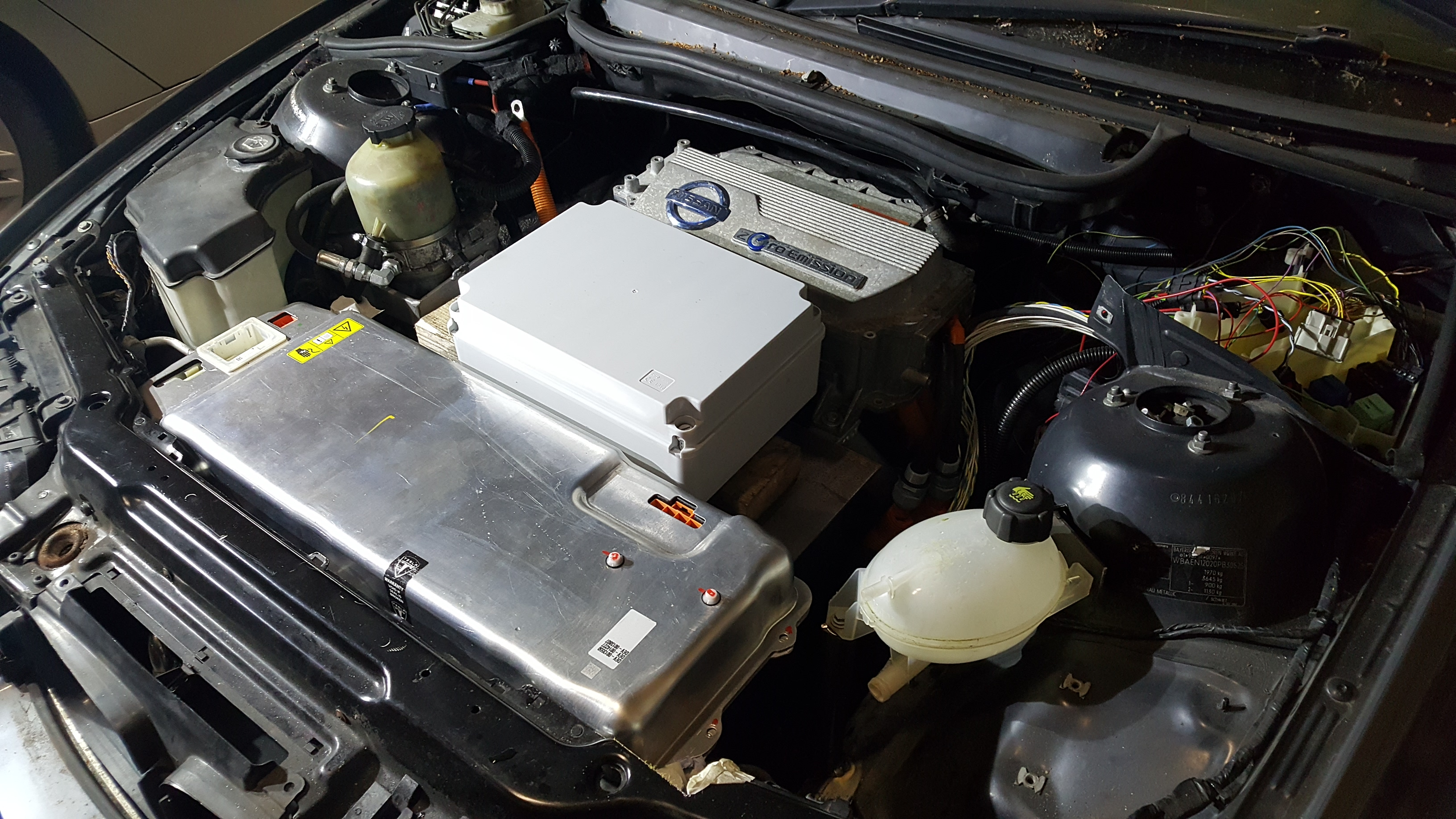

Currently being installed in the BMW E46 Touring project by our vehicle integration team

The reason for no software on github is I have not written any as yet. Reason for that is in order to do further testing I need HVDC,AC, cooling and 12v applied and the easiest way to do that is install it in a car which is still a work in progress. Last bench testing saw the dcdc waking up. It's not forgotten but I'm just one guy:)
