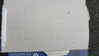

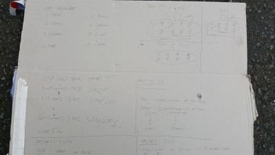

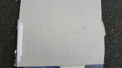

Here are a few pictures of my "blackboard" where I worked out the resolver connections. Will put it into something more readable.
Drove the car for the first time today:)

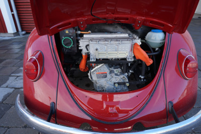

Re: Leaf Gen 1 Inverter Board
Wow that looks great:) its a gen 1?
langoo
Posts: 68
Joined: Thu May 09, 2019 6:27 pm
Location: Varberg, Sweden
Post by langoo »
Jack Bauer wrote: Sun Aug 18, 2019 7:56 pm Wow that looks great:) its a gen 1?
Yes it is ;)

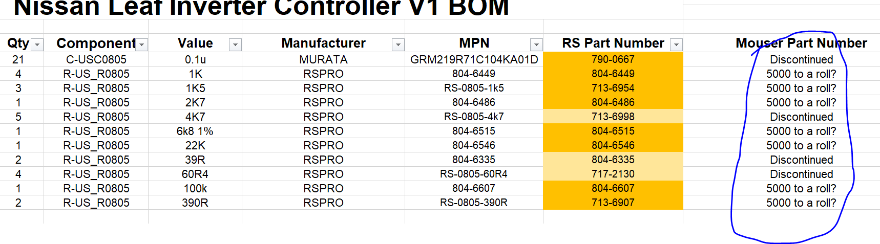

Another question for you all. I nearly have all the parts but, from the BOM, there are a number of RS parts that you can only buy in rolls of 5000 (!?) or discontinued. I emailed them and mentioned them I would be more than happy to take 25-50 resistors off the 5000 roll but they said they couldn't...(or wouldn't!). Has anyone one any to spare, advise on where I can get the last remaining parts here:
I had a look on mouser and elsewhere but unsure how accurate I have to be with other ratings aside from the resistance etc.

If it's resistors and capacitors, get any with the same tolerance and power rating as in the BOM.

Exactly like doobedoobedo said, buy the same size 0805M and other values and will be good. Those missed parts, which were not present at Mouser, I bought in Farnell.
And one thing - don't miss to buy external Molex connectors A and B types with inserts, like I did :) Also are available at Farnell:
