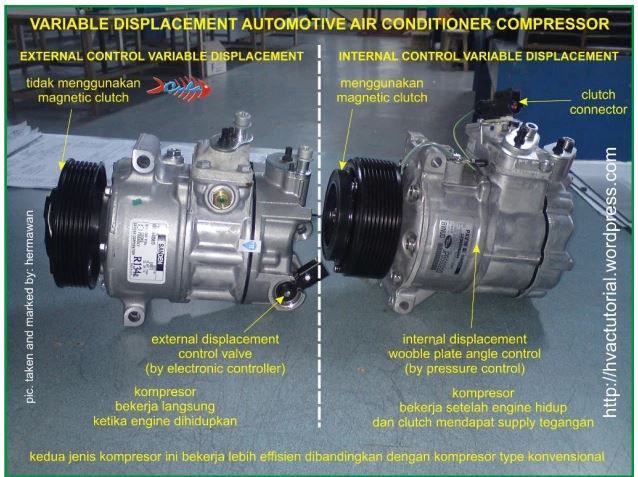

What kind of clutch was it? If I'm right in a clutch operated pump there are also mechanism in place to adjust volume per rpm.
The idea is that if the compressor doesn't need to work hard it makes the stroke smaller. Else there is noway to regulate AC system on a engine operated pump.
That signal or what it is is controlled by software on electrical pumps.

EV_Builder wrote: Sun May 29, 2022 4:50 pm What kind of clutch was it? If I'm right in a clutch operated pump there are also mechanism in place to adjust volume per rpm.
Never heard of that but it's an interesting idea. Do you have any examples of its use?
My understanding was that on a simple system, such as a traditional ICE car system, the expansion valve performs this function. At low loads the expansions valve closes to almost shut limiting the amount of refrigerant going through, this in turn reduces the low side pressure which means less refrigerant enters the compressor each revolution meaning that it is easier to compress an so uses little power. If the pressure drops too low a pressure switch cuts the clutch to the compressor turning it off. Once the pressure lifts it will then restart and the cycle repeat. At high loads the expansion valve is open allowing lots of refrigerant through which means the compressor has to compress a larger volume of gas on each revolution which is harder work causing it to use more power. Essentially the system is regulated not by controlling the pump volume/rpm but by the rate at which of refrigerant is pumped.
More modern domestic AC systems do tend to use inverter based drives for the compressor and motor controlled expansion valves to give big improvements in efficiency which I think is what the best EV systems do. I think the Outlander is somewhere in the middle as the battery cooler evaporator at least looks to have a traditional thermostatic expansion valve on it so I'm guessing the HVAC one would too. These will be pretty soft response so still allowing the compressor speed to be controlled using temperature. One implication of this is that the compressor would need to know both the battery and HVAC evaporator temperatures to control things correctly so there may well be further fields in the CAN message that affect things.

Pete9008 wrote: Sun May 29, 2022 5:19 pm My understanding was that on a simple system, such as a traditional ICE car system, the expansion valve performs this function. At low loads the expansions valve closes to almost shut limiting the amount of refrigerant going through, this in turn reduces the low side pressure which means less refrigerant enters the compressor each revolution meaning that it is easier to compress an so uses little power. If the pressure drops too low a pressure switch cuts the clutch to the compressor turning it off. Once the pressure lifts it will then restart and the cycle repeat. At high loads the expansion valve is open allowing lots of refrigerant through which means the compressor has to compress a larger volume of gas on each revolution which is harder work causing it to use more power. Essentially the system is regulated not by controlling the pump volume/rpm but by the rate at which of refrigerant is pumped.
I would think that if the compressor keeps pumping the pressure will rise very high. And the clutches i know are not exactly the types for regulation of the compressor start/stops.
My signal had a name : rco signal
Anyway varying the speed of the electrical compressor depends on the temperatures and pressures in the system.

Re the pressure it can only increase if there is gas coming in to the pump, if the expansion valve is shut down then this is reduced. The pressure will increase on the high side though, and drop on the low side, until the pressure switch drops the clutch out.
Don't recall seeing anything like that on any of my cars but the concept makes a lot of sense and it would make them run much more efficiently at low load. Thinking about it I'm used to hearing the AC clutch cycling in and out every few seconds but I've not noticed it on my currently daily - will have to have a look under the bonnet to see if it has a variable displacement pump. Just done a bit of googling - it does!
Wonder when the variable displacement type started to appear on cars?
So, the above post is correct for older cars. On newer cars the expansion valve is used to regulate flow though the evaporator as normal but the compressor then regulates it's pumped volume to maintain a constant pressure. So that would suggest that the control variable on the outlander compressor could be pressure rather than temperature - this would also work with the multiple evaporators so seems likely. I still think temperature is worth a try first as it's a much easier sensor to introduce into a pressurised system.

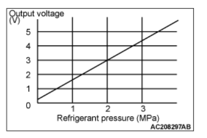

FWIW, the Outlander heater control unit has analog inputs for a "fin temperature sensor" and a refrigerant pressure sensor.
The service manual includes this graph for the pressure sensor:
I saw it hovering at 1.0V-1.1V while the AC was running in the car.
I would guess that this is the feedback loop for the AC - it's adjusting the rpm to try and hold the pressure at some optimal level, while keeping the evaporator temp above some cutoff.
There are some CAN logs of the AC running in the car here, but unfortunately I didn't log the sensor voltages at the same time.

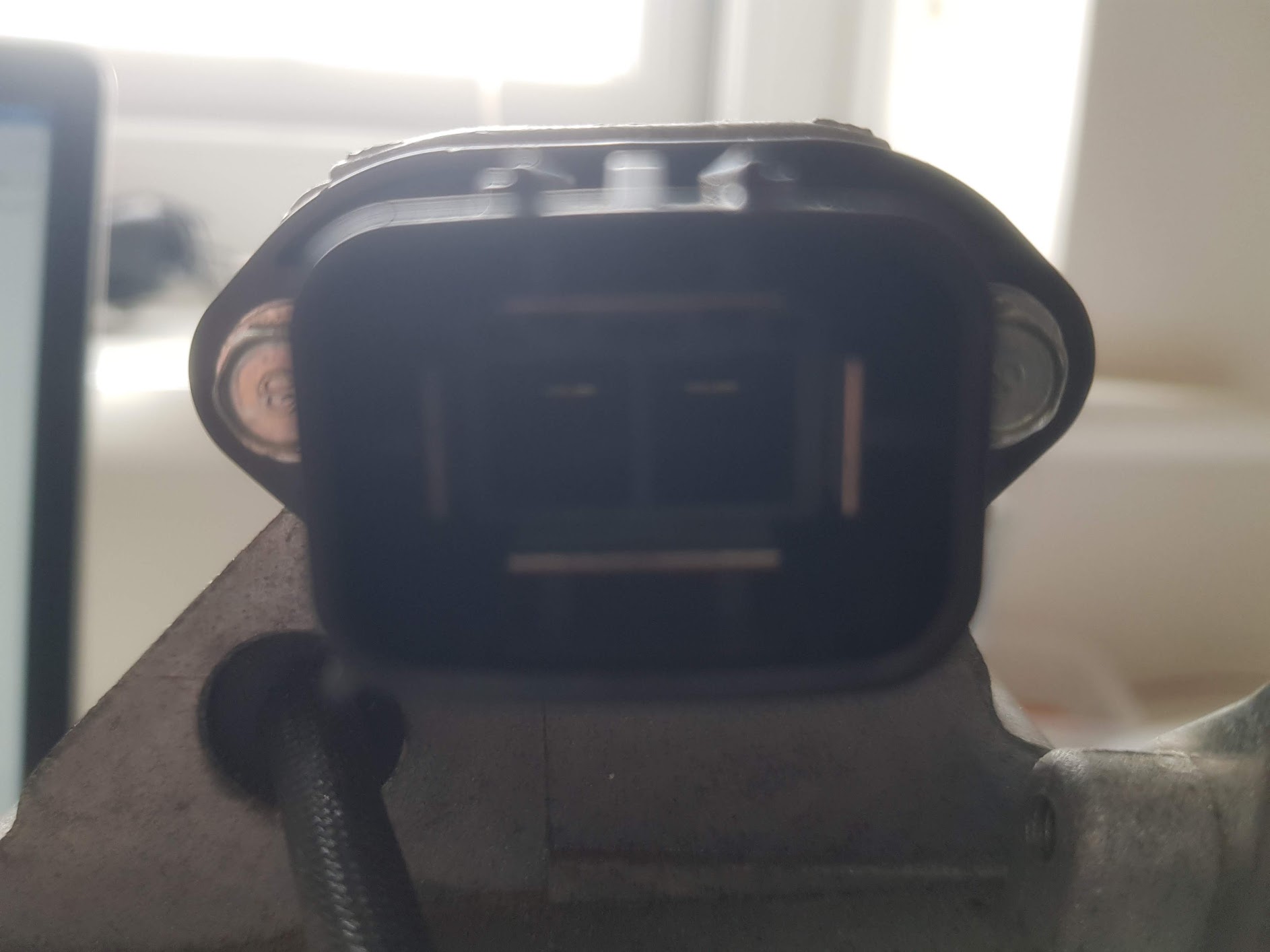

I've picked one of these compressors up for £80 and started consolidating this thread into a wiki page https://openinverter.org/wiki/Mitsubish ... Compressor
Do you have the polarity of the HV connection to hand? I think from your blog, the left side of the photo is negative and the right positive.
