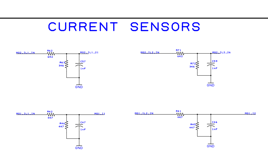

Re: 330e Hybrid Transmission
No worries about the Zombie. I'll just use it for other VCU things.

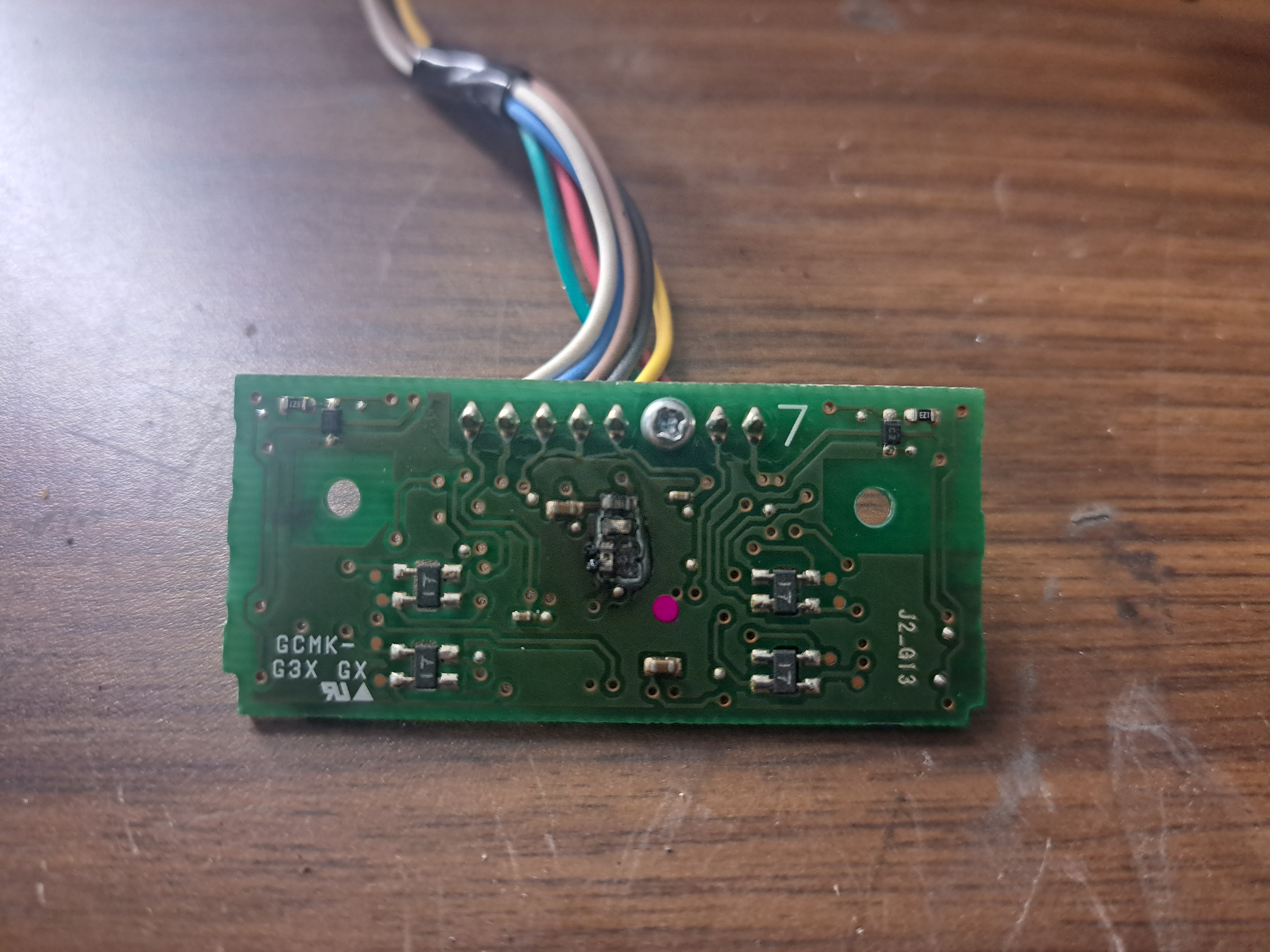

Main concern now is this HICUROFS1/2 error I'm getting. Measured the resistors in the voltage dividers and they're all good but there's definitely a problem somewhere else and I'm not 100% how to track it down. When I measure voltage going into C57 and C59 I get 0.01v. Voltage into C47 and C46 is 5.7v.
No real updates. Had our 4th daughter in October and work has been very busy so haven't had much time for the project.
Still need to diagnose the incorrect voltage at the divider for the current sensors. I did, however, get canbus messages sent to the GCU so I can start mapping them. Once I get RPM, throttle/pedal position mapped I can start initialization so the GCU can control shifting. It uses a closed loop setting so it will continue to learn as i go. I'll also need to send a calculated torque but I'm not sure how. Open to suggestions.

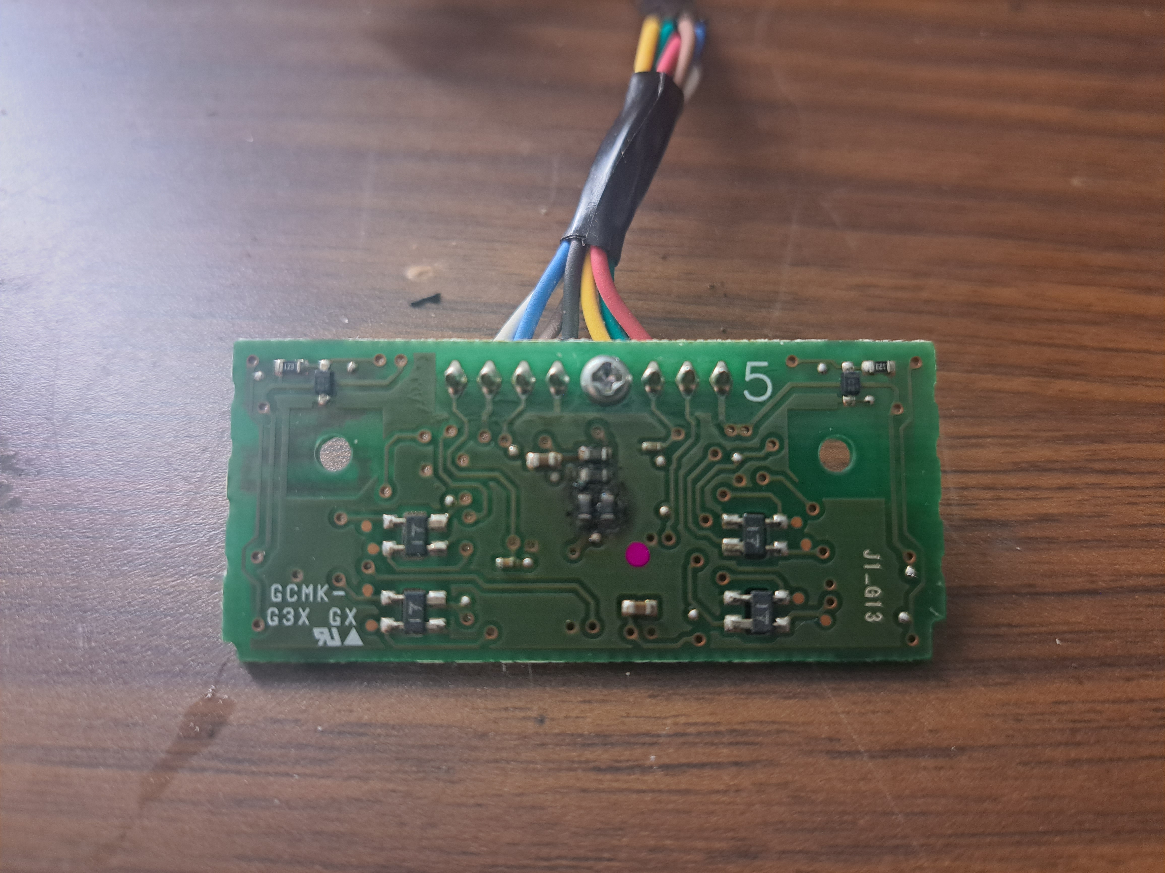

Well... tested all the resistors in the current sensors. R62, 63, 71, 72, 41, 45, 42, and 46 all measured what they're supposed to. No continuity issues at CONN2 or CONN7, everything doing what it's supposed to.
That's when I decided to take another look at the actual current sensor and I noticed a bulge at the base by the connector. Disassemble and voila, pretty sure I found the reason why this particular Prius was in the junkyard.
Time for another inverter.

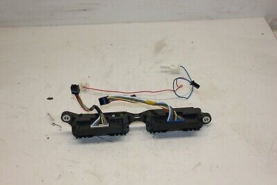

It looks like I can get the current sensor by itself but I think I'd rather get another inverter. Just need to find the time to get to the junkyard.

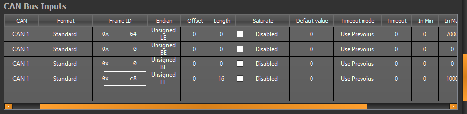

Trying to figure out how to send CAN messages from OI board to my GCU. I've been trying to learn but it's just not clicking. I'm out of my depth here and hoping someone could help.
The GCU has a built-in sniffer so I can see that it's transmitting information and being received, just not sure how to send it in a way that makes sense.

Just received the new current sensor and I have a working setup with no errors! Could not be happier.

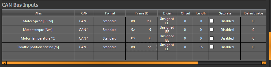

Just wanted to share this because it's fun to watch. No real updates at this point. I'm kind of stuck on a few things.
I can't get any new FOC firmware beyond 5.0 to load successfully but that's ok for now since 5.0 works.
I'm not sure how to add an .ods file to the library so that the motor temp sensor will read correctly.
I'm still struggling to get the Prius and the GCU to talk to each other. I've confirmed the GCU is receiving data, I just can't get it into the right format.
In the meantime, I'm going to work on cleaning up the wiring as well as setting up a coolant reservoir and pump for the inverter.
Anybody in Florida want to come over and offer a hand? I'm open to suggestions.

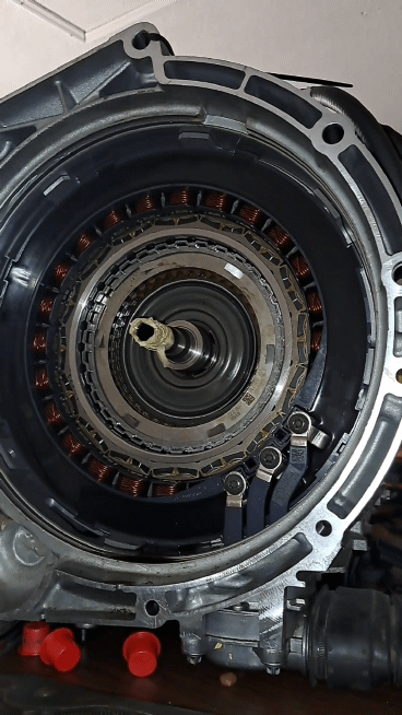

Thanks for reaching out! I have the motor turning under my control with no problem but I'm still having difficulty with the communication between the transmission controller and the inverter. Admitedly, life has gotten in the way of this project and I've not had the opportunity to work on it in quite some time but I certainly haven't given up.
