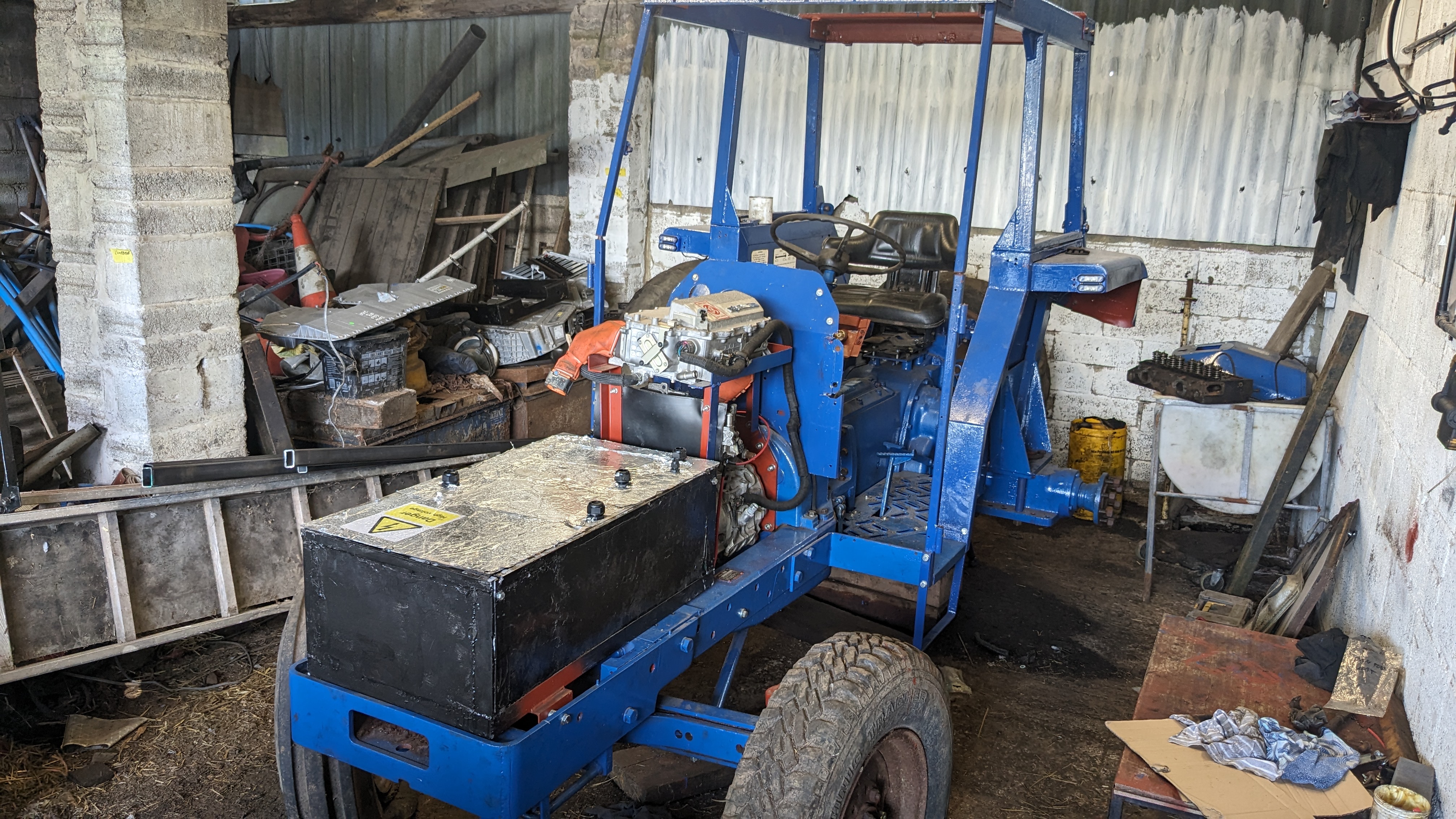

Have a test battery from the MG fitted now. Had to remove most of the tinwork at the front, but it will do the job.
Currently cleaning up and painting the rear wheels before getting new tyres put on. Then I need to look at hooking up the new hydrostatic steering.
After that it should be ready for a first test drive.
My plan is to get some initial driving done with this battery around the farm, then switch it out for the ECorsa battery for some real work. Although it's all a bit delayed at the moment until I get the MG back on the road.

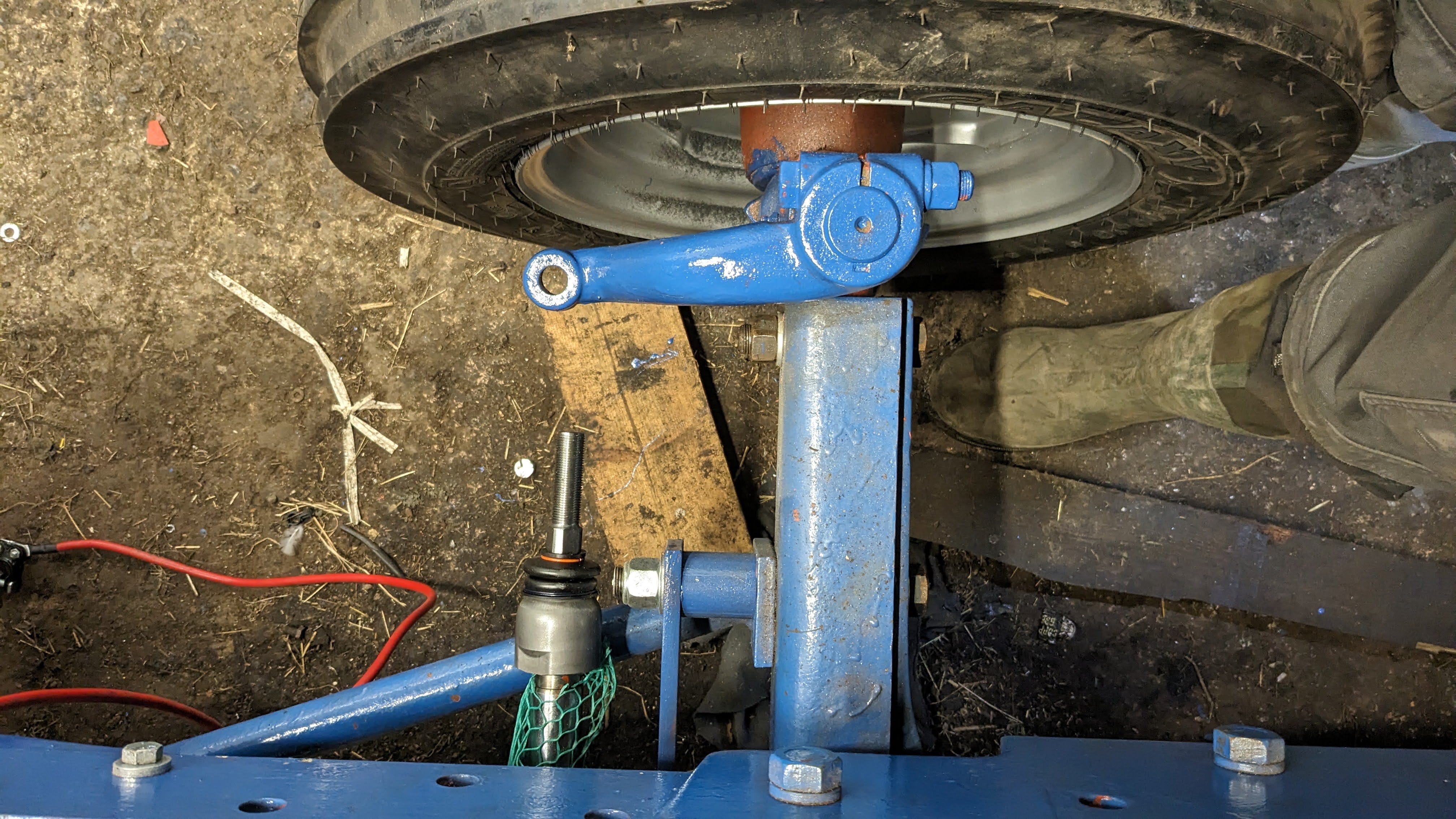

Got the charger and socket physically installed and almost wired up. Potentially might be able to have a first attempt at charging this weekend.
Also tried the power steering for the first time. Still not connected to the wheels but the ram does move pretty well so I think the Astra pump will work just fine. I'm quite pleased that part worked first time, it's a real mis-match of parts. I think I'll still need to adjust the ram at a later date as the throw is longer than the wheels will turn.

Have you checked the current being drawn by the Zafira PAS pump? I had one that sounded like that and it was drawing around 40A at idle and refused to spool down. The Volvo pump I just installed spooled down to draw only 7A when not turning the wheel and is lovely and quiet. (relatively ;) )

Alibro wrote: Tue Jan 30, 2024 7:53 pm Have you checked the current being drawn by the Zafira PAS pump? I had one that sounded like that and it was drawing around 40A at idle and refused to spool down. The Volvo pump I just installed spooled down to draw only 7A when not turning the wheel and is lovely and quiet.
Not yet, I'll put a clamp meter on it at the weekend and see what it does.

Steering is done, have the track rod ends off for painting then I can cross that off the list.

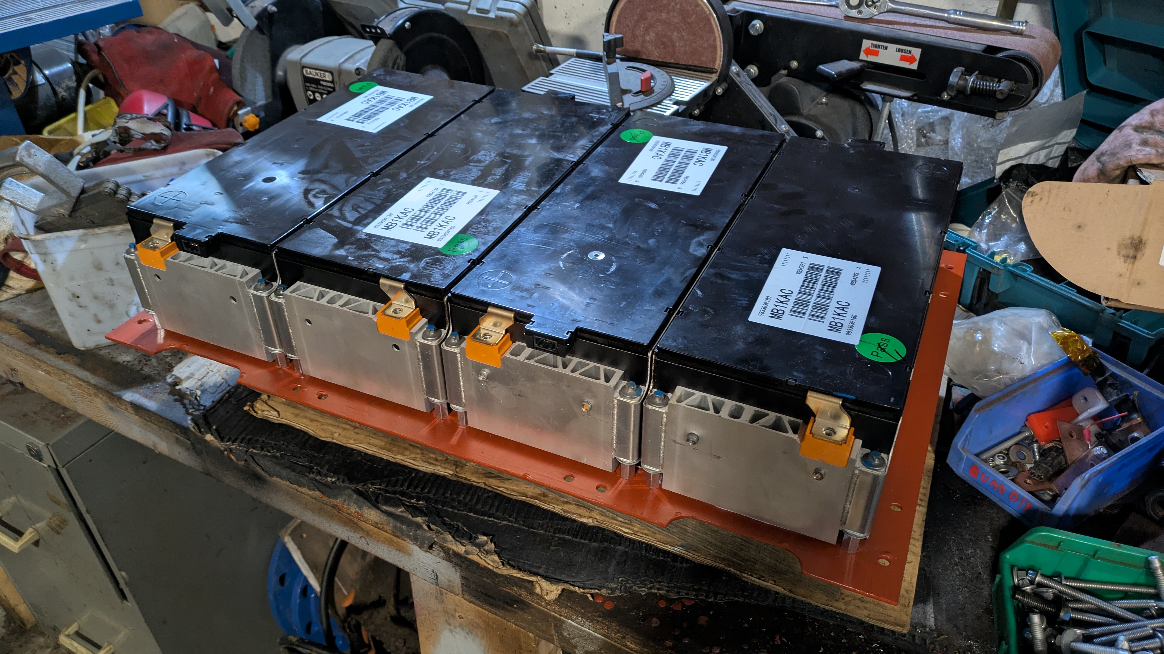

Corsa battery arrived and the modules have been harvested. The hardest part was the 2cm of sealant around the lid. Took hours to get the lid off.
I'm going to be using 16 of the 18 modules for 96s, otherwise the DC-DC won't be happy. it does bring me down to 45kWh but that's fine with me.
Been working on the design for the box in CAD. Originally I was going to go for thicker aluminium sheets and spacers. But that's expensive and weight isn't an issue so it's all steel.
4 modules per layer in 4 layers, probably solid busbars in each layer then a flexi between the levels. The top is the junction box, but I got lazy with that so I'll just drill out the holes for contactors etc when I get it. Luckily there isn't really much in the way of ancillaries for this, just the charger and the DC-DC. I'm going to use the pass through on the charger to connect to the DC-DC so that makes it pretty simple in terms of HV connectors.
Ideally I'm going to build this away from the tractor, then drop it in over a day or so to reduce down time. In reality I might just build it up in situ again since it's not like it's a daily driver.

Finally got the battery box parts back from laser cutting and folded up last week. Today I found some time to weld it all together and it turned out pretty well. Made some design changes from my last post and brought the top layer in a little bit, this way the connectors shouldn't stick out the back of the box too much. Still need to buy some more primer, final coat will be Massey Ferguson silver mist to match the wheels.
