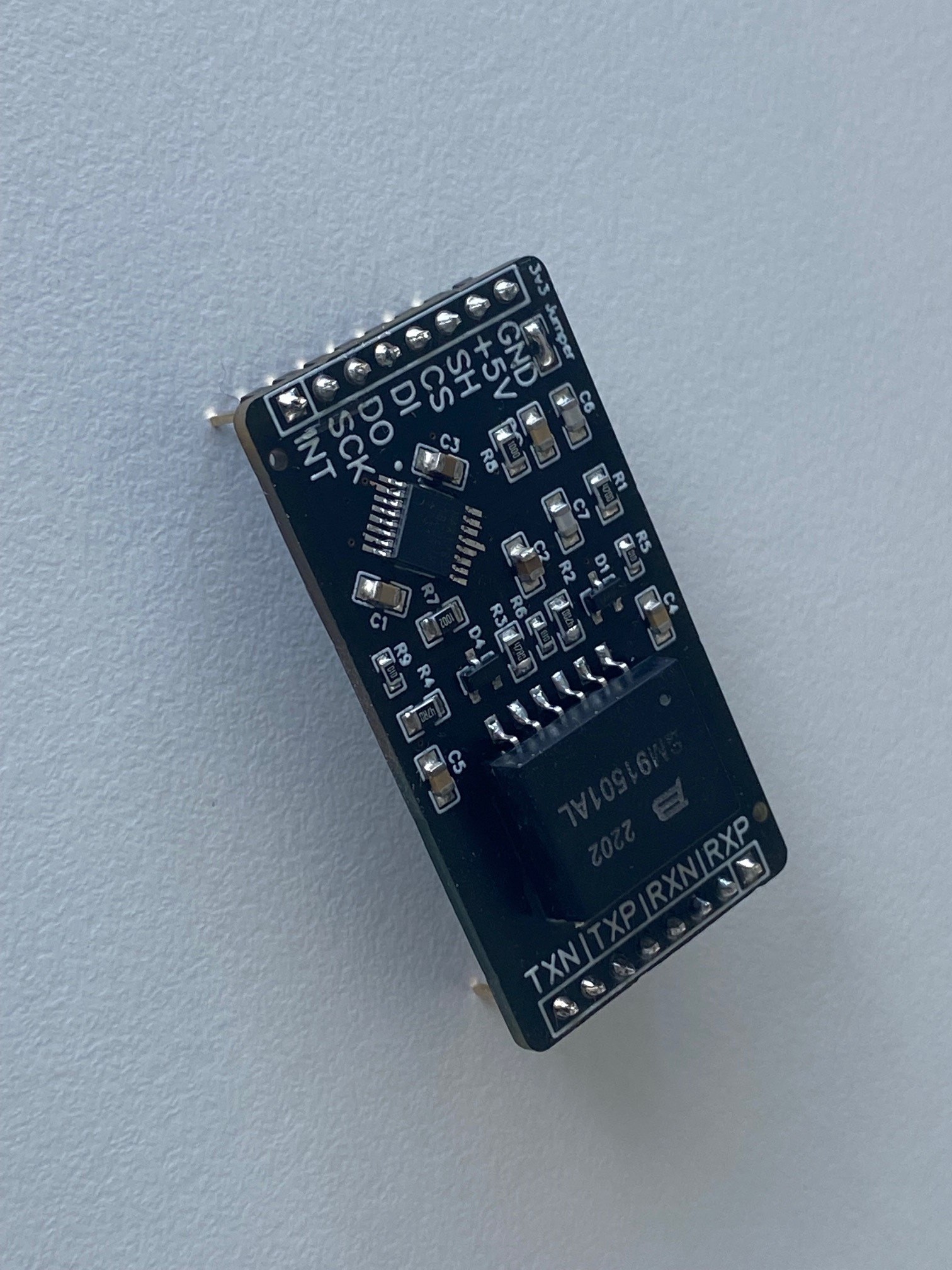

I have a couple of MAX17841 interface boards left if someone is interested. 40eu.
Pm me for schematic.

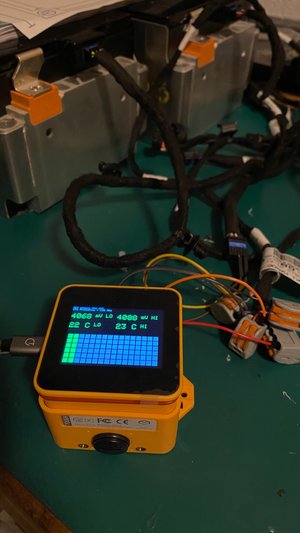

After a bit of help with the MAX17841 / MAX 19823B combo. Using the interface board from Clanarn matched to 16 Peugeot-208 modules along with Arduino UNO as the process. All the voltages are reading correctly from Registers 0x20 to 0x25 (first six cells), the problem comes with reading the AUXIN1 and or AUXIN2 for the cell temperatures ( Registers 0x2D and 0x2E) both are reading nonsense output, AUXIN1 very close to 0 and AUXIN2 maxed out (FFFO)
Reading
3 2D 10 0 10 0 10 0 10 0 10 0 10 0 10 0 10 0 10 0 10 0 10 0 10 0 10 0 20 0 10 0 20 0 0 E6 10 (AUXIN1)
3 2E F0 FF F0 FF F0 FF F0 FF F0 FF F0 FF F0 FF F0 FF F0 FF F0 FF F0 FF F0 FF F0 FF F0 FF F0 FF F0 FF 0 CE 10 (AUXIN2)
I understand AUXLN2 may not be used and is pulled high, the MEASUREEN Register 0x12 is set to 0x303F, but 0x103F and 0x203F have both been used.
I have tried the delay function in Register 0x19 and switched the THRM voltage to on manually and auto.
Any ideas are very much welcome.

I thought I would put together a list of things I have found out about the Peugeot e-208 CATL modules.
Firstly a big thank you to Clanarn for designing the master board, bexander for the software and chris01290 for software and general advice.
The e-208 modules use the MAX178xx family of devices. e208 modules using Max17823B and the master to control these is MAX17841B as the master controller.
Clanarn has made a niffy little board using the MAX17841B, please bear in mind that this board only uses the 4 middle pins on the TX/RX end.
ie
TXN pin 1 Not Used
TXN pin 2 Not Used
TXP pin 3 is TXN and goes to pin 1 on Module 1 (RXNL)
TXP pin 4 is TXP and goes to pin 7 on Module 1 (RXPL)
RXN pin 5 is RXN and goes to pin 8 on Module 1 (TXNL)
RXN pin 6 is RXP and goes to pin 3 on module 1 (TXPL)
RXP pin 7 Not Used
RXP pin 8 Not Used
Wiring on the Modules, look at the rear of the connector plugged in the module the right way up. Pin 1 Top Left, Pin 6 Top Right, Pin 7 Bottom Left, Pin 12 Bottom Right
Pin 1 RXNL
Pin 2 blank
Pin 3 TXPL
Pin 4 blank
Pin 5 goes to pin 8 on Module 2
Pin 6 goes to pin 7 on Module 2
Pin 7 RXPL
Pin 8 TXNL
Pin 9 blank
Pin 10 goes to pin 3 on Module 2
Pin 11 blank
Pin 12 goes to pin 1 on Module 2
and so on until the end when Pin 5 loops back to Pin 12 and Pin 6 to Pin 10, the end of the daisy chain.
I believe the original wiring harness twists the wrong pairs!
The Cells are connected to the first six Channels, so voltages are read from the address 0x20 to 0x25.
Now onto the cell temperature sensors. each module has three NTC and are not contacted as the MAX chip manufacturer recommends.
Being three the board uses a combination of two logic gates, which use GPIO 0 and GPIO 1 to switch outputs/inputs
Address 0x11 drives the GPIO,
so 0x7001 selects NTC1 and NTC2 with NTC1 connected to AUXIN1 and NTC2 connected to AUXIN2
and 0x7002 select NTC3 connected to AUXIN2, AUXIN1 is left unconnected and should not be stored.
I have also found that the THRM voltage needs to be switched on to let the circuit settle. I leave it on by using address 0x19 0x0310, the 3 is the THRM on and the 10 is a small delay, may not need it.
The address 0x2D is for NTC1 and leads with the LSB then MSB. Shift the LSB 4 to the right and MSB 4 to the left and add the two together
measTemperature = ((readRegisterData[3 + (i * 2)] << 4) + (readRegisterData[2 + (i * 2)]>>4));
i being the module number.
Address 0x2E for NTC2 and 3
The good news is the read-out is linear.
So for NTC1
temperature = (measTemperature - 1680)/32;
and for NTC2 and NTC 3
temperature = (2450 - measTemperature)/31;
Both in C
I was not allowed to take over control of the freezer for a couple of days, I was told that was a step too far. So freezer packs and hair dryier were used, and the readings were linear I just may be a deg or two out.
By the way, NTC1 is in the middle, NTC 2 and NTC 3 are next to the module terminals.
I have not added the documents for the MAX178xx family as these are already been added to this post along with examples of software.
Hope this helps.
Joe

Sorry, I have not been clear. At the moment I do not get to the end of the daisy chain init sequence.
After this sort of thing (start transmit preambles):
digitalWrite(SPI_MAX_CS_PIN, LOW);
vspi->transfer(0x0E); // Write Configuration 2 register
vspi->transfer(0x30); // Enable Transmit Preambles mode
digitalWrite(SPI_MAX_CS_PIN, HIGH);
There's a while loop:
while (check != 0x21) // If RX_Status = 21h, continue.
check = vspi->transfer(0x01); // Read RX_Status register
Which (when MAX board is connected up OK) always returns 0x11, which I believe means idle empty.
I am looking for 0x21, which I believe means busy empty, meaning that the slaves appear to have woken up to the preambles.
All help much appreciated!

Anyway having quadruple-checked my wiring, I am now up and running. Thanks to all for the help.
Little test with 2 modules:

Good to hear you have got things working.
I think I got it right as Pin 1, 7,3,8 come/go back to Module N-1 or Master and 12, 5, 10, 6 go on / come back from Module N+1 or loop back.
By the way, you can set the slaves not to have the loop back and do this internally.

Yes, I saw the internal loopback in the chip docs.
I think I see how we can both be right re the pins. I was simplistically dealing with it, for my test case with (many) missing modules, by putting jumpers into the first empty connector in the chain. You are referring to jumping the last used / connected connector in the chain. Same wires, different pins!

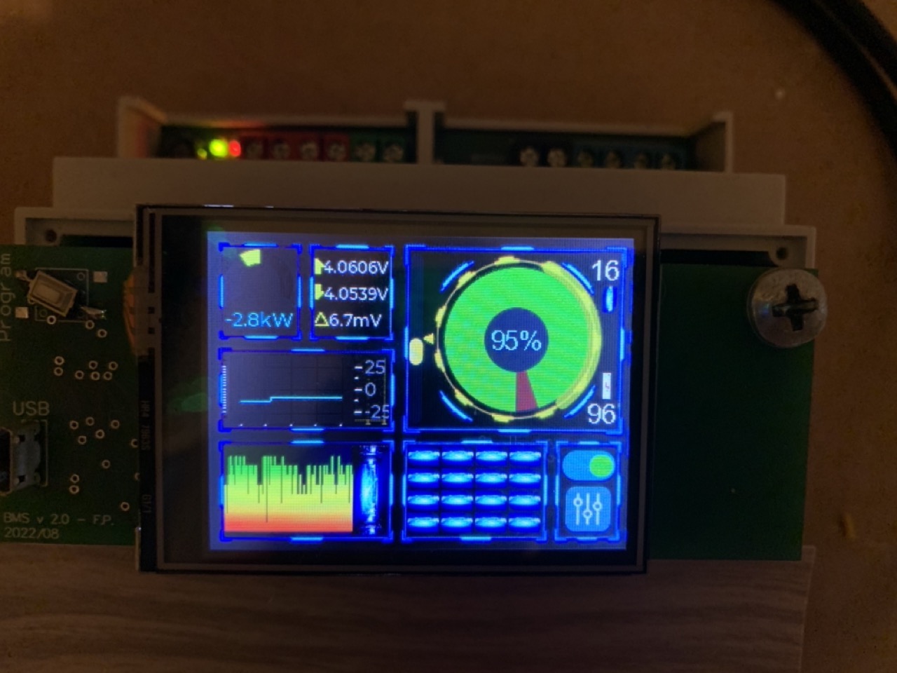

Congrats, to success, now the funny part can begin :-)
btw, nice visualization of data on display.
I can share some photos of my BMS here for inspiration. its designed onto DINrail mount:
Its from test desk without covers and it include HV contractor.

ecertik wrote: Tue Aug 30, 2022 9:23 pm Congrats, to success, now the funny part can begin :-)
Nice!
Super!
