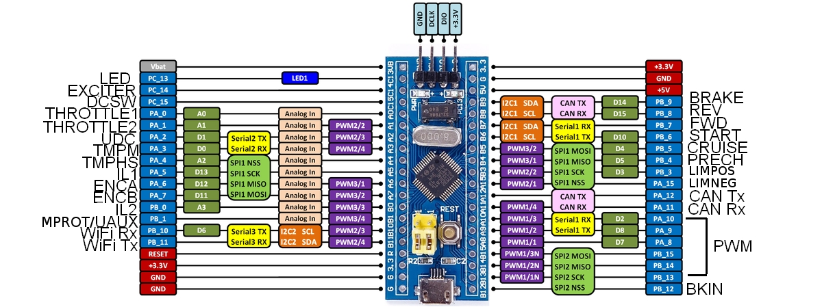

Got myself a blue pill :)
So the best way to figure out whether running on a blue pill is turning on GPIOC12 (Led port of Olimex and other HW revisions) and then read it back. Since the port does not exist on the C8 it reads back as 0.
I also checked the FLASH_SIZE register and its actually 0x80 = 128k flash :)
Finally I found out that TIM4 actually runs, it is just not connected to any pins. So theoretically it would be possible to restore the over current reference pins using TIM2 and doing the scheduling with TIM4.
Been thanked: 1918 times
Re: Johannes in a Blue Pill
So in order to restore the over current reference pins I'd have to delete ESTOP (quite unimportant) and remap DCSW to PC15.
Damien, what do you think?

Alright, here is a new pin map and firmware

Good evening, I would like to ask if a single-channel encoder will work on it? What is the exciter pin used for?
yaroslav wrote: Tue Aug 27, 2019 7:41 pm Good evening, I would like to ask if a single-channel encoder will work on it? What is the exciter pin used for?
Single channel not yet but I think it can be restored.
Exciter pin generates a square wave in resolver mode that is turned into a sine wave by a 3-pole low pass filter and then amplified by an audio amplifier. With that the resolvers primary winding is excited, see wikipedia why this is needed.

Good evening, I collected on such a Board inverter for the test, but there was a mistake DESAT what are the conditions for its appearance?
Dilbert
Posts: 410
Location: Dublin, Ireland
Post by Dilbert »
yaroslav wrote: Sat Aug 31, 2019 4:35 pm Good evening, I collected on such a Board inverter for the test, but there was a mistake DESAT what are the conditions for its appearance?
Are you getting the desat error flagged every time you try start your dev board? You need to pull the fault line low, I believe the same line is used for a few different faults.

I think I found the cause, you need to pin pb12 to apply logical unit, as in previous schemes was 0, as then to implement the current protection?
