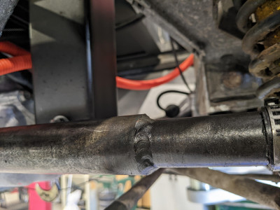

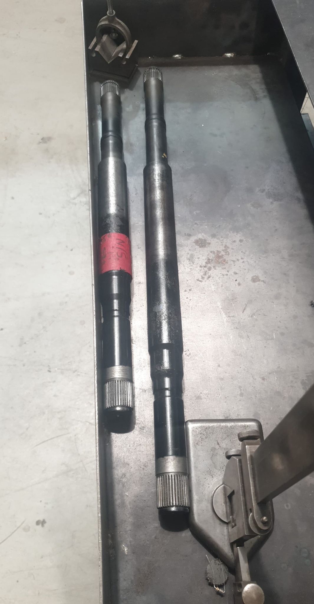

There seem to be a few opinions about how best to complete the join. The options seem to be:EV_Builder wrote: ↑Wed Jul 13, 2022 8:19 pm @catphish you might want to consider 2 things. After welding drilling the shafts completely and press steel H7 8 or 10mm pen through it all or better send them off to Poland and get them back with new middle axles made to your distance and splines for 150euros excl. transportation.
1) Just weld round the visible join.
2) Drill 4 shallow holes and plug weld.
3) Drill a single hole right through the join, insert and weld a pin
Options 2 and 3 should create a stronger joint at the expense of weakening the outer shaft.
I am indeed considering sending the prototype shafts to someone like this to remanufacture: https://berrisford.co.uk/product/custom ... ny-length/
Here they are, press fitted but not yet welded.

1 gives you strength but the issue is from a tension point of view that you kinda have a "line" contact which means that if the axle isn't perfect inline, which it won't be, that the forces wony be even spread i fear.
4option:
Imagen milling a two slots of say 8mm into the hollow shaft.
(U style from above)
Now you increased welding length considerably but you also kinda grab the axle on 2 points so to speak. The weld will make sure the U doesn't open and it will join further the 2 axles. Now if it's enough I doubt it. But it's worth a try at your stage I guess. I mean Tesla's axles are solid, non tube, for a reason...
4option:

Fit tubing over the joint, spanning a couple of inches either side of the joint. Weld both ends of the tubing circumferentially with at least three passes - ensure you bevel the tubing ends to get a wide area for the weld to bite.

The shafts aren't the same diameter so I don't think it would be very easy to securely weld a sleeveremy_martian wrote: ↑Wed Jul 13, 2022 9:24 pm Fit tubing over the joint, spanning a couple of inches either side of the joint. Weld both ends of the tubing circumferentially with at least three passes - ensure you bevel the tubing ends to get a wide area for the weld to bite.

If you weld around the circumference then the failure mode that I'd be worried about is on the HAZ in the smaller shaft. It's a fairly nasty failure mode as the flailing end of the driveshaft can do a fair bit of damage to suspension before flying out. With that said I wouldn't be comfortable not welding around the circumference either as it is where all the strength is! With the welded shaft I would weld the circumference of the existing join but then fit a sleeve (machined to match both shaft diameters) over the top of the weld and then plug weld through multiple holes to secure it. That way you have the full strength of the current but joint, the added strength of the sleeve, minimised HAZ at the sleeve ends and the fact that if a weld fails the sleeve may hold it together while you slow down.
The trouble with option 2 & 3 (assuming that they are not combined with 1) is that they are asking the machined down section of the smaller shaft to take the full torque and I can't see that working. Bear in mind that it's the outer skin of the shaft that provides most of the strength. Performance shafts are often hollow to save weight (although they tend to be larger diameter too).
Whichever route you take, once it is in, I would paint a straight line down each shaft and do several hard low speed starts on a high grip surface and look for any signs of twisting on the shafts.
The other question is tyres, the better the tyre the more stress on the driveshafts. If you ever plan on doing track days with a sticky compound....
With the torque you have available from the Tesla motor I'd probably get custom shafts made - otherwise you will be worrying about it every time you use the power.

Just thought a little more about this - did you machine down the smaller shaft at all or just bore out the larger one? If the former then my comment on 2 and 3 above apply, if not they are probably not relevant. Where the larger shaft is bored out what wall thickness were you able to keep? Dependant on this thickness I would also be a little worried about the strength along the bored out hole, the wall here is largely unsupported even if you plug weld down to the smaller shaft. If the wall thickness is on the low side here I would definitely sleeve and also make sure that the sleeve extends past the base of the bored out section.

He did pressfit it in so it won't come out easy there is no room for that either. It would simply slip and loose complete traction. I would U mill the 2 axles and then fill it up with weld on a high setting. Or drill some big holes and weld that up again. The welds then need to complete shear off in order to loose traction. In the end it's a matter of welding length between the 2 parts and the strength of the hollow tube in the first place.

To clarify, I left the smaller shaft as-is, and bored out the larger shaft only. The larger Tesla shaft was left with a radius of 6mm of hardened outer material. The joints is now welded (in the simplest manner).Pete9008 wrote: ↑Thu Jul 14, 2022 7:59 am Just thought a little more about this - did you machine down the smaller shaft at all or just bore out the larger one? If the former then my comment on 2 and 3 above apply, if not they are probably not relevant. Where the larger shaft is bored out what wall thickness were you able to keep? Dependant on this thickness I would also be a little worried about the strength along the bored out hole, the wall here is largely unsupported even if you plug weld down to the smaller shaft. If the wall thickness is on the low side here I would definitely sleeve and also make sure that the sleeve extends past the base of the bored out section.
Everything is now assembled and working, but I have a knocking under light acceleration and no load, not sure where it's coming from yet...

Thanks, this sounds reasonable. I didn't do this because I was confused by all the options and didn't want to do more harm than good making more holes. Will keep it in mind though!arber333 wrote: ↑Thu Jul 14, 2022 8:56 am There are manuals for this kind of splicing. If you manage to fit one shaft into another best method would be to weld it on the joint circumference additionaly drill out at least two 8mm holes 90deg apart into larger diameter shaft some 8cm from the joint edge. Drilling those into hardened shafts is a pain i know. Then spot weld them to the lower shaft. This greatly alleviates torque point stresses and makes joint behave as uniform metal piece.

Do two or three more staggered passes on those welds.
One weld bead is not enough and you do not want any undercut.

Is it possible that you are running out of plunge on one of the driveshafts? If you haven't already done so I'd remove the shocks and move the wheel through the full suspension travel and check that there is spare movement in the CVs. Other possibility is a bit of muck/swarf in one of the balls causing it bind slightly. Can you hear whereabouts the knock is coming from?
On the joints 6mm on the limit of what I'd consider acceptable, might be worth doing a few sums on torque capability of a 6mm wall tube vs the solid Vauxhall shaft? At the very minimum I'd sleeve it with the sleeve extending past the bored out section and onto the Vauxhall shaft and then drill and plug weld. It looks like you have the space and as arber333 says it would spread the loads into the shafts much better.
Having said that, once you are happy with the lengths and operation, I'd get custom shafts made.
