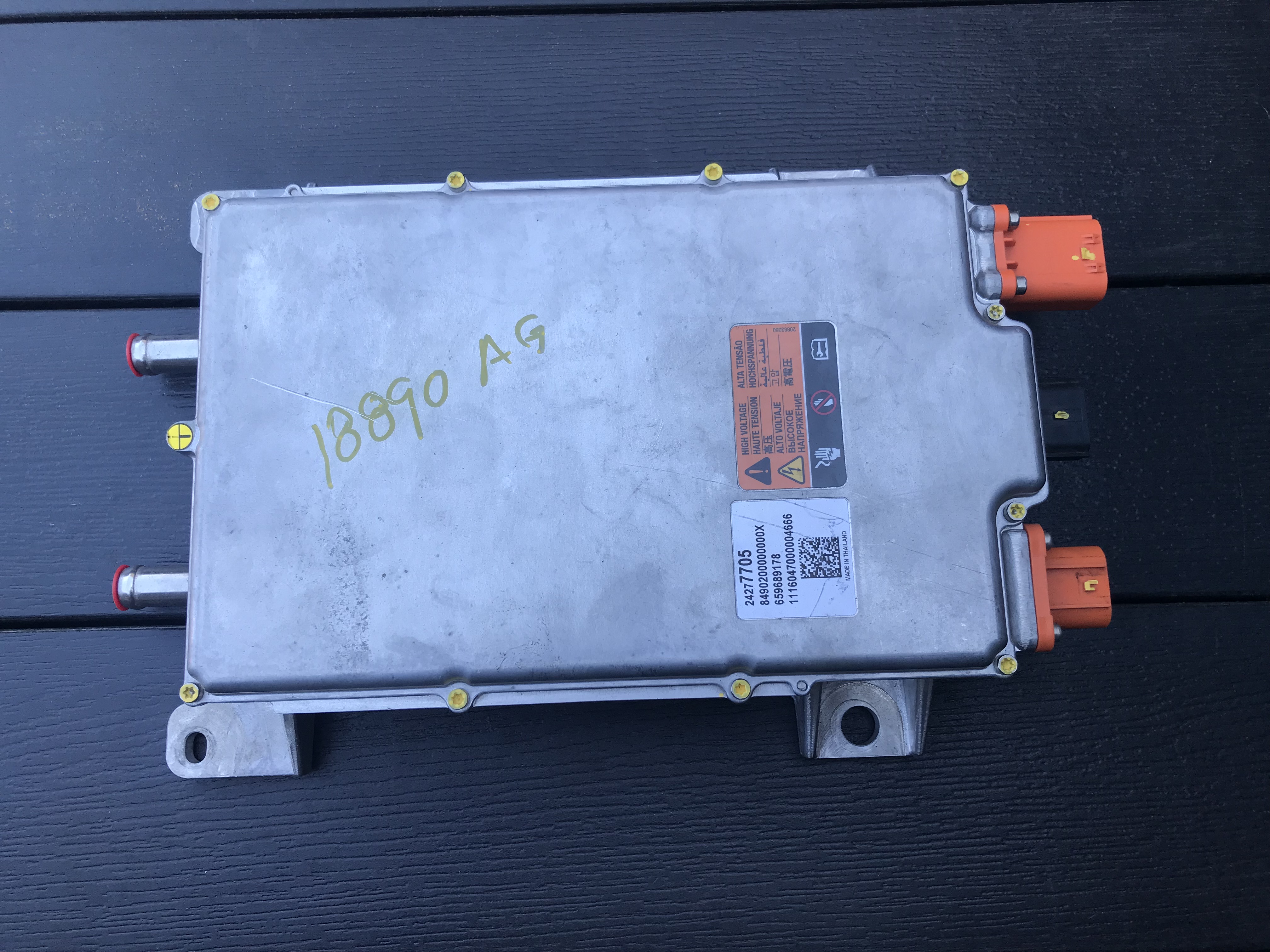

crap, I had it right the first time, these below are Chargers not converters?

alright, tell me this is the Gen 2 onboard battery charger part #24275451, and we all can be friends again, ha ha
(boy I hate learning more than I have to, my brain hurts)

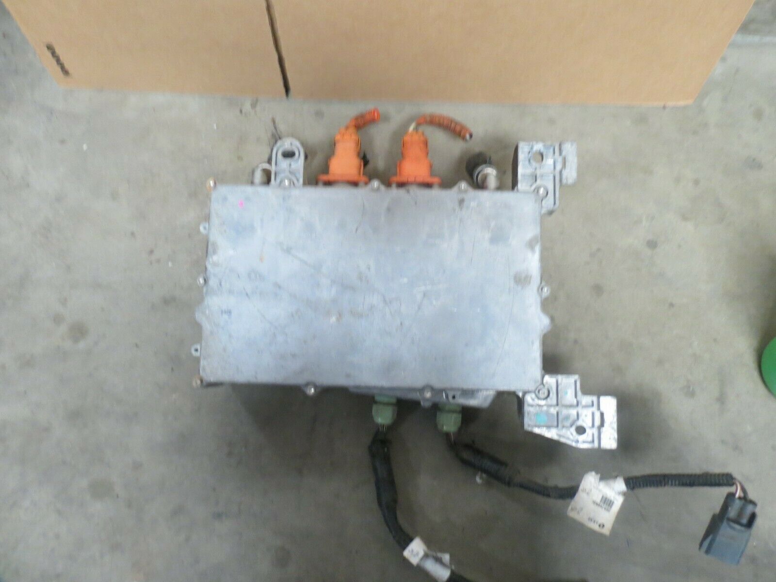

Re: I bought a Chevy Volt Gen1 DC-DC Converter - Now What?
Posted: Sat Feb 19, 2022 11:00 am
by EV_Builder
The long air cooled unit is a DC/DC converter. You recognize the DC/DC ones often haveing the M8 studd for the 14VDC output.
The water-cooled , compact box is the charger. It's single phase 3kw and PWM driven I think 400volts max. (96S).
Posted: Sat Feb 19, 2022 3:59 pm
by Gregski
EV_Builder wrote: Sat Feb 19, 2022 11:00 am The long air cooled unit is a DC/DC converter. You recognize the DC/DC ones often haveing the M8 studd for the 14VDC output.
thanks for trying to help I know I am sounding like a buffoon here so please allow me to say it in pictures:
Posted: Sun Feb 20, 2022 9:19 am
by EV_Builder
The upper picture doesn't reveal if there are studs on the other side so i don't know i just saw your others pictures,,its a charger.
I do know that there is a water-cooled DC/DC too, its on splash screen of your video...
For your build you should check the voltages and the control interface too. Some are Can-bus others are PWM.

similarly GM does use multiple part numbers for the Volt second Gen battery charger
Part Number: 24281923
Supersession(s): 24277705
Part Number: 24291446
Supersession(s): 24275451; 24286781
https://www.gmpartsmog.com/p/75741768/24291446.html
Location in OEM vehicle: in the trunk
some great info on it here: Chevy Volt Gen2 Charger

alright I believe I have identified the actual part number for the Charger to Battery gen 1 cable part #22889574
Supersession(s): 22744388; 22827024
Posted: Sat Feb 26, 2022 12:32 am
by Gregski
and this is the gen 1 Converter to High Voltage (HV) "traction" battery cable part # 23432013 it appears to run from the back of the vehicle ie the trunk along the side of the HV battery to the front of it where it plugs in
Supersession(s): 22744389; 22827021
Lessons Learned from me in the future: This cable is encased in a metal / aluminum tube and is about 7 feet long, hence why it may cost so much on eBay or the shipping may make it cost prohibitive, I will post actual pics of it below!
Also if you look at how it is actually connected on the inside to the circuit board, you can ditch the orange rectangular plug and hard wire it inside with two ring terminals and call it good, since that's how they did it on the older version.
below we see just the tail end of a much much longer high voltage cable that connects the DC-DC converter in the trunk of the vehicle to the front of the battery pack right below the engine firewall, using a high voltage cable encased in a metal tube
