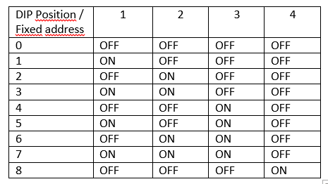

I think in the past i promised the DIP switch address table:
