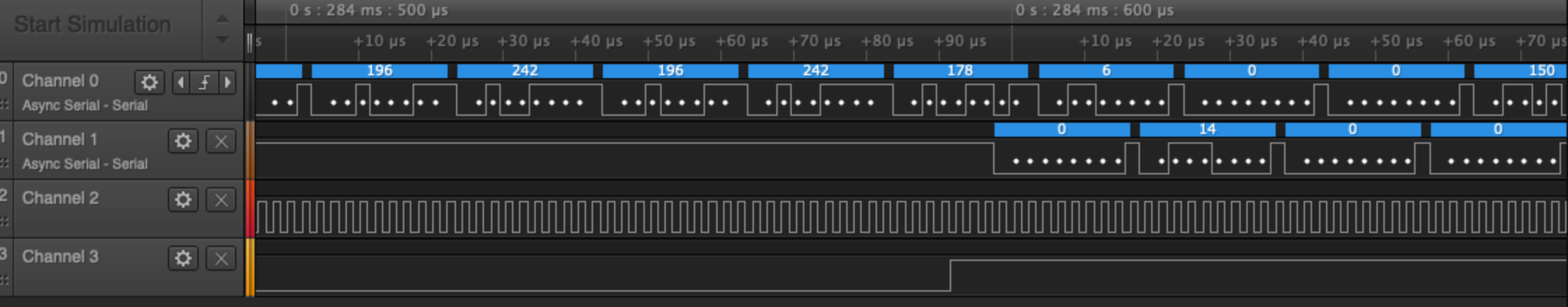

daleread wrote: Wed Mar 09, 2022 9:58 pm Download from here. logic 1.2.18 (not logic 2)
https://support.saleae.com/logic-softwa ... load-links
Then you can open Damien's logfiles
Oh, trouble...

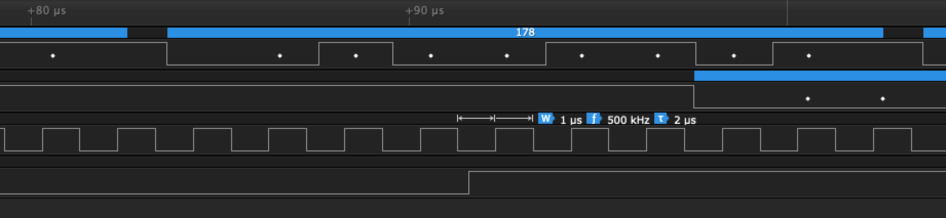

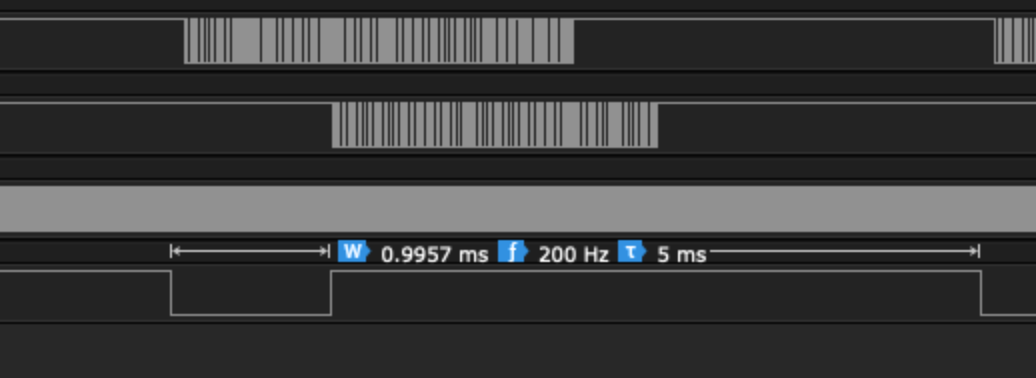

It looks like toyota updates at 5ms intervals.
It is clocked at 500kHz - and the clocks don't let up, they just blast on through continuously
So reference line is very important to get the exact right bit for the message start. I'm not sure exactly how to hook that up to chip select lines for each receiver. Might need some logic chips, or some very fast interrupts.
If you can work out what the HTM data array maps to that would be great! I don't see how to do that without recording both data lines at the same time, and probably videoing the drive and figuring out how to sync it up.

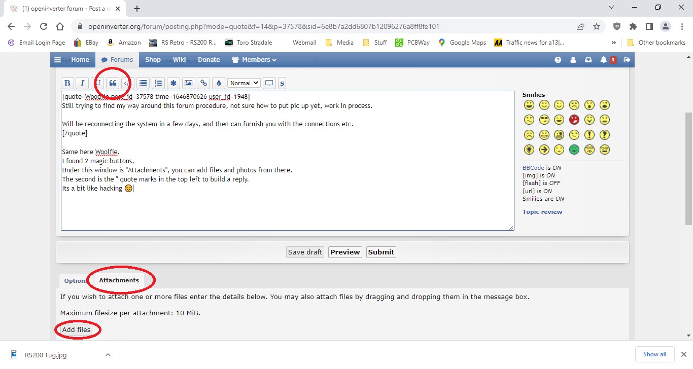

Woodfie wrote: Thu Mar 10, 2022 12:03 am Still trying to find my way around this forum procedure, not sure how to put pic up yet, work in process.
Will be reconnecting the system in a few days, and then can furnish you with the connections etc.

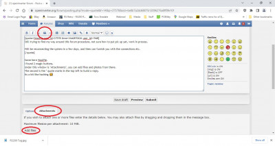

Same here Woolfie.
I found 2 magic buttons,
Under this window is "Attachments", you can add files and photos from there.
The second is the " quote marks in the top left to build a reply.
Its a bit like hacking :)
Looking forward to some photos, thanks for your help.

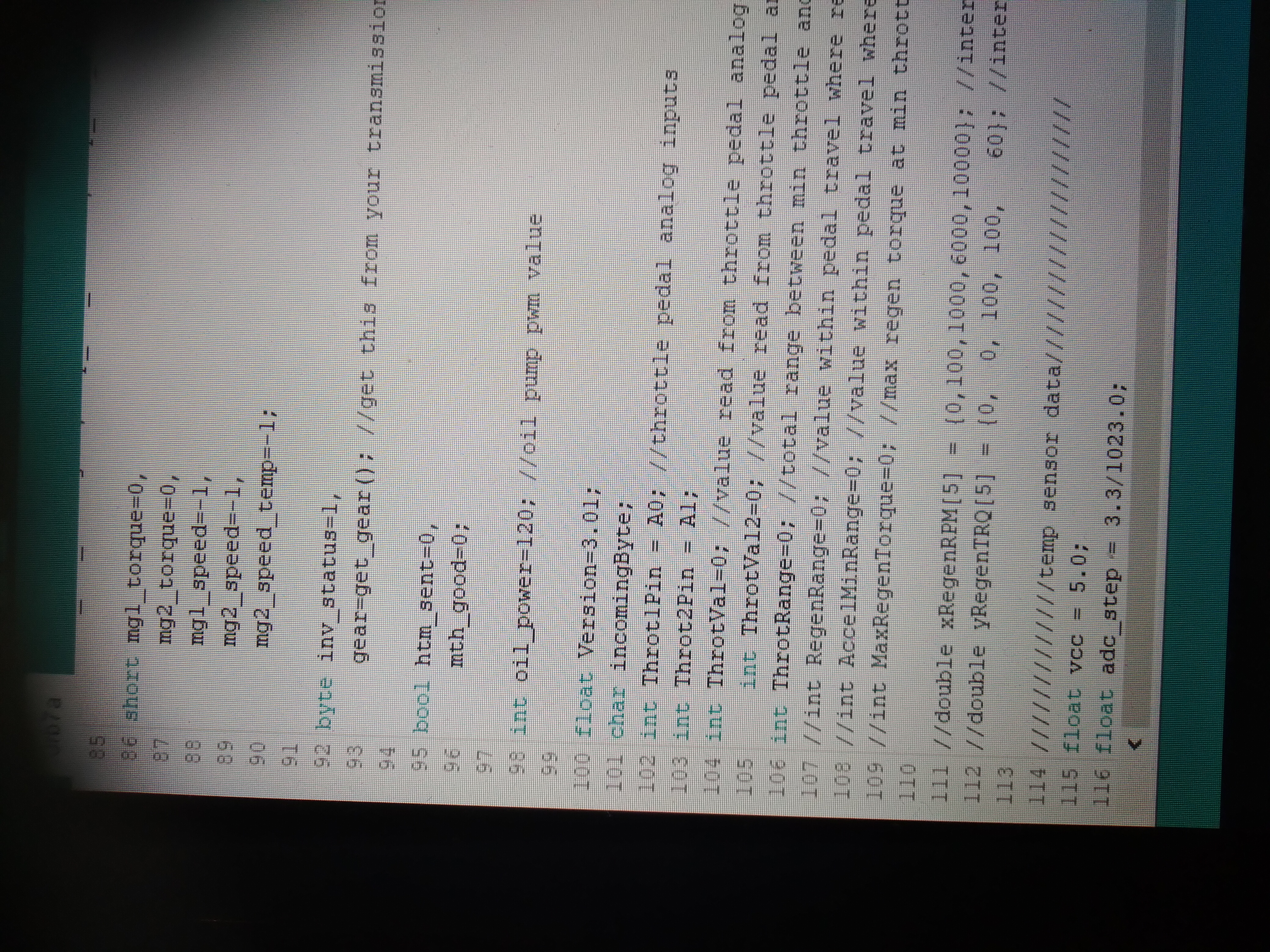

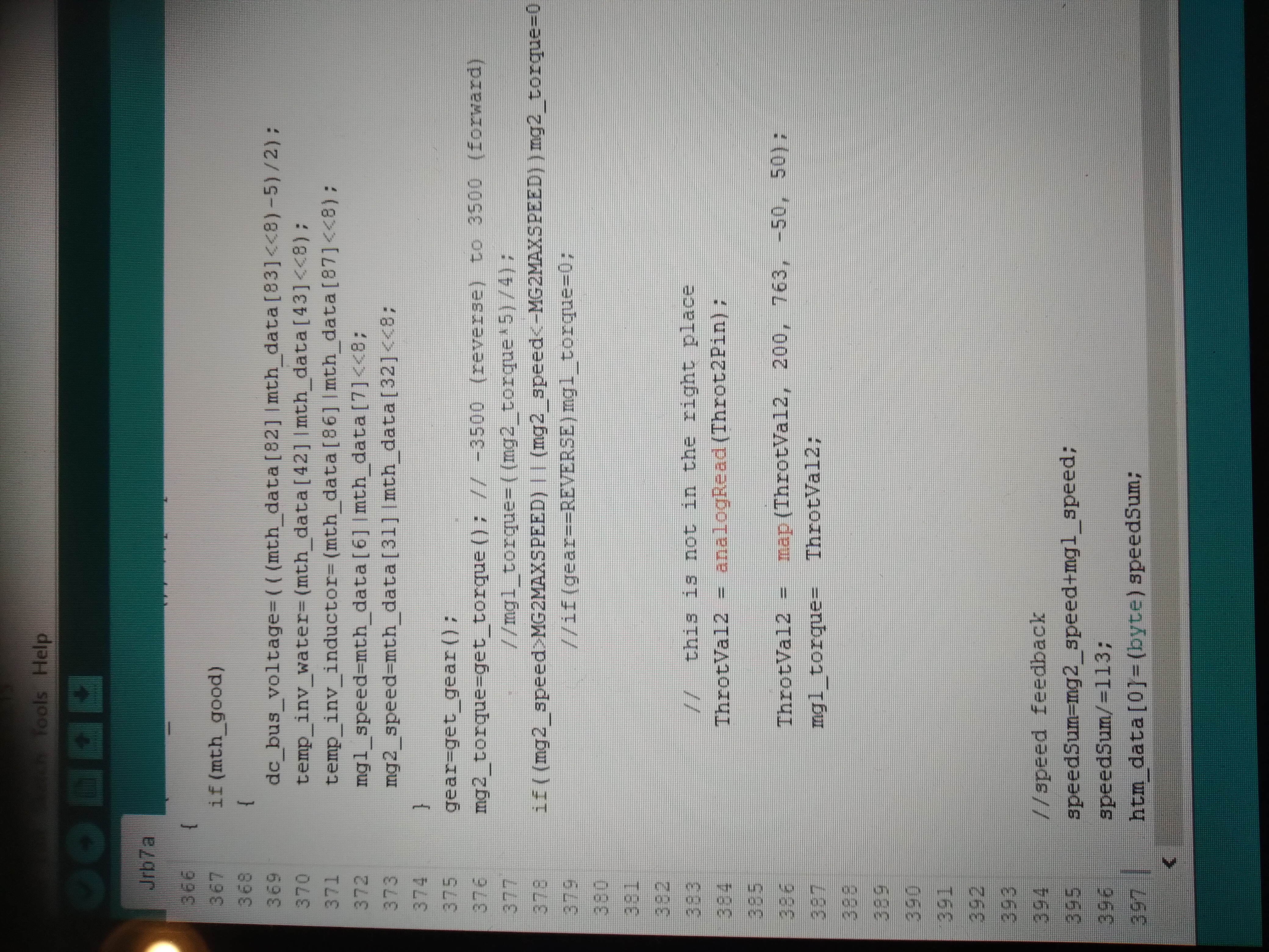

daleread wrote: Wed Mar 09, 2022 8:23 pm How do you tell each motor separately what throttle (torque) you require?
Did you hack Damien's gs450h_vcu code to do this?
Here were the changes made to the gs450h _vcu code
2 separate throttles as described in above post.

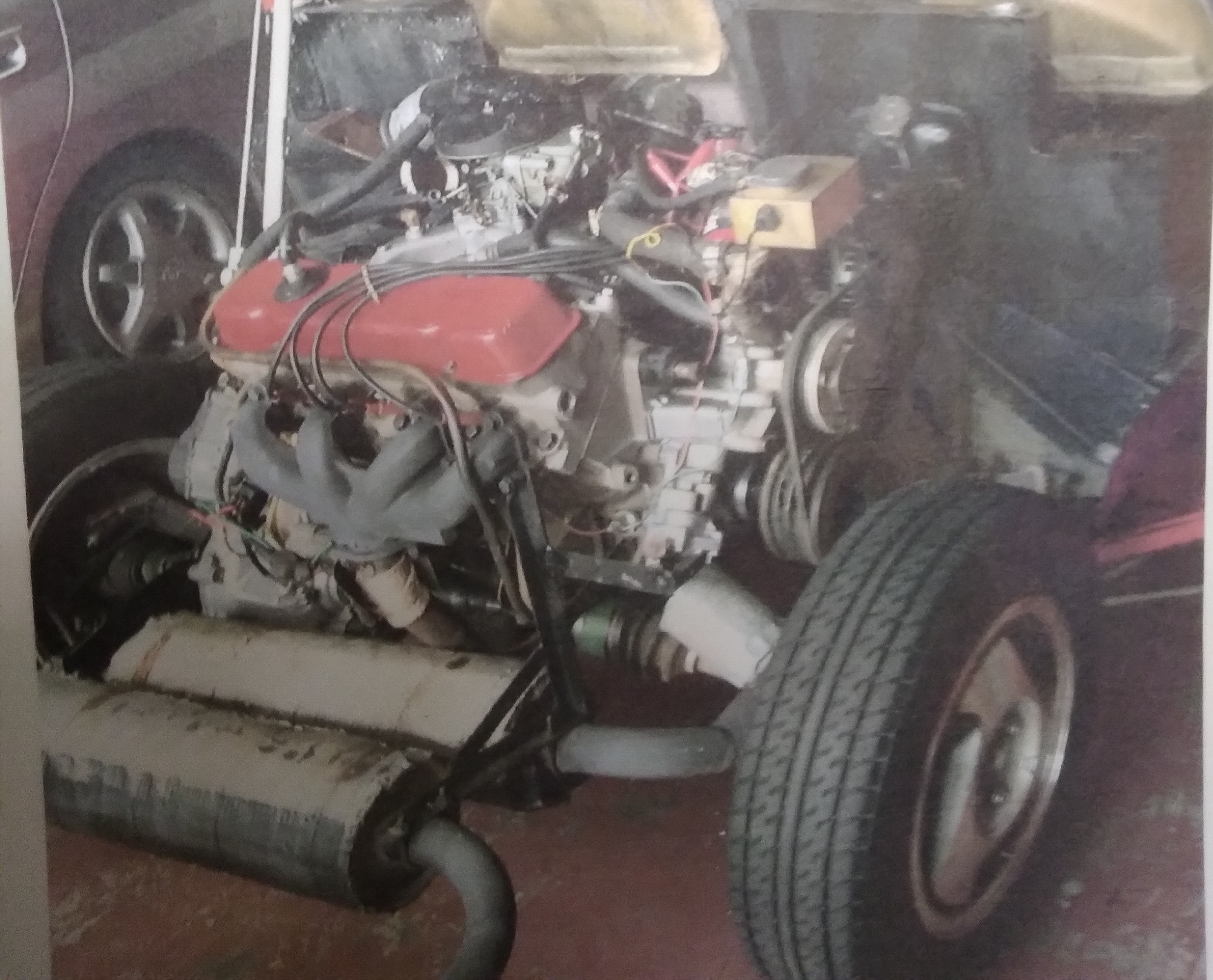

Any photos of your car? and the wiring, motor and front driveshafts and V8 and gearbox setup.
Sounds really interesting, and very similar to what I am trying to achieve.

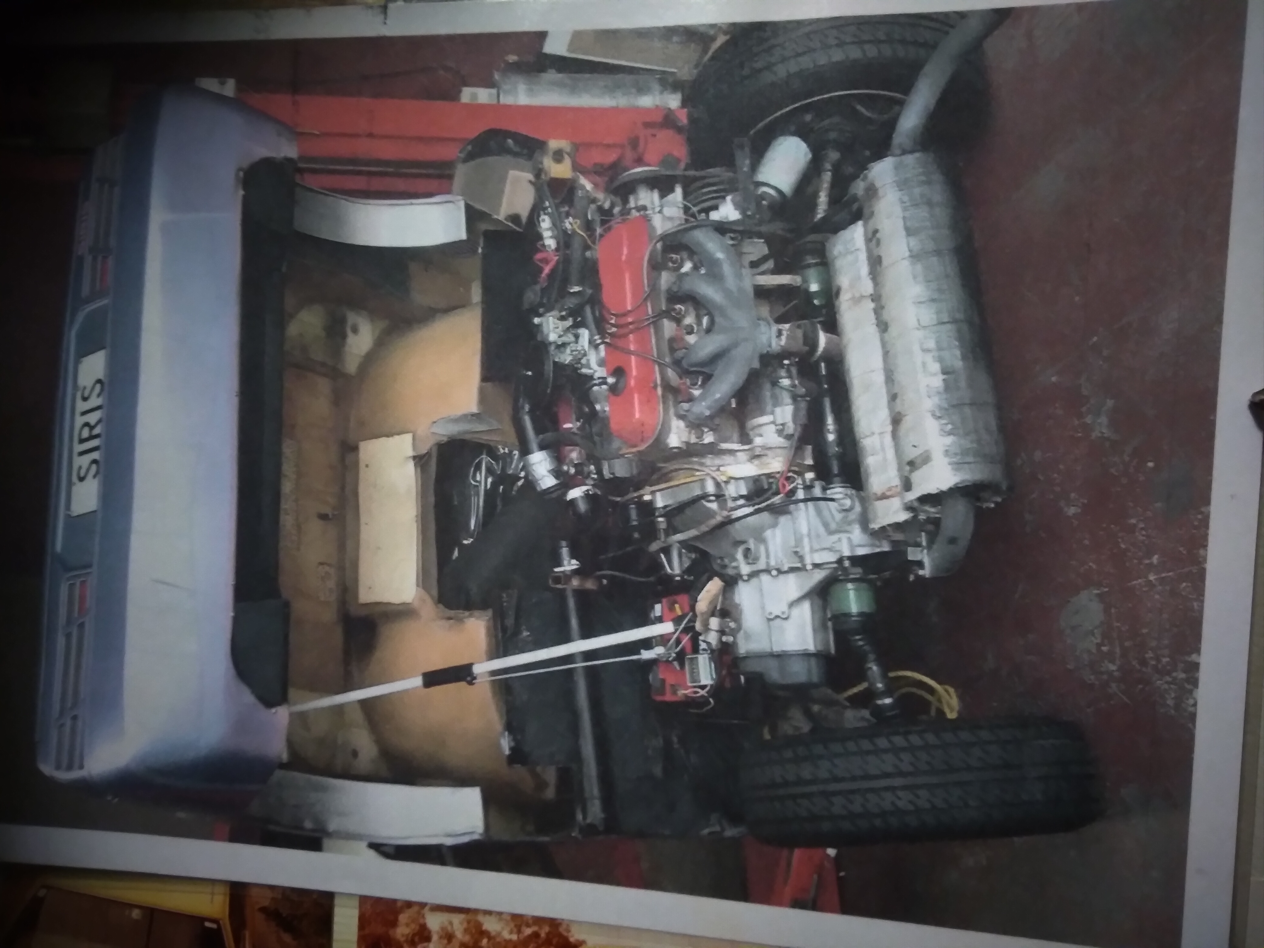

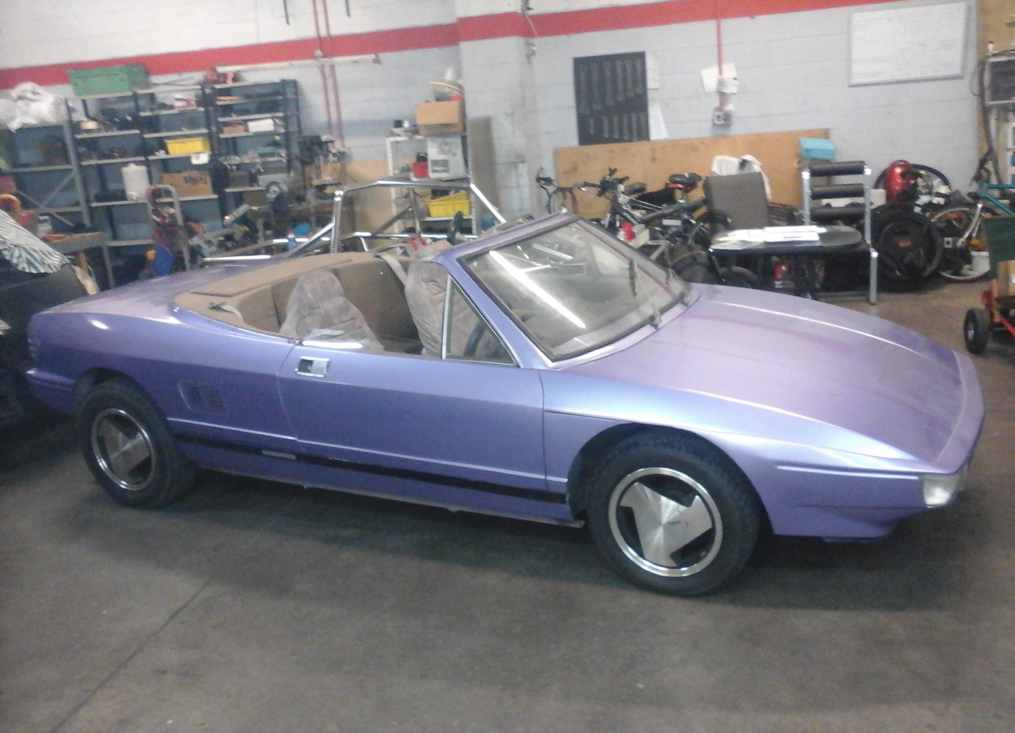

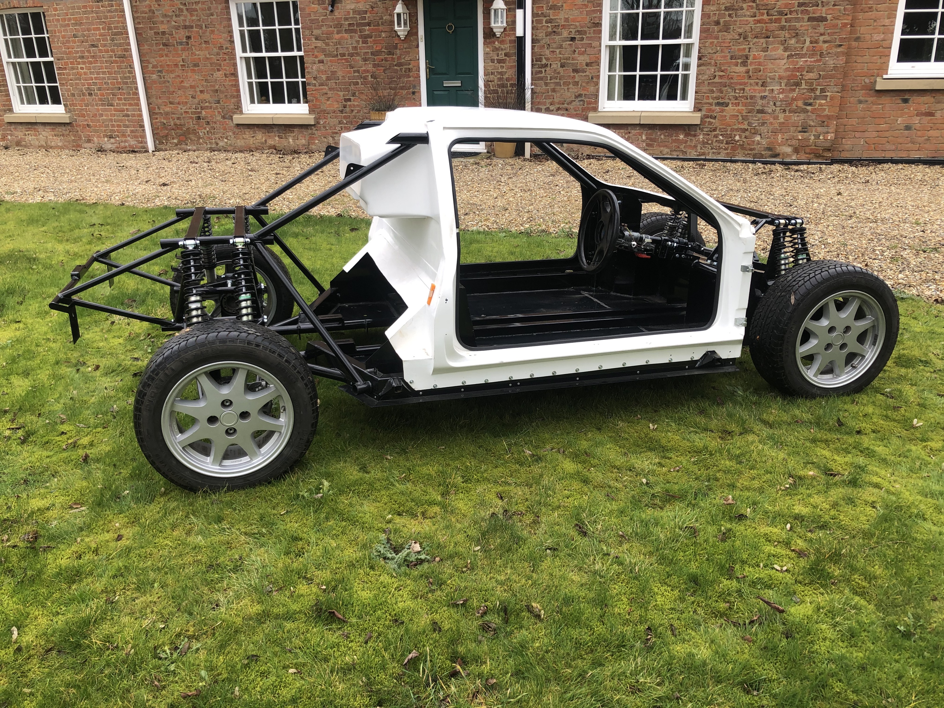

Here are some photos of the Siris Roadster.
The Mauve one is the Q211 recipient.

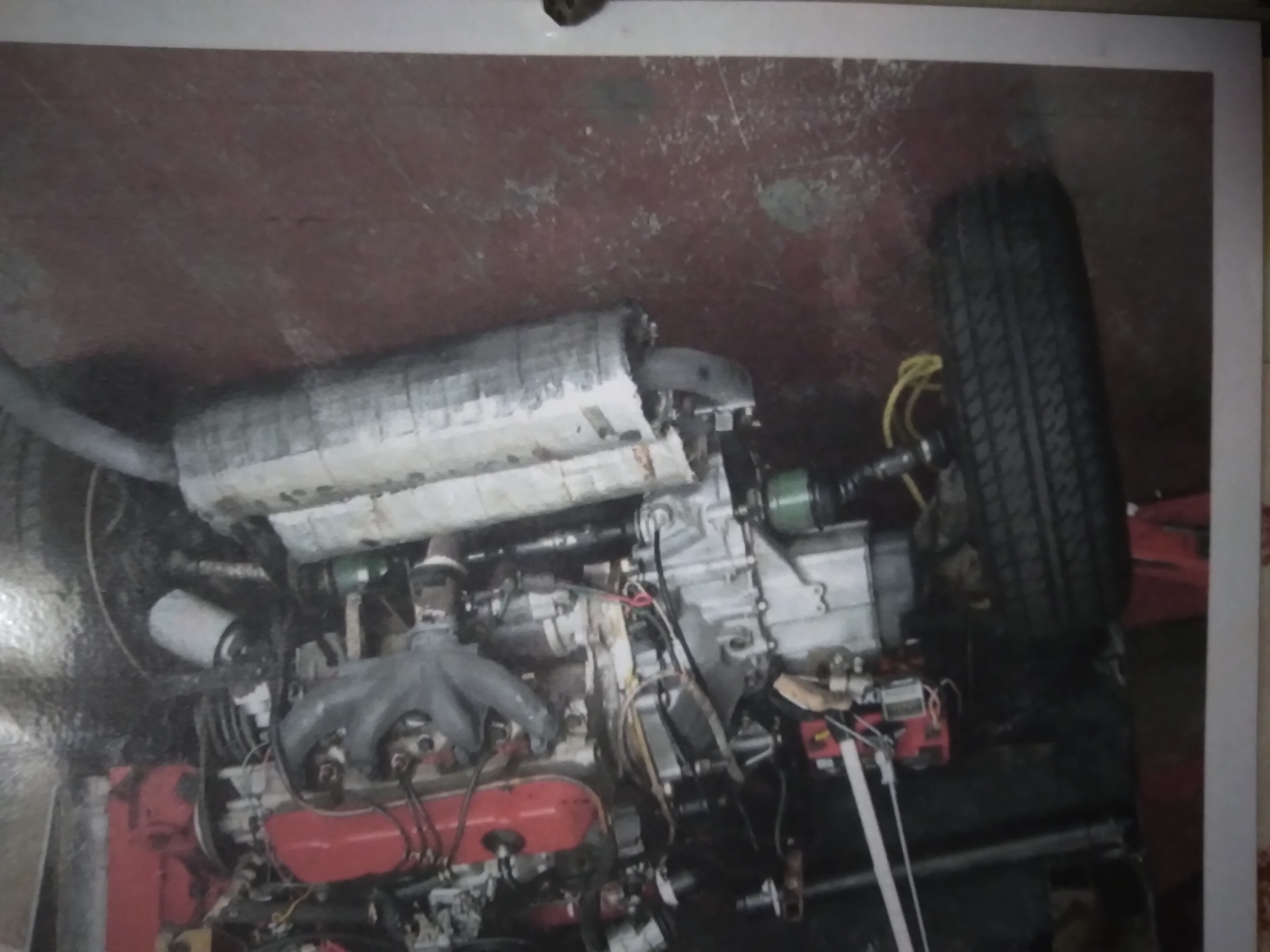

Re: Hyper car hybrid
Post by Woodfie »
Will get driveline pictures in daylight.

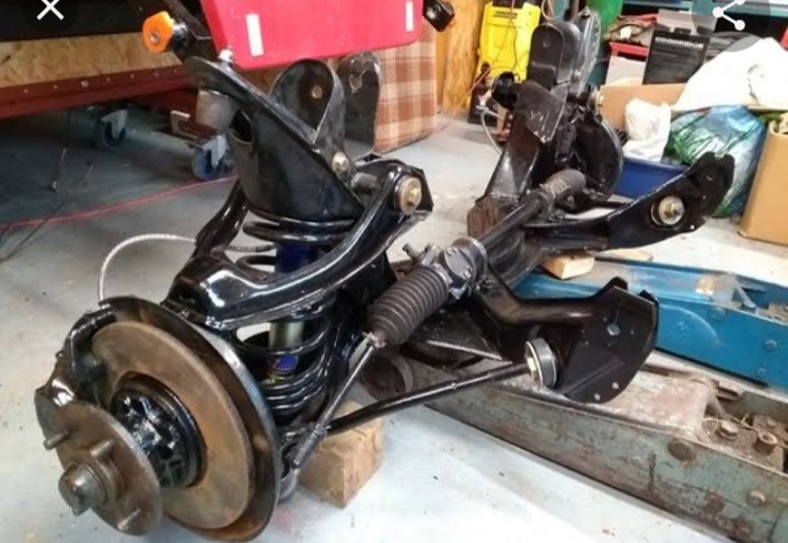

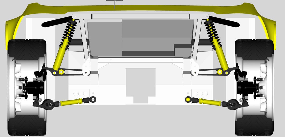

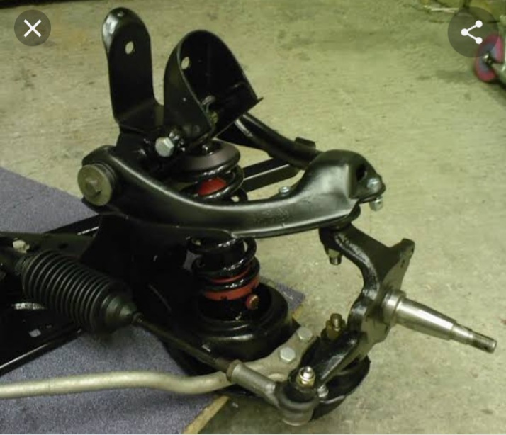

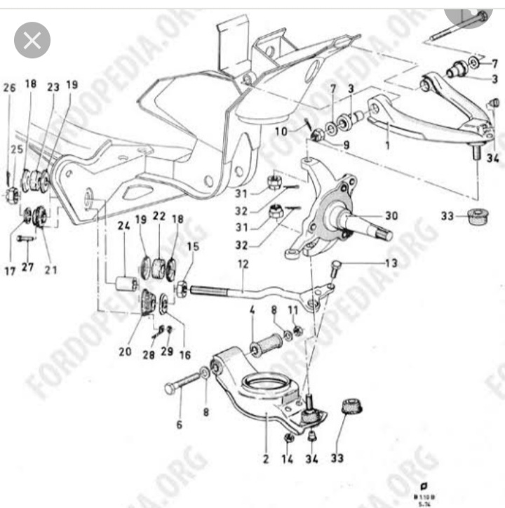

Front end at present is mk3 Cortina, am looking to install a double wishbone system , as yet un found...do you have any suggestions? What are you intending to use on RS200?
daleread
Posts: 49
Joined: Sat Mar 05, 2022 3:59 pm
Location: UK
Post by daleread »

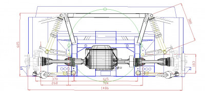

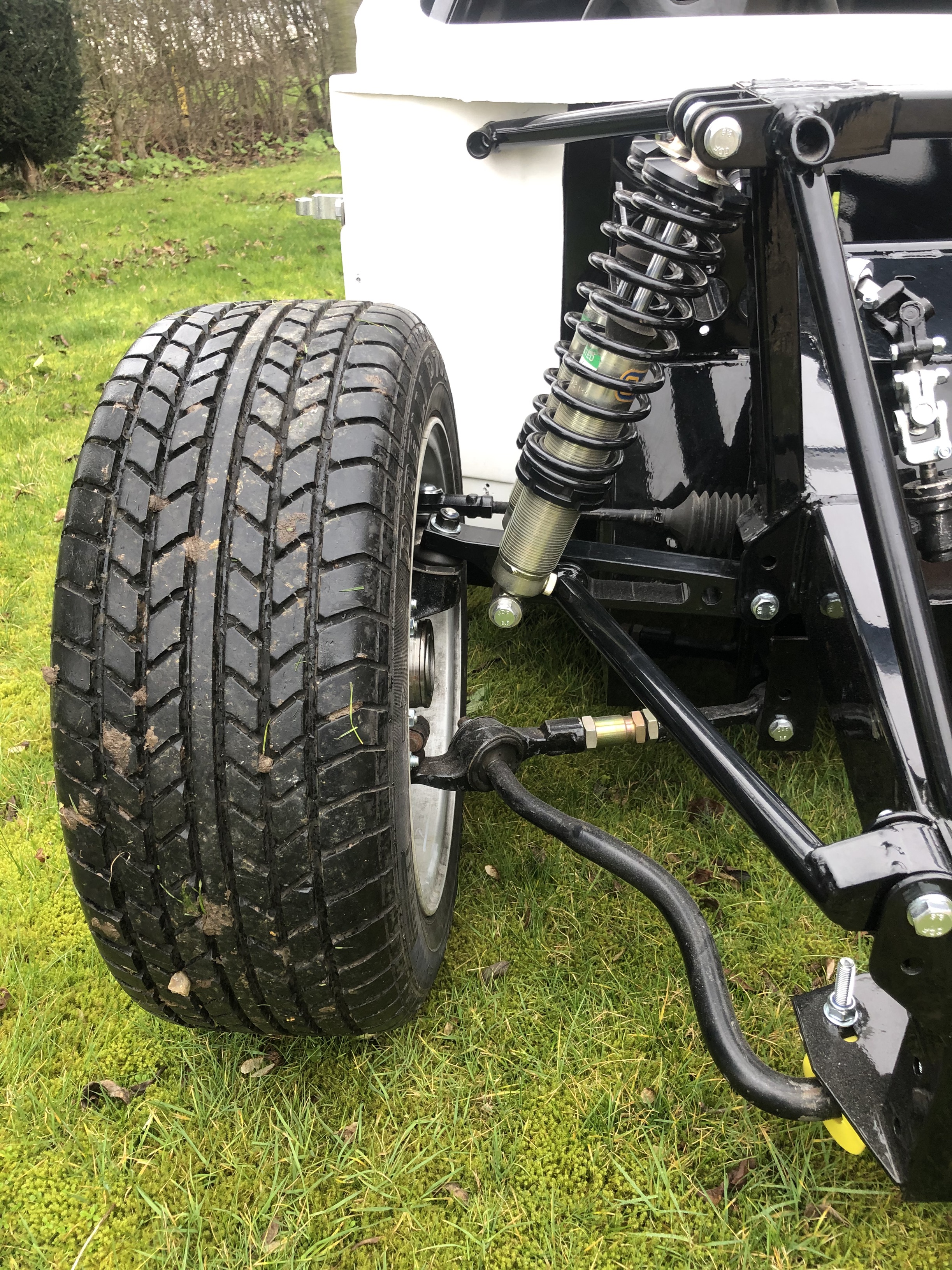

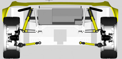

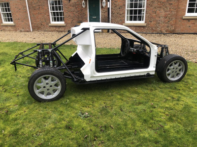

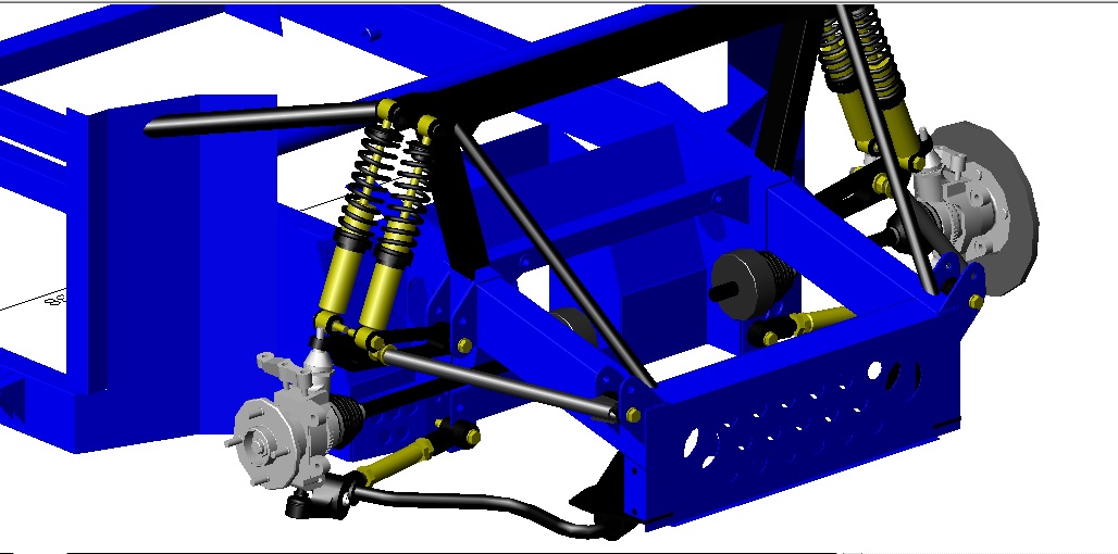

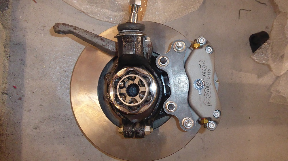

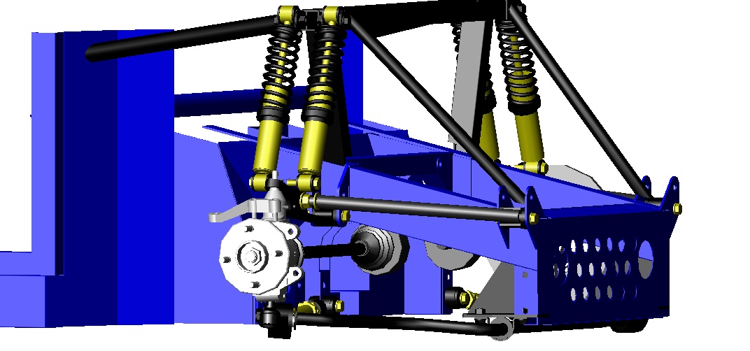

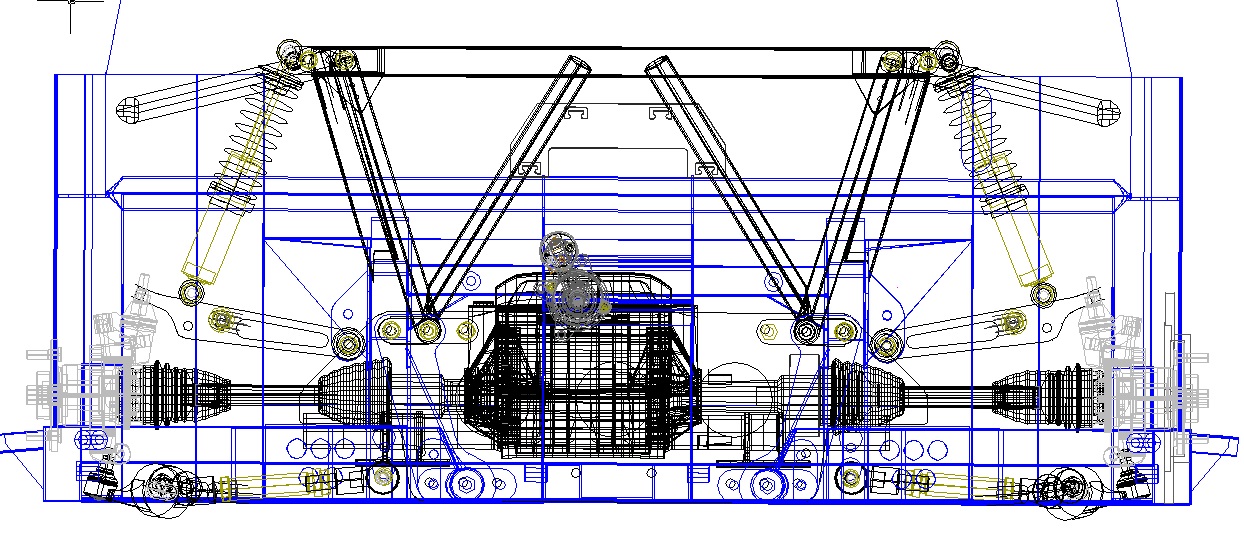

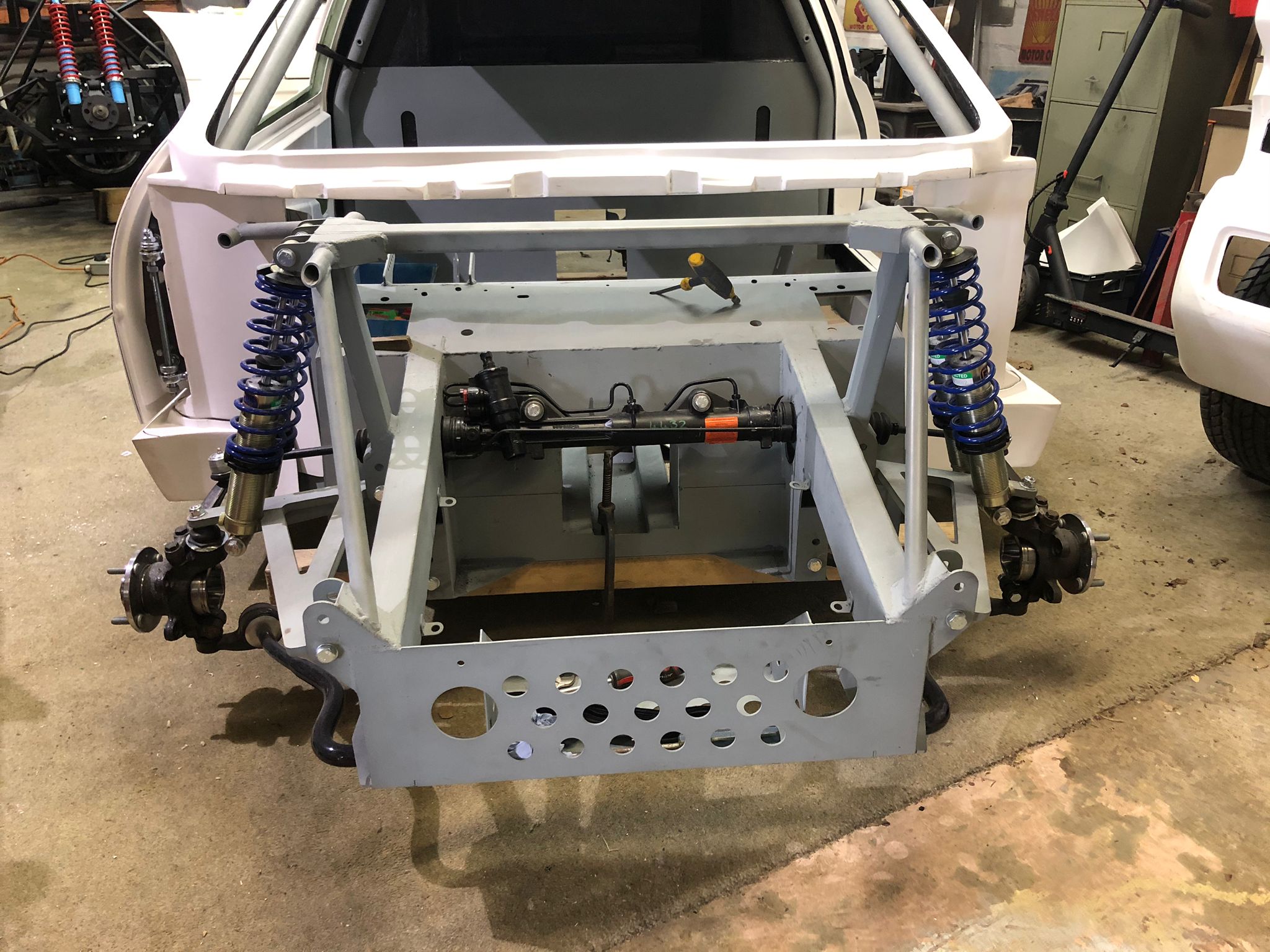

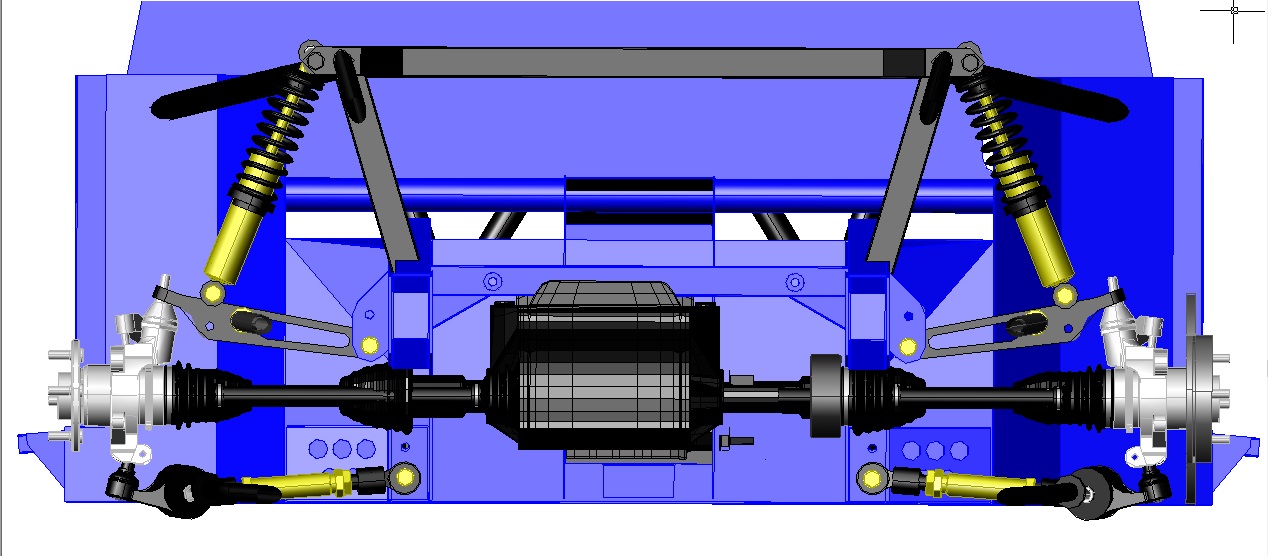

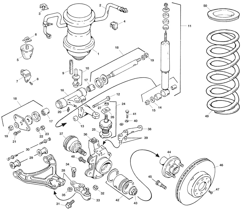

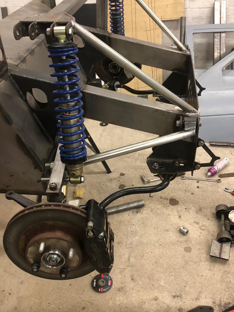

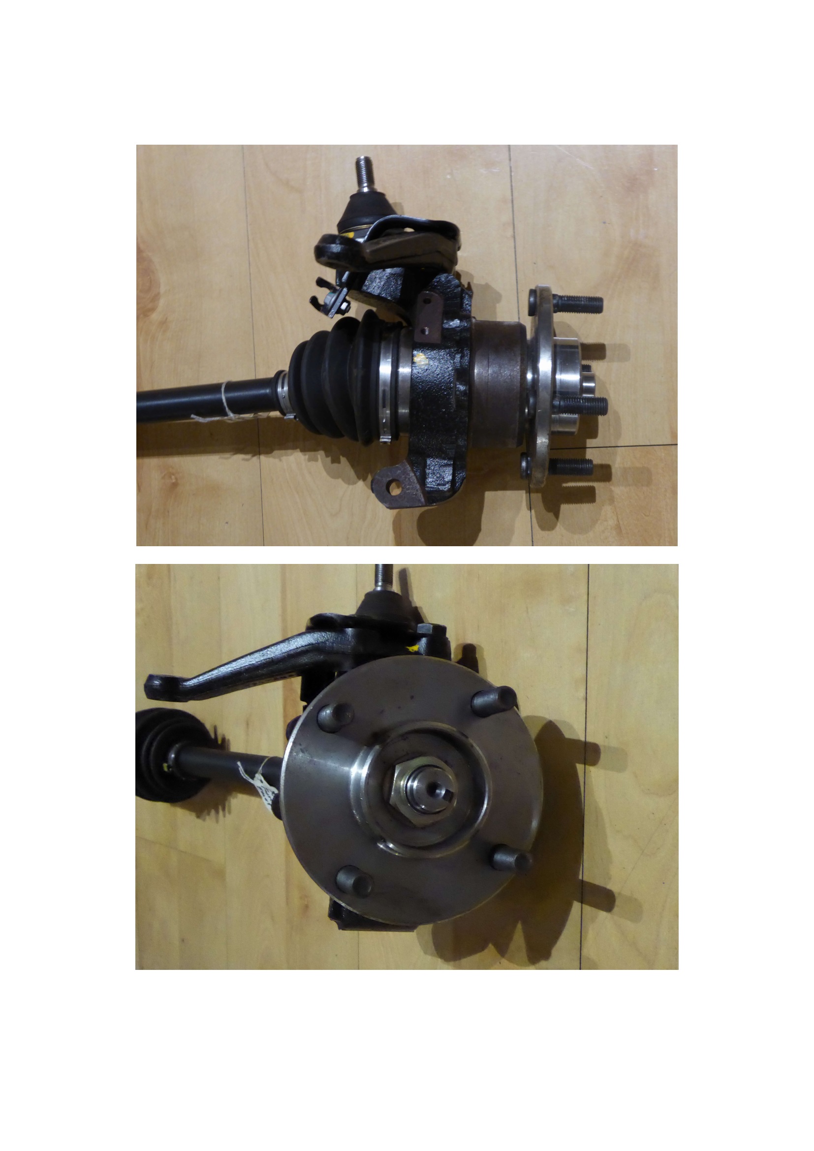

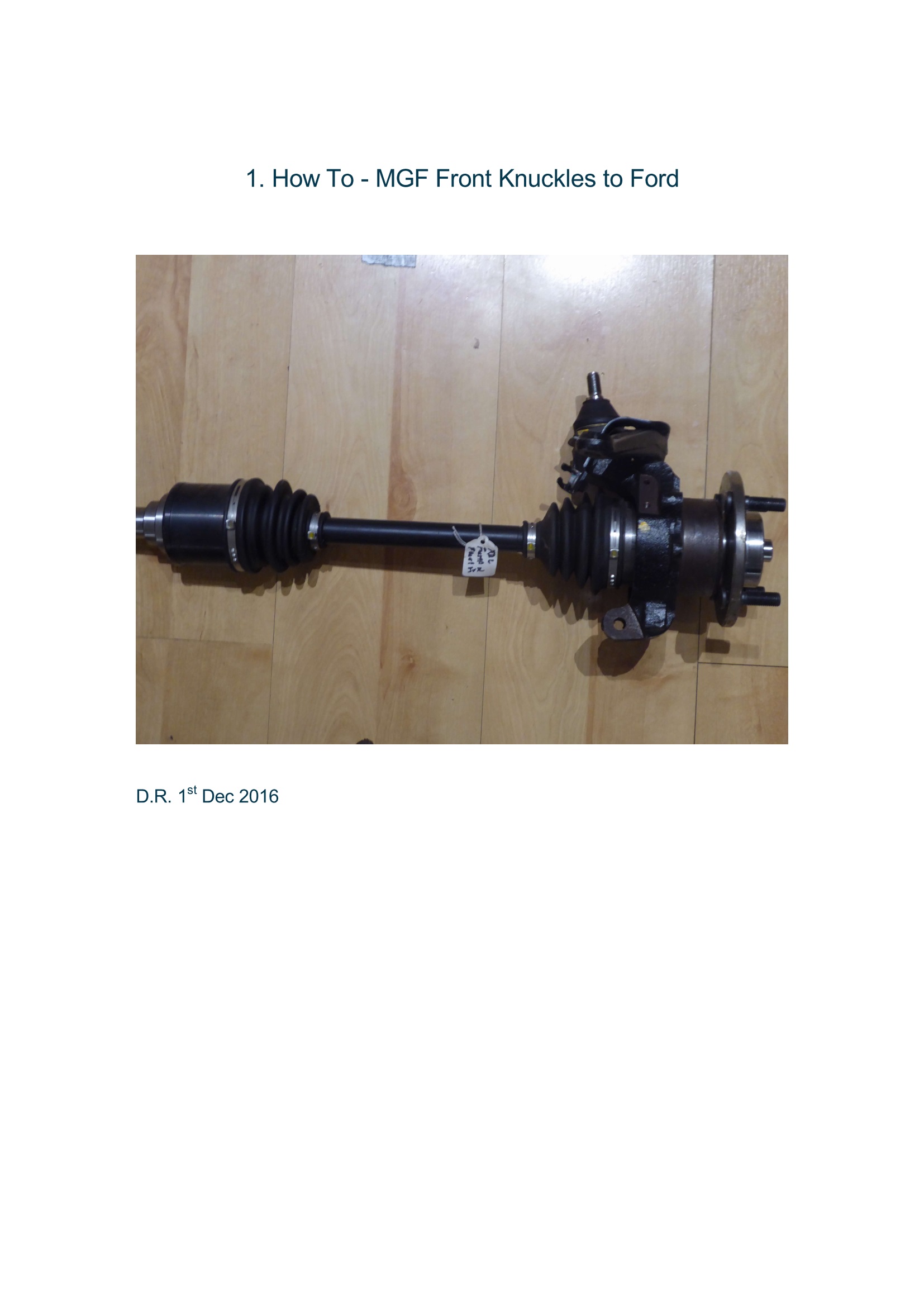

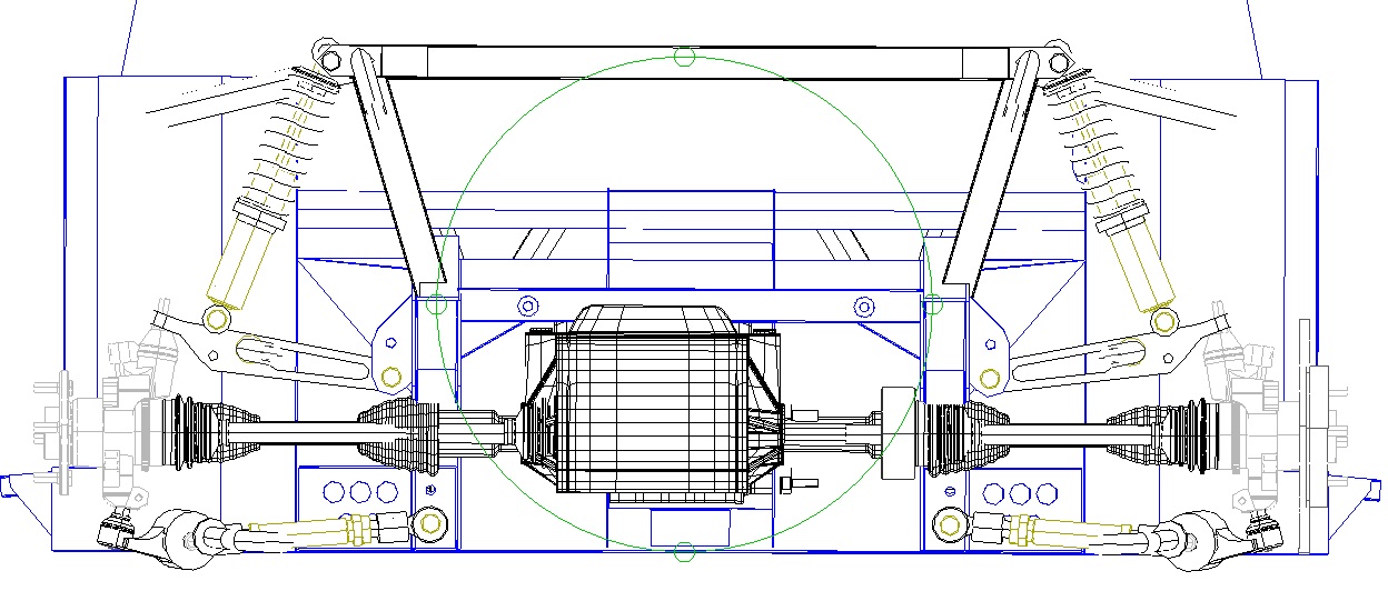

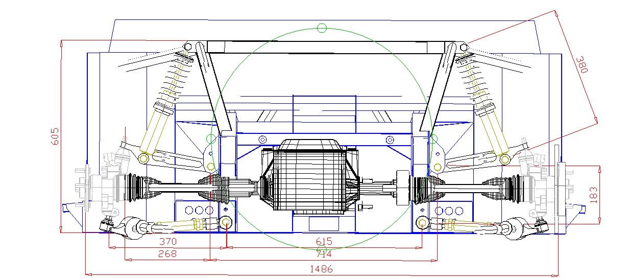

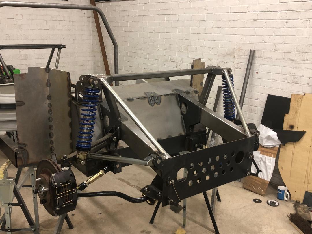

Nice looking car, reminds me of a TR7, but way better. Is it a production or a kit car?

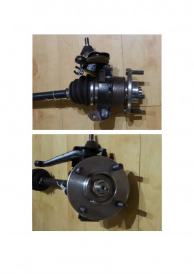

I use MGTF hub carriers (classic mini) on the front on the RS200 with fabricated longer wishbones.
You can use the whole subframe from a MGF or MGTF, every thing is there for you in one lump.
I replace the hubs with Ford Fiesta 4x108 and use Audi bearings, and Wilwood 4 pot callipers.
I can share the CAD files if they are useful to you?
There are lots of photos here, scroll to the bottom of the page.
https://rsretro.smugmug.com/Chassis-Bod ... m/Chassis/

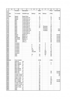

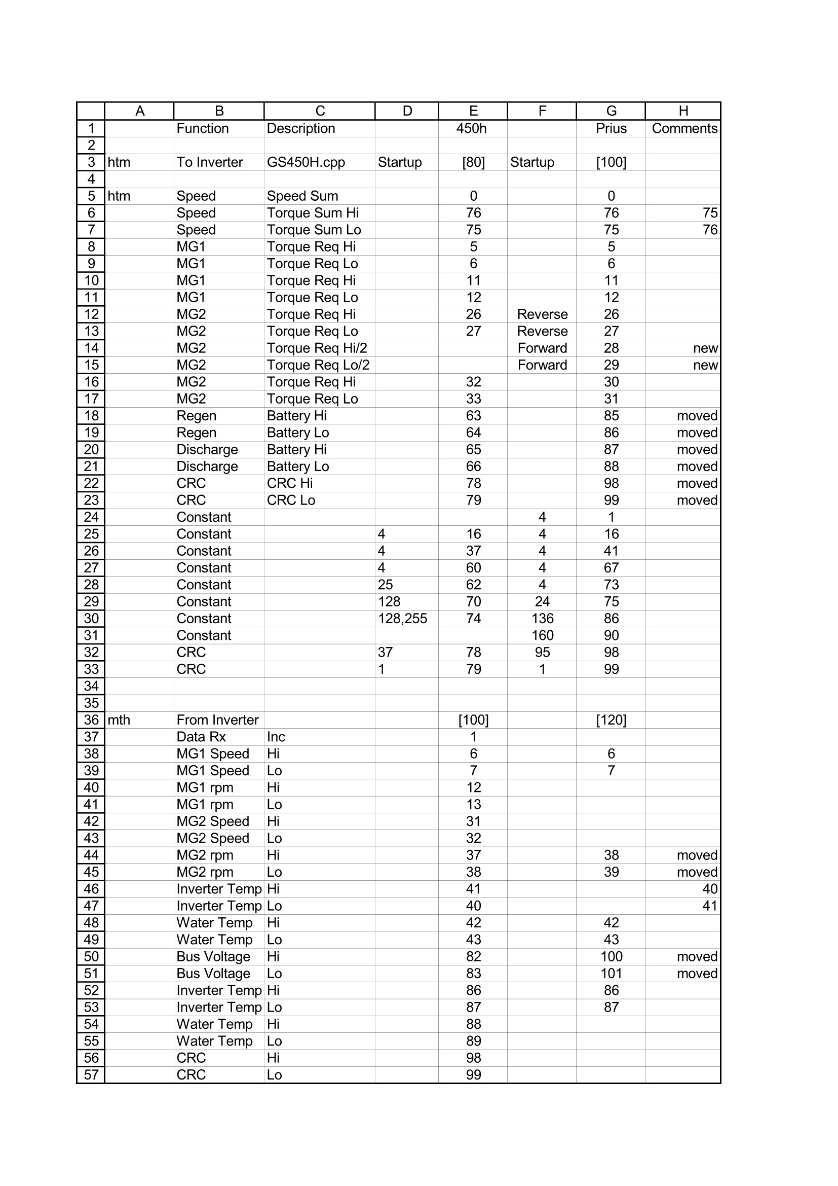

I have been hacking into the Zombie Inverter for the Prius code, to move it into the GS450h_vcu.
I have documented the code and built a small spread sheet with the relevant byte transfers and where they are different between Lexus and Toyota.
The Prius Inverters are way cheaper than the Lexus, be great to get this working.
Here is the spreadsheet and code below that.
I am still checking through this stuff and I haven't tested it, yet.
	Function			Description		450h 		Prius		Comments
htm	To Inverter		GS450H.cpp		[80]			[100]
htm	Speed			Speed Sum		0			0
	Speed			Torque Sum Hi		76			76		75
	Speed			Torque Sum Lo		75			75		76
	MG1			Torque Req Hi		5			5
	MG1			Torque Req Lo		6			6
	MG1			Torque Req Hi		11			11
	MG1			Torque Req Lo		12			12
	MG2			Torque Req Hi		26		Reverse	26
	MG2			Torque Req Lo		27		Reverse	27
	MG2			Torque Req Hi/2 			Forward	28	new
	MG2			Torque Req Lo/2 			Forward	29	new
	MG2			Torque Req Hi		32			30
	MG2			Torque Req Lo		33			31
	Regen			Battery Hi		63			85	moved
	Regen			Battery Lo		64			86	moved
	Discharge		Battery Hi		65			87	moved
	Discharge		Battery Lo		66			88	moved
	CRC			CRC Hi			78			98	moved
	CRC			CRC Lo			79			99	moved
	Constant					4			1
	Constant					4	16	4	16
	Constant					4	37	4	41
	Constant					4	60	4	67
	Constant					25	62	4	73
	Constant					128	70	24	75
	Constant				128,255	74		136	86
	Constant							160	90
	CRC						37	78	95	98
	CRC						1	79	1	99
mth	From Inverter			[100]		[120]
	Data Rx	Inc			1
	MG1 Speed	Hi		6			6
	MG1 Speed	Lo		7			7
	MG1 rpm		Hi		12
	MG1 rpm		Lo		13
	MG2 Speed	Hi		31
	MG2 Speed	Lo		32
	MG2 rpm		Hi		37			38	moved
	MG2 rpm		Lo		38			39	moved
	Inverter Temp	Hi		41			40
	Inverter Temp	Lo		40			41
	Water Temp	Hi		42			42
	Water Temp	Lo		43			43
	Bus Voltage	Hi		82			100	moved
	Bus Voltage	Lo		83			101	moved
	Inverter Temp	Hi		86			86
	Inverter Temp	Lo		87			87
	Water Temp	Hi		88
	Water Temp	Lo		89
	CRC		Hi		78			98
	CRC		Lo		79			99

            dc_bus_voltage=(((mth_data[82]|mth_data[83]<<8)-5)/2);
            temp_inv_water=(mth_data[42]|mth_data[43]<<8);
            temp_inv_inductor=(mth_data[86]|mth_data[87]<<8);
            mg1_speed=mth_data[6]|mth_data[7]<<8;
            mg2_speed=mth_data[31]|mth_data[32]<<8;

        if(gear==0) mg2_torque=0;//Neutral
        if(gear==32) mg2_torque=this->scaledTorqueTarget;//Drive
        if(gear==-32) mg2_torque=this->scaledTorqueTarget*-1;//Reverse
	// MG1 torque cheat
        mg1_torque=((mg2_torque*5)/4);
 	//no mg1 torque in reverse.
        if(gear==-32) mg1_torque=0;
	//post processed final torue value sent to inv to web interface
        Param::SetInt(Param::torque,mg2_torque);
        //speed feedback
        speedSum=mg2_speed+mg1_speed;
        speedSum/=113;
        uint8_t speedSum2=speedSum;
        htm_data[0]=speedSum2;
        htm_data[75]=(mg1_torque*4) & 0xFF;
        htm_data[76]=((mg1_torque*4)>>8) & 0xFF;
	// MG1 torque calc cheat
        if(gear==-32) mg1_torque=0; //no mg1 torque in reverse.
        Param::SetInt(Param::torque,mg2_torque);//post processed final torue value sent to inv to web interface
        //speed feedback
        speedSum/=113;
        //Possibly not needed
        //uint8_t speedSum2=speedSum;
	//htm_data[0]=speedSum2;
	//these bytes are used, and seem to be MG1 for startup, but can't work out the relatino to the
	//bytes earlier in the stream, possibly the byte order has been flipped on these 2 bytes
	//could be a software bug ?
        htm_data[76]=(mg1_torque*4) & 0xFF;
        htm_data[75]=((mg1_torque*4)>>8) & 0xFF;
        //MG1
        htm_data[5]=(mg1_torque)&0xFF;  //negative is forward
        htm_data[6]=((mg1_torque)>>8);
        htm_data[11]=htm_data[5];
        htm_data[12]=htm_data[6];
        //MG2 the MG2 values are now beside each other!
	htm_data[30]=(mg2_torque) & 0xFF; //positive is forward
	htm_data[31]=((mg2_torque)>>8) & 0xFF;
	// Drive
	if(gear==32)
		//forward direction these bytes should match
		htm_data[26]=htm_data[30];
		htm_data[27]=htm_data[31];
		htm_data[28]=(mg2_torque/2) & 0xFF; //positive is forward
		htm_data[29]=((mg2_torque/2)>>8) & 0xFF;
	// Reverse
	if(gear==-32)
		//reverse direction these bytes should match
		htm_data[28]=htm_data[30];
		htm_data[29]=htm_data[31];
		htm_data[26]=(mg2_torque/2) & 0xFF; //positive is forward
		htm_data[27]=((mg2_torque/2)>>8) & 0xFF;
	//This data has moved!
	// regen ability of battery
        htm_data[85]=(-5000)&0xFF;
        htm_data[86]=((-5000)>>8);
	// discharge ability of battery
        htm_data[87]=(-10000)&0xFF;
        htm_data[88]=((-10000)>>8);
        //checksum
        if(++frame_count & 0x01)
        	htm_data[94]++;
	// Temp save Checksum
	CalcHTMChecksum(100);
	// Goto begining
        htm_state=5;
    break;

Well I feel a little silly. I've been trying to decode this as a SPI port. But it isn't one at all. "Synchronous Serial" so it has a Clock sent with it to get the bit rate, however the bytes are still encoded like asynchronous data - with a start and stop bit?! I hadn't seen that before.
First time using this logic analyser software. Here you can see the serial streams decoded as a normal asynchronous stream. I think it can quite happily be "sniffed" with a bulk standard serial port, set at 500kbps.
Which, again I am doubting myself, because the GS450H stuff is at 250kbps - is the Prius faster, or is 250kbps good enough?
Woodfie and I had decoded MTH data using the GS450H code modified to accept the 20 more bytes. I thought I was confident that the data had changed position. Here is what we came up with:

The GS450h htm is 80 bytes but the Prius Gen 3 htm is 100 bytes. ? ! - (mth GS=100, mth Prius=120).
This should align the GS450h 80 bytes with the Prius Gen 3 Inverter, or are u=you using Gen 4? (mth 120 bytes)
	Constant					4			1
	Constant					4	16	4	16
	Constant					4	37	4	41
	Constant					4	60	4	67
	Constant					25	62	4	73
	Constant							160	90
	CRC						37	78	95	98
	CRC						1	79	1	99
	Data Rx	Inc			1
	MG1 Speed	Hi		6			6
	MG1 Speed	Lo		7			7
	MG1 rpm		Hi		12
	MG1 rpm		Lo		13
	MG2 Speed	Hi		31
	MG2 Speed	Lo		32
	Water Temp	Hi		42			42
	Water Temp	Lo		43			43
	Water Temp	Hi		88
	Water Temp	Lo		89
	CRC		Hi		78			98
	CRC		Lo		79			99
In Damien's code its 250000.
Could your 500000 be rising and falling edges therefore x2?
A Serial port, I use FDTI, has the speed. Maybe you should connect the CTS, RTS, DTR, to the clock and sync for your data capture, to synchronise the start and stop of each packet..

Woodfie wrote: Thu Mar 10, 2022 10:11 am Will get driveline pictures in daylight.
Three Siris Roadsters were made, and four predecessors called Aurora Coupes. Not quite production, intention was to make available as a kit, or component car.
Woodfie
Posts: 242
Location: Auckland NZ
Has thanked: 221 times
Been thanked: 96 times
Post by Woodfie »
Sorry picture inverter, corrected , lost it all, adjusted alignment, and still have it downside up.☹

Its a cool looking car, I bet it goes like stink.
Thanks for sharing. What wheel pcd are you running?
And do you have any pics of the front suspension, I might be able to help a bit there?

daleread wrote: Fri Mar 11, 2022 7:47 am In Damien's code its 250000.
The GS450h_vcu code has
Serial1.begin(250000);
I'm just saying what this logic analyser told me.
The tests with Woodfie we changed the numbers to 100 and 120, and moved the checksum to 118,119 (counting from 0).
Oh by the way - you've labelled it CRC, but what I am seeing is definitely a checksum, not CRC

Woodfie

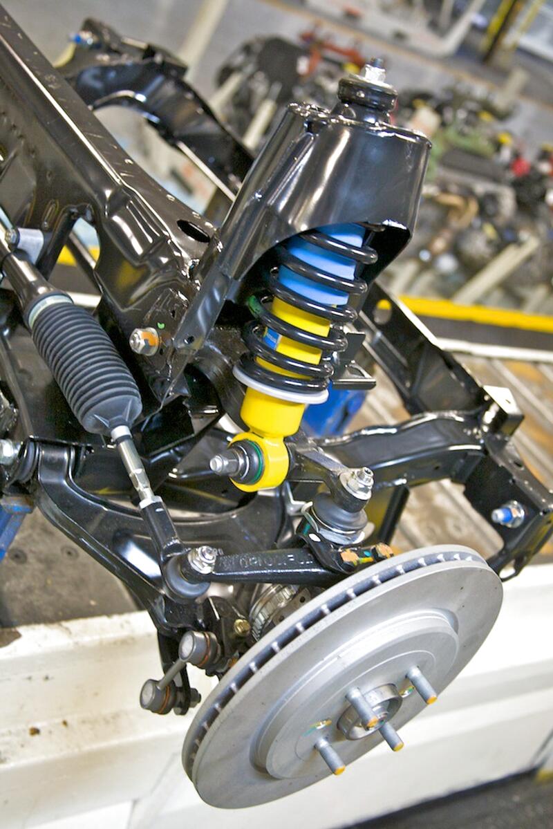

Front Suspension photos from MGF and used in RS200 to get front drive.
You could keep your suspension arms, take out the shock/spring and build a small tower, then put the shock/spring on top of the top arm.
Then change the stub axle for the MGF one.
It will also fix your steering.
daleread

Front (Nissan Leaf Motor) setup with MGF hubs, driveshafts, steering
I will be building this over the next few weeks with a Q211, I have the chassis ready, will keep you posted

Daleread
Thanks for the very informative info.
On the last drawing front on, what is the diameter of the green circle? as it closely indicates the height of lower inner suspension bushes to the top of the bonnet,
Thanks W
daleread
Posts: 49
Location: UK
Post by daleread »
Here are the dimensions of the RS200 for you
The the 605mm can be reduced to fit under your bonnet line, but the RS200 is similar to your car for the bonnet line.
The cross bar locks it al together.
The steering rack is moved to the back to give clearance for the MGR motor unit.
Woodfie
Posts: 242
Post by Woodfie »
Thanks for that, did a quick check to the outside top of my bonnet line, and is 550mm, presently have an inner panel, with moulded in spare tyre space, which would have to be dispensed with.....the 645mm would have to come down to around 500mm if the inner panel remained, could be a bit short for the coil over shock.
Looking favourable to have double springs to the lower arm, then would have to use hub assembly with lower ball joint designated to take load as cortina does.
