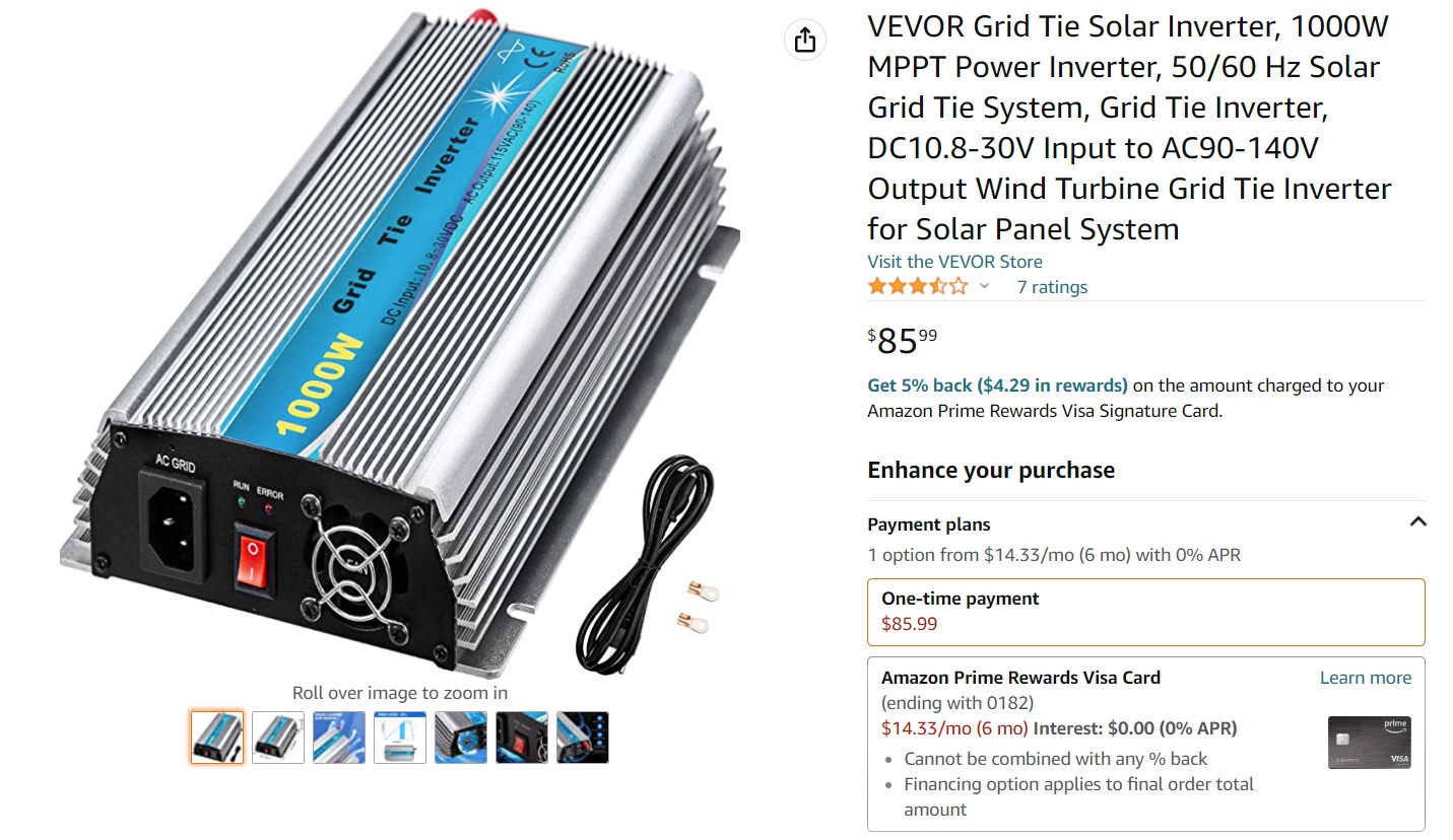

oh wow the same Inverter that I bought for $104 bucks is not on sale on AMAZON for only $85, there are three left, no I am not the seller and no I am not affiliated with them in any way, just sharing what I just saw, since they were SOLD OUT, back ordered for quite some time, this would be a great time to pick one up to play with
VEVOR Grid Tie Solar Inverter, 1000W MPPT Power Inverter, 50/60 Hz Solar Grid Tie System, Grid Tie Inverter, DC10.8-30V Input to AC90-140V Output Wind Turbine Grid Tie Inverter for Solar Panel System

It does not appear to be UL certified, and their CE ("China Export") marking means nothing, so this box cannot be tied to the US electrical grid afaik.

It's amazing how undisturbed these devices can be distributed however. It's fairly obvious that they will be connected to the grid while not implementing any country specific frequency and voltage derates. Let alone bothering with certification. Not too worried anyhow, most of all they reliably shut down when disconnected from grid voltage.

Penal Code 591 PC is the California statute that makes it a crime for a person to maliciously disconnect, remove, injure, or obstruct any telephone, cable, or electrical line. A violation of this law can lead to misdemeanor or felony charges, and is punishable by up to 3 years in jail.
The full text of the statute reads as follows:
591. A person who unlawfully and maliciously takes down, removes, injures, disconnects, cuts, or obstructs a line of telegraph, telephone, or cable television, or any line used to conduct electricity, or any part thereof, or appurtenances or apparatus connected therewith, including, but not limited to, a backup deep cycle battery or other power supply, or severs any wire thereof, or makes an unauthorized connection with any line, other than a telegraph, telephone, or cable television line, used to conduct electricity, or any part thereof, or appurtenances or apparatus connected therewith, is subject to punishment by imprisonment in a county jail not exceeding one year, by a fine not exceeding one thousand dollars ($1,000), or by both that imprisonment and fine, or by imprisonment in a county jail for 16 months, two or three years pursuant to subdivision (h) of Section 1170 and a fine of up to ten thousand dollars ($10,000).
That $85 "grid tie" inverter can get expensive in a hurry. Amazon is a mere down payment 😂

Come on, that's FUD
Never heard of anyone getting in trouble and there must be millions floating around
