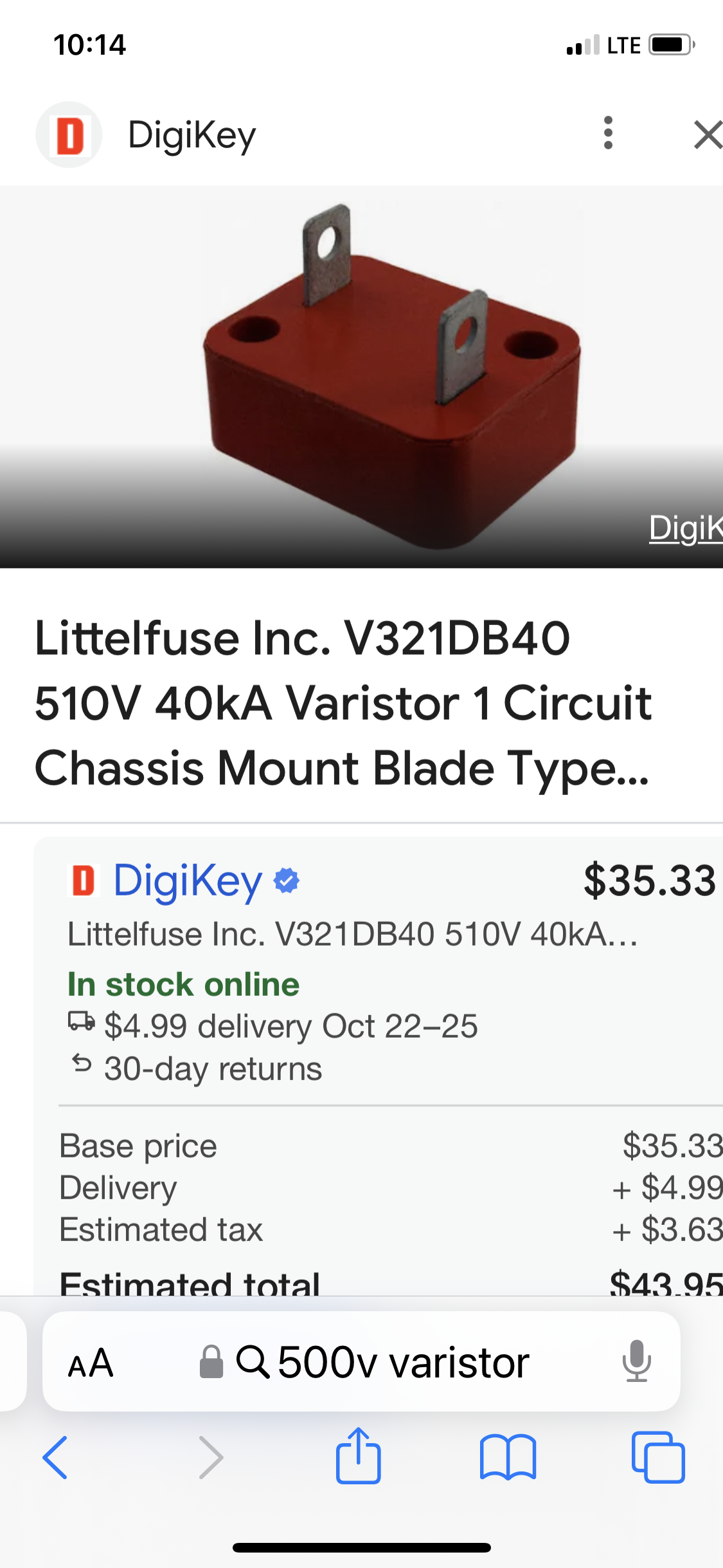

Would something like this (attached)work along with tripmode 1 wired at the HV inverter cables? Could just replace in case of failure? Only $35

I don't know the overvoltage time. I believe this will be inconsistent and will depend on RPM, magnetization of the rotor, etc.phillipschip wrote: ↑Sat Oct 19, 2024 5:26 pm Would something like this (attached)work..
...Or...
https://www.newark.com/littelfuse/v511d ... dp/74R2850
That very likely won't be anywhere near enough except at very low rpms. A MOV can handle huge currents for very short timeframes (too short for this) which makes the ratings look feasible. A combo mov / gas discharge tube with a slightly higher voltage rating on the mov could work if sized appropriately.
Adding a beefy resistor in line could help the overvoltage devices survive long enough to help. Just realize the voltage across the resistor will likely raise the clamping voltage, possibly by a lot.
I have mentioned turning on the cabin heater in other posts asking how to deal with this energy. It should be at least a few kw worth of load dump but needs to be fast enough to actually help.
You have to match the regen energy over time to the overvoltage devices ability to absorb it over time. It's tricky.

How would you wire the Varistor/gas discharge tube-parallel with Mov? Something like a 500v Mov and 600v tube? Also, it looks like you can get Mov’s with higher clamping rates-1.3kv etc. for not too much more. Would this help any or is the surge so high this value doesn’t matter too much?

600 amps x 600 volts = 360,000 watts. But I'm not sure what current the motor would output, for how long, and what your clamping voltage would be.
This has a sample schematic at the bottom. https://www.bourns.com/docs/technical-d ... t_form.pdf
Tvs diodes are fast but weak and blow shorted. The T is for transient.
Mov are medium fast and medium strength. They can withstand a lightning strike in power lines. That's very fast though.
Gas discharge tubes are slow but fairly strong.
The idea of setting different voltages for the 3 types is the slower devices have a lower clamping voltage and take over doing the work from the faster & weaker ones when they start conducting.
TVS / MOV / GDT are all rated for fairly short duration. It will be challenging finding longer duration testing info to use them for this. It's not an easy or cheap thing to test.
There's also the direction of how much of a power dump would it need to keep the voltage below safe fet values. The heater being on may be completely insignificant thinking it through.

Having these two devices wired with a good estimated guess-would there be any downside besides the potential waste of money? If one were to do that, what ratings would you recommend? Also, would a snubber work-capacitor resistor at the motor?

If youv undersize them they will likely fail spectacularly along with the typical overvoltage failure in the inverter. There's also the schrapnel potential landing in high voltage causing further failures.phillipschip wrote: ↑Sun Oct 20, 2024 4:41 pm Having these two devices wired with a good estimated guess-would there be any downside besides the potential waste of money?
Adding components like this isn't worth taking a guess at. Adding them means adding high voltage wiring which has some risk to it & could have it's own failures.If one were to do that, what ratings would you recommend? Also, would a snubber work-capacitor resistor at the motor?
The only way I can think of testing this is with some controlled loads on a generator / dyno that you can spin up to higher and higher rpms and test. Not exactly diy.
Might be able to carefully do this opening the contactors at really low rpm, recording results, and working your way up. You might be able to plot the energy out below the threshold voltage and extrapolate some expected power and voltage levels from that. Testing at say 200v and adding lower voltage rated overvoltage protection might help work through the problem within the voltage range of the system.
Just realize this very likely will end up a huge amount of power, misses the vehicle coasting part of the equation, and will blow the drive if the overvoltage protections you're testing fail.
Note in the datasheets, these survive a few large events. It's a huge amount of energy to deal with, repeated hits damage them over time. Something to note if doing ramp up testing.
Short answer is lots of possibly expensive / time consuming testing is required to know for sure the size of the overvoltage protection required. I don't know how to calculate it, too many unknowns (at least for me..)
It's worth making sure the contactors stay closed and only open in an emergency. Extra time here is likely better time spent.
