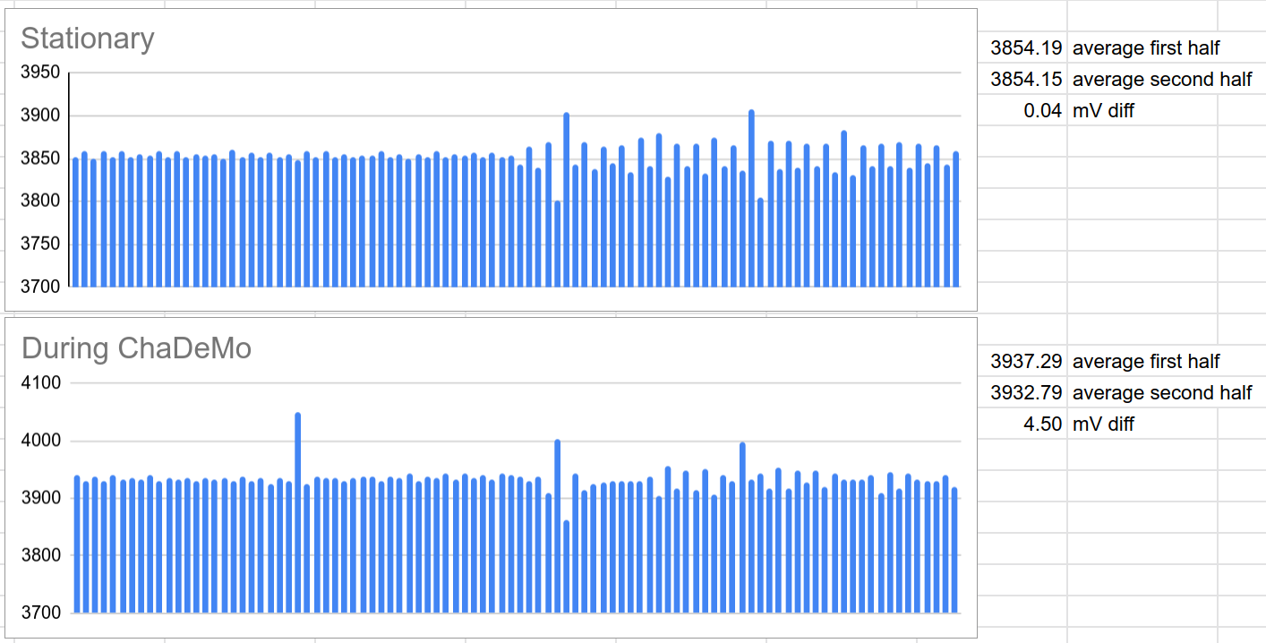

Pete9008 wrote: Tue Nov 29, 2022 6:26 pm Any more details on this?
Hadn't actually plotted this before now, but I think Johannes is referring to the read cell voltages by the BMS, one half is more jittery than the other in a pack that we manually measured to be perfectly balanced at the time:
  • Presumably the jittery half is the front/are the further away cells.
  • It's not always the same cells that read high/low
  • both halves average out at almost exactly the same voltage
johu wrote: Tue Nov 29, 2022 6:06 pm A man from Germany who converted his Volvo had to split his pack in 3. 1/2 in the boot like yours with the stock tap harness, 1/4 fuel tank volume, 1/4 engine compartment. Obviously for the latter two he needed to extend tap wires also. The problem does not exist for him.
This is good knowledge and reassuring! I was worried I was the only person in the world with that setup/problem now.
johu wrote: Tue Nov 29, 2022 6:06 pm "old" sense chips, may be more robust?
I can quite easily test that by putting the 24kWh BMS in for a short test drive and see if that drops out when system under load.
Edit: Anyway, the cell balancing is a bit of a tangent. I will work through your comments and run experiments for the interference problem.

Yes very typical sign that not the cell but the measurement is the issue: for adjacent cells one reads low the other one high by the same amount.
What's that "finger" in the first half during charging? Loose interconnect or high internal resistance of one cell? (Probably not)
EDIT: worth noting that the 40 kWh BMS not only has different sense chips but also smaller value balancing resistors. I think 40mA balancing current as opposed to 15 mA on the old ones, if I remember correctly. If you open up the interlock loop it will stop "balancing" - I think balancing is counterproductive with that sort of sense error and actually triggers the sense error because loading down the tap wire

That plot looks like a good way of measuring whether changes are having a positive effect - make a change, rerun the plot and if the jitter is less the change has helped.
Assume stationary plot is with the inverter running but with the car stationary? If the inverter is off does the jitter disappear completely?

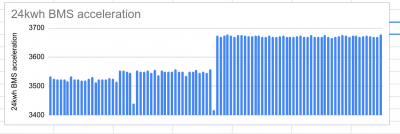

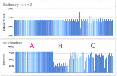

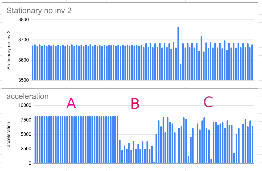

See the plot with the inverter working hard, note the range as well:
  • MAXINT 8191mV in a whole block (A)
  • then vaguely reasonable readings for a bit (B) *
  • then from 200mV to 7000mV (C)
I wouldn't read too much into where the erratic measurements are at this stage, as the BMS is getting values that are so far out of bounds that it doesn't know what to do at all anymore.
Thats the main problem I am trying to solve, the 50mV jitter I can live with for the winter/until I have time for master/slave setup.
One hint: plugging and unplugging the BMS seemed to make a difference when Johannes and I were driving together, I have since made it worse again, just a little of acceleration will freak it out :)
* Edit: actually it goes down to 2500mV, so they are toast too
* Edit Edit:

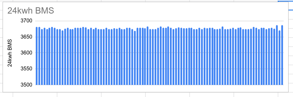

Look at that, 24kWh BMS doesn't mind at all and has less jitter at standstill, both sides look the same! This might be good news for science, bad news for my project: "yes you can extend wires on 24kWh/30kWh pack, no you cannot do it on 40kWh pack". Driving around the block now.
Edit Edit Edit:

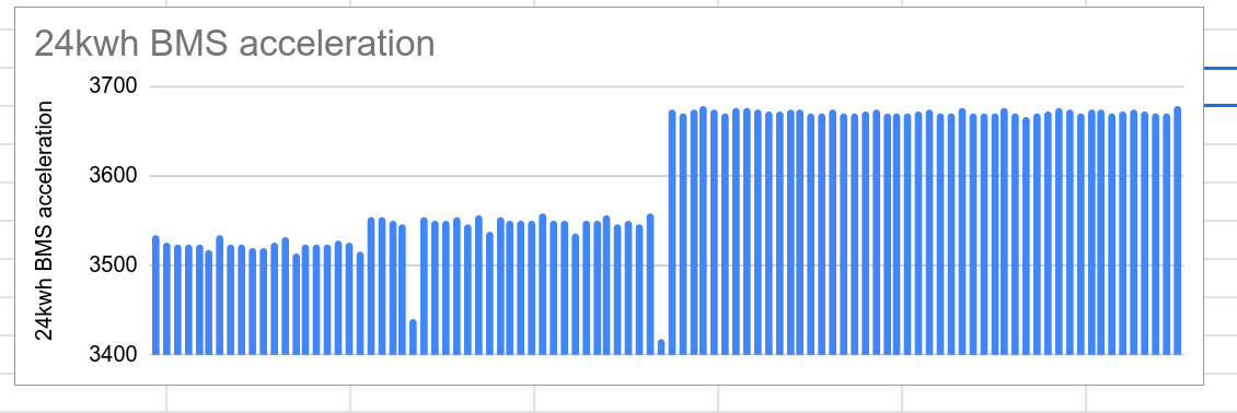

Look at that, under acceleration with 24kWh BMS one half sags as expected, but I get decent readings for the other half.
If I am disabling balancing anyway, maybe I use the 24kWh BMS, and with reliable current, temperature and most cell voltages I calculate my allowed dislim and chglim myself in the VCU... getting into BMS development there but could be a band-aid till I get to re-design the system and re-wire.
unless one half of the pack sags a lot harder than the other because of too thin HV bus? Pete? 35mm2 currently in the vehicle.
Strikes me as unlikely.
Pete9008
Posts: 1801
Has thanked: 102 times
Been thanked: 351 times
Re: Interference: How to measure and fix it?
Post by Pete9008 »
That looks a lot better :)
Like the idea about using the 24kWh BMS and doing the SOC calcs yourself.
Think its probably the comms between the individual bms ICs that is the problem, the 24kw and 40kw use very different systems. In particular the 24kw uses opto isolation across the disconnect (rather than the capacitive coupling on the 40kw) and that would make it a lot less sensitive to voltage differences between the two packs.
Edit - there is another thread asking about cable voltage drops which has got me thinking about it. Was going to do a few summs and will post the results later. I doubt it's causing the sag here though. How long are the cables?
Edit2 - do you know which pack is which on both the 24 and 40kw bmss?

Just noticed that on 24kWh the lefthand side of the chart sags, whereas in 40kWh system the righthand side was jittery.
Maybe the old BMS reports the cells in reverse order in the CAN messages or this is a hint for something else ...
Been thanked: 1918 times
Almost looks like the right half isn't updating at all. Unlikely there to be 0 sag under acceleration. I remember this from my home made BMS. It had sanity checks (CRC) and would just stop updating when those failed. Usually happened under acceleration also.
Anyway, still an improvement.
Yes you could come up with your own charge curve, depending on cell voltage and temperature. Or Damien style, charge with full power until you hit 390V :D
EDIT: sag is always equal on all parts because the current is the same, says Kirchoff
