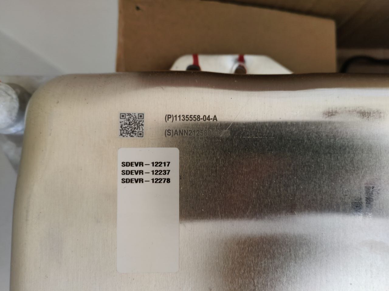

caymanS wrote: Wed Mar 29, 2023 6:48 pm Has anyone tested Damien's PCS controller with a model-Y PCS? I have a model-Y PCS and would like to know whether or not this controller can work with it before I make an order.
What's the part # on your PCS? I'll see if its the same as either of my model 3 PCSs (one functioning, one I broke).
To the best of my knowledge, the Y and 3 are essentially the same car with different sheet metal, up to a point where they started re-engineering the Y for the structural battery.

When working with Tesla parts, the CAN MsgIDs and payloads have changed at some firmware updates, which complicates answering the question, "will the same hardware from the same vehicle MY still work with Damien's codebase". I believe he's already worked around one or two FW revisions in his sofware, but there may be more variants extant.

P.S.Mangelsdorf wrote: Sat Apr 01, 2023 9:50 pm What's the part # on your PCS? I'll see if its the same as either of my model 3 PCSs (one functioning, one I broke).
Here's a photo of serial/part number:
A quick note: I am now able to turn on DC-DC converter using Arduino Due code that Damien has provided. I am receiving error code 24-VCFront. I had many more errors in the beginning which I resolved except for this one. I could not find any DBC file that interprets PCS log message 0x424 to explain why VCFront is unhappy. Any lead would be appreciated.
