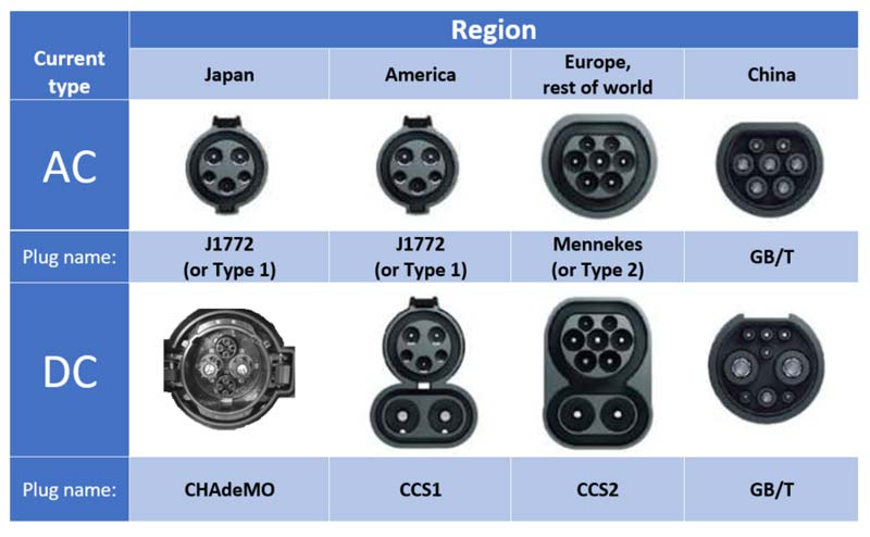

NOTE: Given you're in the US you cannot use the Tesla Model 3 European CCS connector ("CCS2") on your car because it's a different form factor to the US CCS connector ("CCS1") that you'll find as you're driving around :(

Kevin Sharpe wrote: Tue Jan 21, 2020 6:18 pm NOTE: Given you're in the US you cannot use the Tesla Model 3 European CCS connector ("CCS2") on your car because it's a different form factor to the US CCS connector ("CCS1") that you'll find as you're driving around :(
Would this potentially be (an expensive) option?
https://www.evseadapters.com/products/u ... r-adapter/

MuskTang wrote: Wed Jan 22, 2020 3:30 pm Would this potentially be (an expensive) option?
I don't think we want to put >50kW through an adaptor cable. If the car is in the US then fit a Type 1 CCS connector 8-)
