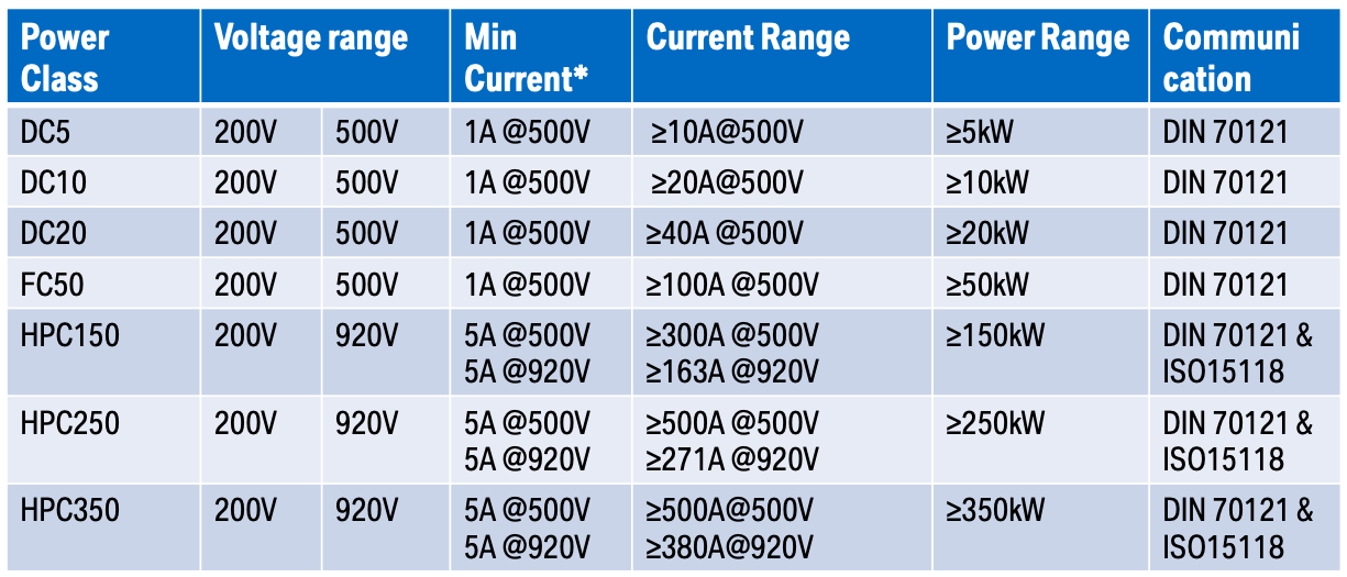

Posted: Thu Jan 09, 2020 11:12 pm
by Kevin Sharpe
Useful CharIN document detailing CCS power classes 8-)
DC-CCS-Power-Classes-v6.pdf
(595.54 KiB) Downloaded 462 times
