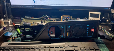

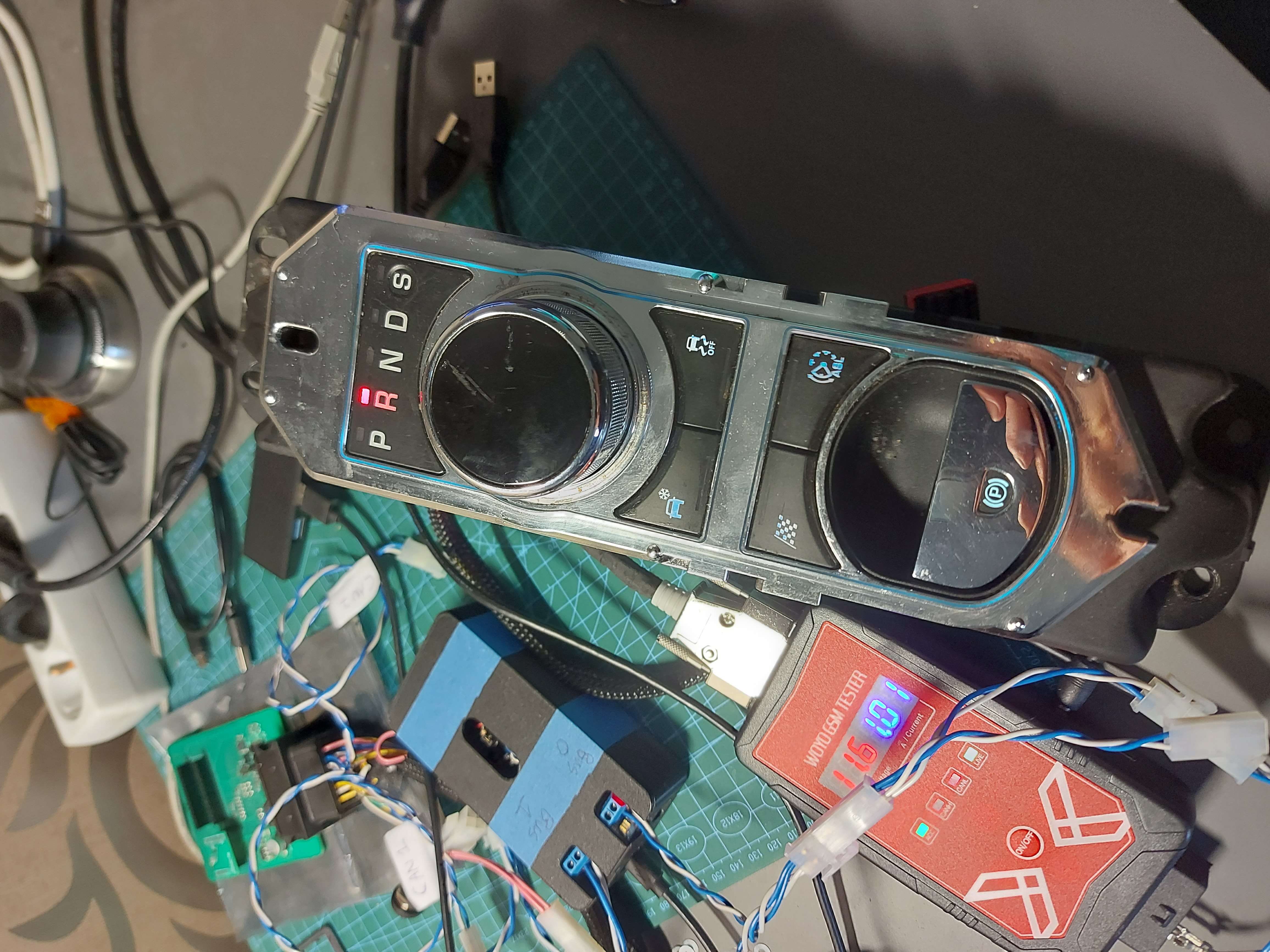

Hello friends. How long have I been looking for this topic in all the forums !!!! I'm trying to get it to work with a stepper motor for shifting gears in another car. I needed to find all the CAN bus codes and then I stumbled upon this forum. Happiness!!!
I found only 2 leds like in my picture

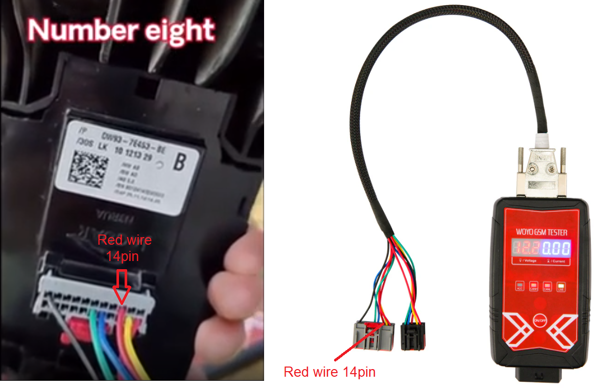

I also found voltage on the pins of the 22 way connector
GSMTSM - Pinout.pdf
(484.6 KiB) Downloaded 927 times

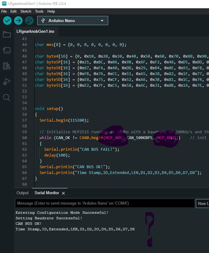

I found mcp_can.h library on git. Applied nkiernan's advice uploaded to arduino. What should happen? Maybe I don't have a CAN bus connection? The port monitor should display information with the line 0x312 from selector?
Posts: 2962
Has thanked: 330 times
Been thanked: 848 times
Re: can id´s 4 Gear Selector

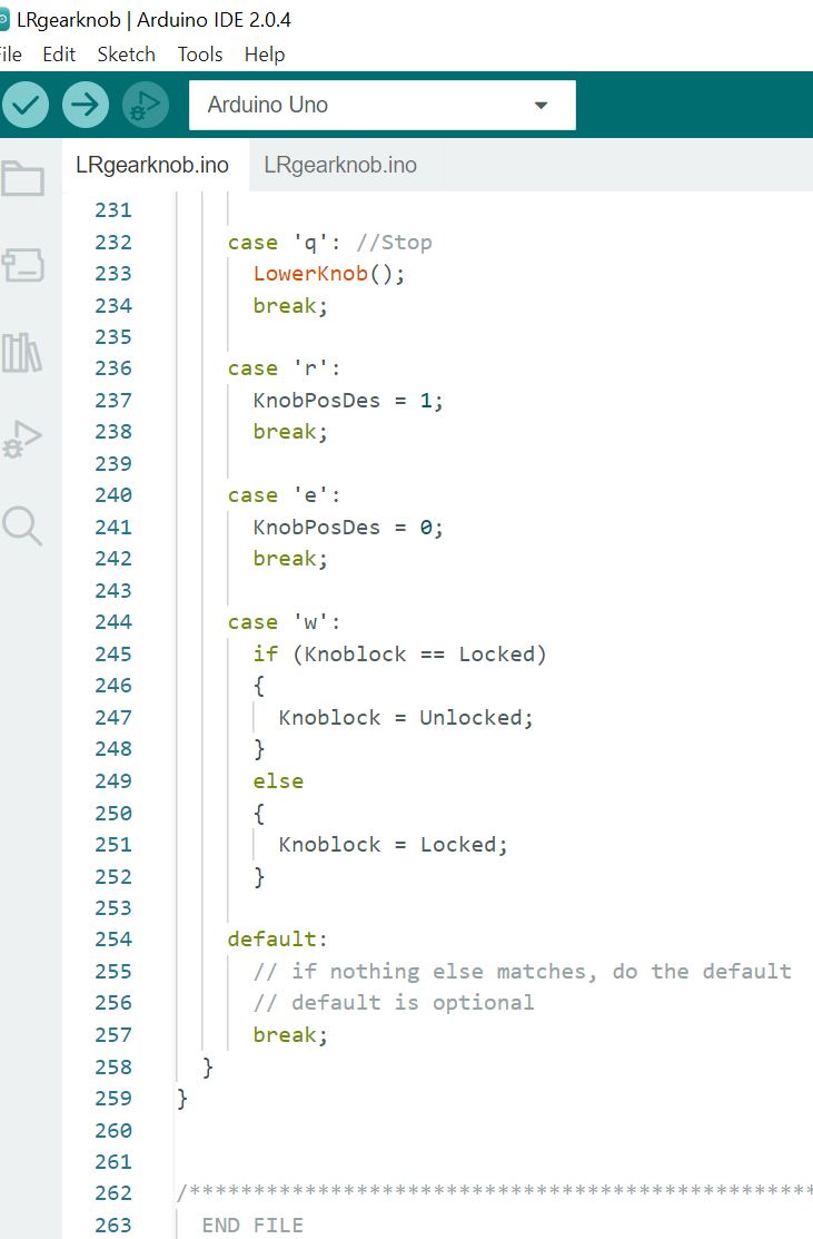

VanGogh wrote: Tue Apr 04, 2023 7:01 pm I found mcp_can.h library on git. Applied nkiernan's advice uploaded to arduino. What should happen? Maybe I don't have a CAN bus connection? The port monitor should display information with the line 0x312 from selector?
It does not print anything, as the Leds will feedback on the knob.
Send it the letter 'd' is you want to toggle canbus debugging.
VanGogh
Posts: 41
Joined: Mon Apr 03, 2023 7:33 pm
Post by VanGogh »
I don't understand. Maybe my GSM doesn't work with this code? Because on the video of the seller from Aliexpress there is no mine. Does anyone have a video review of working GSM with arduino? How to make the knob move? I haven't been able to move it for 2 weeks now((((
I Send it the letter 'd', but nothing. Then 's', then 'w' and nothing(((

VanGogh wrote: Tue Apr 04, 2023 8:08 pm I don't understand. Maybe my GSM doesn't work with this code? Because on the video of the seller from Aliexpress there is no mine. Does anyone have a video review of working GSM with arduino? How to make the knob move? I haven't been able to move it for 2 weeks now((((
Couple of suggestions. You have the CAN lines connected between the arduino CAN shield and the Jag unit and did you check the resistance between the lines ( approx 60R). Think I added a 120R resistor between the lines because my CAN shield didn't have the termination resistor.
You're applying 12V+ and GND to relevant pins and are you applying the 12V+ ignition signal also? When you open serial monitor in arduino and connected to the UNO, this is what would print when first powered up or reset (baud rate is set to 115200 yes?):
  • Entering Configuration Mode Successful!
    Setting Baudrate Successful!
    CAN BUS OK!
    Time Stamp,ID,Extended,LEN,D1,D2,D3,D4,D5,D6,D7,D8
Looking at the SerialComms function in the code, I don't think 'd' is specified as CAN debug? But 's' should raise knob and 'q' should lower it. I need to test but think when ignition is applied selector knob would raise (tbc).

Please show us your wiring setup, as wiring can be an issue.
Have you ever gotten canbus from it using anything else?

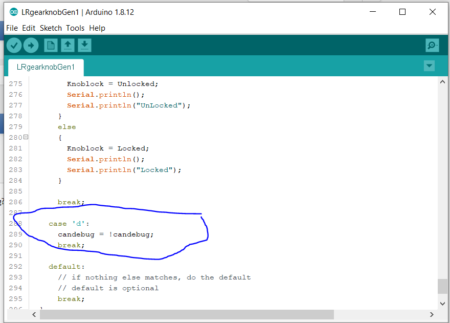

nkiernan wrote: Tue Apr 04, 2023 8:26 pm Looking at the SerialComms function in the code, I don't think 'd' is specified as CAN debug? But 's' should raise knob and 'q' should lower it. I need to test but think when ignition is applied selector knob would raise (tbc).
gen 1 ignition rasies knob.
d toggles debug for canbus

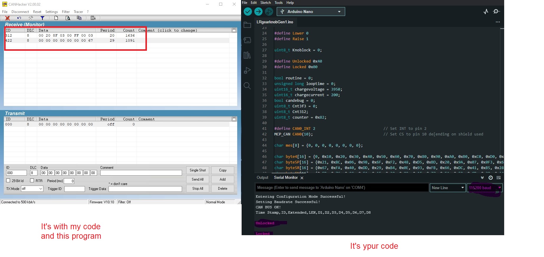

Thanks I tried.
I have another code for arduino and used canhacker 2.00.02 to find signals without 120 ohm resistor. But he could not find the signals to raise the knob. Found your code and can't get any results with it. There is no resistance between the CAN bus contacts. I added a 150 ohm resistor and no change (or do you need 120 ohms?). I sent a letter 'w' and the port monitor says "UnLocked" and "Locked" but I don't hear the solenoid valve inside.
When I send other characters nothing happens at all

tom91 wrote: Tue Apr 04, 2023 8:53 pm gen 1 ignition rasies knob.
Apologies Tom, was using your sketch from the first link (gen 2):
