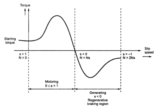

During acceleration, this problem is self-solving. If you take away voltage, the excess back EMF just gets used up by the motor, but during regen, if you take away voltage, the back EMF doesn't self-dissipate in the same way.
Unfortunately, this means that during "motoring" ie positive slip/torque, more voltage always means more current, and the PID loop works. But during regen, the relationship isn't linear. Too much voltage OR too little has the potential to cause excess current, so the algorithm can't reliably guess which direction of change is needed.

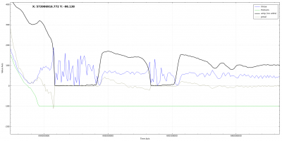

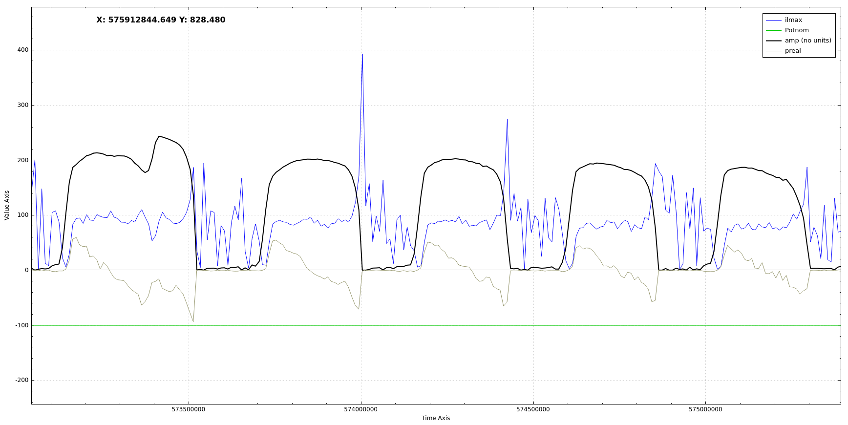

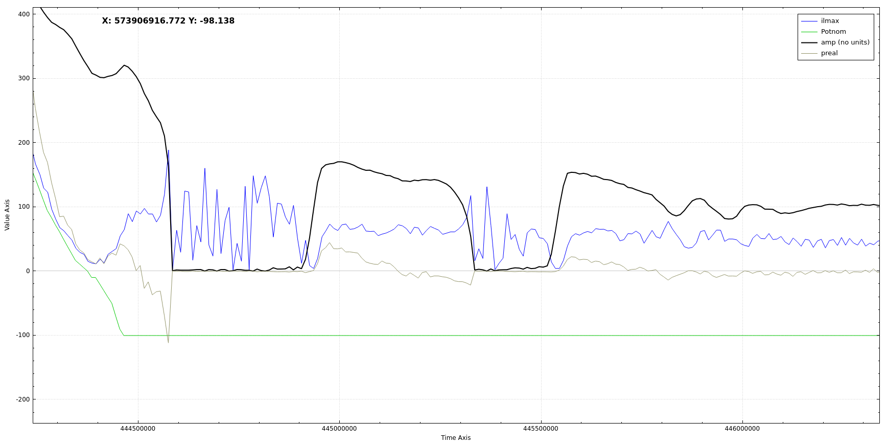

- catphish
- Posts: 966
- Location: Dorset, UK
- Has thanked: 99 times
- Been thanked: 197 times
Re: Current control of induction motors
I just went out and graphed real power. The results are (at least to me) very interesting, and it seems your suggestion is a good one! This graph shows the following pattern of oscillation:Pete9008 wrote: ↑Fri Jan 20, 2023 1:16 pm Sorry, real power was my suggestion, hadn't considered/understood all the implicationsStill think the sign change is the problem but wondering if there is a simple test that could be done to confirm it (basically just to test the theory) before spending time looking for a solution that will cover all cases?
* Voltage rises, there is some positive real power. I assume this is the rotor being magnetized.
* There is a brief period of stability, during which real current flips into reverse.
* Current rises and the PID reduces voltage
* Current rises rapidly
* The inverter reduces the voltage to zero and the rotor field collapses
As we hoped / expected, every time real power goes negative, the PID loses control of current (in fact it looks a lot like it's operating in reverse!)
In terms of theory, this now seems somewhat obvious. Thinking about one leg of the inverter, if current is in the opposite direction to voltage, then obviously increasing the voltage on that leg will oppose that current, and if current is in the same direction as voltage, then reducing the voltage will push less current. This seems stupidly obvious after almost 24 hours of trying to understand how electricity works.
At this point, I could convert real power to a current and feed it into my PID, however, for three reasons I'm inclined not to for now:
1) The current implementation is simple and it appears to work well in terms of regulating current.
2) Part of the goal of this implementation is to allow people to have control over how much current is actually flowing through their motor and inverter. By using real power, we'd be allowing unknown amounts of reactive power, which could easily cause damage or trip overcurrent limits.
3) I believe the user should be manually tuning their current vs slip ratio to optimize power factor. However, I also believe that this new calculation will allow logging real current and apparent current, allowing for much easier tuning (the user can now easily adjust slip to maximize the power factor!).
With all that in mind, I absolutely now believe that I can use the *sign* of real power to set the direction of the PID error. Any time current appears to oppose voltage, the PID can increase the voltage to reduce current. I will try this in the next couple of days and see if it resolves the problem.
I will also make all this data available as parameters for logging / tuning, and possibly include a precalculated power factor. Right now I'm sure my power factor is probably quite bad because I previously tuned my car to 500A RMS vs 3Hz, whereas (for safety) I'm currently limiting myself to 500A PEAK at 3Hz (the new algorithm limits AC current based on peak current per phase).
Another example from today's test:

A few ideas:
The curve for an induction motor flipping from motor to generator is almost the same, just rotated by 180:
You cannot change rotor speed, it is attached to car, you can change stator rotation rate >> change slip by changing 3 phase frequency going to Induction Motor...
