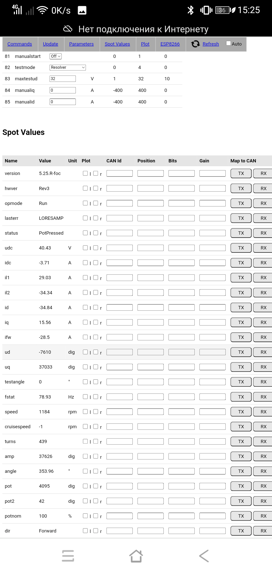

from the throttle handle, the motor is controlled as usual. it was not possible to get the motor rotation in manual start mode and attempt settings. a quiet squeak was like a normal start or angle search in the standard way, but there was no real rotation.
the last screenshot is the rotation of the motor in a normal start from the throttle stick (1000+ rpm from a 40 volt battery)
evil neodymium :twisted:

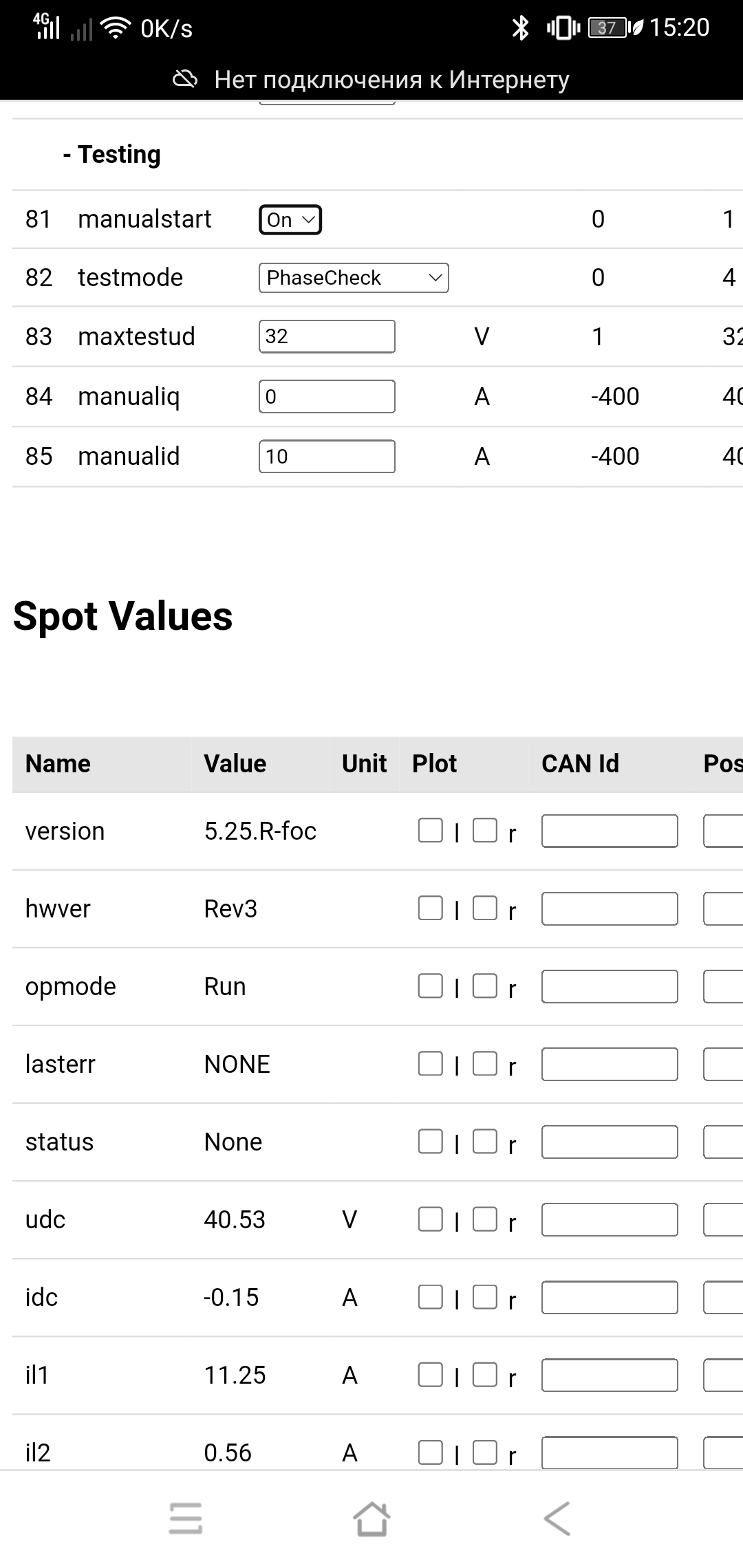

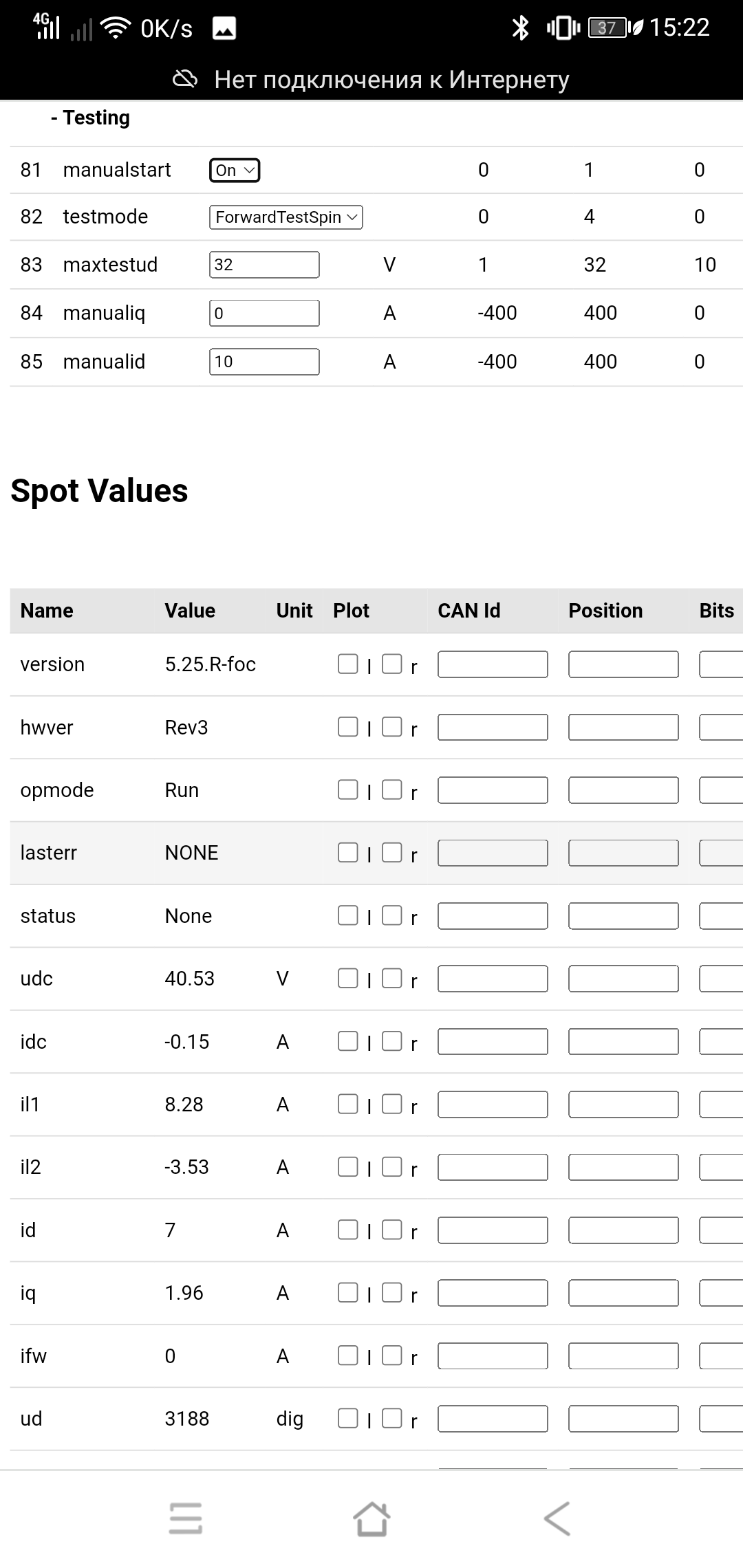

Re: IPM Motor - Auto-setup
Post by Romale »
only I use the sine/cosine chip. not a resolver. could the problem be in this place? or maybe increase the manualid current?
Post by Pete9008 »
Depends on the motor, the HSG runs fine on 10A but better on 20A (I couldn't go higher due to the limits on the PSU).
What result did phasecheck give?

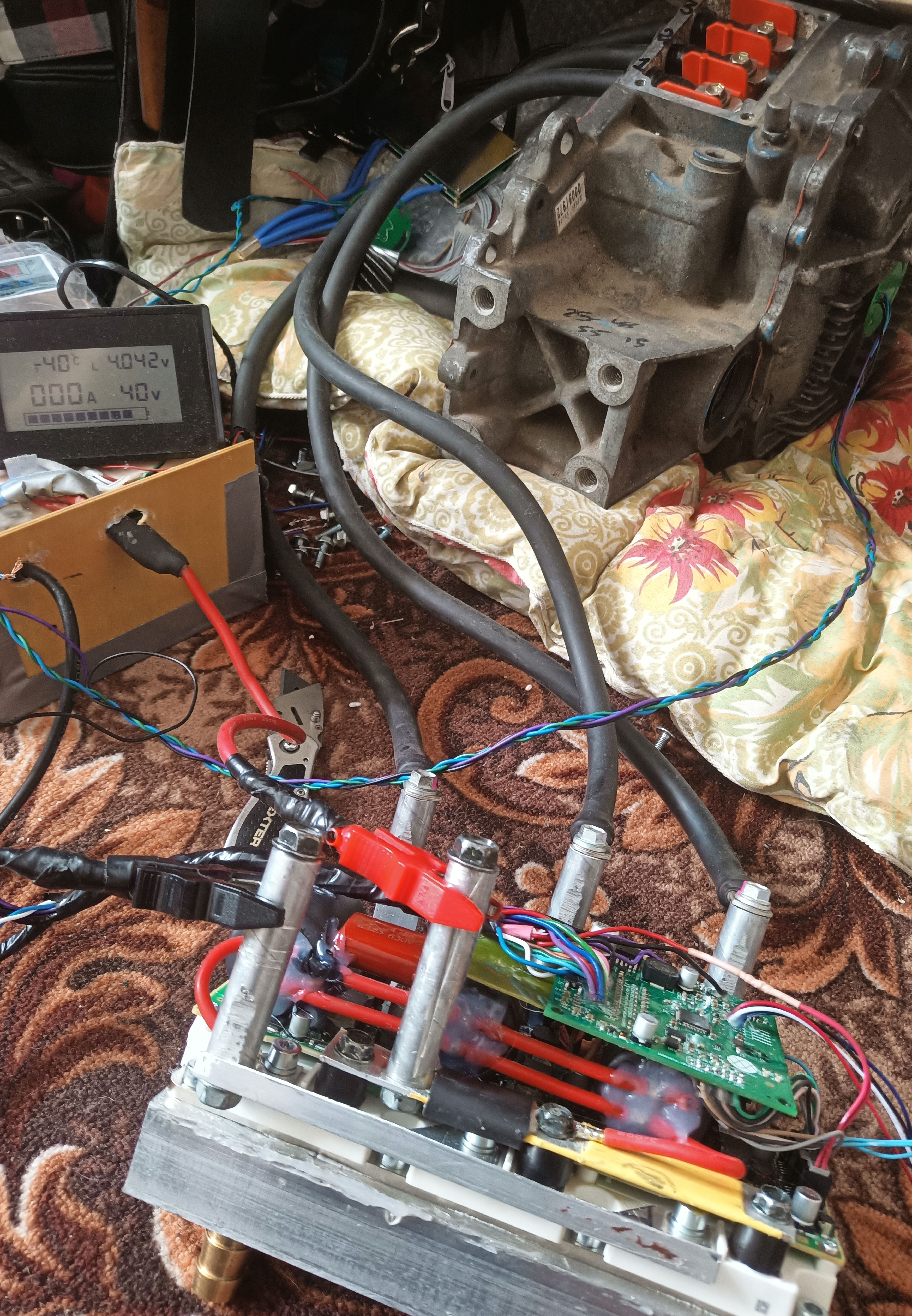

Post by Romale »
Pete9008 wrote: Wed May 31, 2023 12:38 pm
in none of the tests did the motor start spinning. a little later I will check with an increased current of 20 amperes.
MGR10 alphard motor

Post by Pete9008 »
The phasecheck shouldn't spin the motor, it just returns a result to the Messages section of the web interface.
What motor are you using?
The tests should work with any type of angle sensor.
Post by Romale »
Then maybe I didn't do everything right? I was expecting the motor to turn and didn't watch the messages above))
rear engine from toyota alphard 10 generation (mgr)
