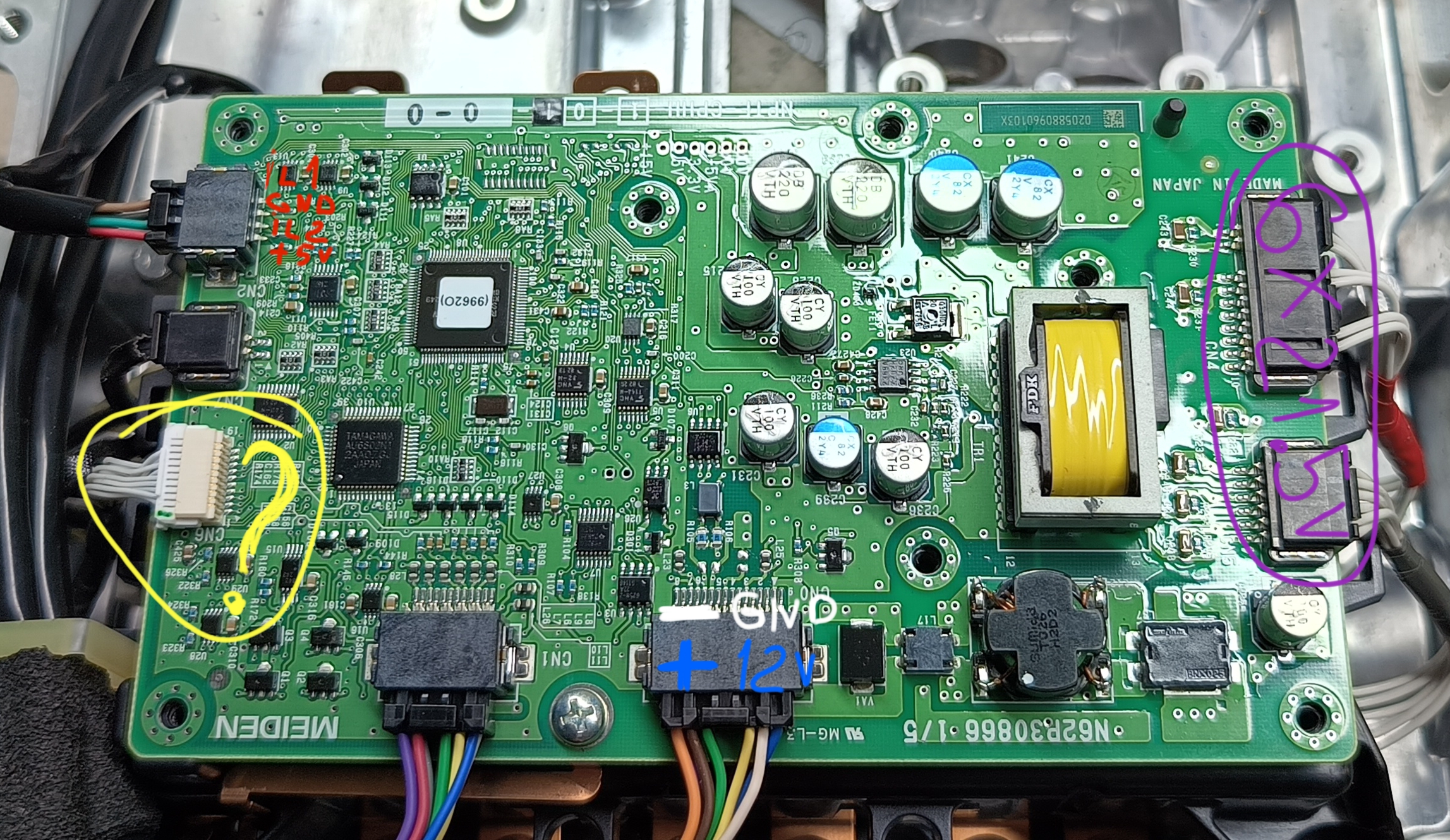

Re: Mitsubishi Outlander Front Inverter running openinverter, overcurrent issues
here some pictures of my project:
viewtopic.php?t=3450
could you please share the pinout of this white connector? thank you!nathaniel wrote: ↑Sat Mar 18, 2023 10:05 pm ........then I cut off the 6 pwm signals, resolver and current sensor and udc measurement that come from the original controller and connected it to the openinverter mini. I left the rest on the original controller. an additional advantage is that the original controller measures a multiple temperature sensor in the motor and inverter, so I can still read this via canbus.
