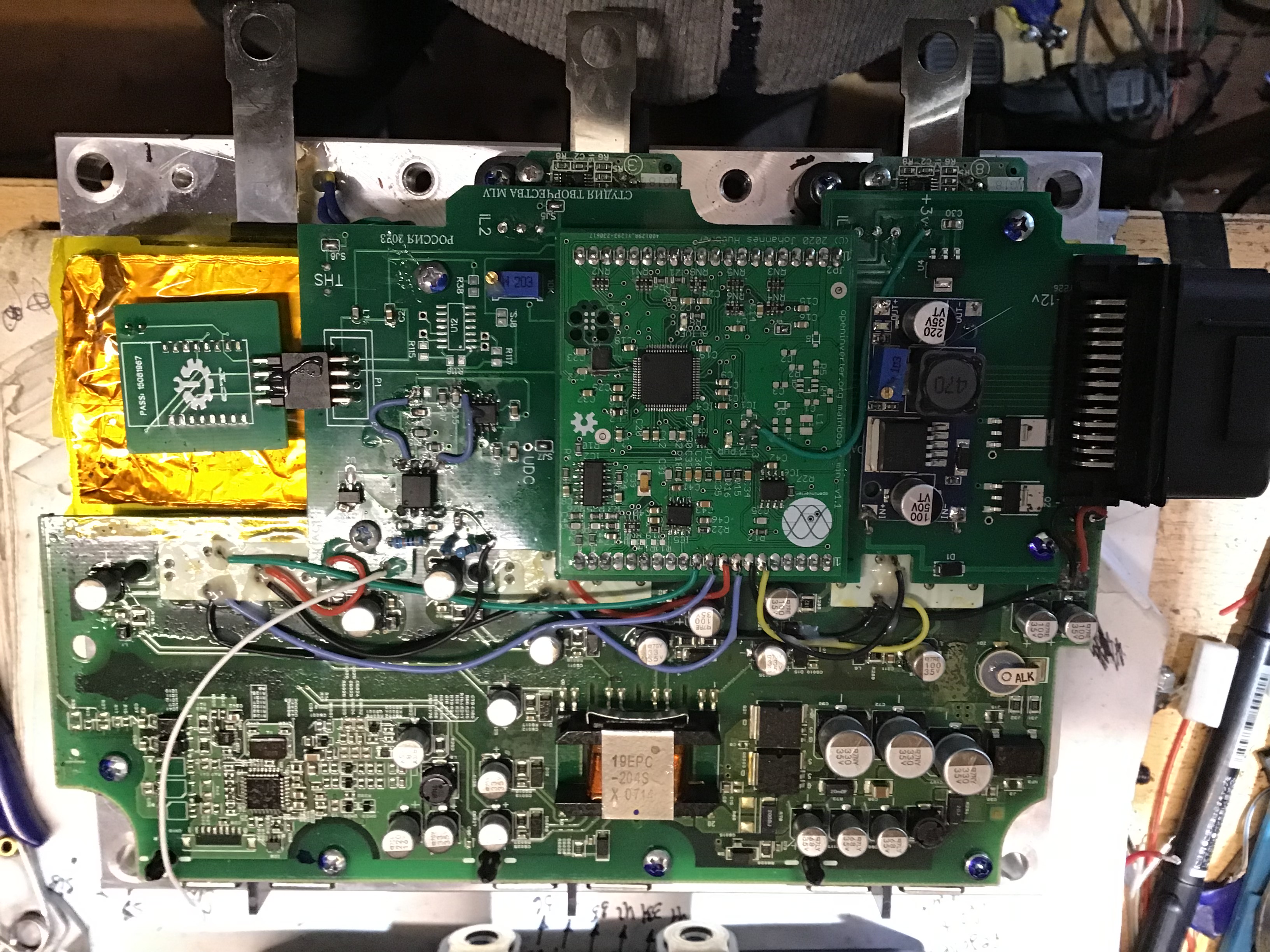

I have not encountered these problems. I just use the v3 O.I. board in the ima inverter, the current sensors and the driver power board are regular, the ima processor did not solder off and did not close any legs to the mass. from the ima, I take two wires with current sensor signals relative to the total minus of the 12 volt power supply. +5 volts current sensors are received from the standard board. also, relative to the general minus, I supply 6 pwm wires to control the transistors.
and everything.. it works by itself.
Previously, I tried to use my own isolated 6 pcs dc/dc (12/15) to power the drivers, and I took +5 volts for current sensors from the OI board, then I also got a shutdown of the inverter at a voltage above 78 volts.
evil neodymium :twisted:

8 kHz, 160 deadtime.
do you remember that in all circuits for the ima inverter, the upper lower control points are confused in places?
I showed it somewhere. the TOP of the dome is closer to the transformer. the input BOT is closer to the current sensors. and in the existing pdf files with diagrams, the opposite is indicated.

Posts: 3796
Been thanked: 413 times
Re: Honda ima and his abilities An old beetle
Romale wrote: Tue Oct 24, 2023 12:17 pm I just use the v3 O.I. board in the ima inverter, the current sensors and the driver power board are regular, the ima processor did not solder off and did not close any legs to the mass. from the ima, I take two wires with current sensor signals relative to the total minus of the 12 volt power supply. +5 volts current sensors are received from the standard board. also, relative to the general minus, I supply 6 pwm wires to control the transistors.
I went back to this theme because i want to test IMA inverter more and i cant process the part in bold. Can you explain please...
1. Do you desolder main chip, or do you somehow disable it? How does it work?
2. You simply provide the same 12V to terminals at the IMA side AND for the OI board?
3. What is the current sensors sensitivity mV per Amps? I remember somewhere the value 5.8mV/amp, is that ok?
Tnx

Hi, I thought I would answer where I can. I have been posting my work on a drop in mainboard for the second gen civic hybrid IMA inverter in the YA-HI (Yet Another Honda Inverter) thread.
on mine I completely cut away half the original PCB. however it is my understanding that the Honda inverter sends no commands with nothing connected it is possible to add your own control board on top without issue. honestly though I would rather not risk it, better to remove the standard MCU then have some odd fault blow your igbts up.
yep, I use one 12v on everything. in theory each of the gate drives are isolated so could have separate grounds if you wanted but its not worth it. as is common in other conversions that use this inverter I also supply the 12v through an un populated capacitor footprint just above the main connector.
you are probably correct with that value. but you have to remember the ADC inside the STM32 chip is maximum of 3.3V while the current sensor outputs 5v so the open inverter boards use resistors to scale the input to a safe level for the chip, thus changing the actual reading per amp.
I think i remember seeing 4.65 il 1 and 2 gain in one of Romale's parameter files.

Yeah you probably could, but is it worth the risk? really isnt much effort to remove the main MCU. not like it needs to remain functional. could tear it off with a screwdriver if you wanted to. just make sure nothing is touching afterwards and you are good to go.
I will be interested to see how the Lebowski brain performs, I stayed away because it didn't seem to be in active development anymore, and I didn't like the fact it didn't run resolver position feedback.
Posts: 3796
Beggernator wrote: Wed Aug 13, 2025 10:20 am Yeah you probably could, but is it worth the risk? really isnt much effort to remove the main MCU. not like it needs to remain functional. could tear it off with a screwdriver if you wanted to. just make sure nothing is touching afterwards and you are good to go.
I wanted to ask Romale how is his view on the matter as is personal experience.
What i am concerned with is would there be any difference if i removed the main chip vs if i keep it? Since he said he kept the chip in i am wondering if that would somehow prevent the EMI from throwing signals off. I.e. maybe those pulldown paths to the chip are keeping the other brain from browning out....? Maybe some active resistor dividers work there...?
Who knows what will happen if i remove the chip and have lebowski conk out on me... I cant easily resolder the chip back on can i?
I had similar happening to me on two cars. My Pug would operate steady, but friends Mazda RX8 is stil randomly conking out on regen... i cant seem to find any remedy....
