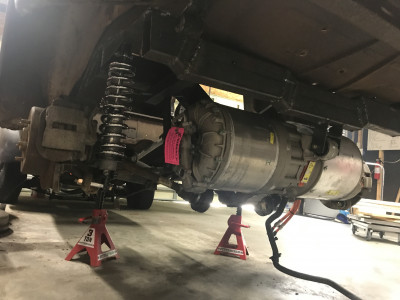

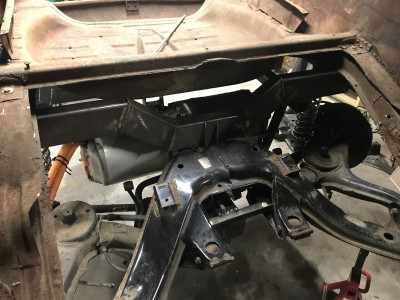

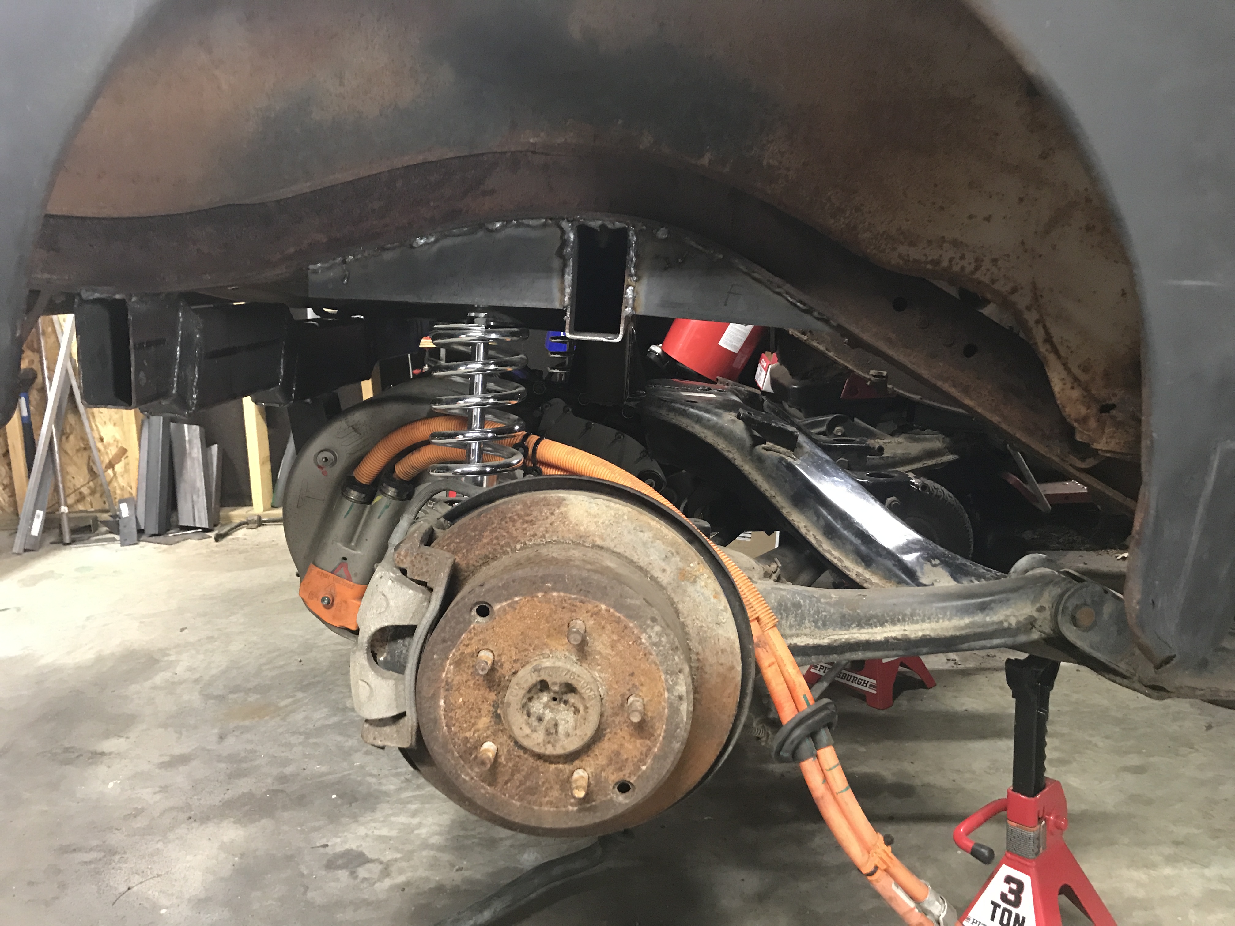

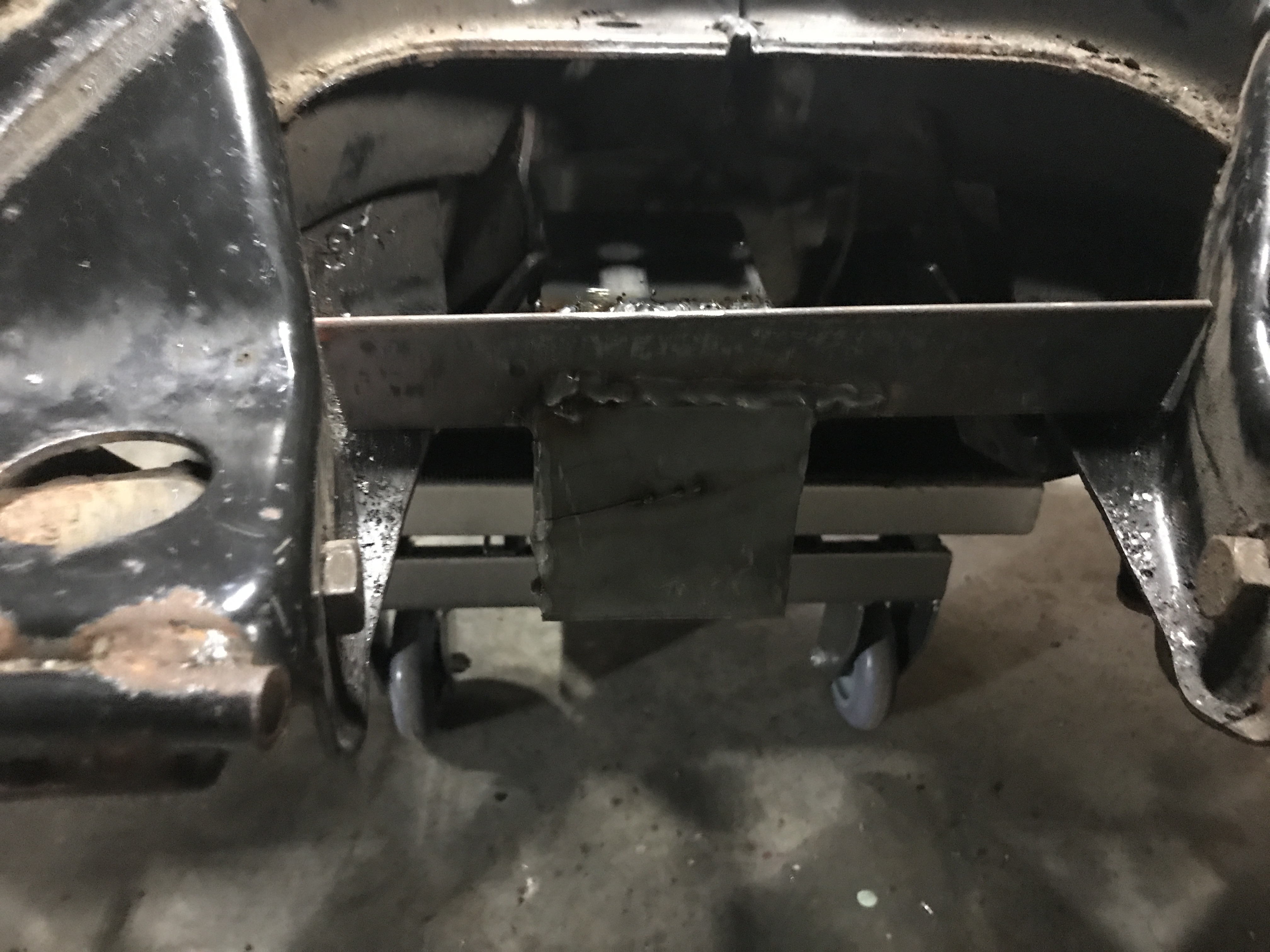

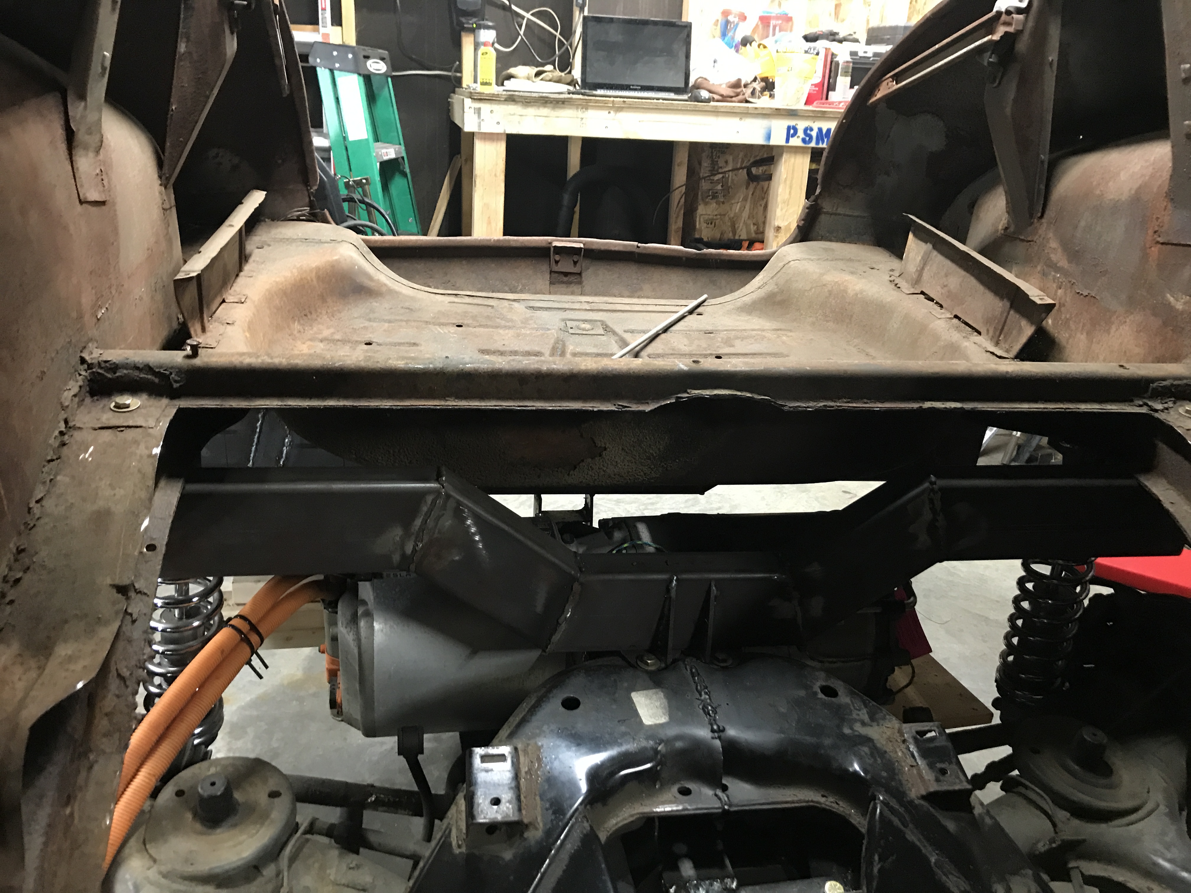

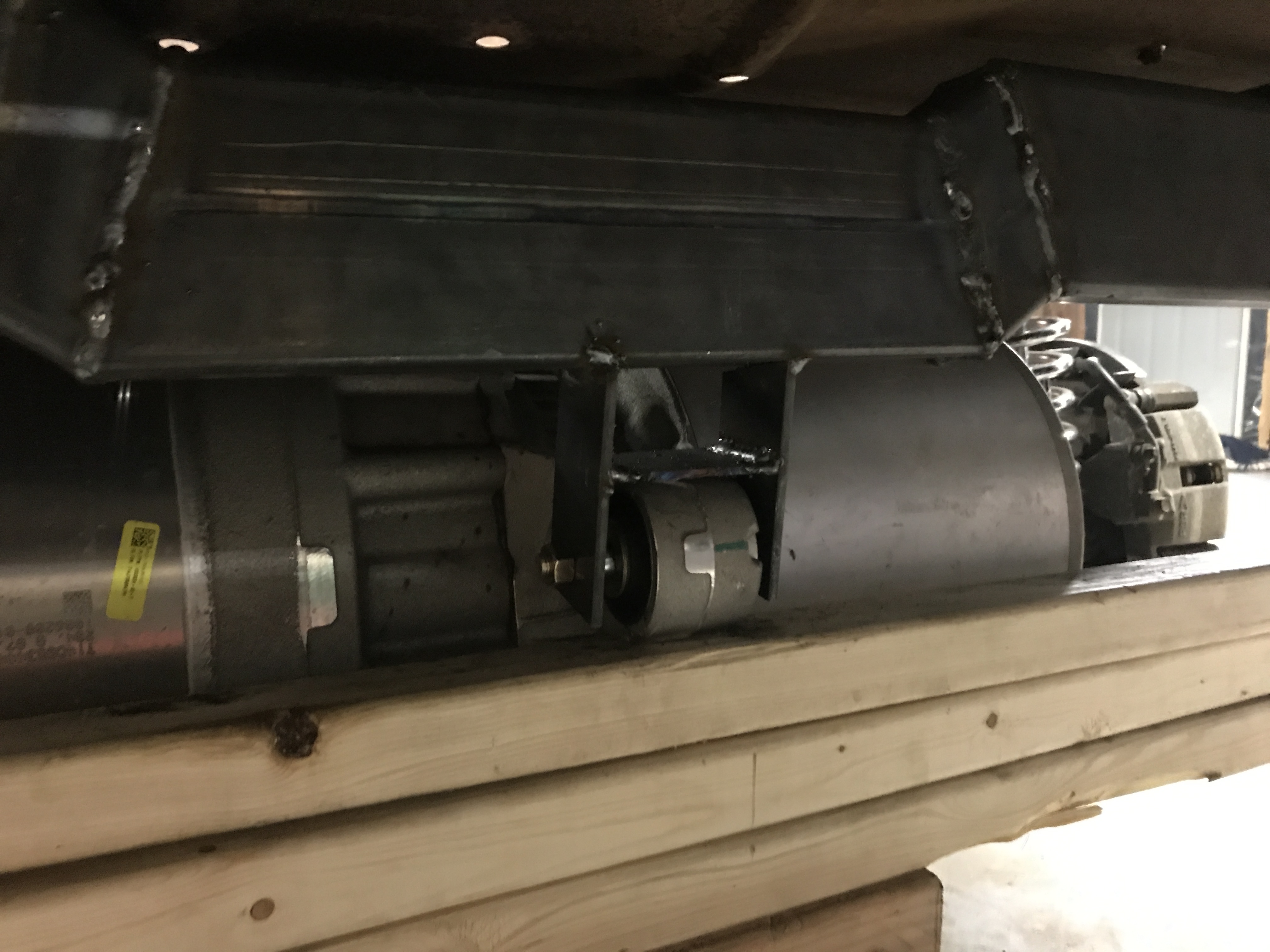

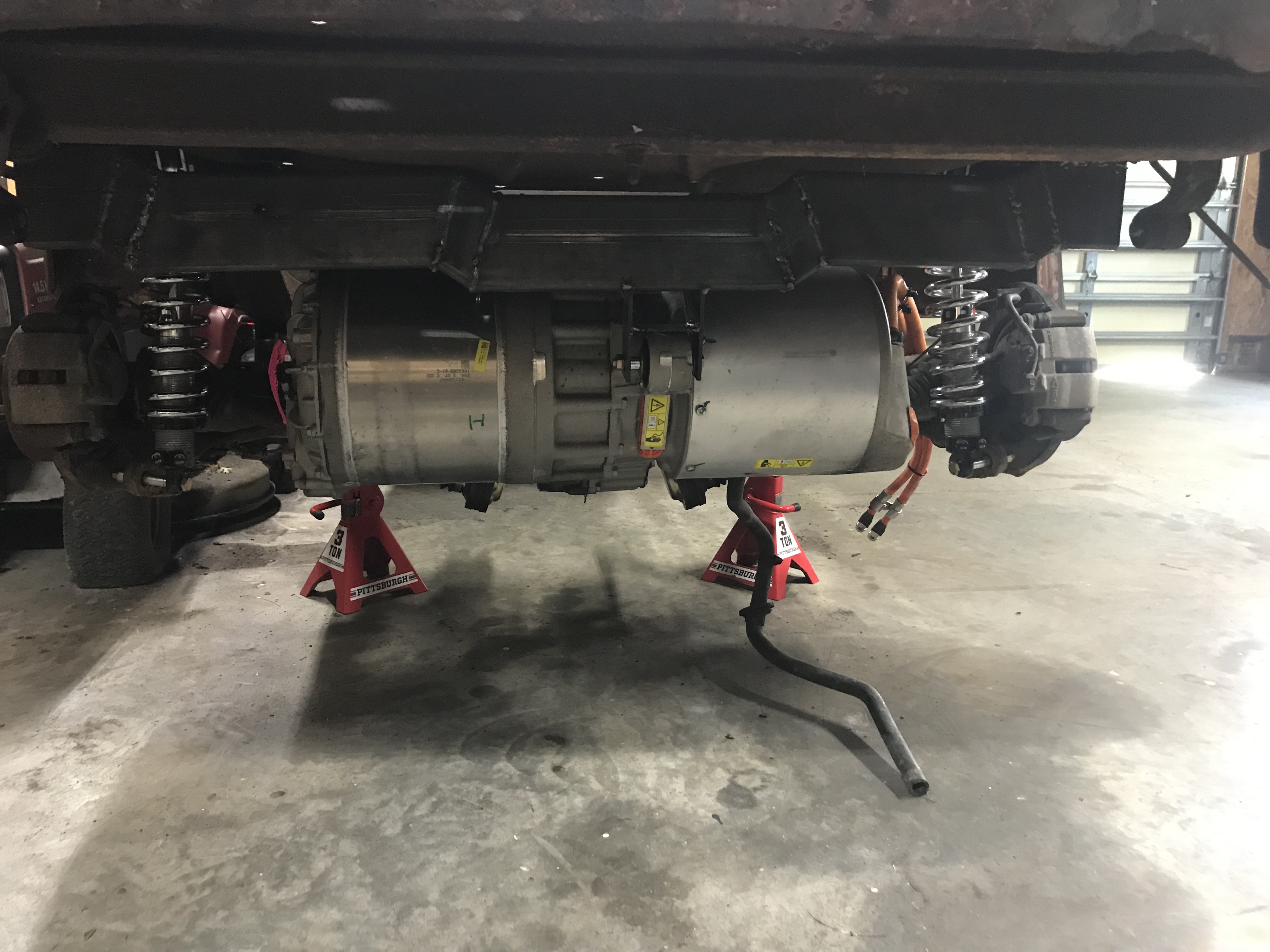

Finally some more progress. The LDU is 2/3 of the way mounted in the car. I've finished the front and rear mounts, but ran out of material to finish the side mount this weekend. I'll have to pick up some more box steel this Friday to wrap up the motor mounts. One thing this project is certainly improving: my welding skills.
Most of the mount "design" is done on the fly and with some simple geometry done by writing on my workbench. I know, not the most sophisticated or accurate, but it gets the job done.

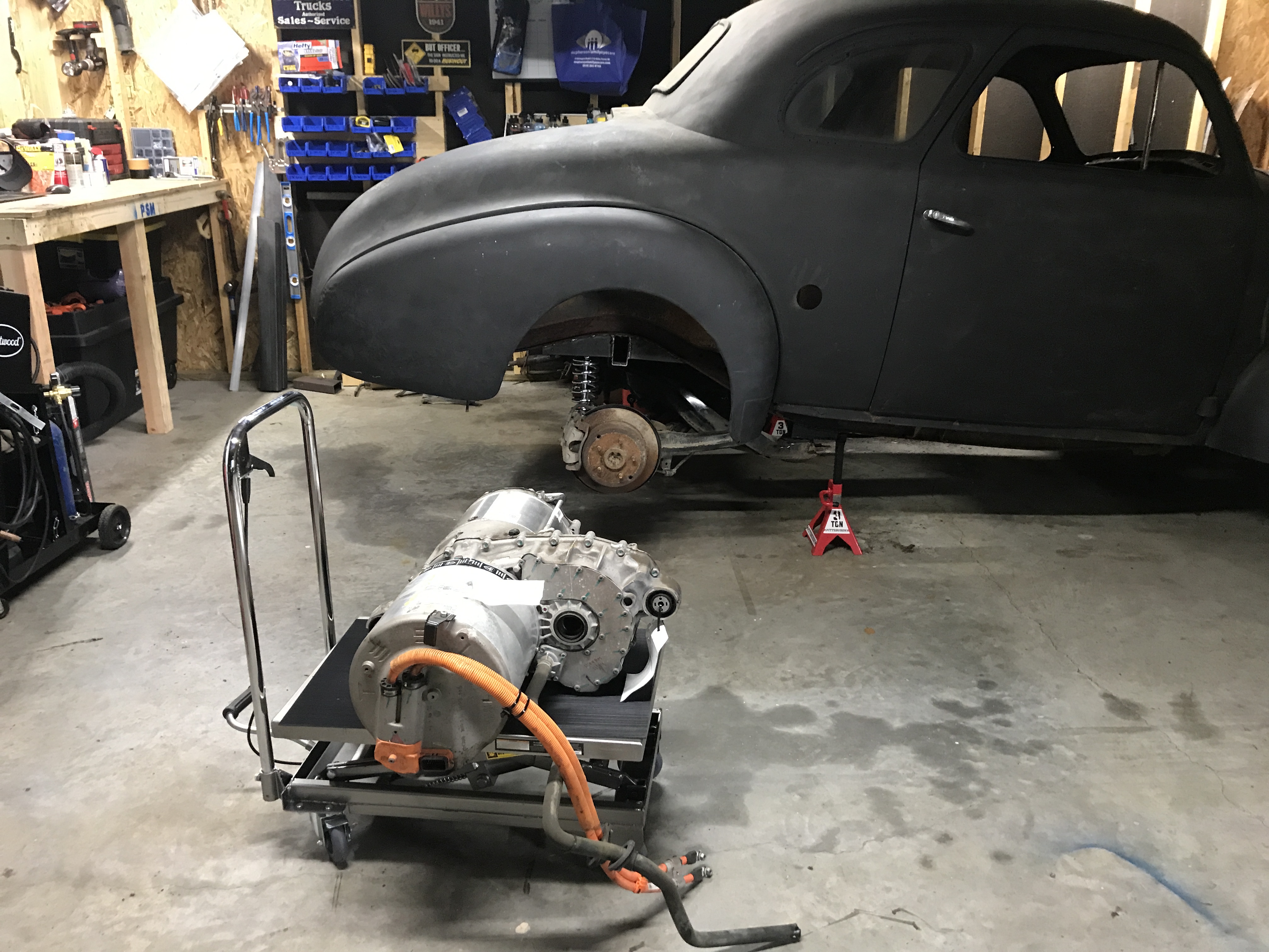

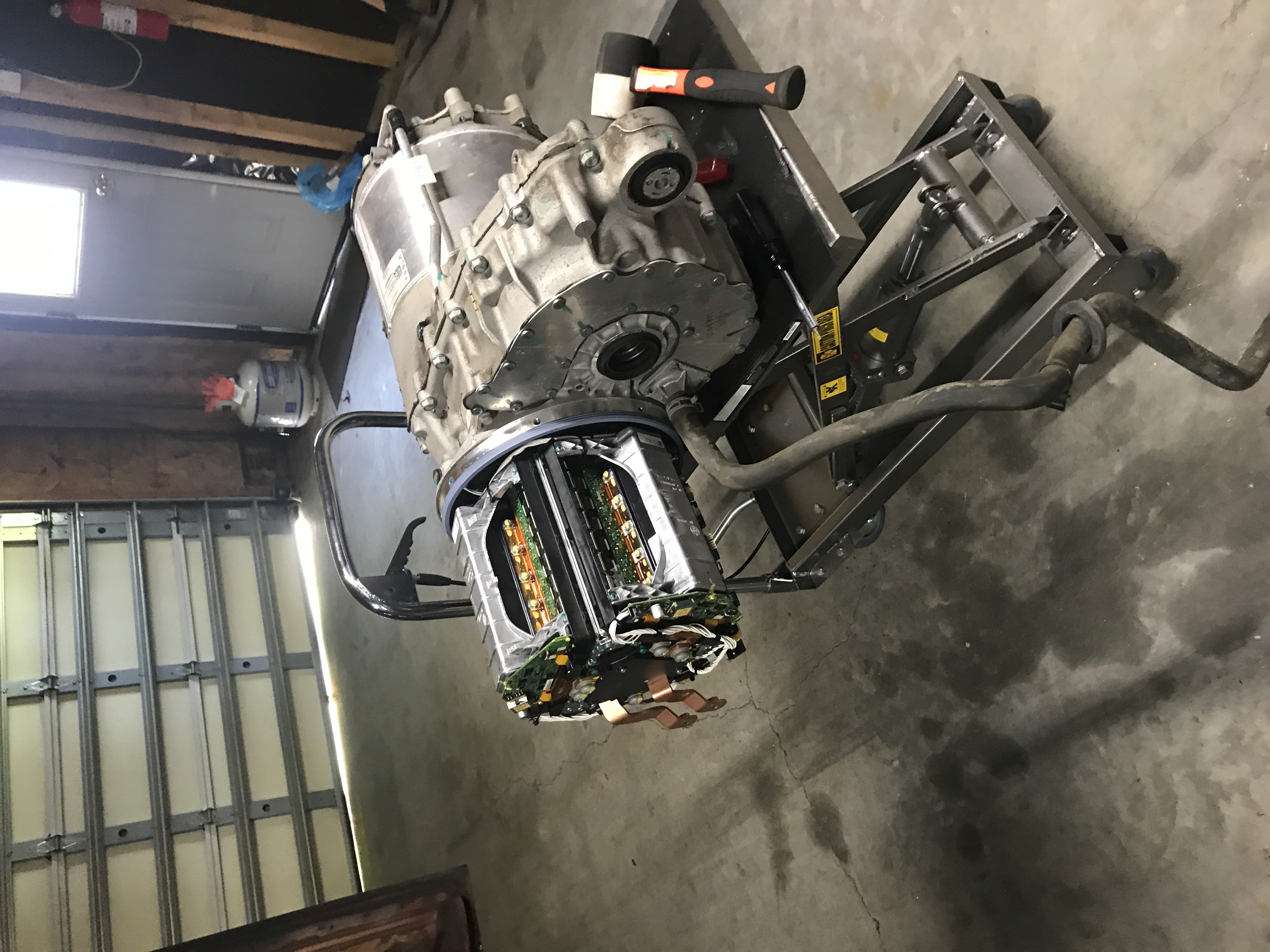

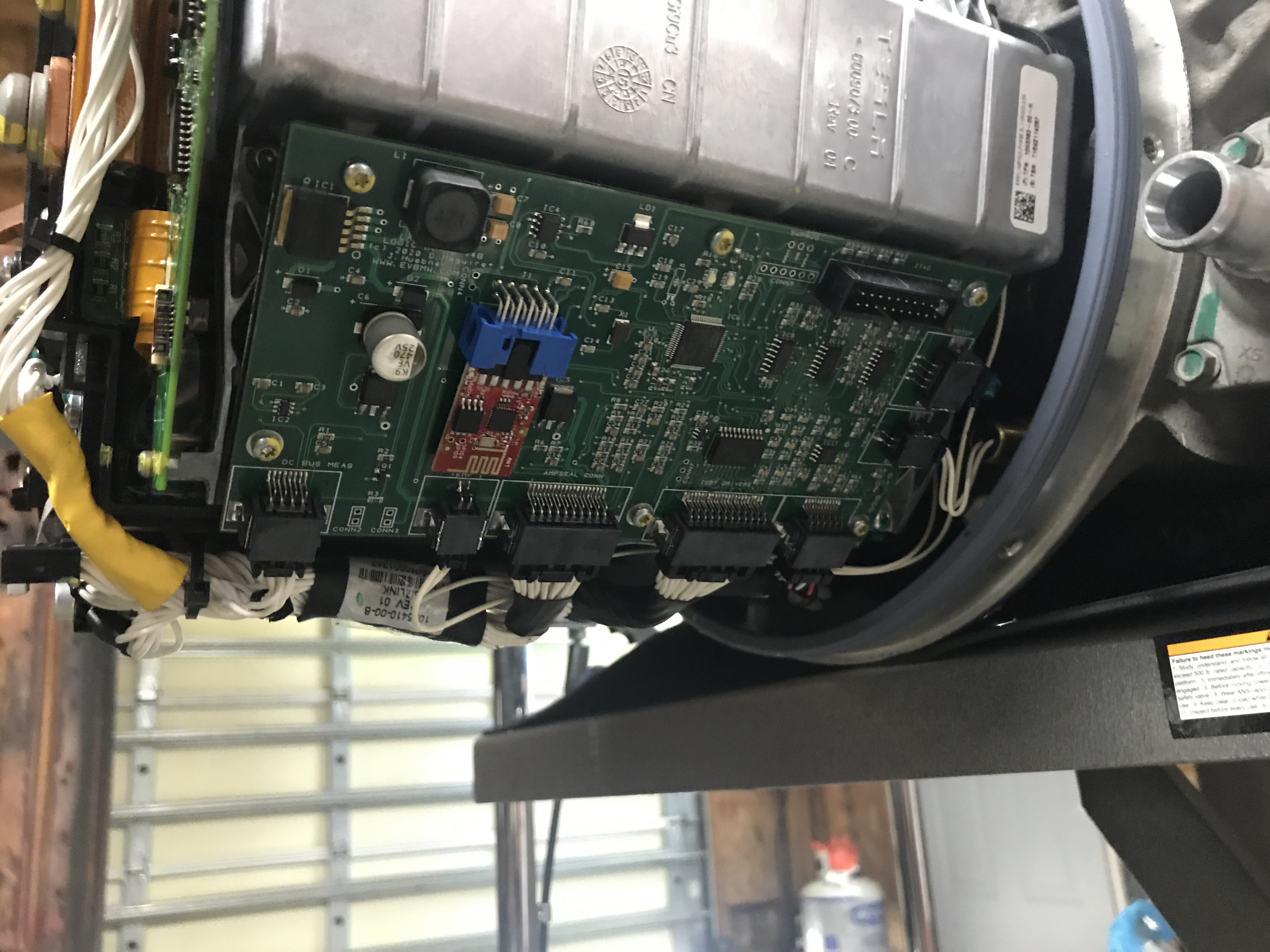

New control board is in the inverter, and drive unit is in the car.

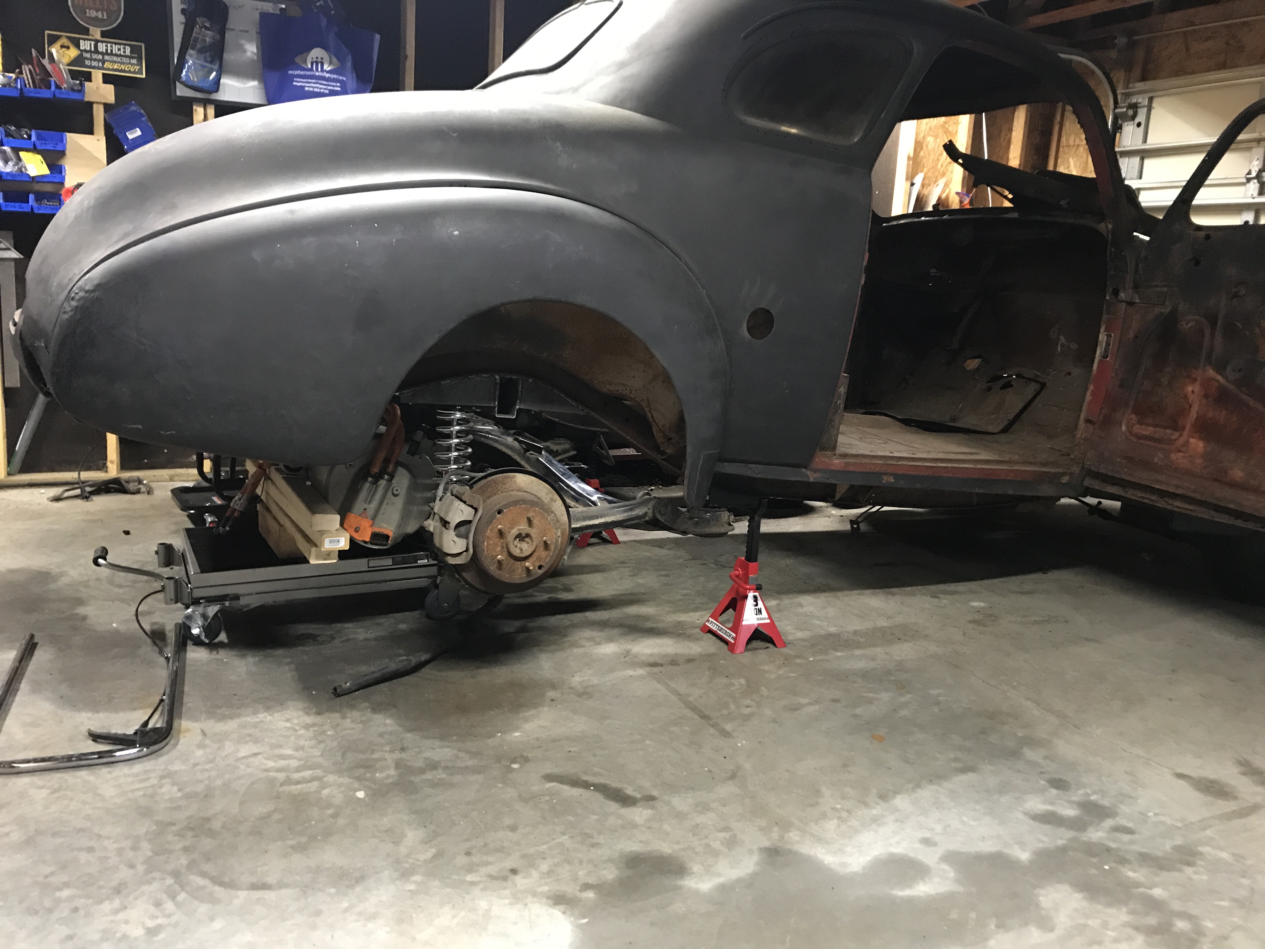

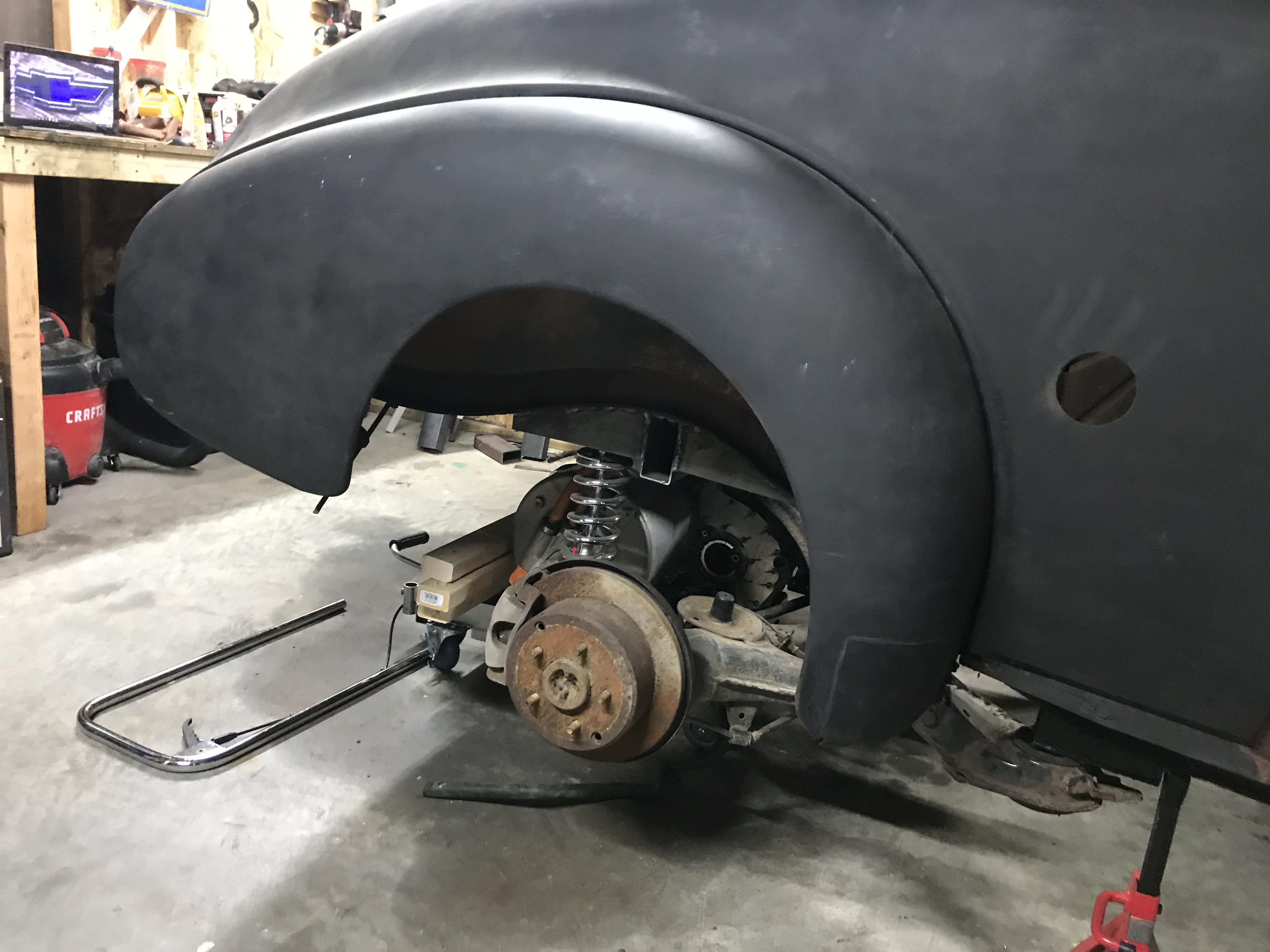

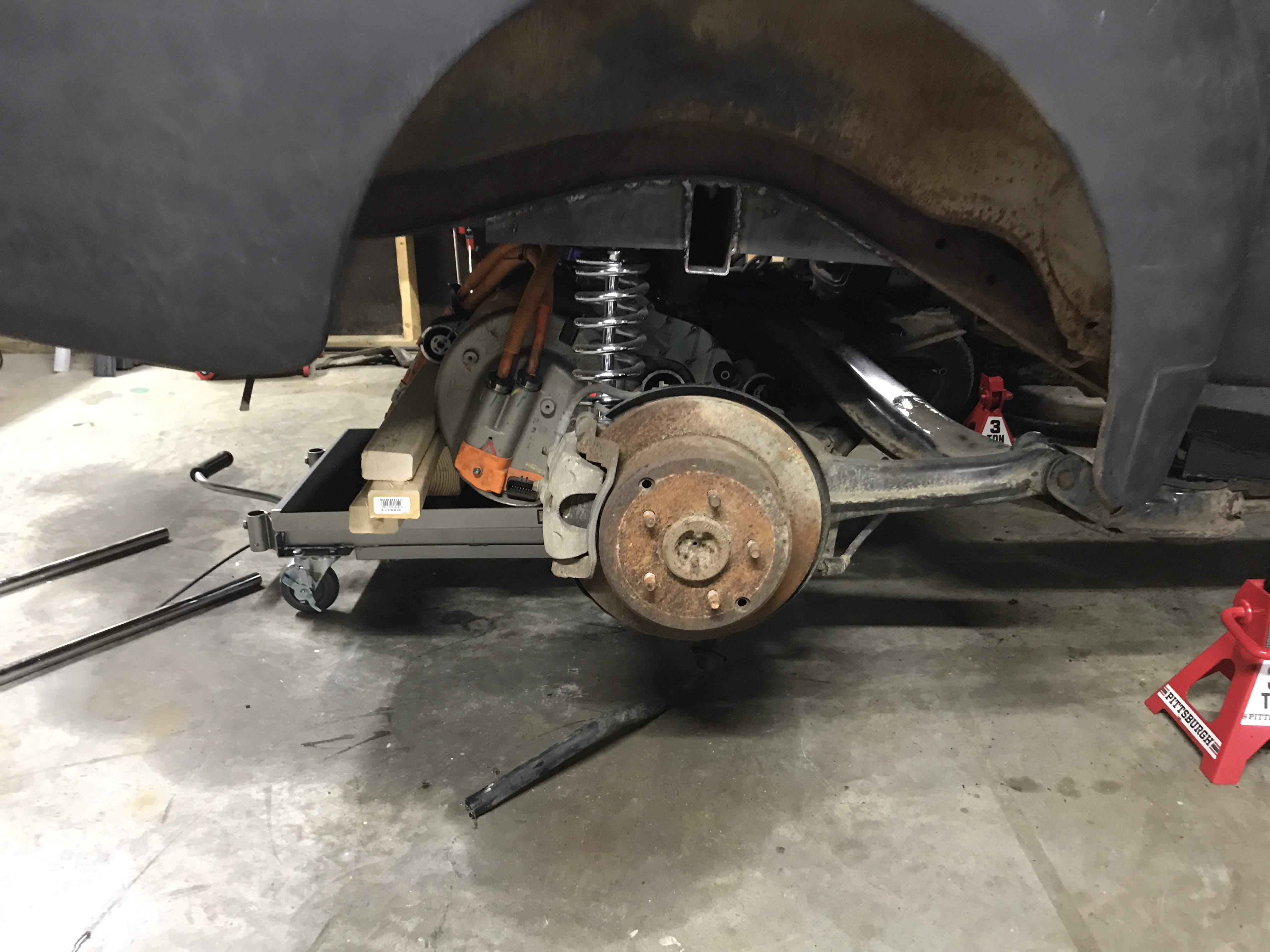

Much appreciated. One of the goals for this project is to bust EV conversion myths, in both directions; to show hot rodders that EV hot rods are still fun and have character, (and don't have to be BMW, Porsche, or VW based), and to show the EV community that conversions can be rough around the edges, they don't all need to be tidy and sterile. Though the wiring and plumbing will be neat, the car is rough, the welds are not art, and I will probably do something wrong.SRFirefox wrote: ↑Sun Oct 04, 2020 7:05 pm This is beautiful and I think a wonderful example of EV hot rodding. The suspension you selected looks like it was made to live there. Do you expect any issues with the upper shock mounts? They look like they're part of your welded cradle, but I can't tell from your photos.
Regarding the rear shocks, yes the mounts are welded to the frame just out of view. I used mounts made and sold by QA1, so I know they are right.
I decided to just bite the bullet and jump straight to coilovers rather than mess around with creating perches for the coil spring and separate shock setup from the GTO.

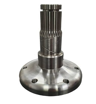

I got started on the axles this weekend. I was hoping that I could find a way to put the Tesla CV joint onto the GTO axle, but no such luck. Different spline counts (no surprise) but not enough meat on the GTO axle to cut a new spline onto it. Plus I need to shorten the GTO axles by about half an inch.
The plan for now is to cut (on an angle) and sleeve the two axles together. We'll see how long that lasts and when (not if) it breaks I'll get new axles made.

why don't you use the Tesla Drive Shaft Stumps from zero EV with adapter plates if necessary?
https://zero-ev.co.uk/product/tesla-dri ... 64-993-vw/

Essentially, that's what I'm doing but I just bought the whole drive shafts because it was cheaper. Adapter plates might work, but it would require some custom machining and/or butt welding to the Tesla stumps which I'd like to avoid. In theory, I could have the GTO shafts splined for the Tesla CV bearing carrier but the spline sizes are similar enough that there isn't enough material to cut new splines on.muehlpower wrote: ↑Sun Nov 15, 2020 8:19 pm why don't you use the Tesla Drive Shaft Stumps from zero EV with adapter plates if necessary?
I'm doing this project on a tight budget so I'm trying to avoid too much custom machining for now. Cutting and sleeving will get me on the road, and I can get a shaft with the GTO splines on one end and the Tesla splines on the other made when these break at some point.

I'm not sure we got along right. The parts of Zero EV fit into the Tesla differential and have 6 threads on a diameter of 108mm. Your drive shafts have 6-hole CVs. All you need is a ring with 6 holes of 108mm and 6 threads with your diameter, if you don't already have 108mm. No welding, no cutting!
I made adapters because my drive shafts were too short.

The Zero EV driveshaft stumps are exactly what I have but cost roughly $200 more than what I paid.
https://zero-ev.co.uk/product/tesla-dri ... umps-pair/
To mate the GTO axles to an adapter would require shortening them, and a) they don't have a good spot to add new splines b) I don't know a good local machinist c) I can't afford to be paying for custom machining work when I can get on the road with spliced axles. d) At this point I don't know whether the axle shaft or outer GTO CV joint will break first. I think its worth testing with the spliced axle to find that out.

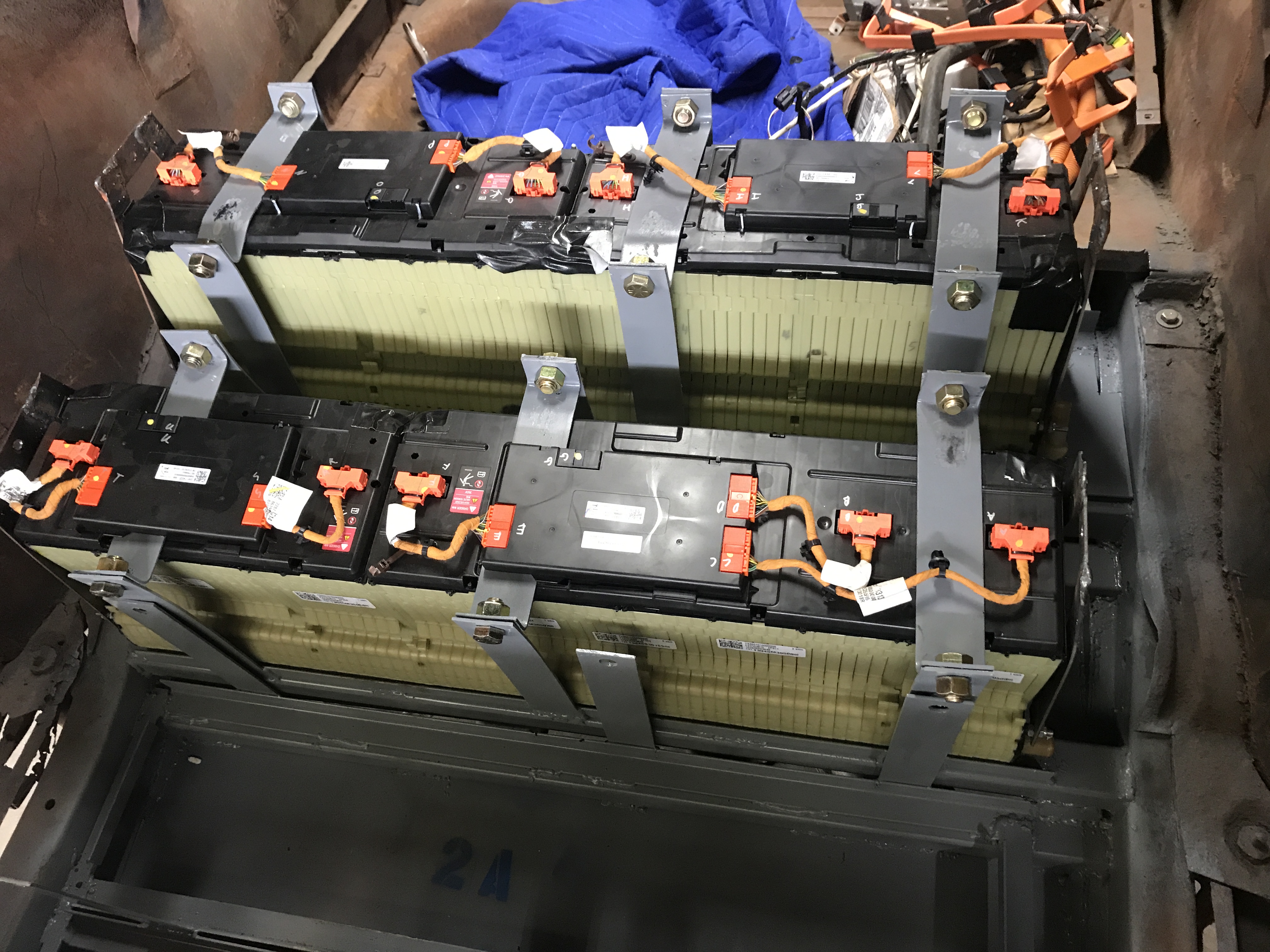

Battery #2 has been broken down and reassembled. Photos here:
I also got some work done on the battery rack/box, but didn't take photos. Hopefully by the end of next weekend I'll have the battery installed in the car.
