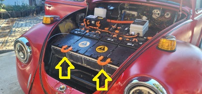

I'm just here cause someone came up with a better thread title than one of mine !
but I luv these tow shackles
20221228_134904 arrows.jpg (43.34 KiB) Viewed 14608 times

Gregski wrote: Sun Jul 02, 2023 6:36 pm I'm just here cause someone came up with a better thread title than one of mine !
two shackles that will give you a buzz if you pull hard.
i used the original cables without modifications. I gotta tell you something gregski I used those modules based on your recommendation and experience i even bought two of the eBay's listings you reference in your thread.
cheers :D
Hammer, Duct tape, WD-40 that`s it :D
