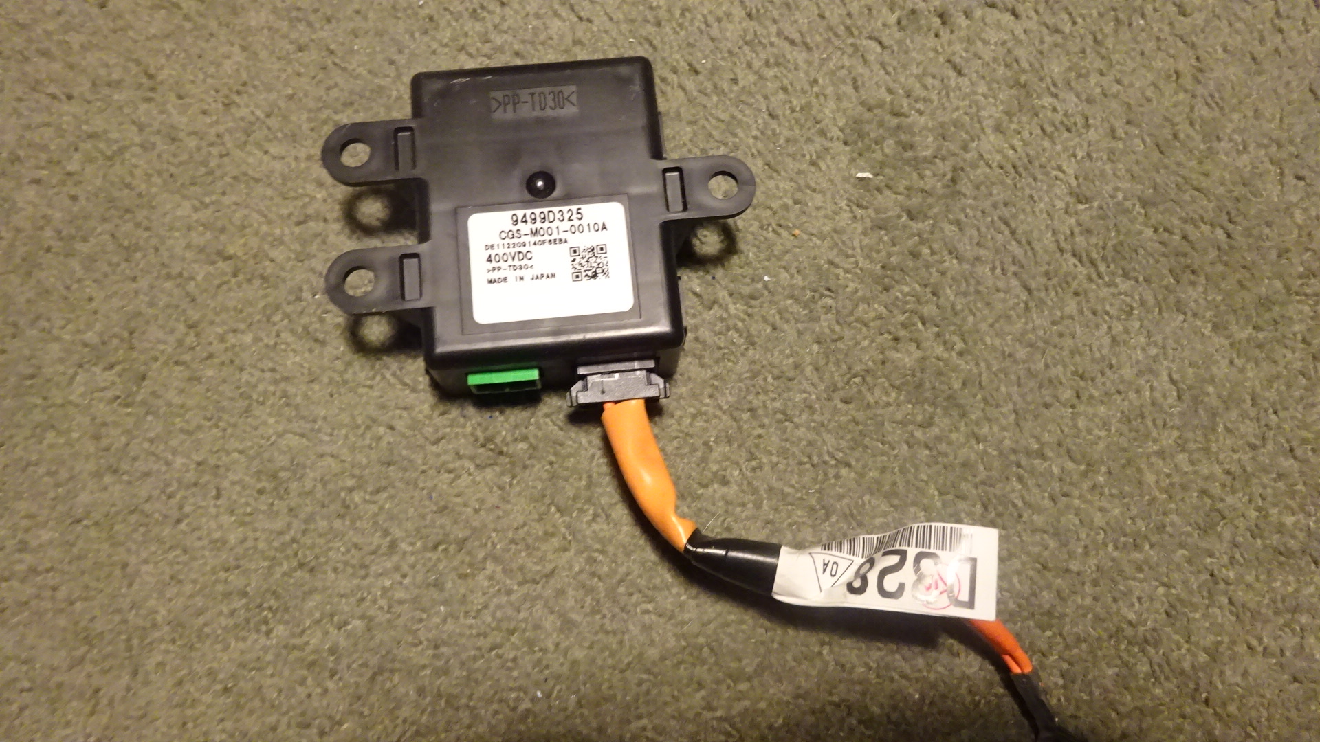

There is a separate isolation detection module in the imiev and outlander phev, i don't know whether they are CAN based or outputs an analogue signal.
EDIT, the detection module grounds the contactor so it should be relatively easy to use.
http://mmc-manuals.ru/manuals/i-miev/on ... 800ENG.HTM
