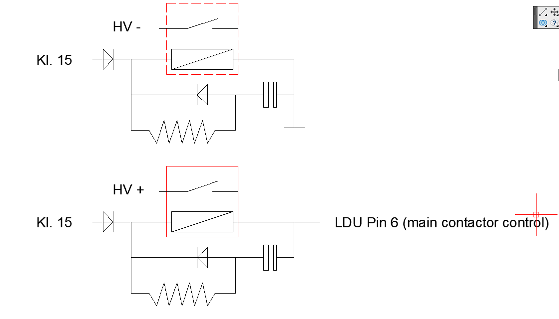

muehlpower
Posts: 807
Has thanked: 18 times
Been thanked: 186 times
Re: How to not kill a tesla drive unit
Post by muehlpower »
I'll do it like this, close to the Contactors. It maintains the high voltage for a second even when the ignition is switched off while driving. The capacitors of the power supply on the OI control board should be empty more quickly. The diodes and the resistor limit the inrush current and prevent the current from flowing back to terminal 15. Unlike digital or timer-based solutions, it switches off safely after one second.

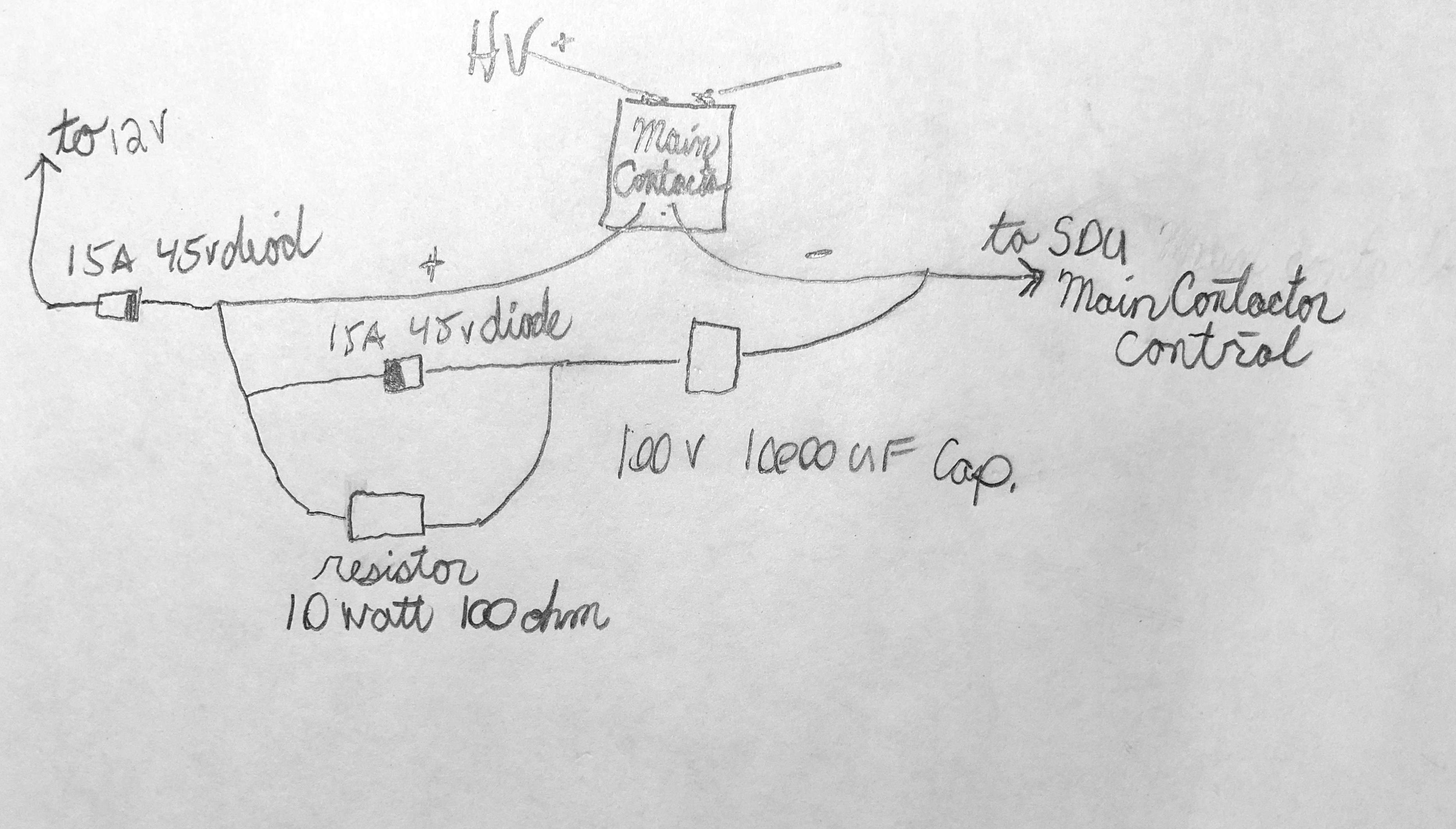

Would something like this do the trick? I have these parts already except the capacitor. I would think the trip mode option to close the pre charge would be a perfect protection if given the option to then open after 1 or 2 seconds.
I was thinking of using the Ford fuel pump cutoff switch pictured. I have seen it recommended in forums.

I understood the capacitor approach addresses the use case "ignition off while driving kills the inverter".

muehlpower
Posts: 807
uhi22 wrote: Wed Aug 28, 2024 6:03 am I understood the capacitor approach addresses the use case "ignition off while driving kills the inverter".
Exactly. In my imagination, first the direction signal goes to neutral (RND), then the capacitors of the power supply on the OI board are empty, and then the HV battery is disconnected. And everything is so safe that the TÜV accepts it as a real emergency stop, not just the signal for forward or reverse is switched off. Perhaps the TÜV or someone at the inspection for a racing event also wants a demonstration that the drive should survive.
How it is then switched off, ignition, emergency stop (also several) or crash sensor is then irrelevant.
Of course, this delay must then also be applied to the second contactor, which is not controlled by the drive unit.

phillipschip wrote: Wed Aug 28, 2024 2:47 am Would something like this do the trick?
That old style Ford inertia switch is one of the problematic ones I mentioned. It used to be funny to kick the front bumper of one of these cars and this switch would open. Car wouldn't start and the owner wouldn't know why. There might be a newer revision that's less sensitive though. I believe hitting a small to medium size animal would also open the switch possibly rendering your drive exploded. I believe these were added because of the lack of a fuel pump safety circuit in these models.
I'm not seeing what you guys are with this extra one second of contactor on time. If you're going highway speeds and the inverter is shut off, I only see this as giving you 1 second to turn the ignition back on before the contactors open / inverter fails.
It might buy you a little in the speed above which the inverter fails if contactors are opened - allowing generated regen power to flow into the battery. But this would likely go full regen during the inverter off, contactors still closed time, likely causing loss of control.
All of the emergency stop tests I've seen are stationary. But I think this should still be thought through.
OI has an e-stop loop in at least some inverters. Doesn't opening this set the inverter into like a neutral mode, a no regen / no acceleration mode to allow coasting safely to a stop?
It seems like what you guys are after is more of a vehicle computer that's watching for vehicle speed or crash info to cut the contactors when safe or in an emergency but I might be mistaken.

jrbe wrote: Wed Aug 28, 2024 10:18 am That old style Ford inertia switch is one of the problematic ones I mentioned. It used to be funny to kick the front bumper of one of these cars and this switch would open. Car wouldn't start and the owner wouldn't know why. There might be a newer revision that's less sensitive though. I believe hitting a small to medium size animal would also open the switch possibly rendering your drive exploded. I believe these were added because of the lack of a fuel pump safety circuit in these models.
Any suggestions for a good inertia switch? If a really good one was installed that would only trip for serious accidents then the inverter wouldn’t matter :0
