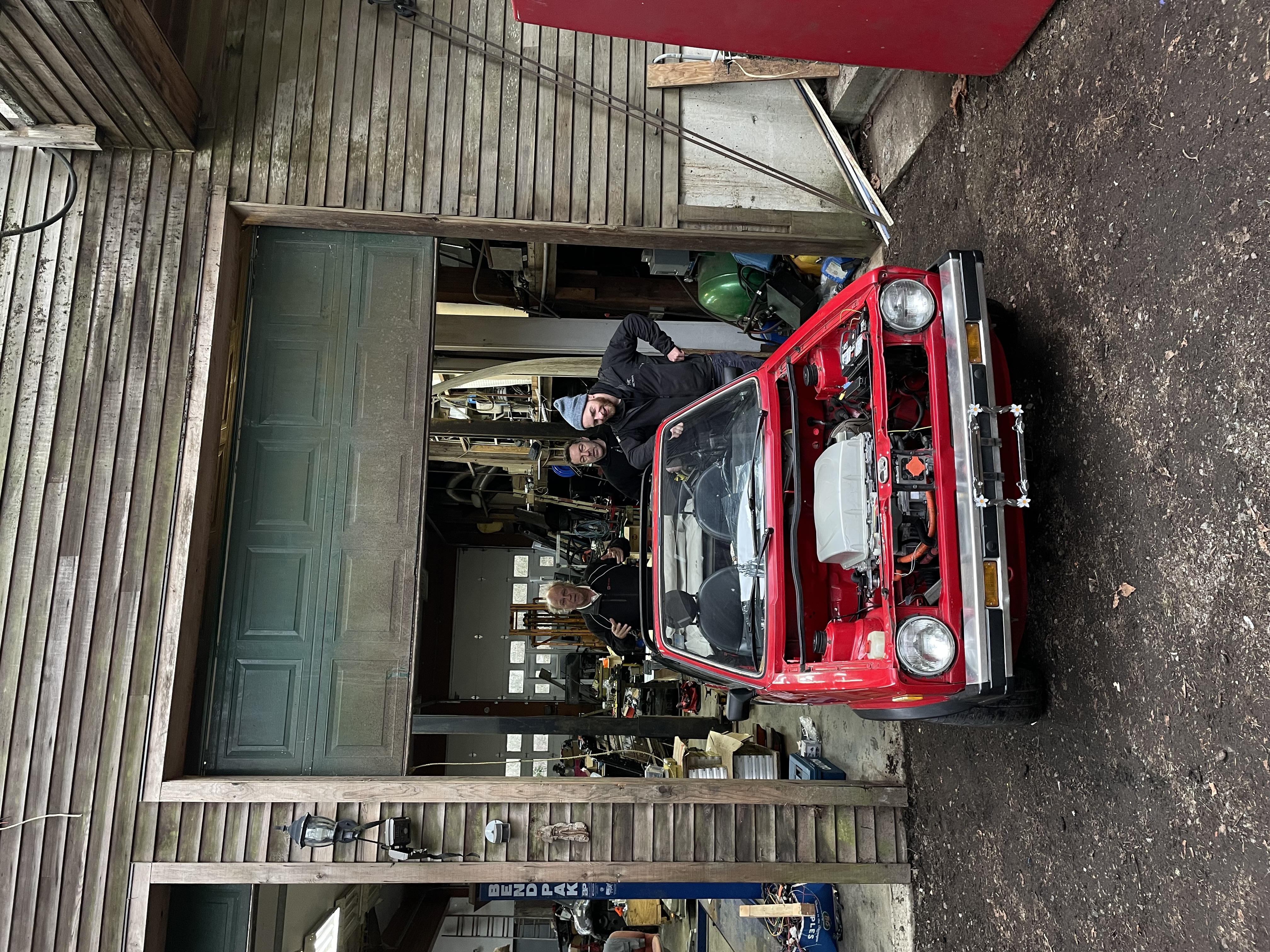

The guys are stoked! We burnt some rubber today
There’s no noticeable torque steer, takes off like a rocket, steering is nice and light. Needs stiffer springs In the rear as it dose run, we put lowering springs in the front.
Pretty much no power in reverse, it’s un usable.
I’ll have to do a savvy can dump and see if there’s any missing messages ?

Quick test drive

Does the crade mount to the existing mounting points? No new holes need to be drilled? Do you have more photos? Not visible how it is attached to the front beam?

no new holes
cradle goes from the mounter mount point under the body, to a pickup point on the front beam. and 2 mounts matting to the original mount mount points on ether side of the engine bay
