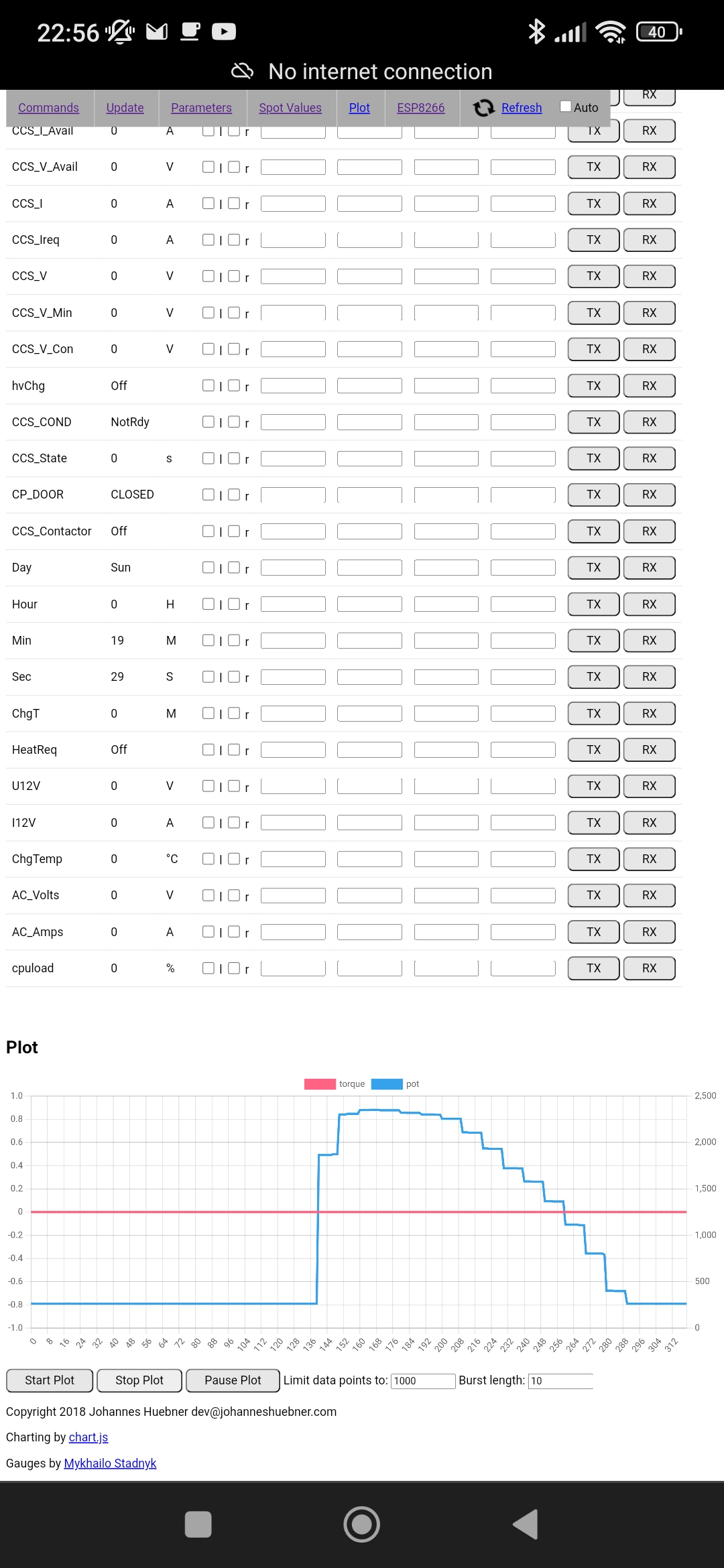

Quick video of the current setup. Finally got invUDC showing on the web interface but no spin still.
I think I need to revisit the signal wiring.
Re: setup, I also tried doing all the LV off one battery with the PSU adding current but that didn't help. I've got a piece of aluminium bar touching both the inverter casing, transmission casing and the shield signal screen touching the inverter case with another 4mm wire going from the inverter case to the battery negative but still no dice.
No obvious errors on the web interface from what I could see.

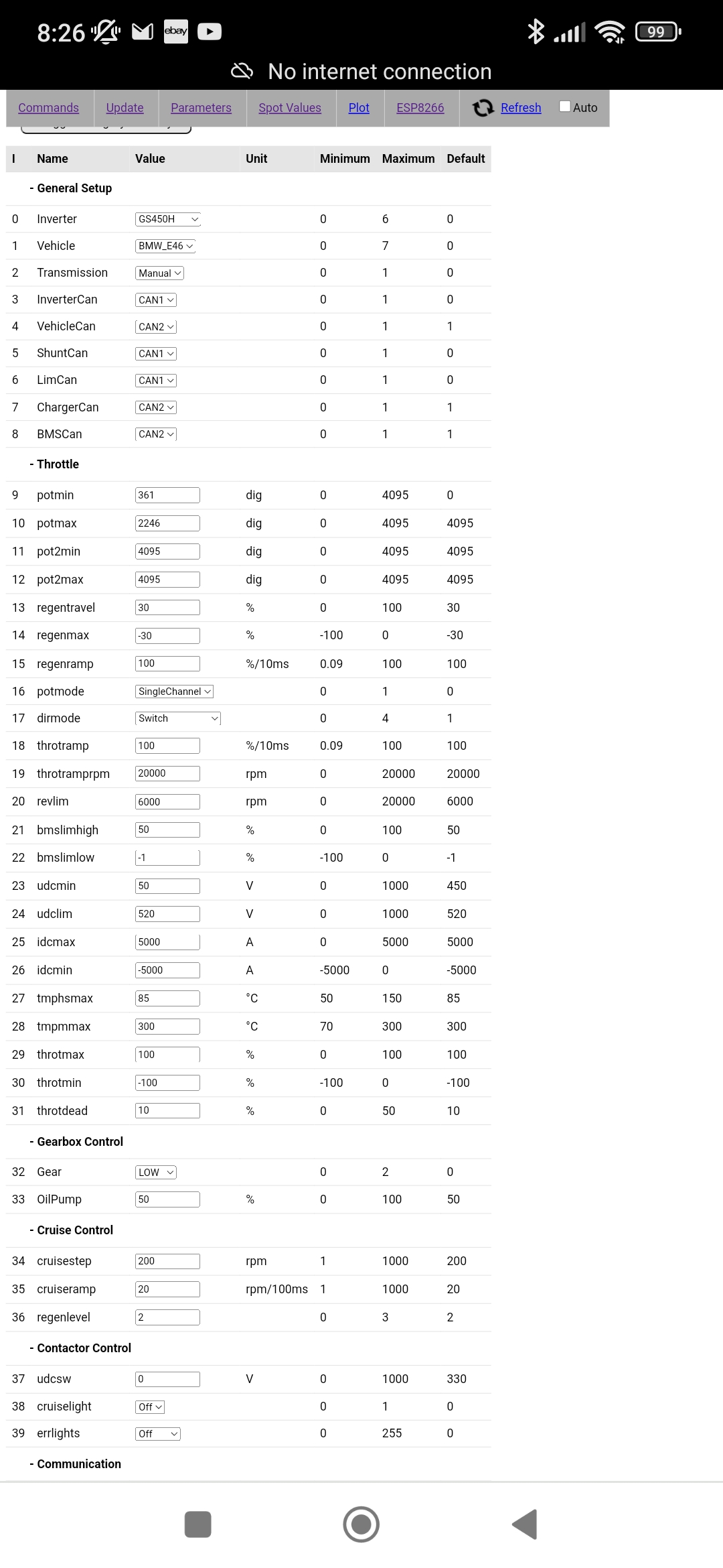

The fact that torque is 0 suggest potnom is also 0. Previoulsy you stated that you had potnom values which would also mean there were torque values. I do not have a GS450H but I have checked with GS450H inverter selected and if there is a potnom value >0 there is also a torque value.
To get potnom/torque values the only requirements are to be in run mode and forward or reverse direction selected.
The wiki suggest checking that throtmax is not set to zero and that that tmpm is less than tmpmmax.

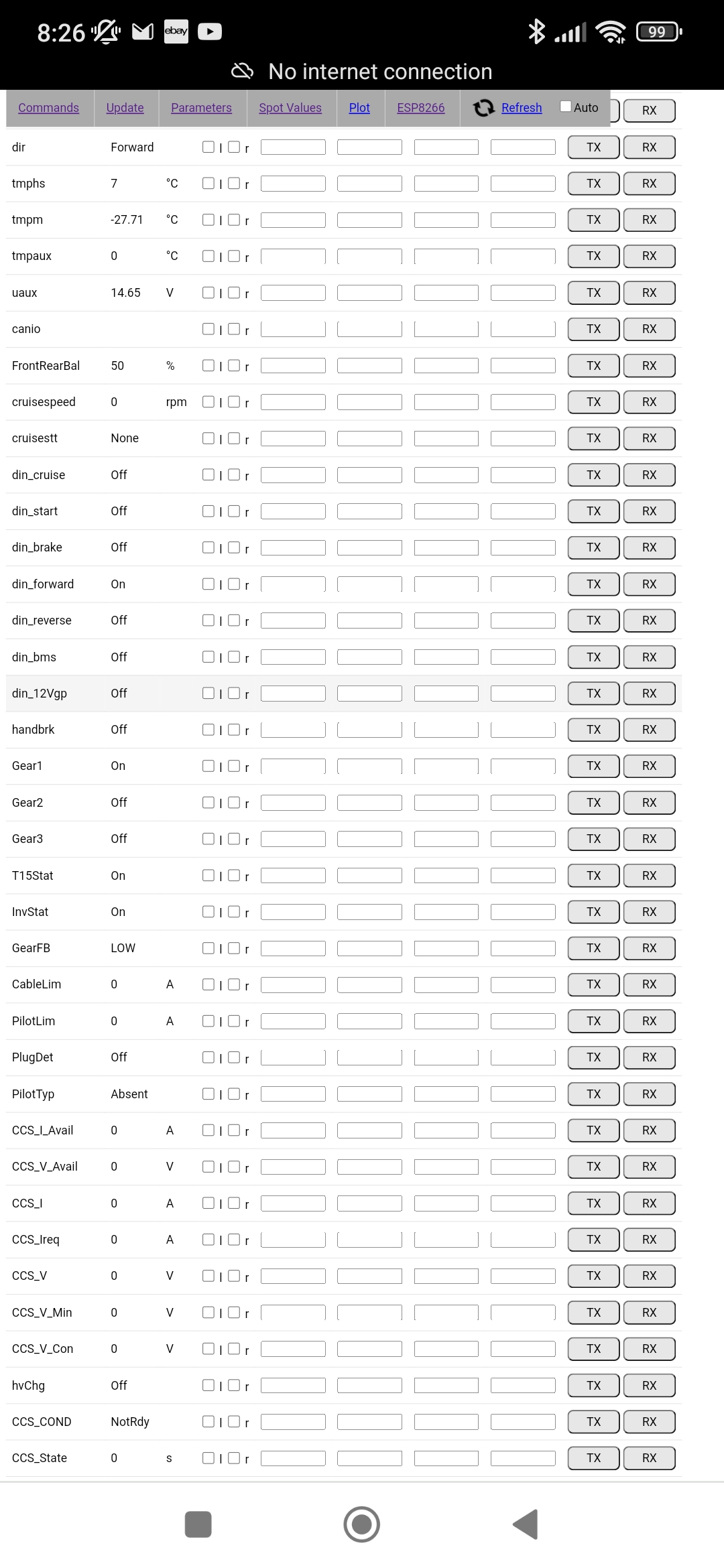

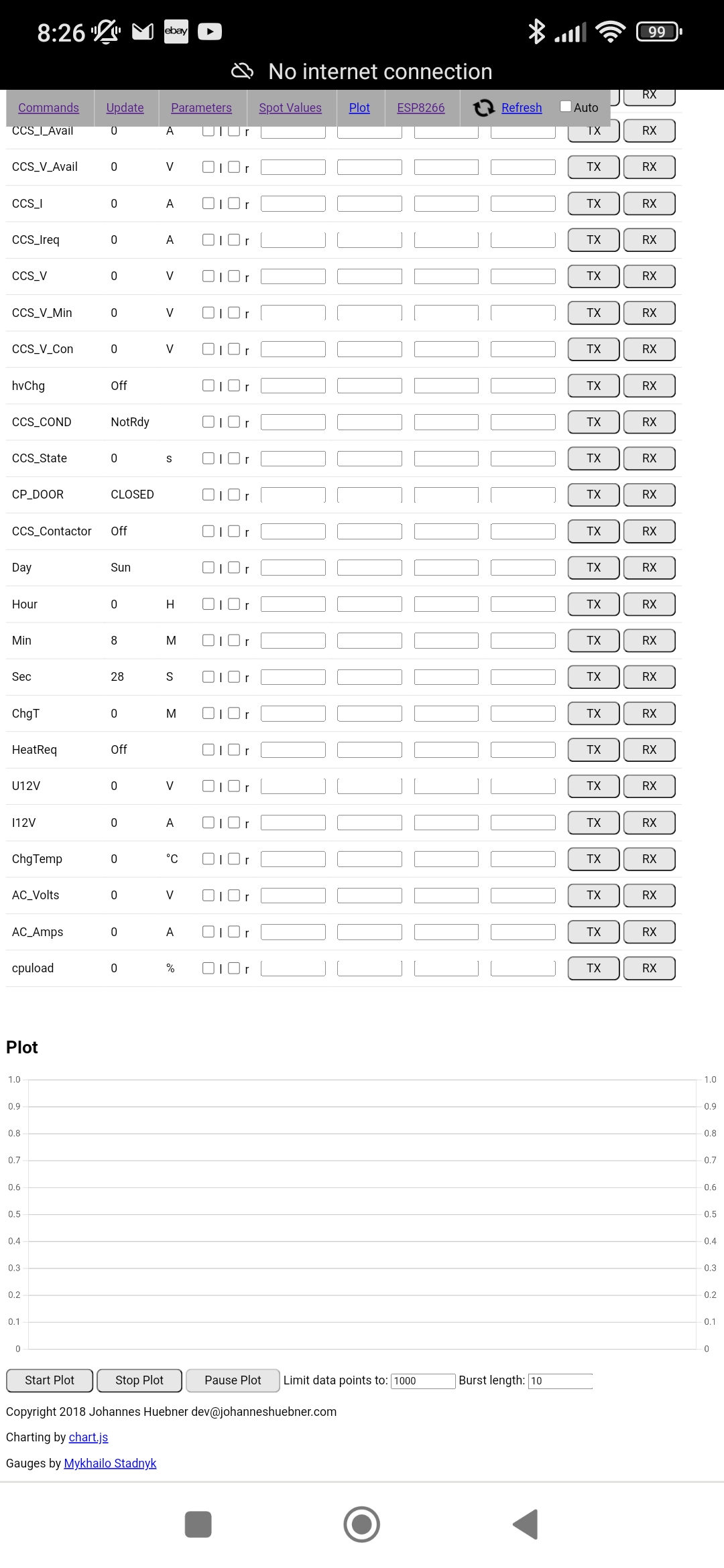

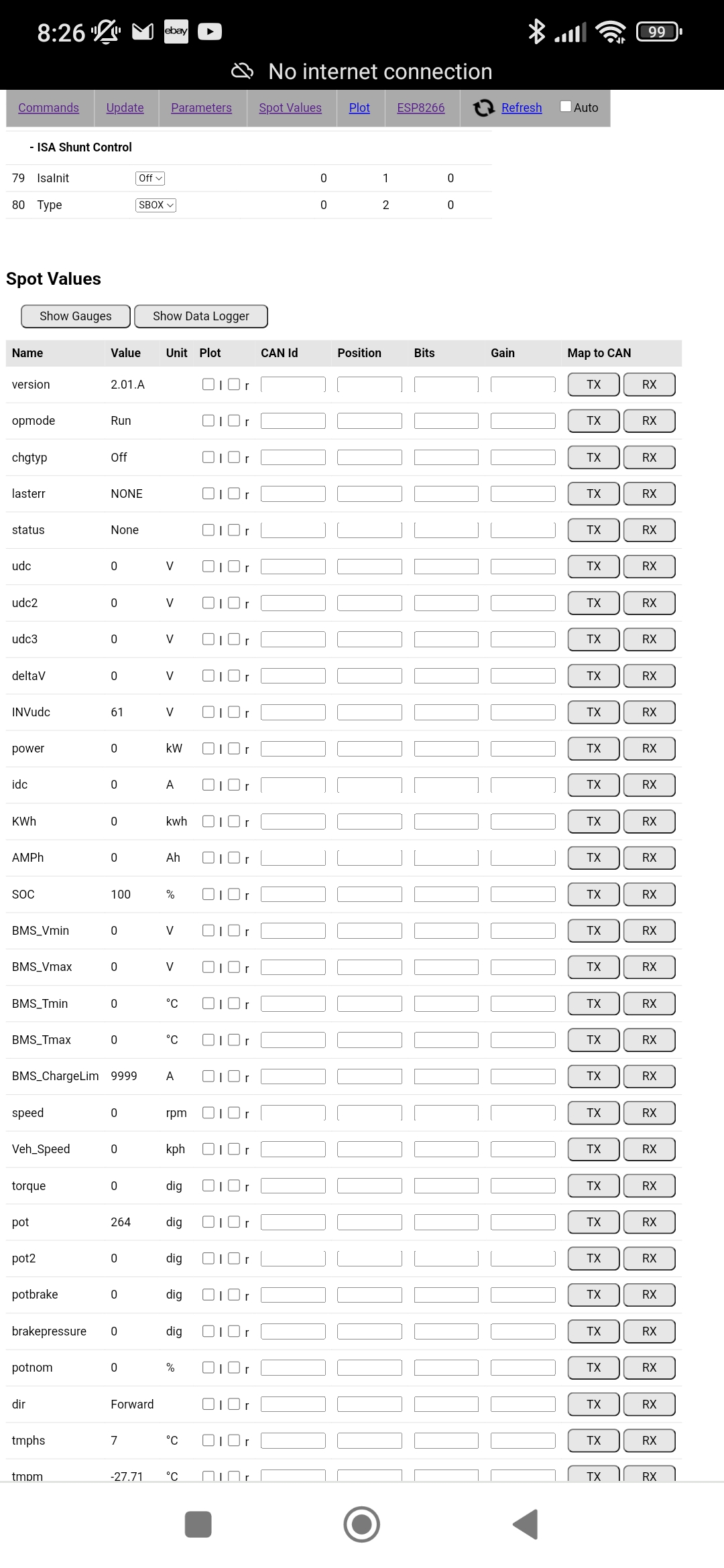

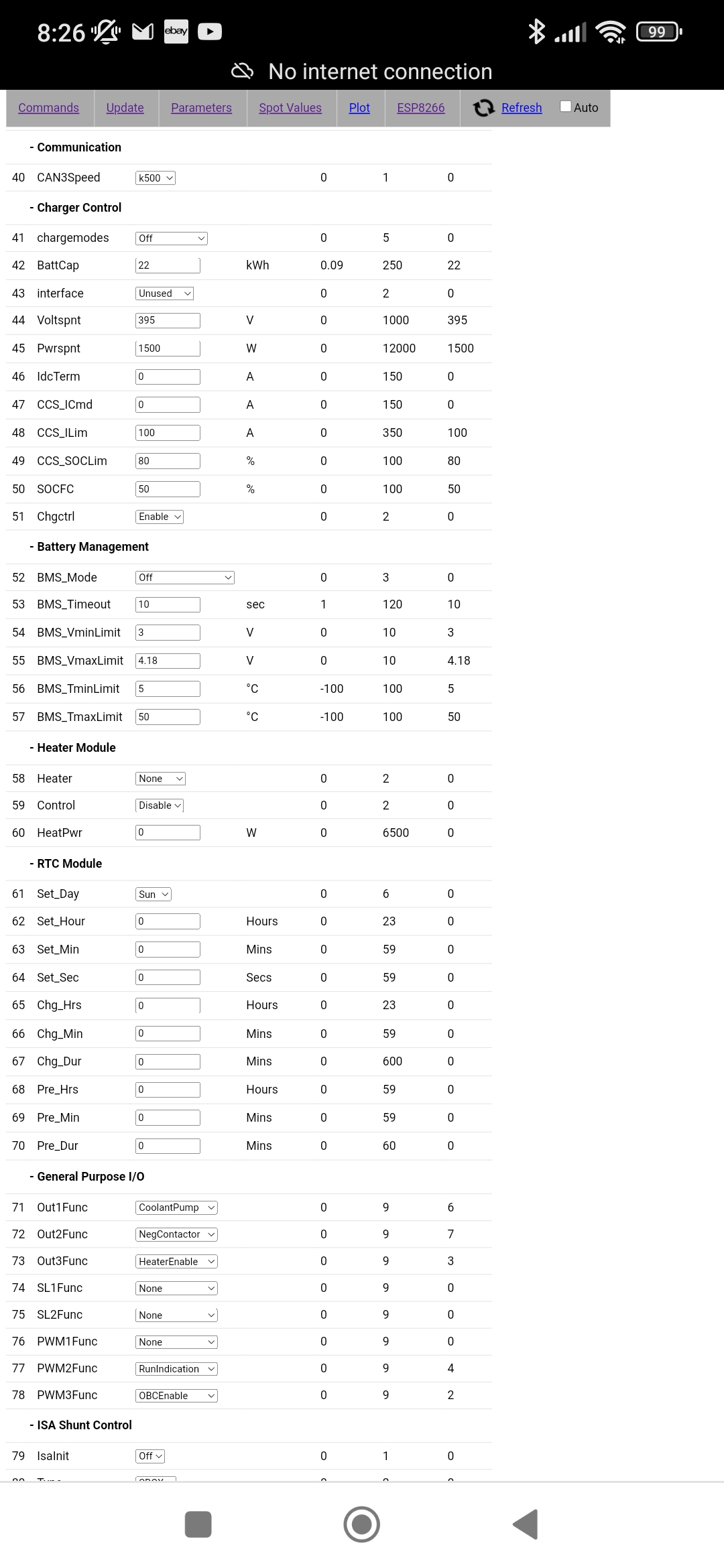

Thanks, here are my parameters and spot values.
I've a value for throtmax (100%) and tempt is lower than tmpmmax although it is an odd value at -27 for some reason.

Udcmin is set to 50v but is reading 0v as you have no shunt
