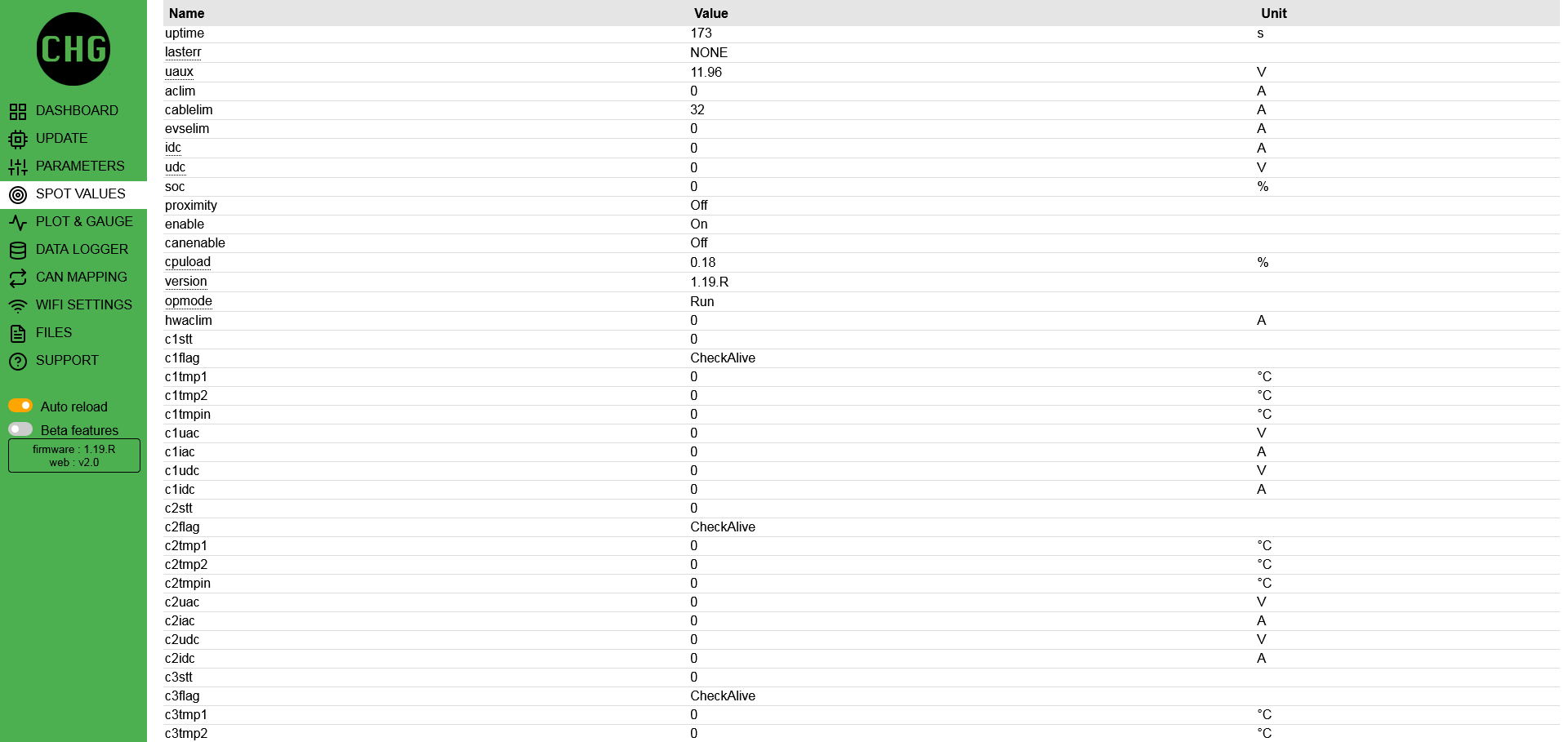

medo wrote: Sat Feb 15, 2025 1:56 pm o CAN messages come from the modules
You make a CAN log or just relying on the controller telling you?
medo

Re: Tesla Charger Support thread gen2/gen3
Post by medo »
yes, in the web interface I only see check alive if it is active, but no values, also in savvycan, I only see can messages that come from the controller, but not from the individual modules
