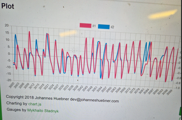

Plot when in in manual mode with everything set to 0, that amplitude seems high to me, +-15 with no manualid. And il1 and il2 should not be in phase, should they?

We have tested with glinks setup quite a bit but never got stable current control. I experimented with my own inverter and arrived at the conclusion that negative gains are needed. When connecting positive voltage on the IGBT side of the current sensor and negative on the outside bus bar the reading is negative. Also verified with a scope. The sensitivity is -2.5 mV/1A. That would result in a ilXgain of -3.1
With some more testing I figured the phase order.
The one without current sensor is phase 3, then 2, then 1. Also phase 1 is sensed by il1 and phase 2 by il2. No inverter pin swapping needed.
The mystery is, we did try with these settings but the current control loop ran away. So commanding 5A manualid resulted in 100A phase current and triggered the current limit.
Maybe the controller gains are off or 100A is too low and triggered by overshoot.
