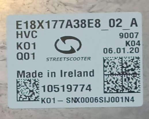

Is there any hint on / in the charger, what company produced them?
- crasbe
- Posts: 330
- Location: Germany
- Has thanked: 58 times
- Been thanked: 180 times
Re: 11KW MLBevo charger group hack 5QE915684BJ possible
If the wiki is right, they are made by KOSTAL: https://www.kostal-automobil-elektrik.c ... ectronics/

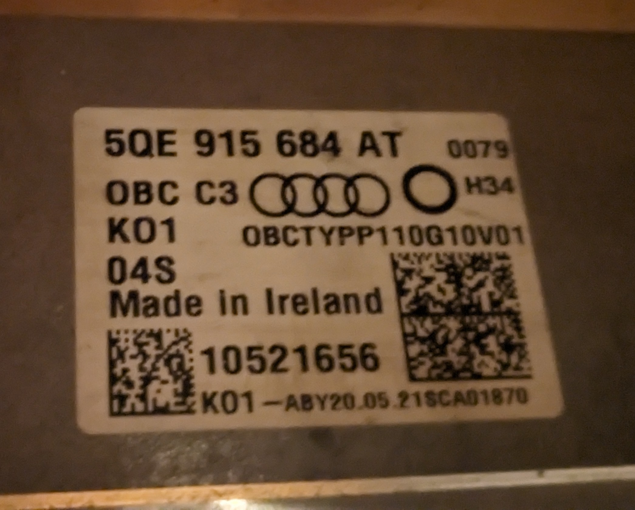

Seems at least plausible, my other charger says "Made in Ireland" and KOSTAL has two subsidaries in Ireland.
One hint is the high voltage warning sticker, it has a VW part number: "12E 010 001 B", my 5QE 915 684 AT charger has nearly the same sticker, but with part number "12E 010 001G". Otherwise there are just numbers in the casting, no letters. Possibly a date code of a casting of "04 2018".

Comparing the stickers, the similarities between the VW one and StreetScooter tag are quite obvious.

This might be the proof for Kostal: https://www.electrive.net/2018/08/11/ca ... etscooter/
The casting from Jacobs charger says "23 2019", so it's a later model and apparently it's a week indicator, not a month indicator.
So my charger with "04 2018" might be cadmium polluted. Or maybe not.. probably not more than the bolts of the car it'll perhaps be installed into..
Cadmium-belastete Ladegeräte sind zwischen 2013 und Juni 2018 verbaut worden. Betroffen sind der VW-Konzern und StreetScooter. Laut “Automobilwoche” stammt das Bauteil mit den belasteten Kontakten von Kostal.
I wonder.... are those chargers some that were affected by the recall and somehow jumped out of the dumpster? The tag with a date of 2020 however would indicate otherwise.Cadmium-polluted chargers were installed between 2013 and June 2018. Affected are the VW company and StreetScooter. According to "Automobilwoche", the part with the polluted contacts comes from Kostal."

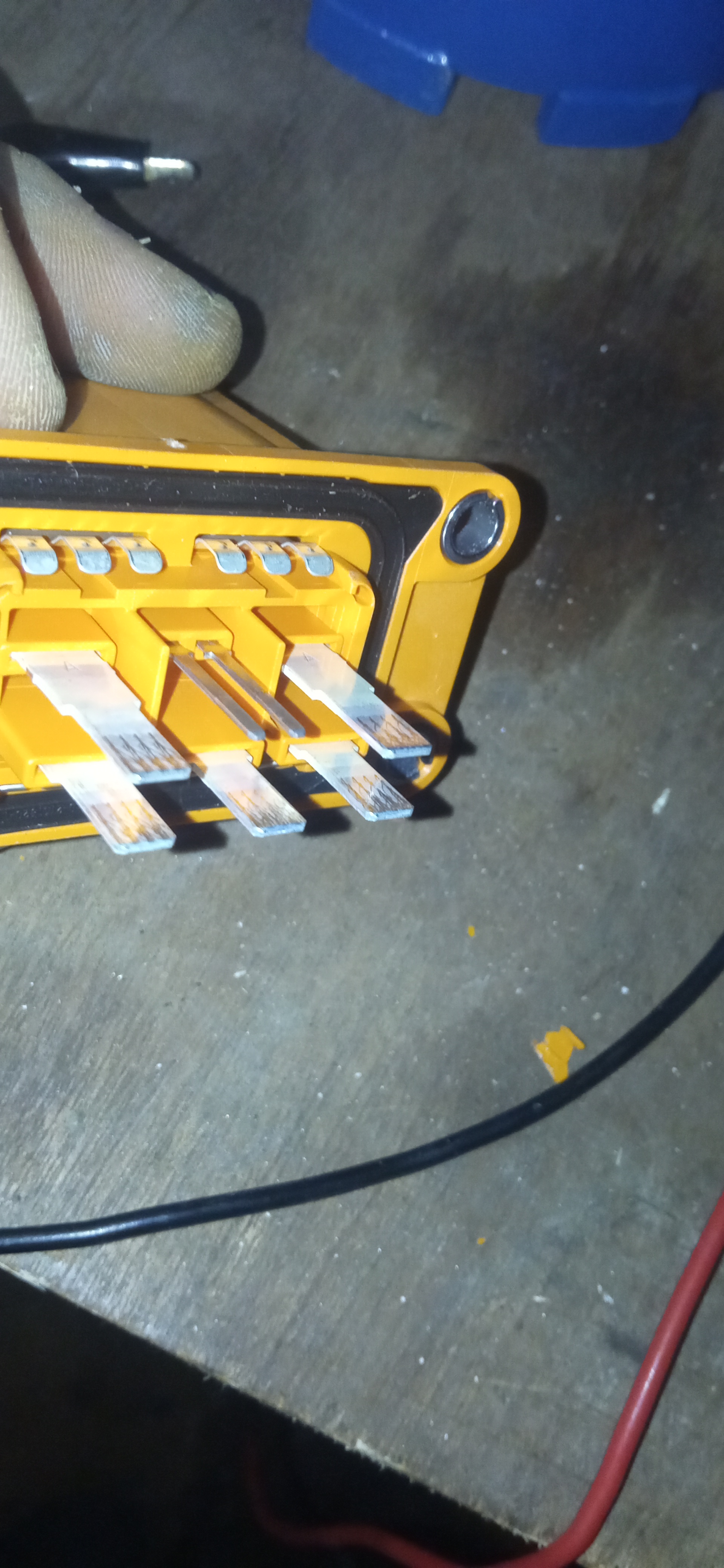

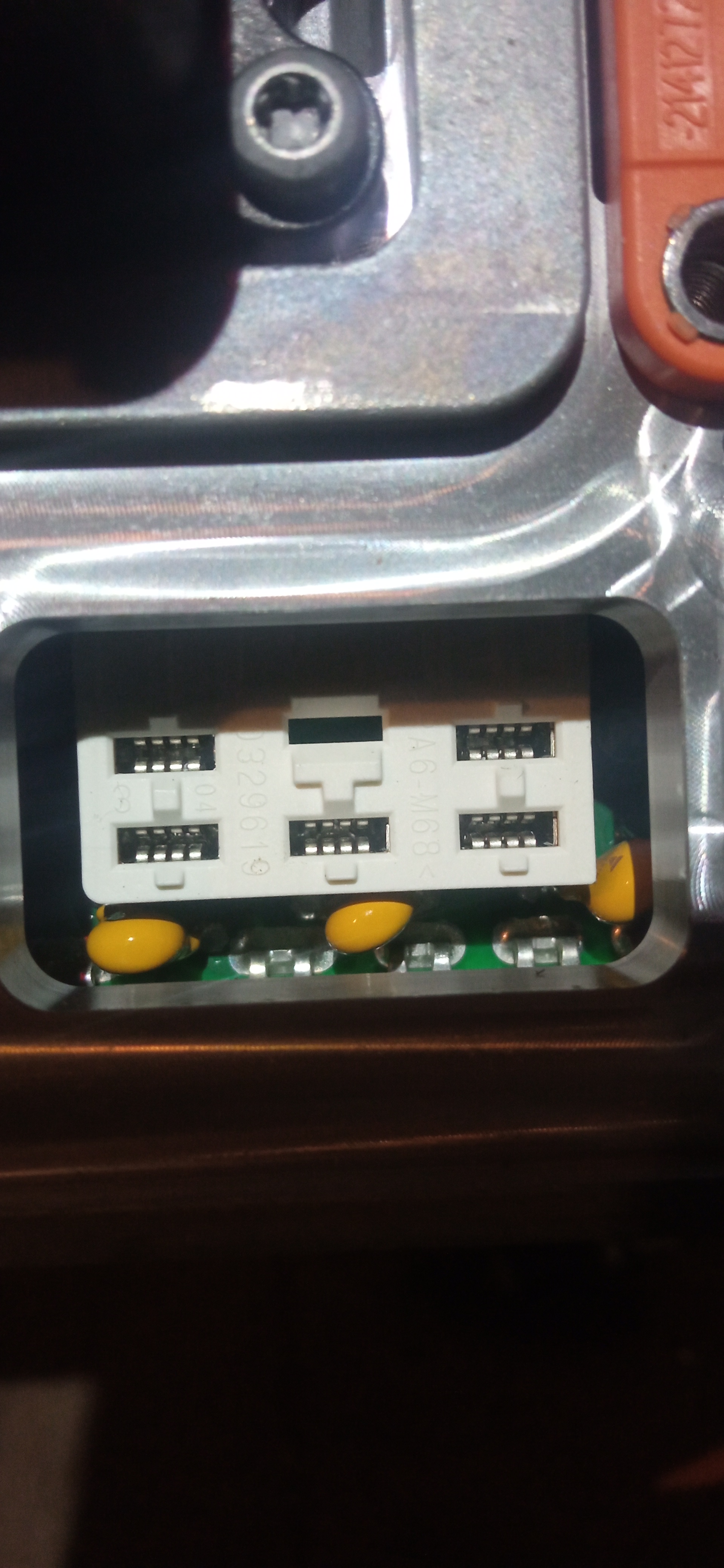

Ah I just wrote a long post and then tried to add a photo and the post was lost!
Anyway in short, I looked at replacing the large HV cable for something cheaper and more commonly available. The small HV connector cannot be removed due to some small wires with no slack and the 60 pin connector is more widely available.
The large HV connector uses 5 spade pins direct to the board with the top centre small pins unused. It looks like it might be possible to 3d print an adapter for the cable to something more commonly available or use spade connectors and a 3d printed gland or some form.

I would try and get a VAG group charge port with the connector. Plenty on Ebay these days for around £150. Much cleaner and safer than making up an adaptor.Jacobsmess wrote: ↑Tue Mar 05, 2024 7:52 pm Ah I just wrote a long post and then tried to add a photo and the post was lost!
